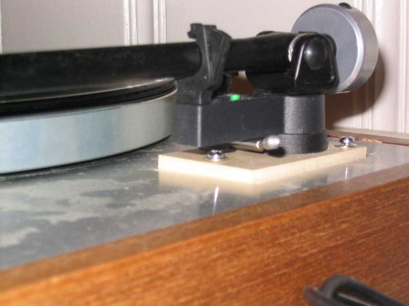

Here are a couple of photos from the sanded-spindle, Rega-mounted TD-160 that you have all helped create.

Also, I did actually sand the spindle quite a bit to reduce the speed. It had an exceedingly low yield on the effort / results ratio, so I started to look at the motor mounting.
The TD-160 motor is held in place by three screws (well, two screws and one screw post). The screw nearest to the platter is on a tight spring, which made me think. I loosened this screw a bit and the spring kept the mounting firm, but the motor inched (millimetered?) closed to the platter which, in turn, slowed the rotation.
I effed with this for a few hours and finally got the speed about right.
Per your collective advice, I mounted the Rega with MDF. It was surprisingly easy to do. I'm sure the VTA could use to be adjusted, but I think I'm going to leave that for another day-- unless of course someone preaches disaster to me about this...
The sound is truly beautiful and I can again enjoy my vinyl collection! Even Mrs. Annan is pleased. Well, by "pleased" I mean she's stopped hitting me in the face. Relative terms, baby.

Now it looks like you can enjoy some music! Are you going to paint the tonearm mount some time?
You might want to look into something like a "Platter Matter" to replace the original mat at some point. This thing adheres to the album and damps out resonace pretty well. You have to peel it off the LP after use. It's a pain to use but makes a hugh difference to the music. Enough so that I still use mine.
Don't forget to correct the vertical tracking angle if you change mats.
