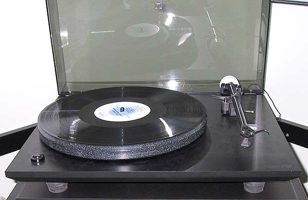

You might want to look into something like a "Platter Matter" to replace the original mat at some point.
Asked for and may receive a new mat / record clamp for Christmas.
Don't forget to correct the vertical tracking angle if you change mats.
Uhhh... I uhhh... really haven't aligned the VTA. I'm just kinda eyeballing it right now. The cartridge is aligned properly and the table is balanced, to the best of my ability, but the VTA... well... still need to do that.
Is it worth investing in one of those Rega VTA adjsuters? Will I destroy my record collection and rob myself of enjoyment if I don't meticulously adjust the VTA until later?

Watch out for the ghosts of vinyl past. I think if you are in the ball park with VTA then you are fine. At least the cartridge isn't 15˚ off center ... is it? Have a great holiday!
