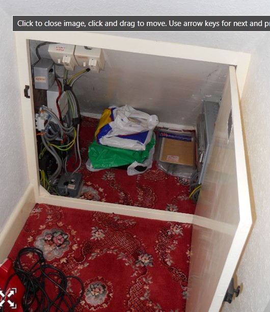

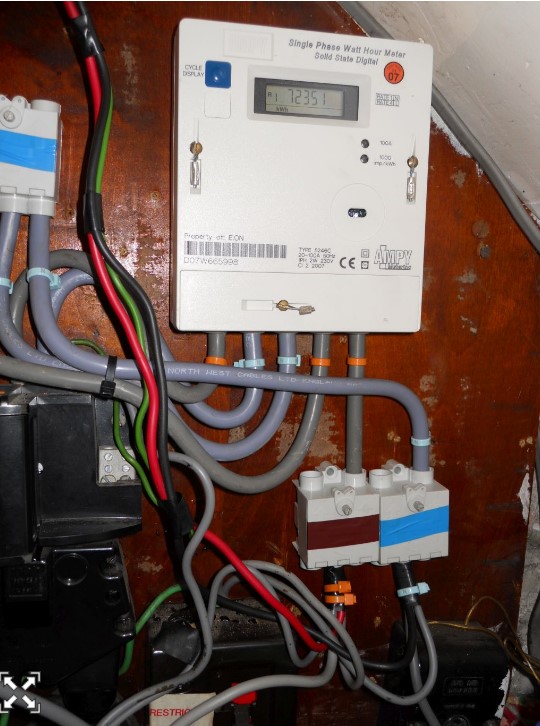

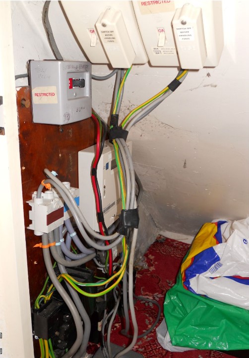

A few years ago our mains supply voltage went down to 100v ish, next door were going to buy a new shower but knowing a bit about elektrickery I told them not to bother and rang the lekky company.
A big armoured cable had blown in the supply to our houses, the lads gave me the cable afterwards, the cable was under a section of tarmac carpark where a big puddle sat. Being in rural UK the rain effects our broadband, fone reception and whathaveyou. Recently it's rained for weeks here in the UK ,the ground is saturated, a possible cause of your issue.
First though check the screw terminals on your consumer unit, especially where the big cables come into your house. I've found faults on our and several neighbours consumer units over the years where the terminals to RCB's and ring mains etc were loose. Yours sounds like a possible loose earth connection, neutral is tied to earth on most UK systems. Carefull though, you'll be working on a live system, use properly insulated tools and use your nous.

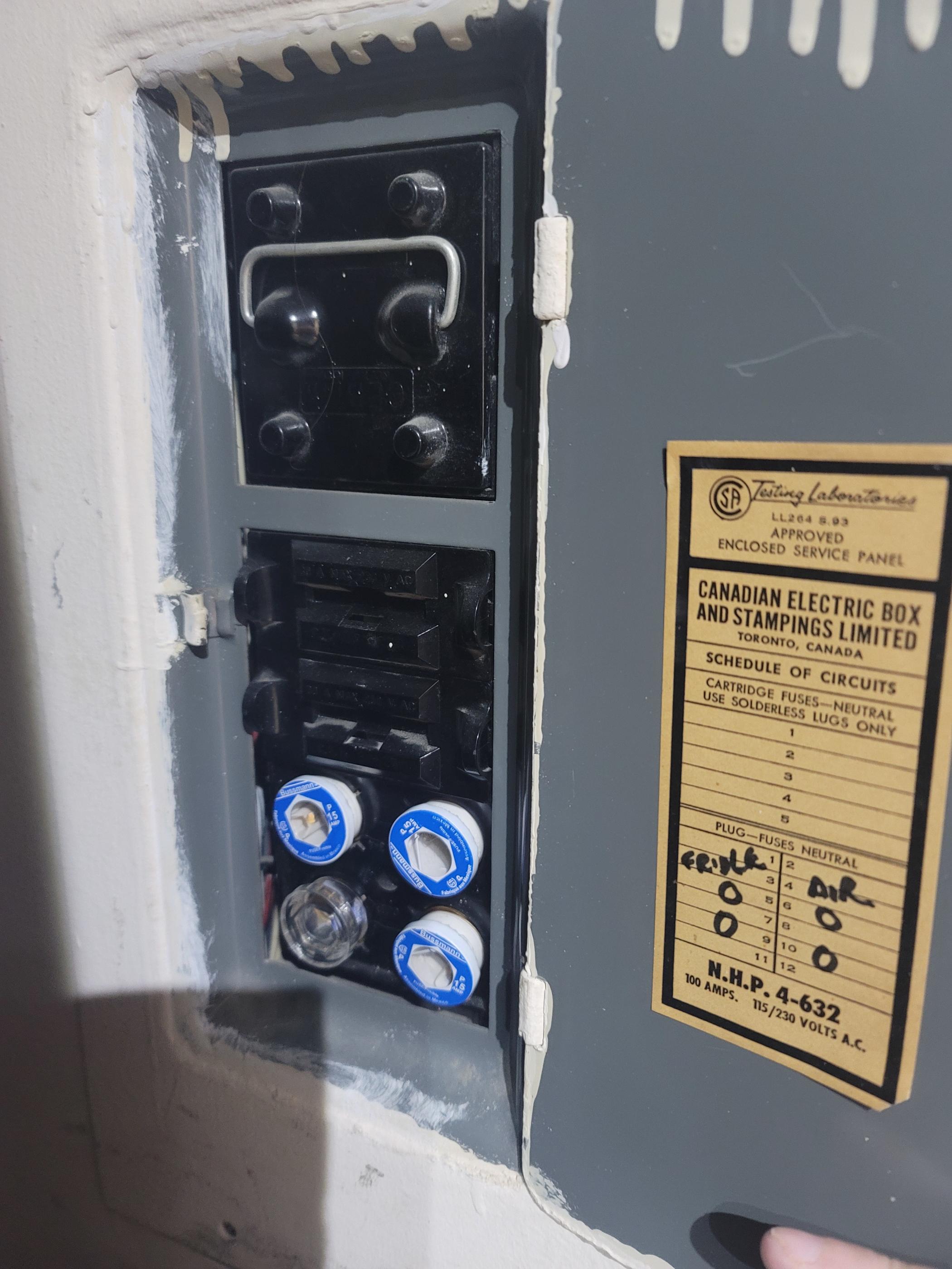

Wow... That "consumer unit" is very different than whet we get in Canada...
My apartment was built in the 1970s and I still have a "fuse box".
An apart-hotel I stayed in had a more modern "breaker panel".
Of course, we don't use a ring topology here, either.
As far as the OP tightening screws at the main connection to the "consumer unit", I'd leave that to a certified electrician. It's one thing to get 240V or even 480V shock DC from a tube amp, it's another to possibly cause a 480V (or whatever your higher voltage is) arc flash with current behind it. Not that you have 3PH coming into your place, but this is what a 480V arc flash looks like: 480 volt 3 phase Arc Flash Demonstration - YouTube

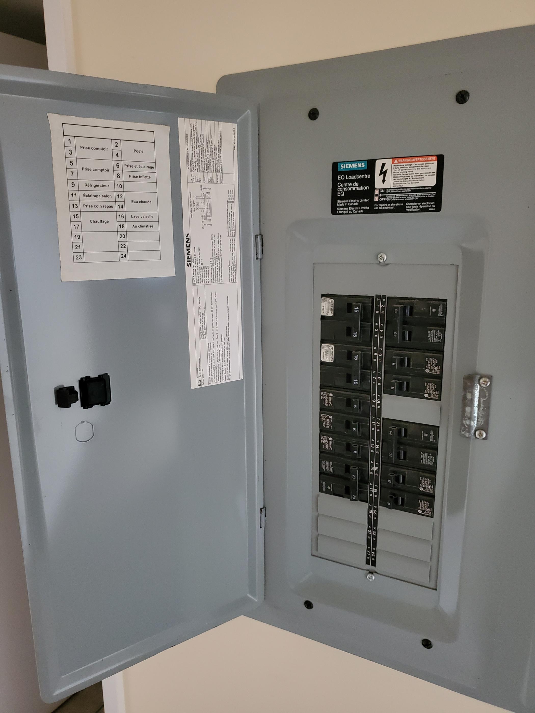

This is a more typical install in a house in Canada. The feeders must come through conduit but the branch circuits don't have to be. We don't have rings, ours is like hub and spoke. It's also a before photo 🙂

Here each circuit is a "branch" circuit with it's own breaker or fuse (not for new installs). Ground also travels to each box/device. Neutral is tied to ground at the main service panel, nowhere else.
Interesting. I could imagine the current adding up on those first wire runs although I don't know what your socket limits are. In the UK it is 13A per outlet where a double, triple or even quad socket still only counts as one outlet @13A total loading.
In the example above, the entire electrical load will be on a single 15A breaker. Modern code is requiring more and more circuits. My last apartment was build in the early 1950s and the entire place ran on 3 15A circuits not counting the stove. This 1970s apartment is half the size, and has 8 15A circuits not including the stove. In theory, it's a 100A service fed by #4 copper or #2 alu. When I move, they will replace the fuse panel with breakers and a usage meter (it's included in my rent, but not for the next person).
Generally, it's a 15A breaker these days... per branch. #14 copper wire / #12 aluminium (obsolete except for distribution)
Kitchens get split feed (top and bottom are on separate fuses) and it's more common now to have 20A for a kitchen receptacle running #12 copper wire in most places (75c or #14 where 90c is ok). Generally, things are derated to 80% of that. You might get a hair dryer rated for 1875W, but a space heater (electric fire I think you call them) would only be 1500W because it might run continuously, where a hair dryer is short term.
The electric stove will be a double breaker running 240V @ 30A usually. Roughly the same for a dryer. A water heater (electric shower?) usually runs 240V 20A. A spa/hot tub with a 6kW heater and 2.5HP pump is running on a dual 60A breaker at my fathers house.

Oh, and the 4 P type fuses are for the outlets and lights in the apartment, there are also four 15A cartridge fuses for the kitchen outlets, and the standard larger cartridges for the stove. There is 100A service here and it's only 400 square feet... Since I scrapped off the bus bars and applied Vasoline to the fuse contact, the fuses never blow now (unless you try - plugged in a shorted cord last week - instant blown fuse). They used to start arcing on load which would heat and melt the thermal part of the fuse.
