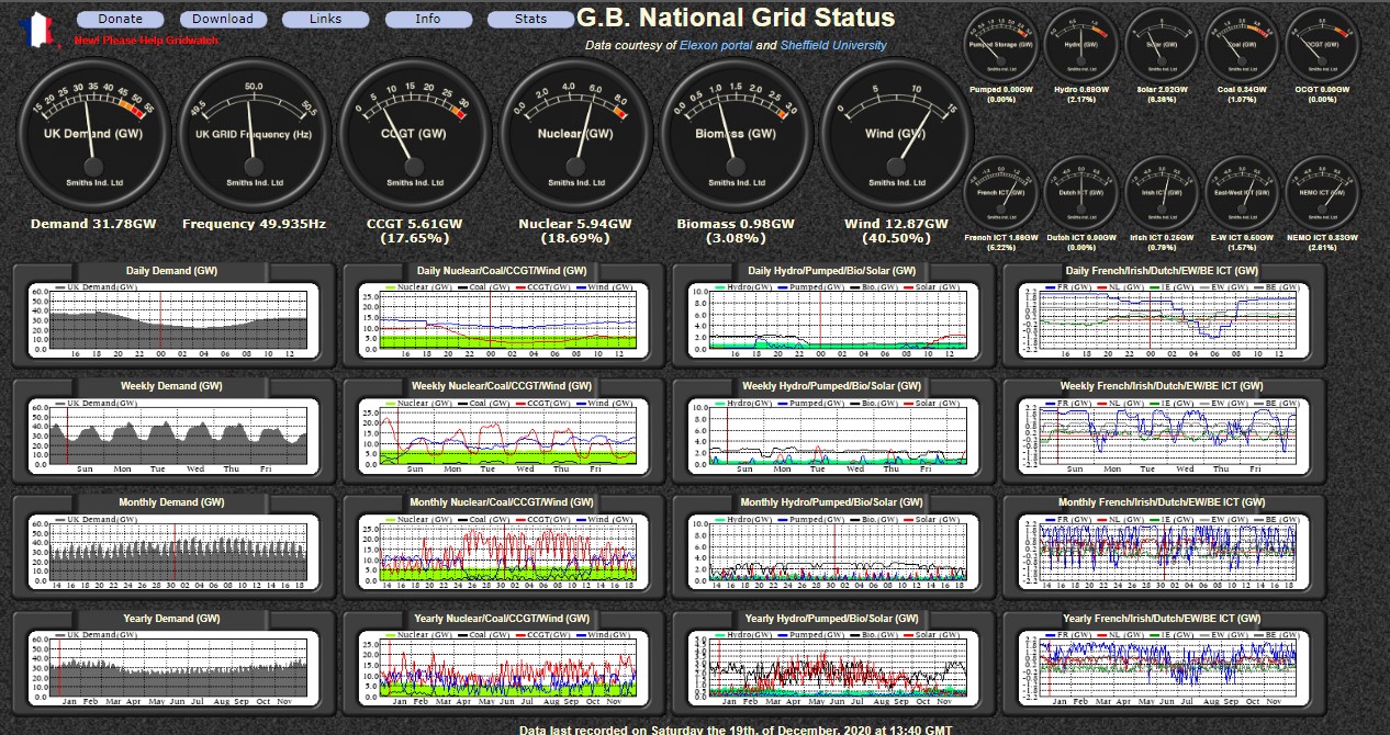

That is low.
The UK grid at this moment looks to be under heavy demand (frequency is quite low at 49.93Hz). Some utility companies have also adopted a dynamic voltage control where they reduce voltage to try and ease power requirements. That was trialled some years back in the North West of England and implemented.

so this evening unstable and unusable amp. voltage AC 215-220V and I think this is my intermittent instability problem...only because at this low AC in the HT drops below 500 and this is what I have measured along with 400 or less on the AC after transformer in the HT. The voltage picked up a bit 222 V or so and the amp could be switched on and was nearly working - then you can hear the instability start. Could all be circumstantial I guess.

215 is out of tolerance for the UK. That is to low. It would be interesting to see how your incoming supply holds up under load. I could pull our mains down from its once nominal 240 to 245 volt all the way down to around 216 by heavily loading it. Four storage heater (total approx 12kW), an immersion heater, couple of radiators and it was starting to approach the nominal 24kW absolute max loading of a single phase supply fused at 100A.
48 hours with a chart recorder that showed the voltage plummet at midnight as the storage heaters were powered up had the then electricity board put several properties onto a much stiffer supply.
Is the amp the SP8? The PSU in that shows (curiously) that 210 to 250 is the accepted input range. I'm not sure I'd take that at face value without checking it first.
