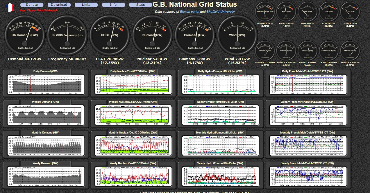

Demand seems very high just this minute... maybe tonescout has left something switched on 😉
Ours isn't as fancy... Power Data
Still interesting kodabmx, you guys in Canada are in the enviable position of having a large amount of Hydro 😎

You're probably familiar with this one and there is some interesting info in the links on the page.
Dynamic Demand
I seem to recall a thread over on another UK forum a few years back where the once super accurate (as averaged over time) 50Hz wasn't what it used to be. Maybe it was a problem for a few months for whatever reason... I don't know.
