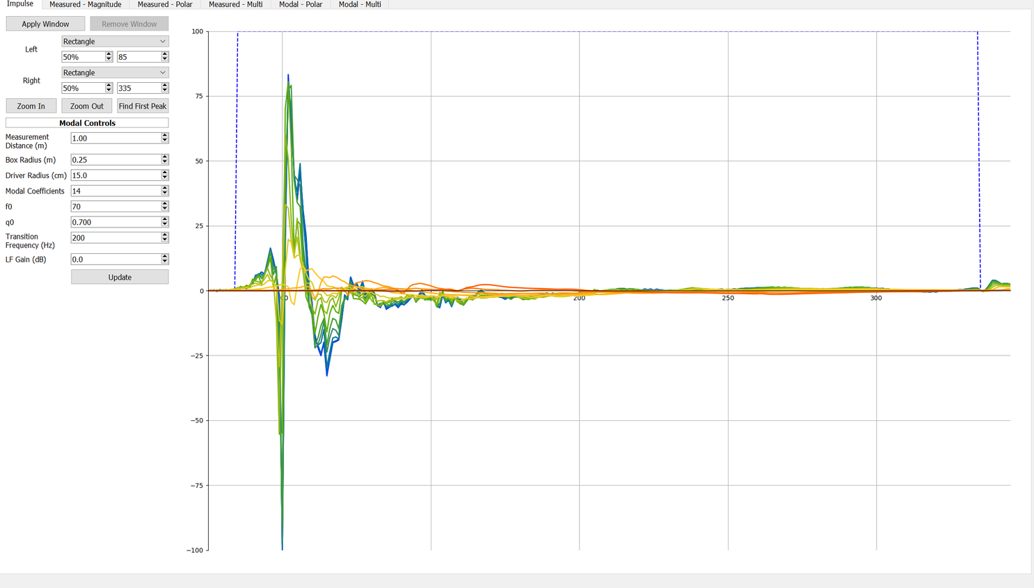

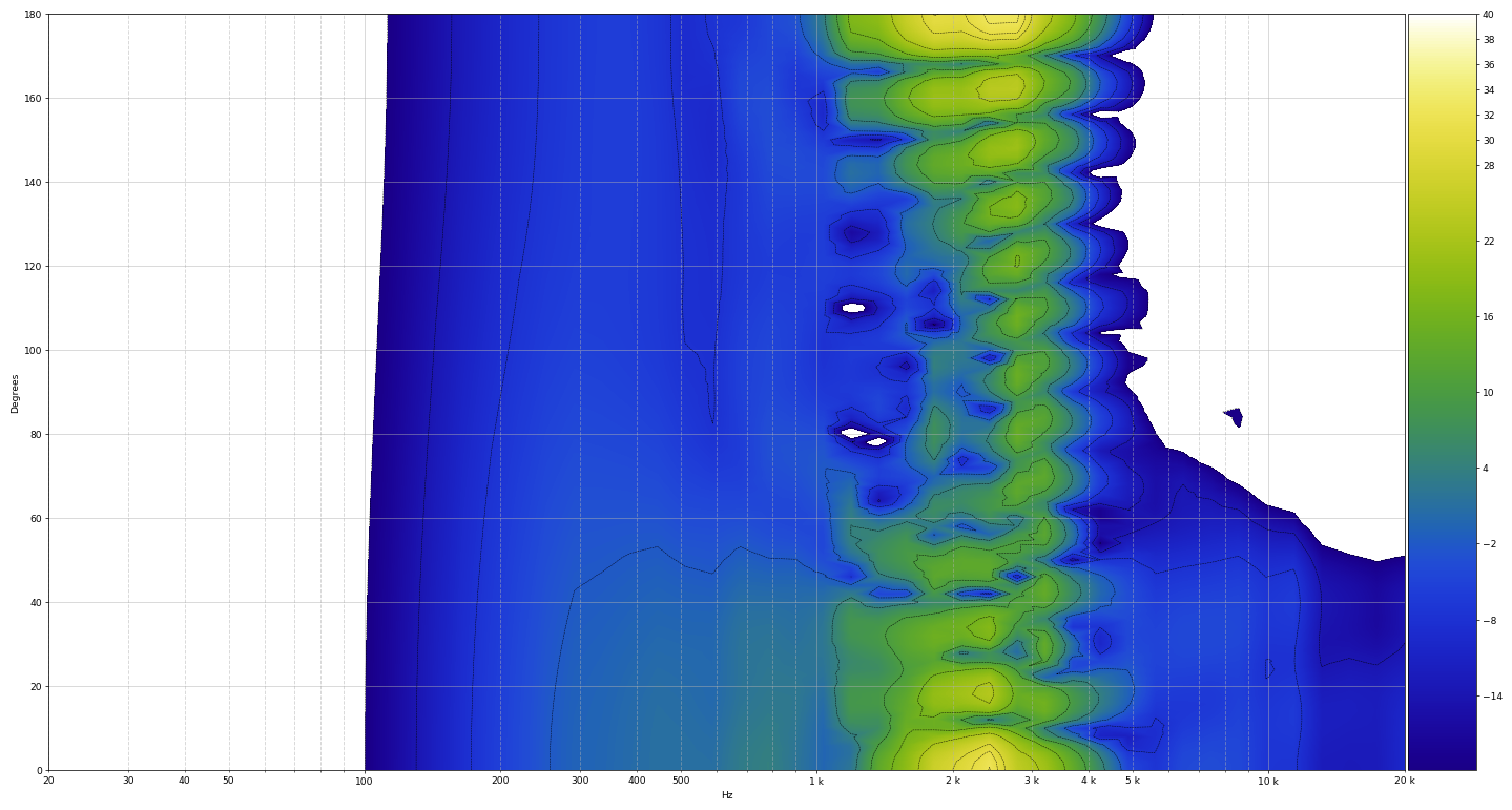

anyway I put the window as follows, is this ok?
this results in
Ok, I can open the file now.

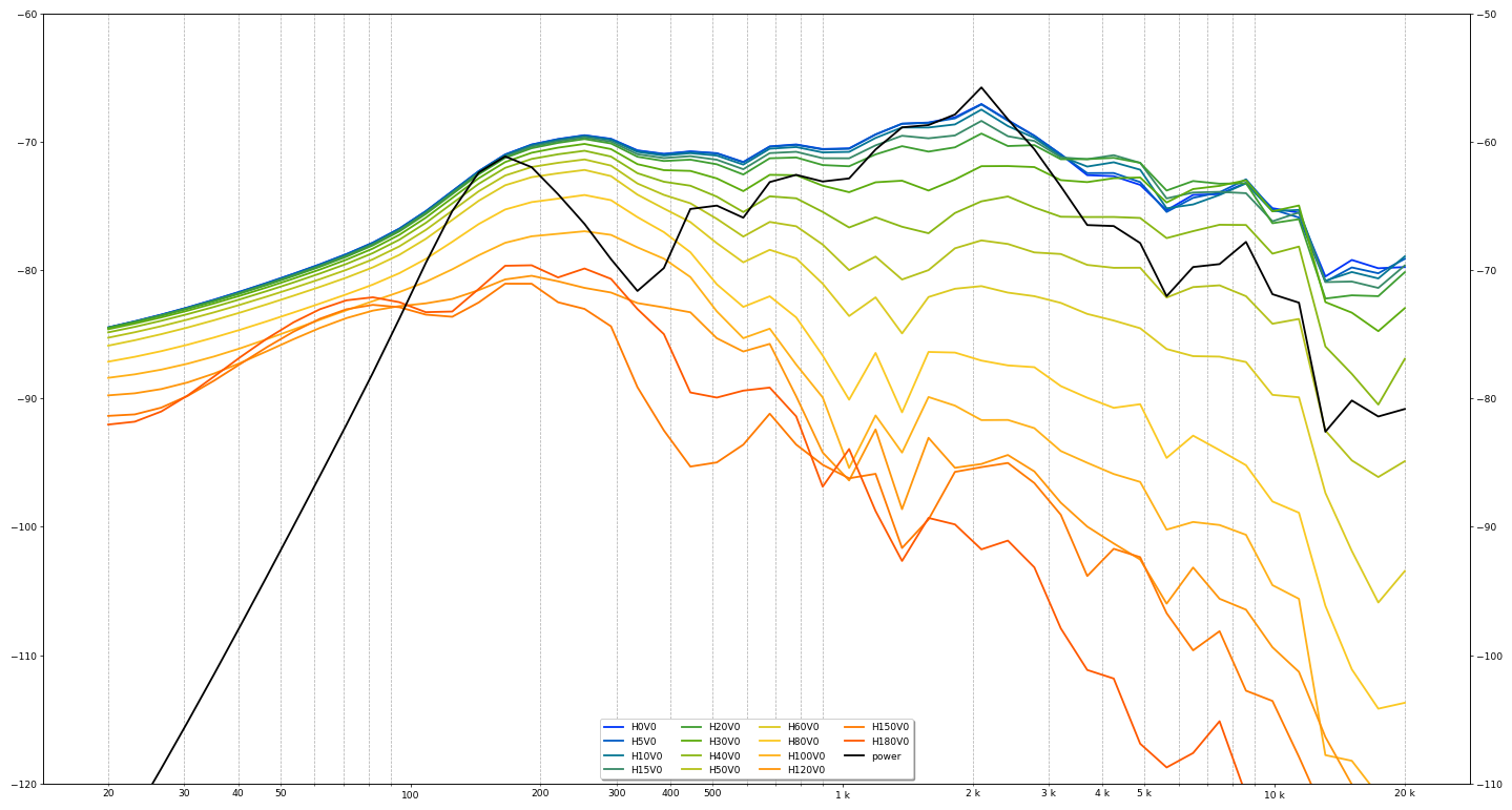

1) The window is extremely hard to set. In my code you just drag a line and set the window - done. Only one impulse should be shown - the axial - as this will determine the correct window length.
2) The modal fit is certainly wrong.
3) a line on the polar map showing the angle for the top plot would be almost essential. Another line showing the frequency would also be nice. Its very hard to tell what the angle and frequency are.

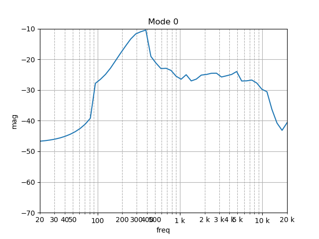

What I would need to see to debug the error is a plot of Modal coefficients versus frequency.

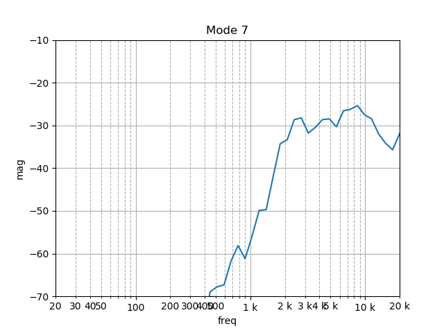

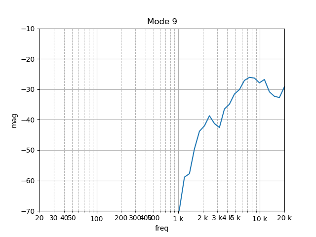

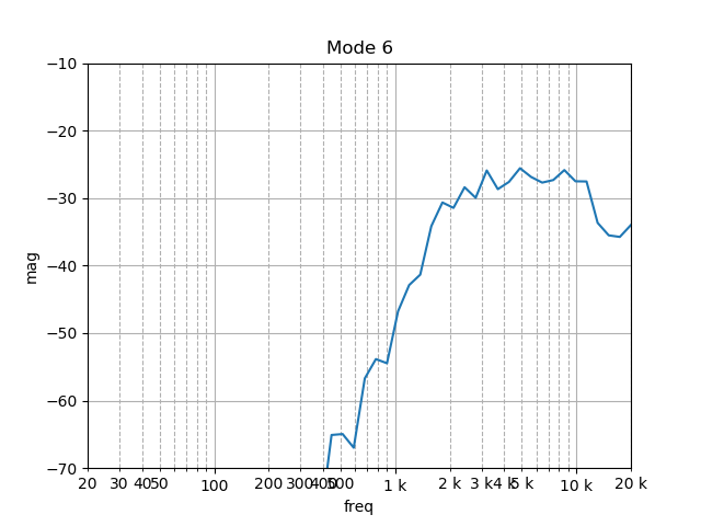

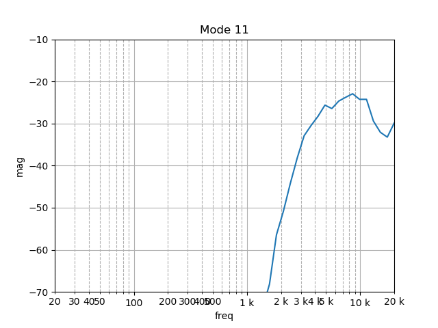

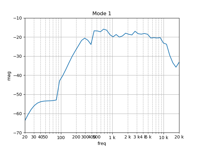

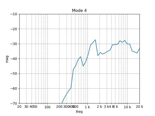

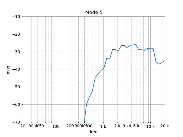

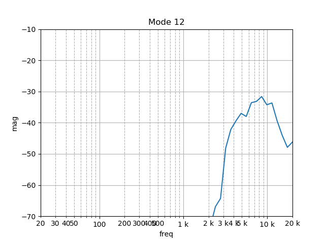

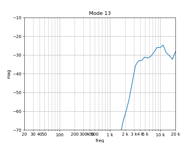

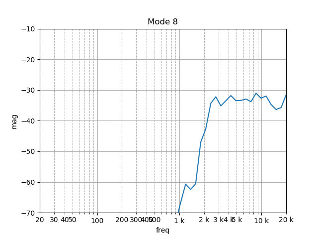

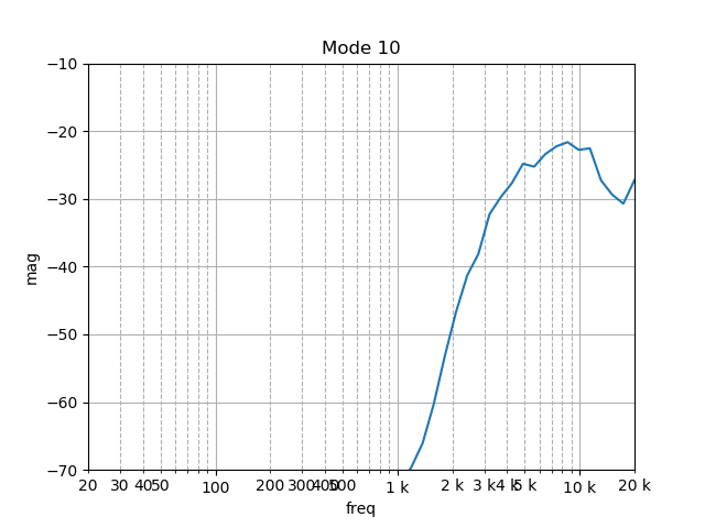

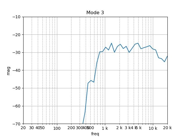

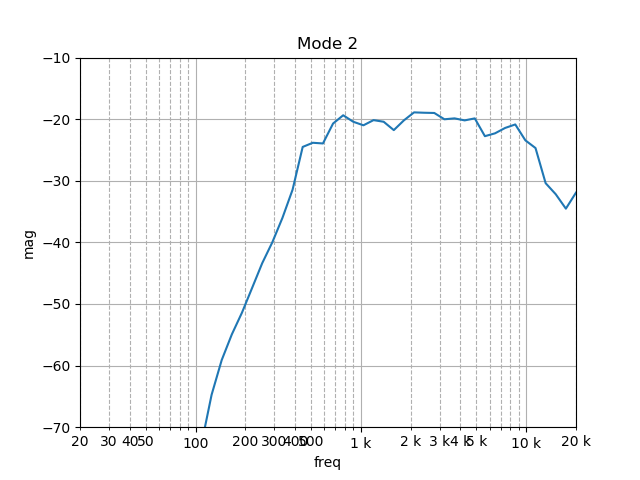

Yes, I need to see the array ModalData(,) output from CalcSpatial, plotted as magnitude versus frequency for the number of modes calculated (or say the first ten.) There are some strange single point dropouts of -30 dB that can't be real in the results.

anyway I'll generate that data for you

Also, I would need to see these same plots within the app - on a tab (which can be hidden later)- while I do some things. That way I can debug what is going on i.e. what ka value does mode 0 go bad and does this vary with field location or with the assumed source radius, etc. ... critical to know these things.
PS it's actually not so bad that the error is going to be simple. You appear to be interacting correctly with the DLL, but something is amiss.

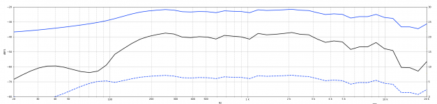

try this build - Release Display modal parameters * 3ll3d00d/pypolarmap * GitHubAlso, I would need to see these same plots within the app - on a tab (which can be hidden later)- while I do some things. That way I can debug what is going on i.e. what ka value does mode 0 go bad and does this vary with field location or with the assumed source radius, etc. ... critical to know these things.
the window controls are hopefully a bit more user friendly and the modal response in the new modal - parameters tab. There is a glitch with the multi view charts in that leaving the tab and going back to it stops the chart working.
if you hit ctrl+m then you should be able to tweak the modal parameters and see the results
if you hit ctrl+l (while focus is on the main window) and put that into DEBUG then you'll see the parameters (excluding the actual data as I thought that would be a bit too much info) passed into the various function calls.
let me know if you need anything else in order to be able to debug further

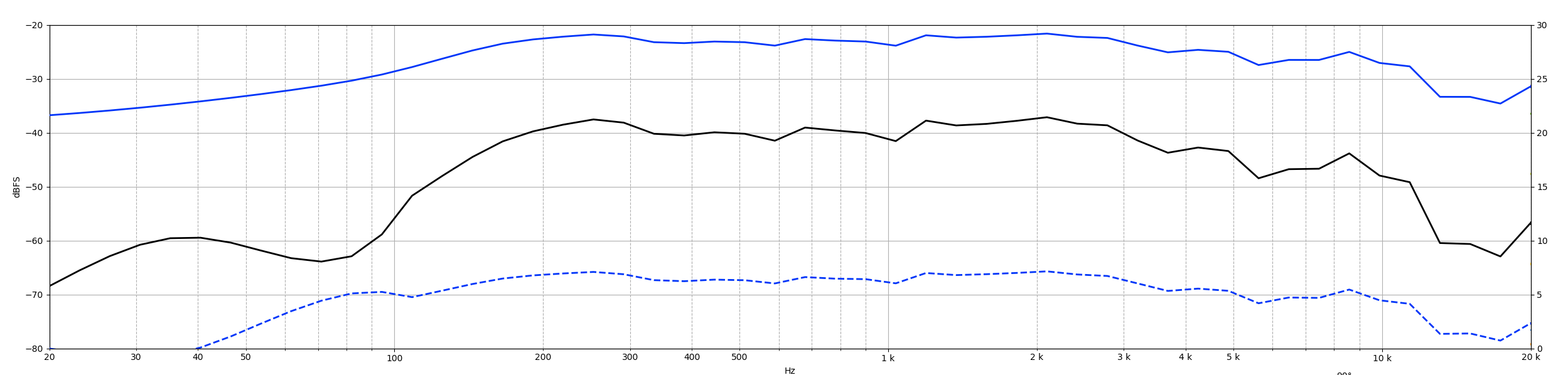

At this point, below 200 Hz is pretty well meaningless. We will need to add in some further techniques for that area, but above 200 Hz what you are showing looks exactly correct.
I think that I might have found the problem. When I "commented out" the LF fitting stuff I may have to correct the remainder. I was never completely happy with my LF fit - I could always get it to work, but it took too much human interaction and it only worked well for monopoles. When we decided to do this work I commented out all that stuff to focus on just the higher frequency range, but might not have completely left behind correct code.
