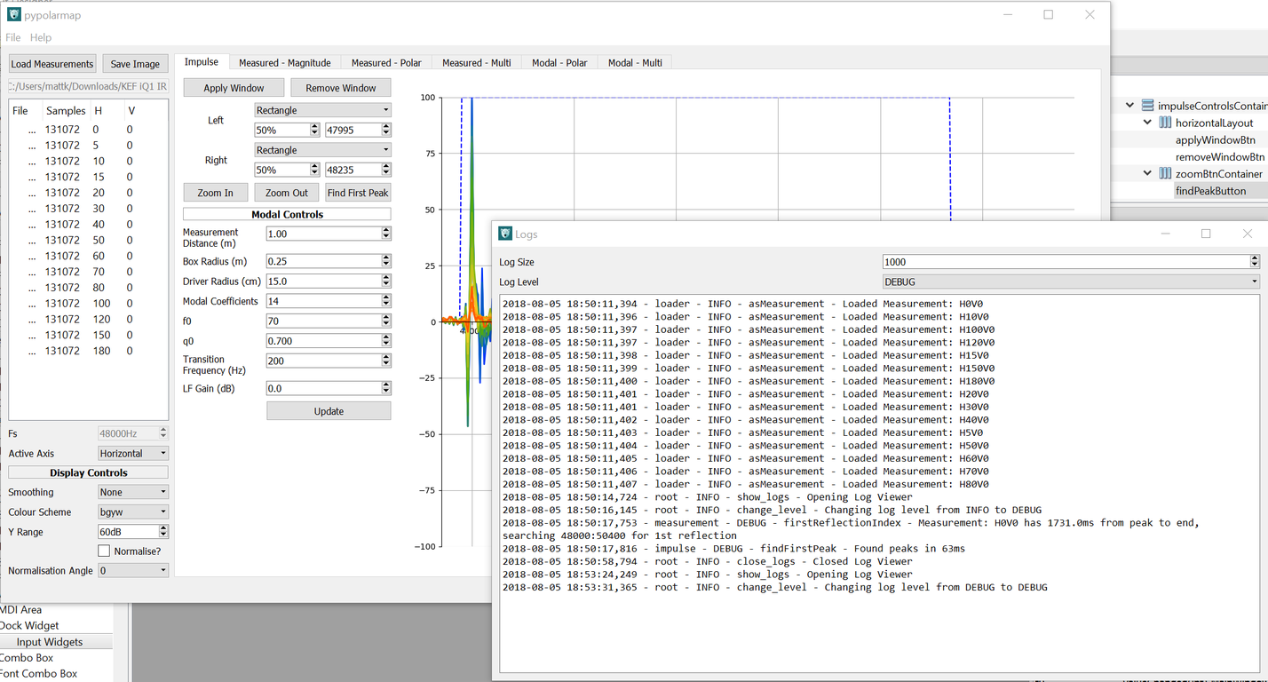

these issues have prompted me to do some of the boring bits though
firstly, show an error dialog when something unexpected happens
secondly, a log viewer so you can see some of what is going on as it does stuff
should help track things down in the event of bugs (not that my code ever has such things 😀)
I've also tweaked a few things that were v slow for no good reason when presented with large measurement files of the type that REW produces by default. I think the last thing I need to resolve (and is the cause of the error shown in the example error dialog) is handling integer wavs (as opposed to float)

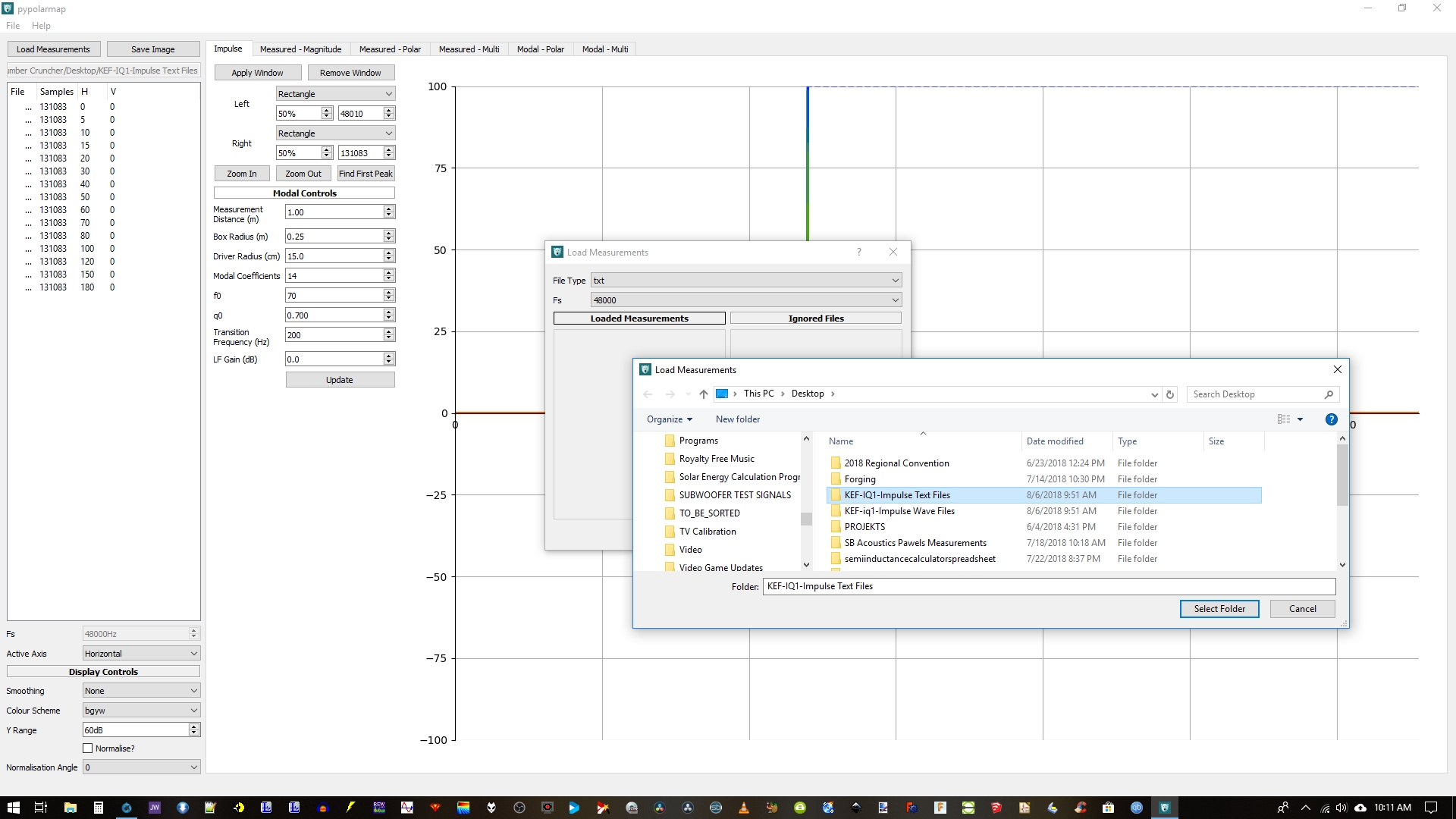

Can't load the files with the H prefix, unless I put the H in the wrong place?
I am having the same problem with anything except for text files. For what it's worth, the WAV files I posted can be imported into REW and then exported as .txt files; I was going to post the .txt files here but they're too big to attach.

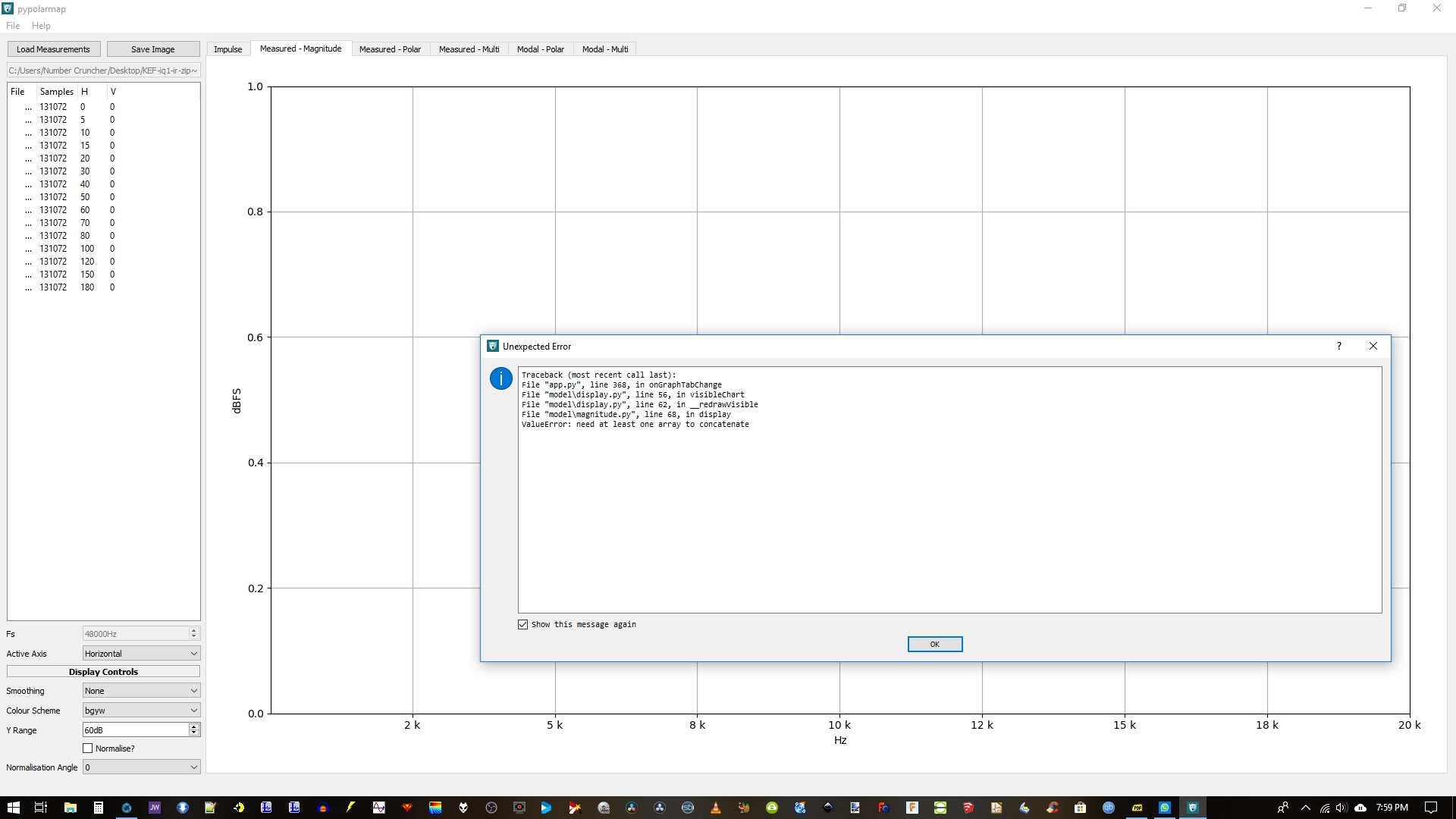

OK downloaded the latest update. I could import a wave file into the application. But I saw only one impulse response and when I tried other windows I get this error:
So now as given the hint I am transferring the impulse response provide as a sample file into impulse text files.
I'm cutting the impulse window down to the smallest practical size.

I don't have these problems so I need precise instructions that reliably reproduce the error.
Something to note about the file loader though... My expectation is that data is stored in an orderly fashion which I define as "each measurement set is stored its own directory with names that fit the naming convention and with no other files in that directory at all". If you load from a directory that meets this description then it will load all files and automatically close the load window.
If you load from a directory that contains other files then it will list both loaded and ignored files in the dialog and will leave the dialog open so you can decide what to do next. This either means close the dialog and accept the list of loaded files or it means load a new set of files from some other location. If you load again, the new files replace whatever you had loaded so far.
Once you have loaded files then you have to "apply window" before the other graphs will be visible.

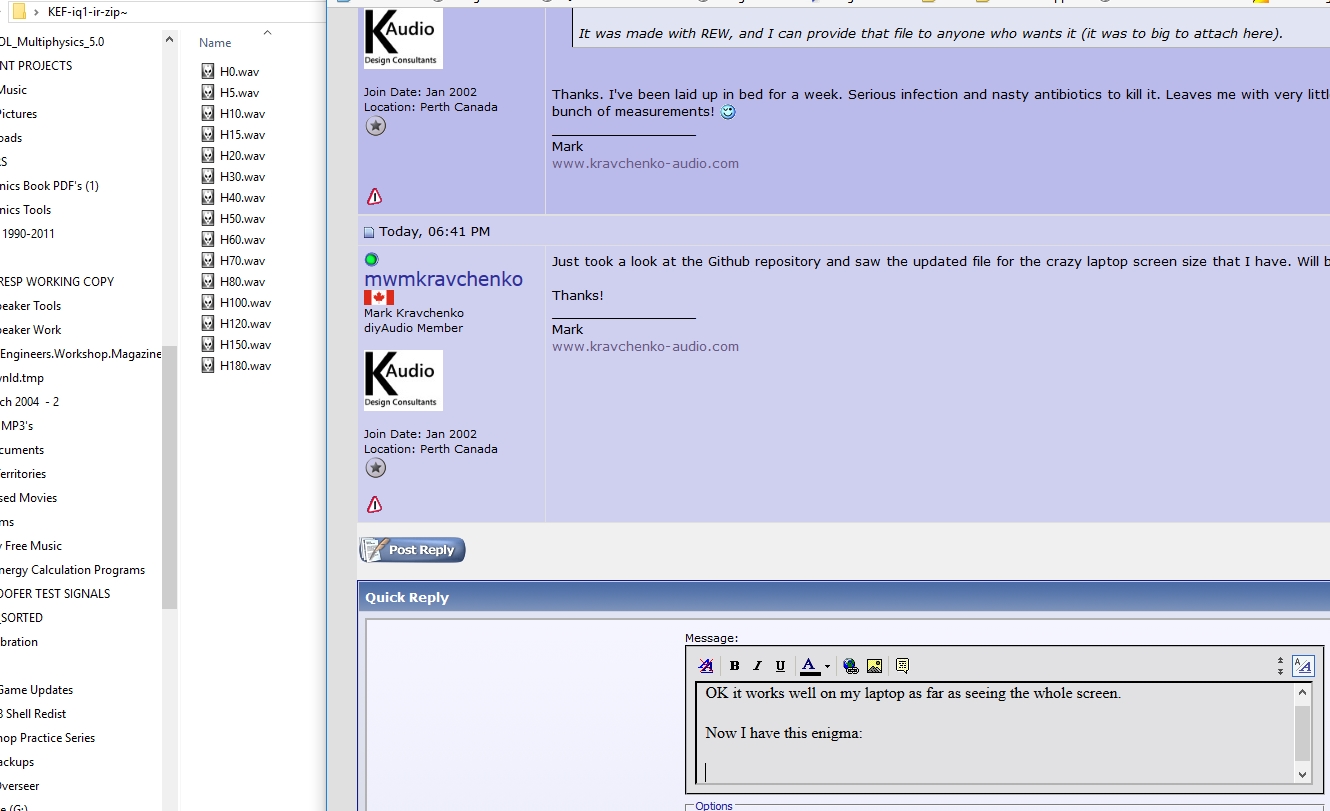

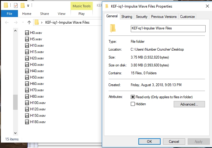

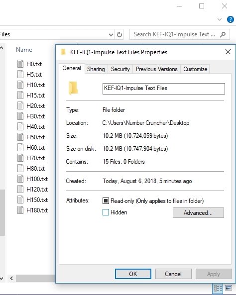

If I am missing anything in the way of file information just let me know. It's no trouble at all if I can help a bit.
I also made a folder in the installation directory and placed the two separate text and wave folders there just for kicks and giggles. I'm pretty sure it should have made no difference. And it indeed made no difference. Same error messages.

Are you using the exe or the installer?
So to be clear you did the following
Extract zip to some new directory
Launch app
Press load measurements
Select wav from drop-down
Select folder
Click ok

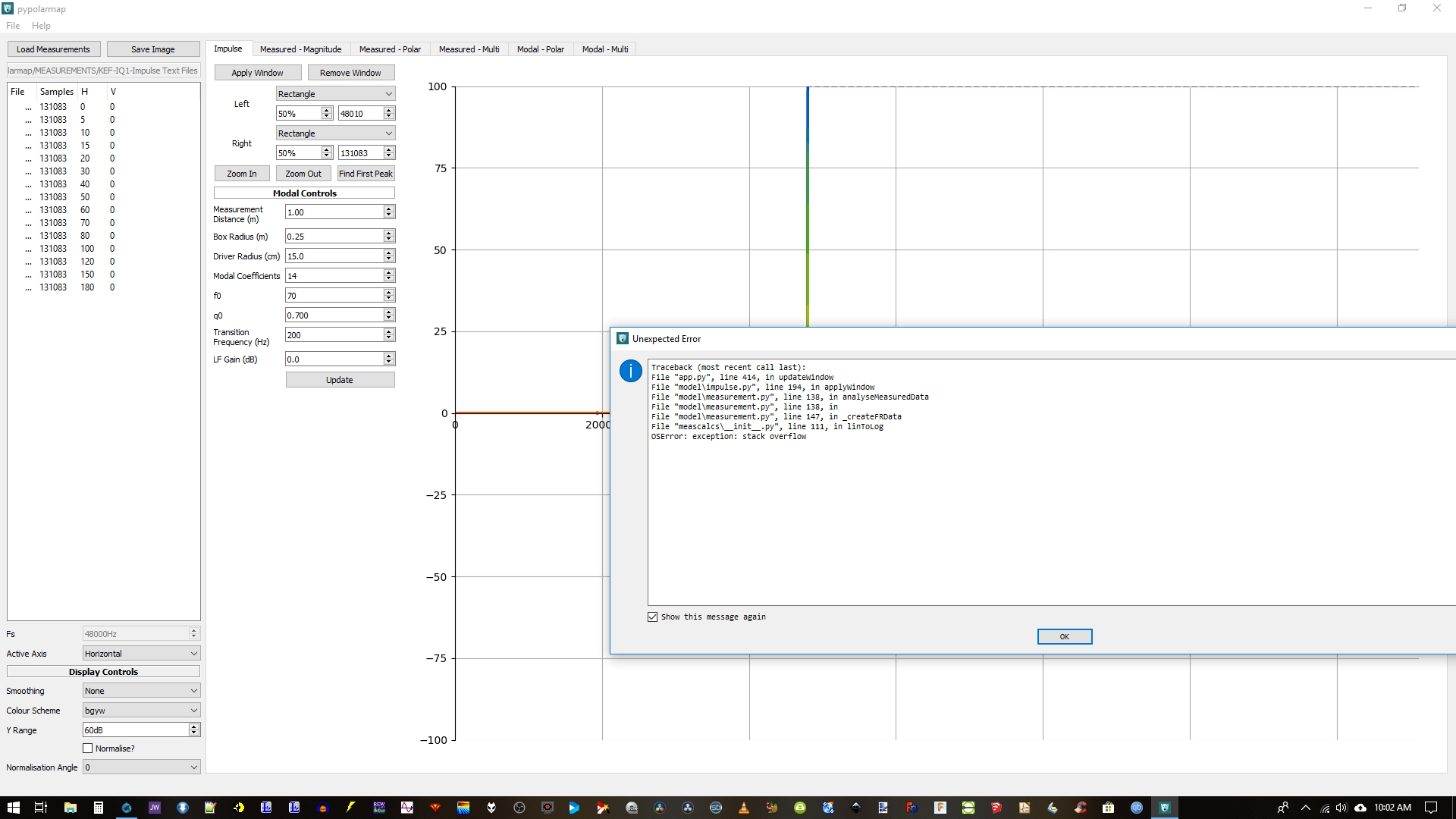

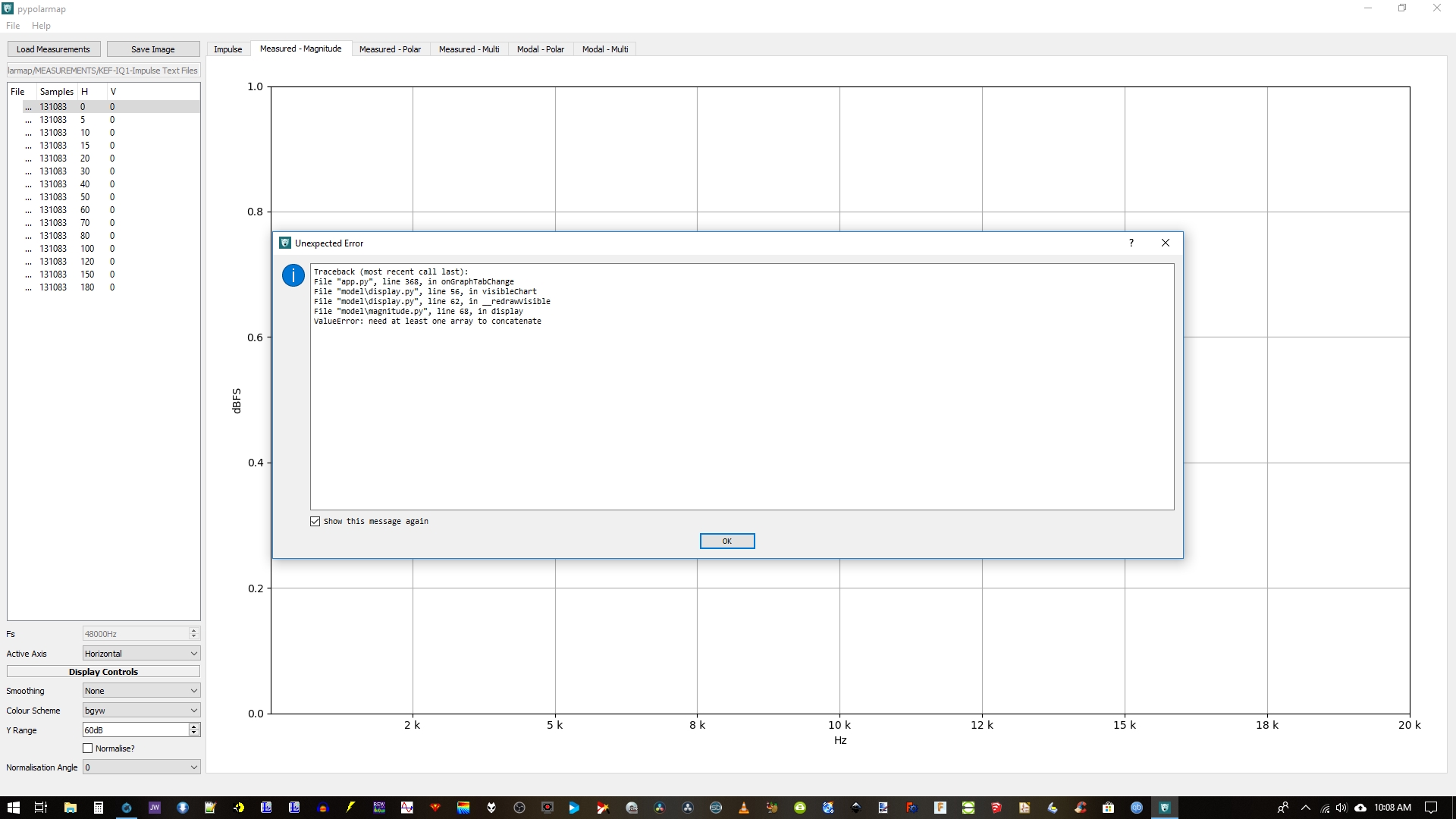

Then what next? The error suggests you have clicked apply window but it is not clear from the bug report
This is what I mean by being specific, literally step by step instructions 🙂
The picture suggests you pressed apply window with the right gate set all the right which means it is attempting to analyse about 2.5s of data which I don't think the DLL handles and so possibly other stuff blows up too.
If so, pull the window in (either manually or using "find first peak" as a starting point) and try again.

Used the installer.
Followed the exact process you list.
Pressed the apply folder.

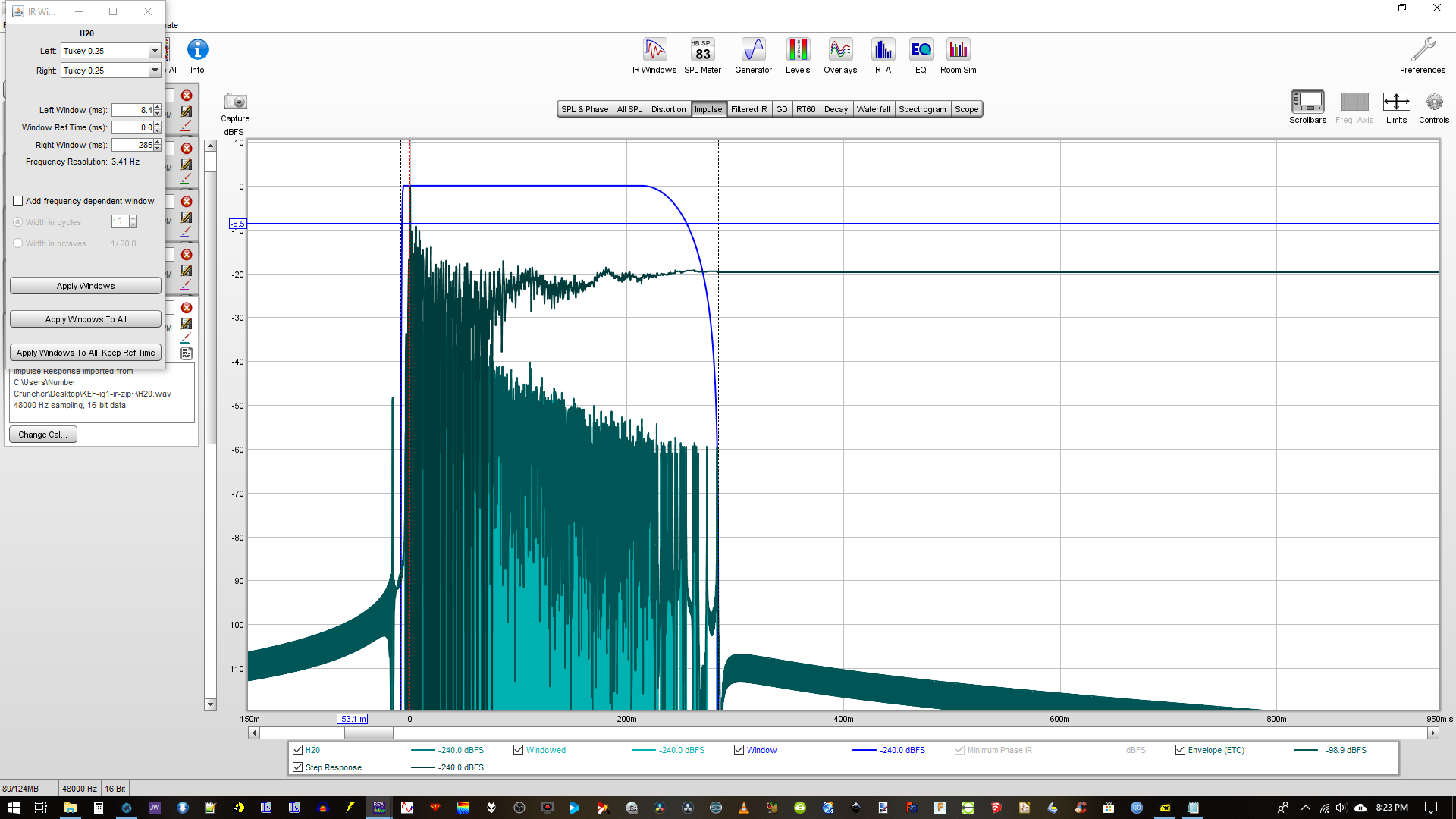

That's what I did. The impulse in this sample set is pretty dirty.
Literally gated 7 to 9 Ms before the impulse and an average of 280Ms after the impulse. Exported this clipped file as a text impulse file and that is what has been uploaded.
