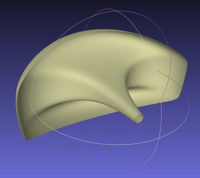

With a selective laser sintering (The minimal quality IMHO) this part cost :
5246.47€ white
6482.90€ color
7472.05€ color + laquer
X2 if you need two of them, you must also raise the thickness of the part to be usable, it will increase the cost by a factor of x3 to x10 (you can also buy a lot of things with 140000€).
If i can help...

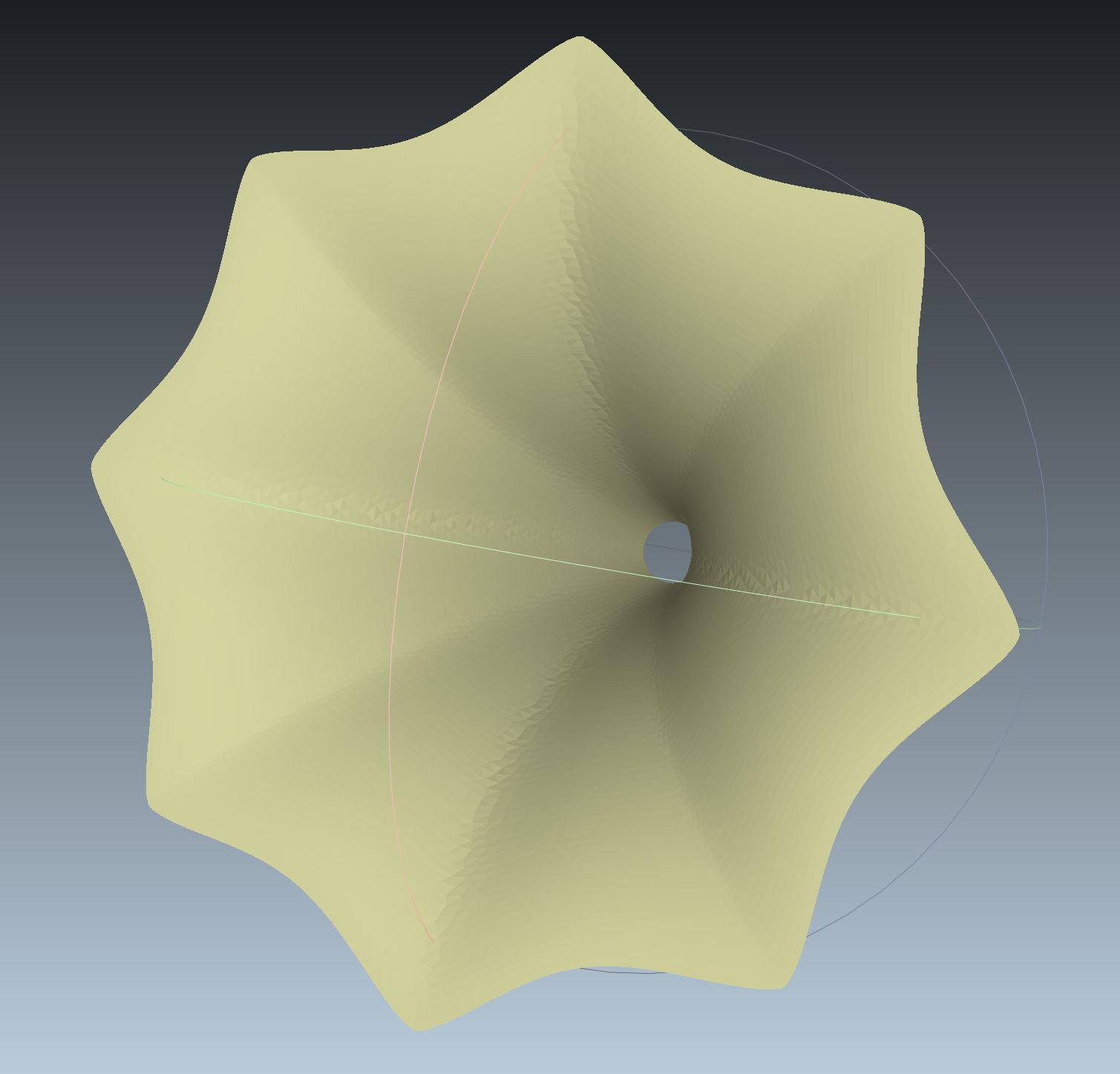

Try i.materialise.com, I bet it will be cheaper. However it would need an enclosed volume model and not an outline. Even completely closed (capped off top and bottom) still is much cheaper at just over € 1000,00 so printing the real deal would be way cheaper than that, due to less enclosed volume. But it needs a volume model to work. It needs a real thickness to it that exceeds the minimum allowed thickness of the material you want to use or more (if you want a usable product).

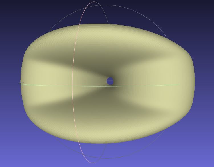

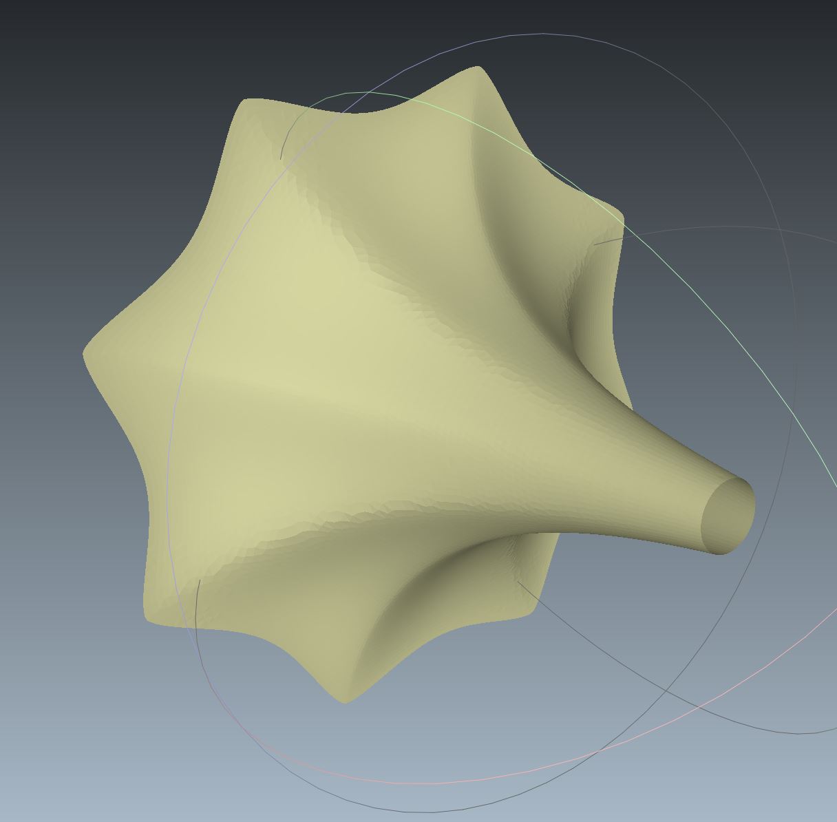

What I forgot to mention. The original profile has an intrinsic roll-back. Of course, this can be done also here. The following pictures were calculated until the original maximum outer extension of the profile:

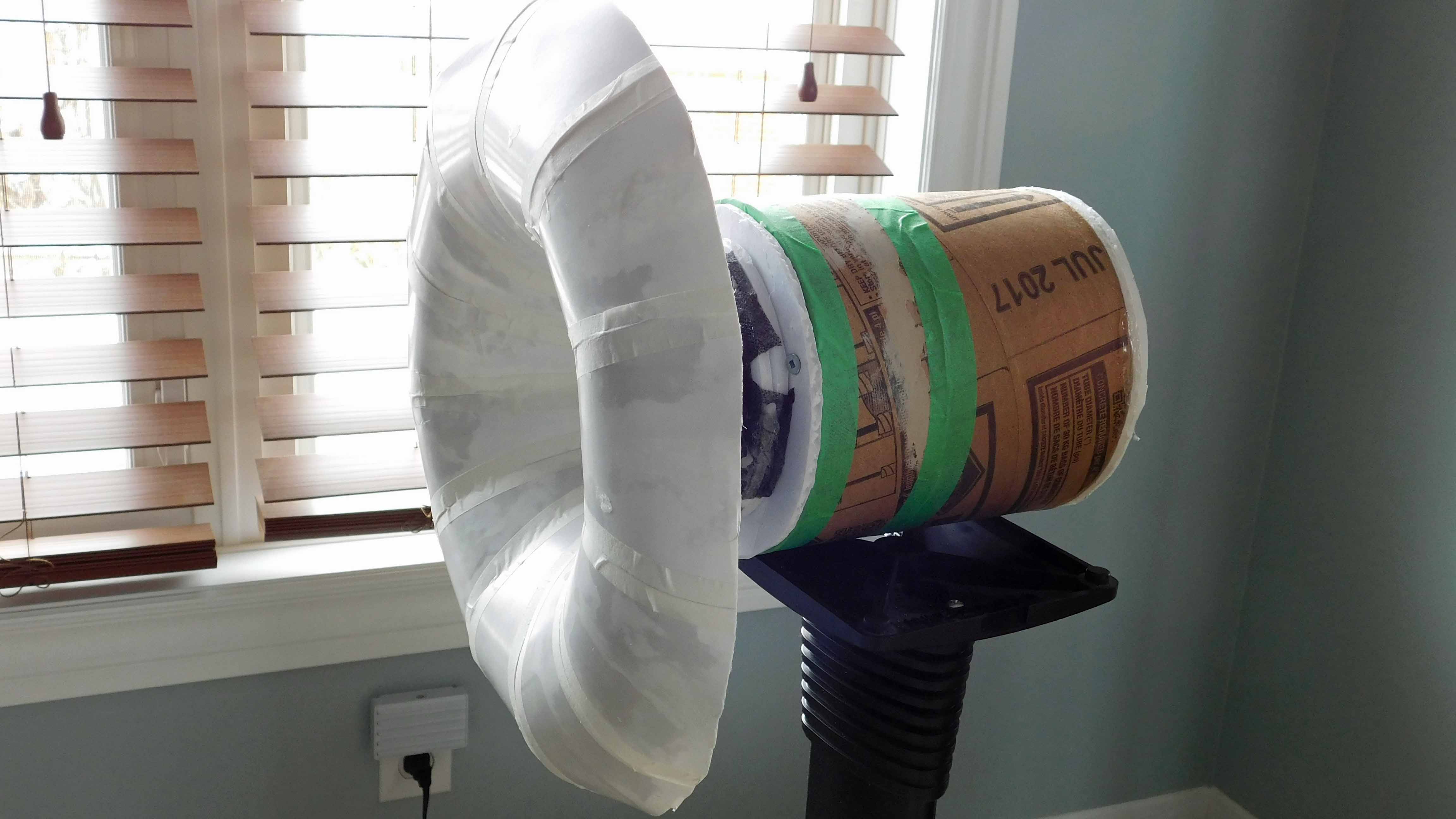

It looks more organic (better) with the full roll back. I can see how that would be very hard to manufacture. Maybe a CNC wood mold and fiberglass mat. You might even find an industrial 3D printer that could make it in sections.
I have seen examples of using a series of contour "ribs" to build a paper mache horn similar to yours. Alternately, the same technique could be used to build a master mold that might due for DIY'ers. Once the profile is built, its easy to smooth and strengthen it.
I think MeshLab and MeshMixer are able to "bulk up" a surface mesh STL for actual printing.

In my experience the best method for this is Blenders Solidify modifier. My calculator has already incorporated an material thickness parameter that works together whith "even thickness" in Blender.

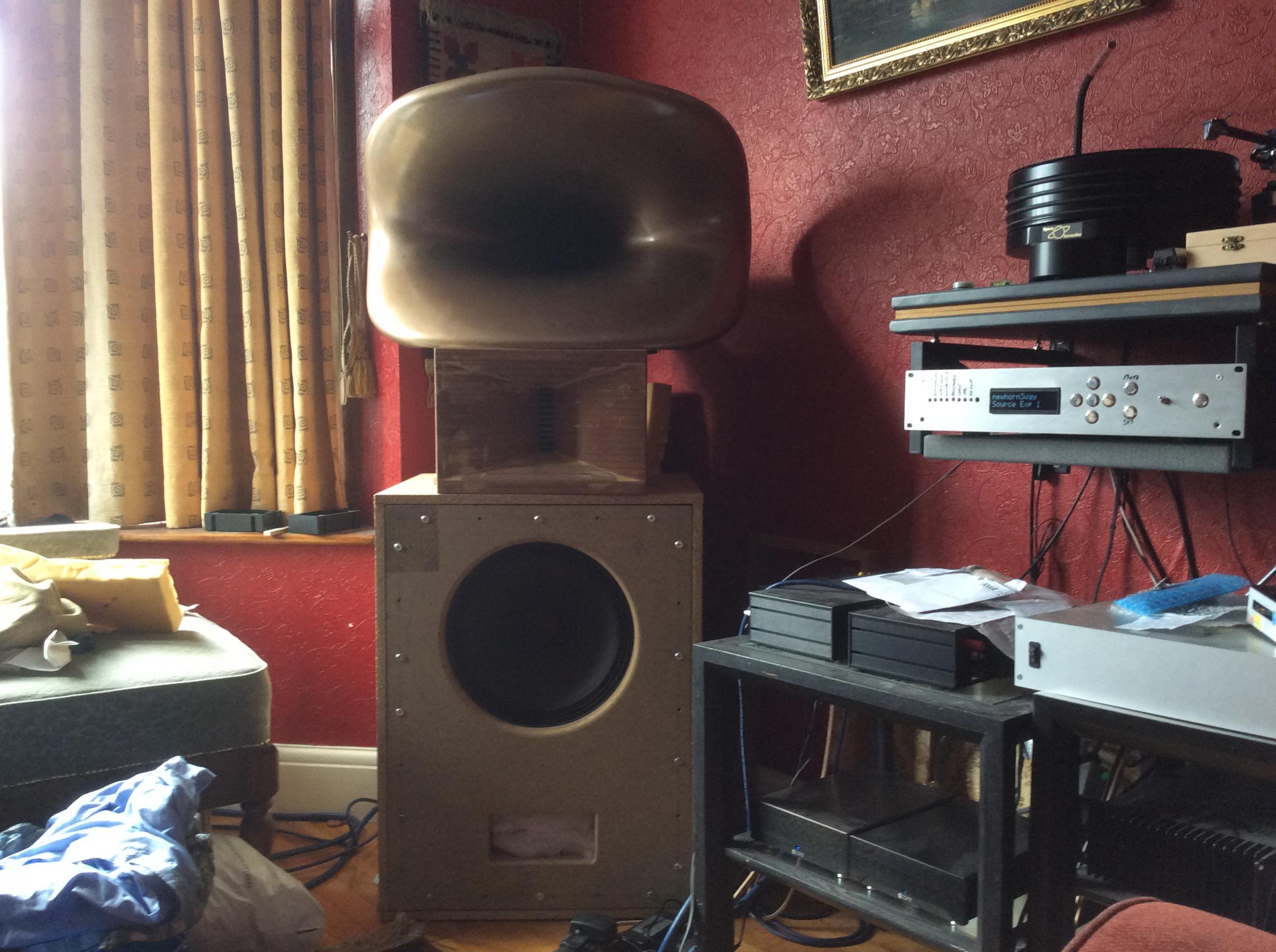

3D printing is one option, the approach I used for my latest horns was to cnc machine them in layers from birch ply. I want to try a SEOS type horn next with my JBL 2482’s.
Very nice project! Thanks for sharing. What is the weight of one horn? This looks like the JMLC Iwata horn.

I published an article on how to make horns out of paper about sixteen years ago, but I mostly do 3D prints now because I like asymmetrical horns.

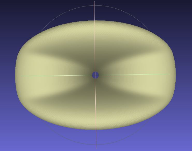

Asymmetry was one of my main motivations either to break symmetry and to favour the hirizontal plane.

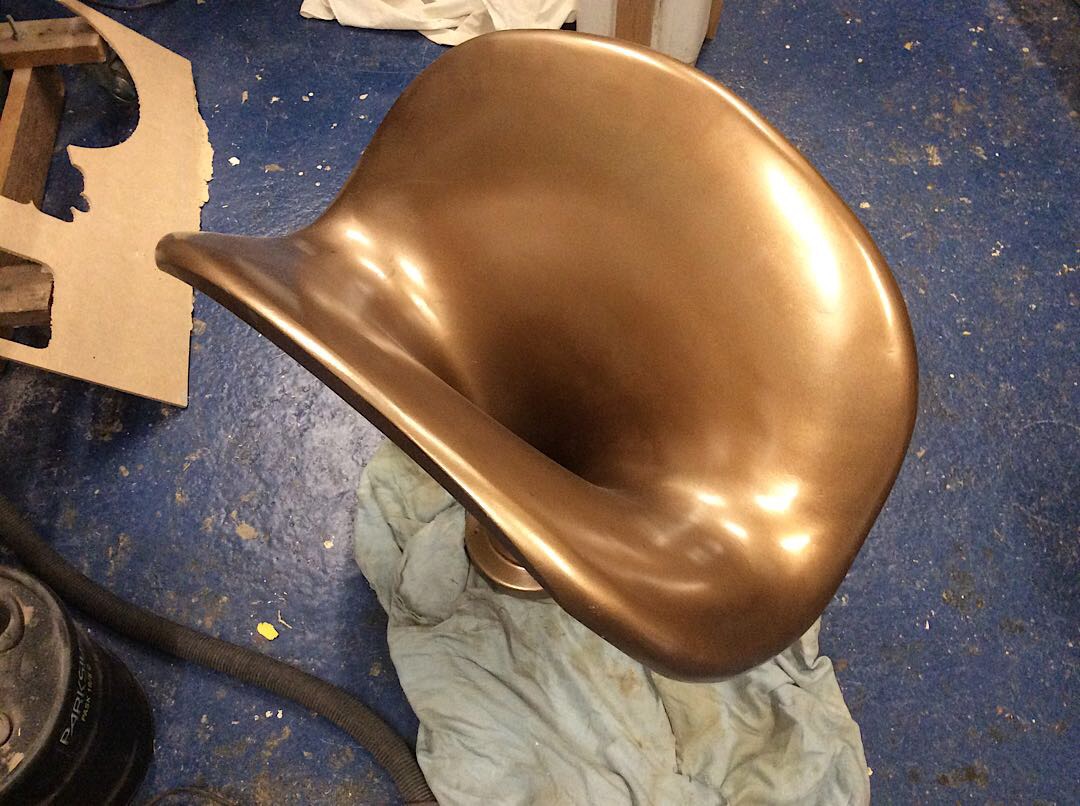

Speaking of gold, the material of the previously shown 3D printed Tractrix horn is Ice PLA, colour "Glamorous Gold".
It was printed with an 0.8 nozzle and some PVA support.
