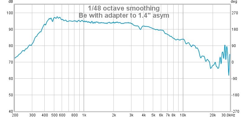

It's kind of funny, the way we are concerned with driver exit and (horn) entrance angles.
Faital Pro uses the same horn (LTH-142), for the measurements of all their 1.4" drivers.
The exit angles of the conical adaption horns range from 6° (HF141 & 143), 7° (HF140), 12° (HF148 & 1400) to 29° (HF142, 144, 146).
Try to look for clues, it's mesmerizing.
For horns with a relatively low flare rate - like the LTH-142, I don't think the exit angle matters all that much. The phase plug design however, does.
I owned and sold Monacor branded samples of the LTH-142. It's a nice horn, but undersized (like most PA-horns). Compared to the XT-1464, the LTH-142 is subjectively more prone to beaming, even though the graphs may suggest otherwise. This is inherent to the Tractrix horn contour.
It's good to see docali working out somewhat bigger horns > 50cm mouth width. This appears to be a critical size, once you go beyond 50cm nearly all types of horns/waveguides really start to show their merits.
I think too that the exit angle does not play that important role. But maybe it is not a so wise decision to use the mentioned 29° exit angle with a long horn. I would assume that such drivers work better with short horns or a waveguide.
I compared the LTH-142 and XT1464 with my large format 18s driver and found that the LTH142 looks more smooth but the XT1464 can go lower and loads the driver better. But both are terrible plactic bombs. I have already seen a 3D printed WE clone in Munich high end show done by Azzolina. These horns felt similar to wood and looked awesome. But is would be quite expensive to make a larger horn.
Size in no limit for calculations but you need a good printer that could print such a large thing. For my 18s driver my target cut-off is 350 Hz.

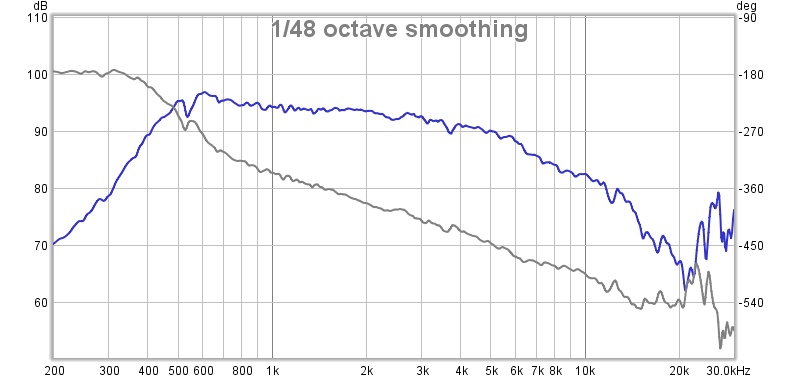

These two smooth profile horns inspired my work. Despite the often found diffration slots or throat discontinuities these horns show that it can work without such things:
The measurements were done near mouth slightly asymmetric. If the mic is placed to some greater distances we see of course the beaming effects and the transition is not as smooth as seen here.

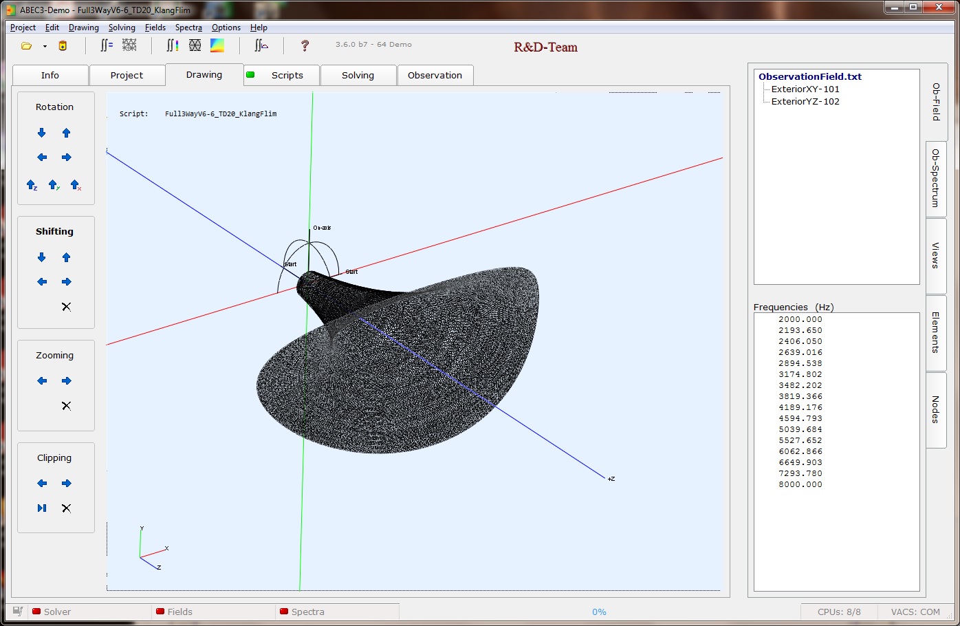

If you have mesh files, why not do a few acoustic simulations (ABEC3) to verify the design before printing.
Yeah! Very good point! I simply do not know currently how to do that and my time went to 100% into the calculator. What do you need with mesh file - an STL?
Can this software simulate horns with bended mouth areas (which are not in the same plane)?
It's 3D BEM, so any design really.
The design file, in order of preference is [step, msh, stl]. I think providing just a design file should still protect your intellectual property (VBA).
If you're interested, post or PM, a simple design file and I can check its suitability.

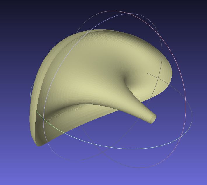

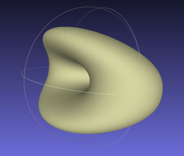

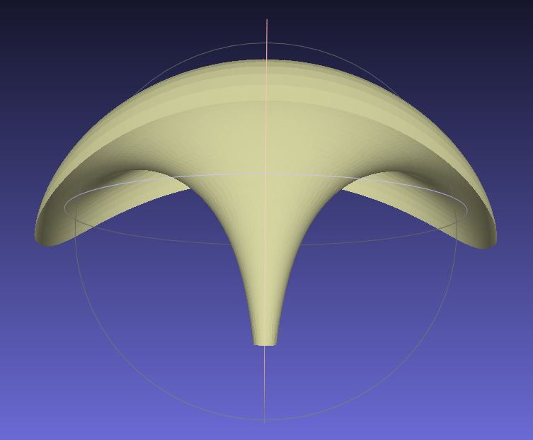

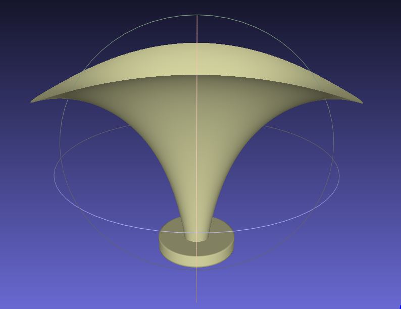

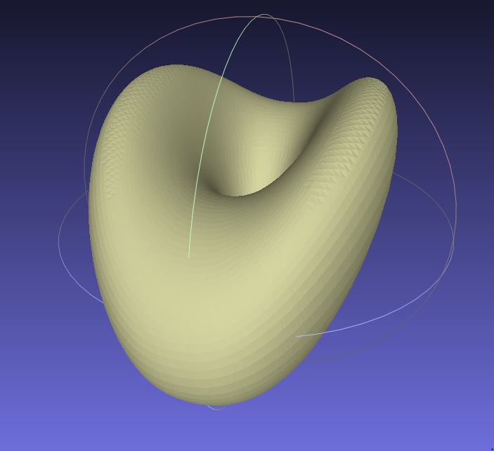

But I would like to mention an important point. All the benefits that will ever come out of this project will be directed to organizations which support children that suffer for cancer - either research or for care and nursing. For every printed copy a donation has to be made. I will do the same. I currently have to think about how much is appropriate. Any suggestions?

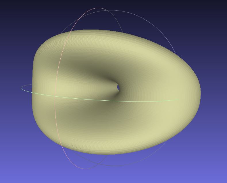

Here is an STL with 425Hz construction vector:
View attachment DRBA_EP_425.zip
It sounds like a very worthy cause.
The design is large with 8016 vertices, and 15490 elements. Can you generate a simpler model with < 5K elements for a test case?
How big is this horn ? Axial length?
No problem, only two different settings in the sheet:
View attachment DRBA_EP_425s.zip
The coordinates are mm:
xamax ybmax zhmax zhmin
21.3mm 11.1mm 26.5mm 19.5mm
xa and yb are major and minor axis.
The transition from round to elliptical is a key factor. I used different functions for this and choosed the best looking. Let's see if everything was for the waste basket ;-)
This particular horn has 305mm depth, 516mm width and 256mm hight and without stereographic projection.

I'm unable to enter a list of very simple conical coordinates as you can see :scratch:
https://www.casimages.com/i/190310090133127823.png.html
ABEC3 is a wonderful tool hampered by a lack of good tutorials. It requires alot of persistence to deduce how it works.
I'm still working on the sim. It's partially working. There is of course the subdomain problem with declaring where the mouth of the horn is. Usually it's regular geometry, but not for your horn :)
I'm very interested in modelling this complex interface boundary and still have several ideas to try, but they all take a little time. Patience.
