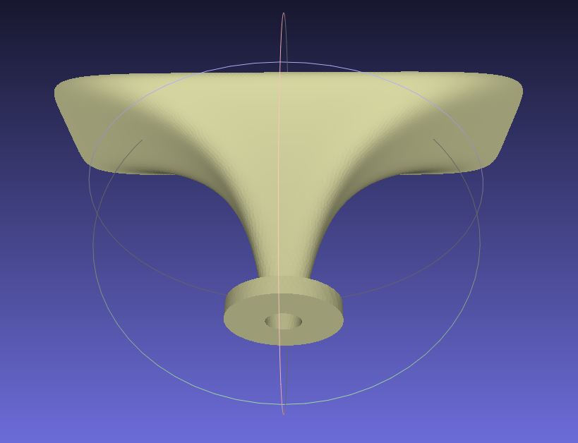

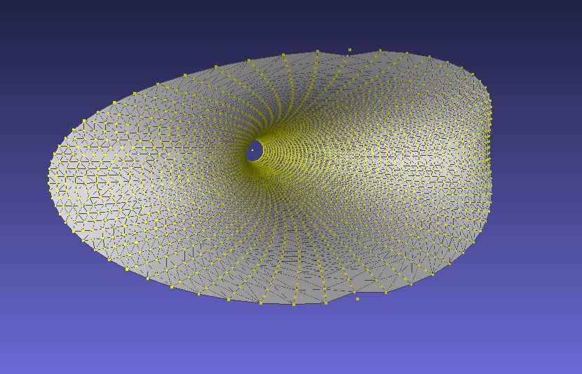

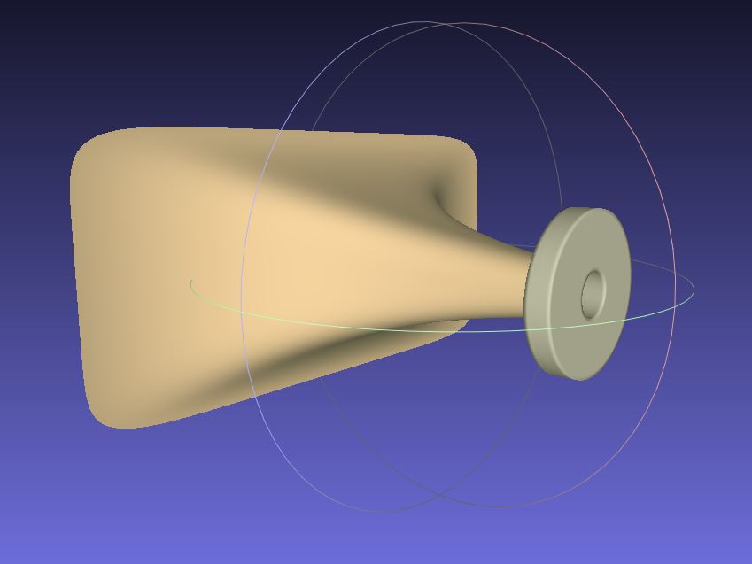

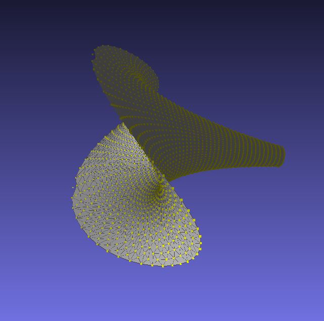

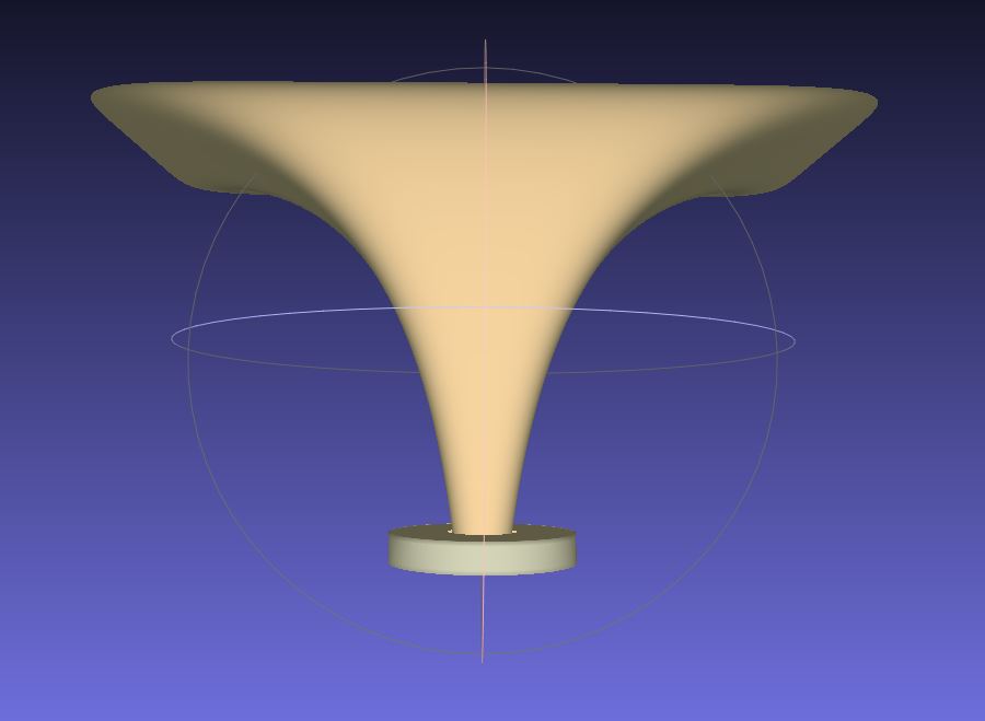

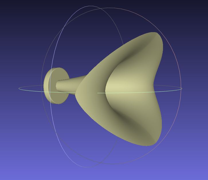

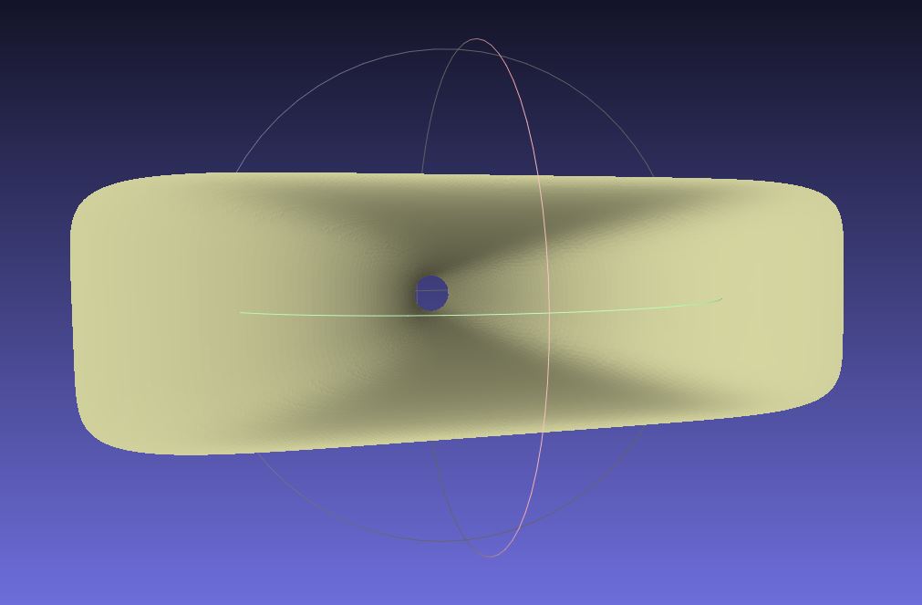

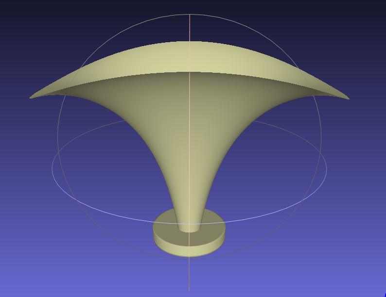

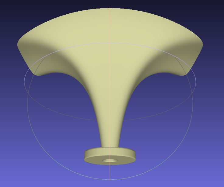

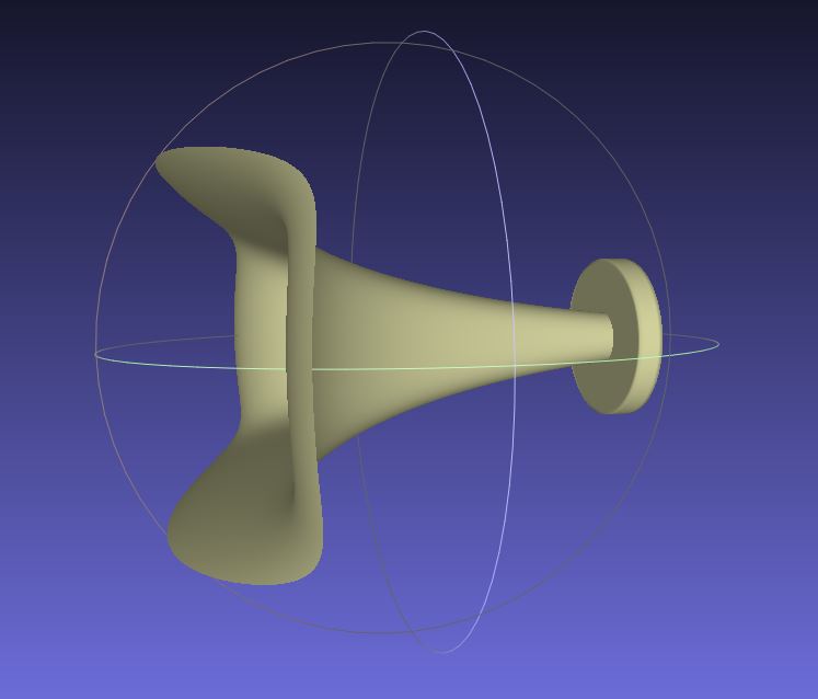

Klangfilm spherical wave horn calculator - from round to elliptical

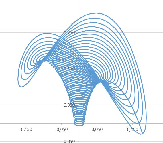

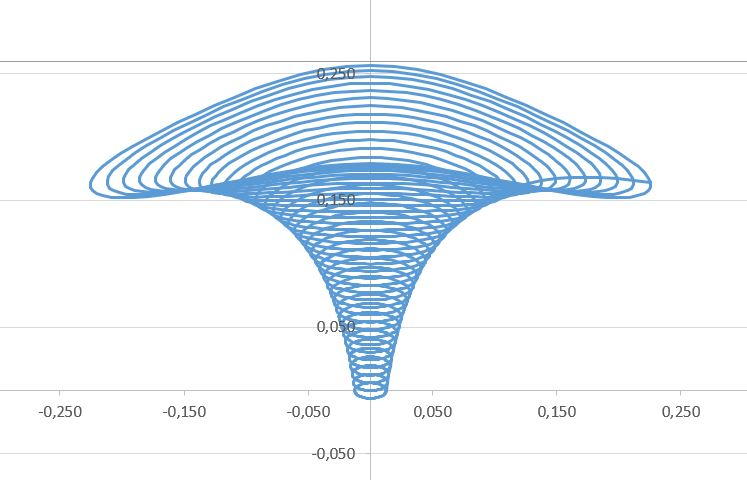

I have done some further modification options of the profile following the underlying concept.
Usually, such horns have the property that for the expanding profile all points along the horn axis of the outer shell are oriented in the same plane where at the mouth the horn is flat/flush to the speaker front/plane. I thought some time about this and found several options how the profile can be bended using the original Klangfilm construction vector r0.
The following three variants use different assumptions:
1. For every elliptical plane along the horn axis the origin of the construction vector is calculated. Then for every point of the ellipse the vector from this origin to this point is used, it's length is calculated and then normalized to r0. Then the ellipse point is slided alog this vector until the new vector has the normalized r0 length. So, the points near the major semi axis are shifted against the throat and points near the minor semi axis will be shifted in the opposite direction.
2. The same construction vector is used but only the z-component is used to shift the points.
3. The angle of the construction vector is changed while leaving it's length at r0 so that it ends at the elliptical cylinder. This only changes the z-component which is the horn axis. This option leeds to some dramatic looking profiles.

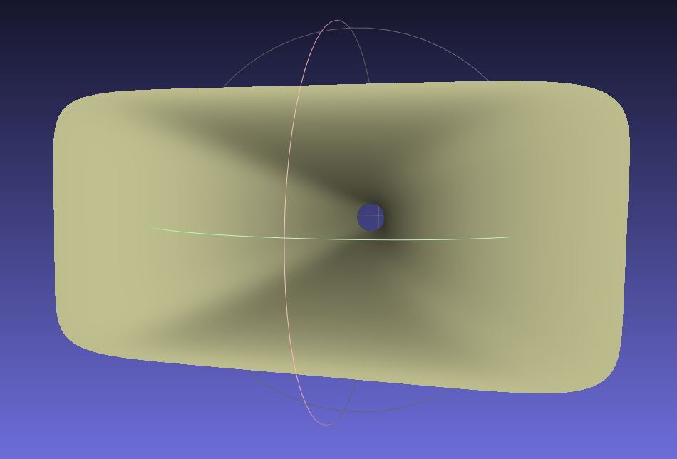

Hi!
only a small teaser what will be possible with the forthcoming version of my calculator. From round to elliptical, from round to squared or rectangled, projected or not projected, nearly everything is possible...
3D printing of the first horn is in the preparation phase.

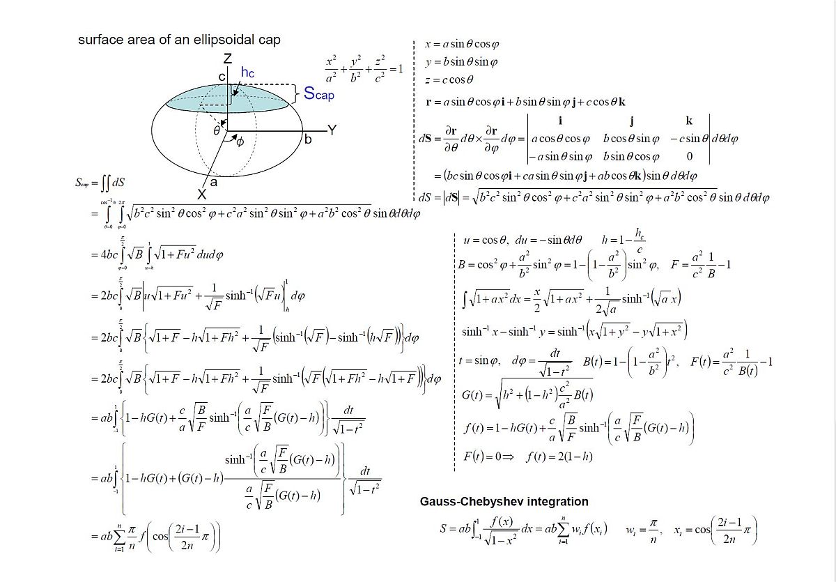

Currently, I need first to verify my concept by print out such an horn and do some measurements before I will make available my calculator. Additionally, I need to protect my work in some way but not with a business scope in mind. And I want to keep some basic control. As i have done it in Excel there is no way to protect the code.
The math behind some steps is very complex like the numerical integration of the tri-axial ellipsoid surface cap. And it took a long time to make/normalize the stereographic projection work properly.

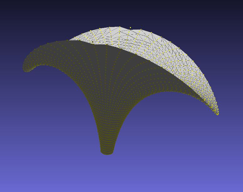

Furthermore, very much effort went into the creation of the point cloud which can be extracted automatically for Meshlab. For this the arc length of yh need to be numerically integrated and several other function for surface areas and arc lengths. The horns shown at last here were created only by changing 2 or 3 parameters in the Excel and only about 5-10 minutes in Meshlab to create the STL files. Also a material thickness could be incorporated for the use with Blenders Solidify algorithm.
I have some limited feedback from some people and this could open a complete new class of horns if the concept works.
My skills about 3D printing are still very limited. But an error free STL file should be a good start. Also the material used will be very important. But we this new industrial revelution of 3D printing and everything here is developing fast. So, maybe in a very short time we will be able ti print something that feels like wood and behaves quite similar.

But if you want better prepare your own calculation sheet this is highly welcome. What I have learned is that at first you need a good idea what to do and then how to do and then how to verify. You may need some advanced mathematical skill also. If you have all of this then you also need programming skill. My code has currently about 2000 lines only for this limited scope. So, it is not really an Excel sheet that does the caclulation. Excel is only used to store data and to visualize.
My experience with STL files is that you need quite evenly spaced points. This is a real challenge with some complicated functions and this fine tuning took more time than the horn profiles itself. You have to do a lot of transformations between cartesian and polar coordinates to be flexible. Integrations are often better done with polar coordinates.
Only to give you an impression look here:
https://keisan.casio.com/keisan/image/surface%20area%20of%20an%20ellipsoidal%20cap.pdf
If you understand such math then you are encouraged to proceed.
