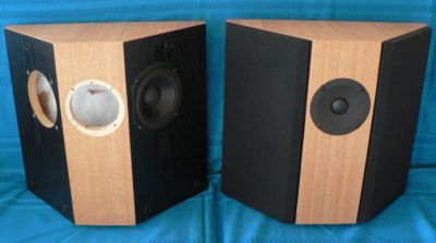

I was always planning to bevel the left and right edges of my baffle. Would cutting small strips for the bevel work, sanding the edges to get it to blend?
I've seen people veneer over baffles with curved edges, it looks quite nice but I am a fan of sharp angles.
Yes, that would work. Veneering would start from the sides and work to the front so the previous edge is covered by the later veneer.
The pic shows bevelled veneering but with wider strips but the result is the same with smaller widths.
