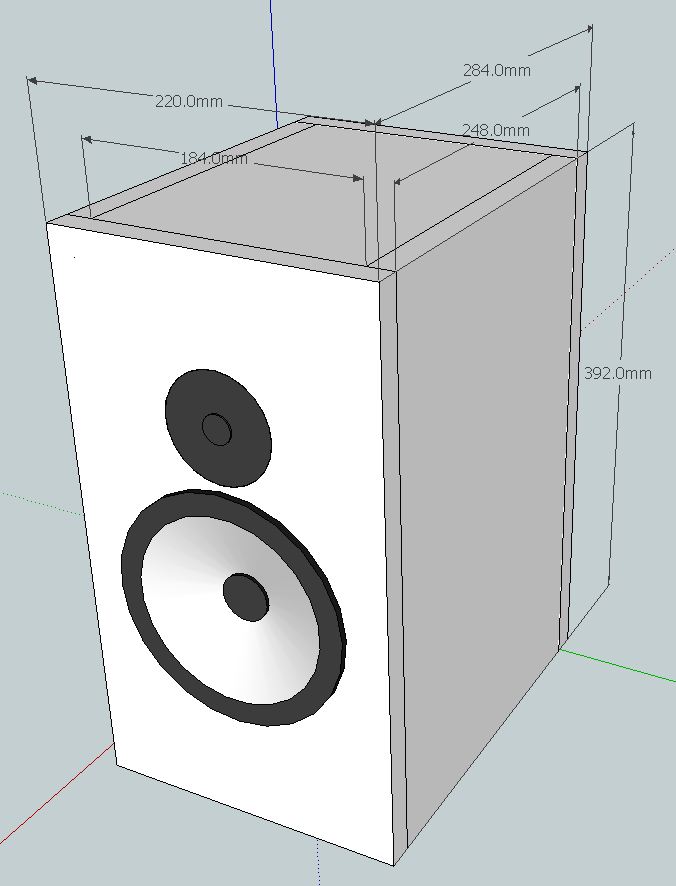

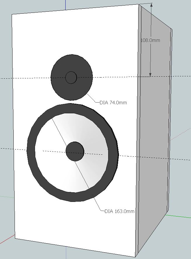

How does this look for a preliminary box design.
I followed the advice in post 375, it was done very quickly though.
I'm not sure if I have correctly positioned the drivers. I left the centre of the tweeter the same height from the bottom of the box, and then placed the driver fairly close to the tweeter.
Not visible is the port on the rear of the box, 51mm x 174mm as calculated previously in the thread. I will also follow the bracing advice specified, I just haven't shown it in the design as of yet.
The wall thickness is 18mm in the diagram. Internal volume is 16 litres from my calculation. (excluding the space being taken up by internal components)
I have also made the tweeter flush mount into the baffle, where as the woofer is just sitting on top. I have seen many speaker designs that do this but I do not understand why, is it simply a cosmetic decision?

Looks fine. The tweeter position needs to suit the top of the box so just change the tweeter height from 108 to 86 and the centres between the drivers at 125 max. That should leave about 7mm between the tweeter and woofer flanges and if you want to move them closer or even overlap (have a look at my little grey Raptor speaker) the driver centres reduce accordingly.
I did a sim on my other software and the port can go down to 51 x 144 long.... I don't trust the values from WinISD. Start off at the 174mm and go from there.
Flush mounting the tweeter is the right way to go and flush mounting the woofer is not necessary. Not flush mounting the woofer is easier to build as you don't need to do a rebate but only a hole (make sure the back of the cut out is chamfered as shown in the drawing). It also slightly helps with horizontal offset (driver acoustic centres) but the amount is insignificant but every little bit can help.
If I overlap drivers so I can get closer centres then I don't rebate the woofer as it sits over the tweeter flange by 5mm-15mm.
Cool thanks.
I've moved the tweeter up to the correct position, I'm just looking at pictures trying to determine whether I like the look of having the woofer overlapping the tweeter flange, otherwise I'll place them so that their centres are no further than 125mm apart.
I didn't even pick up the chamfer on the inside of the woofer cut out, thanks for pointing that out.

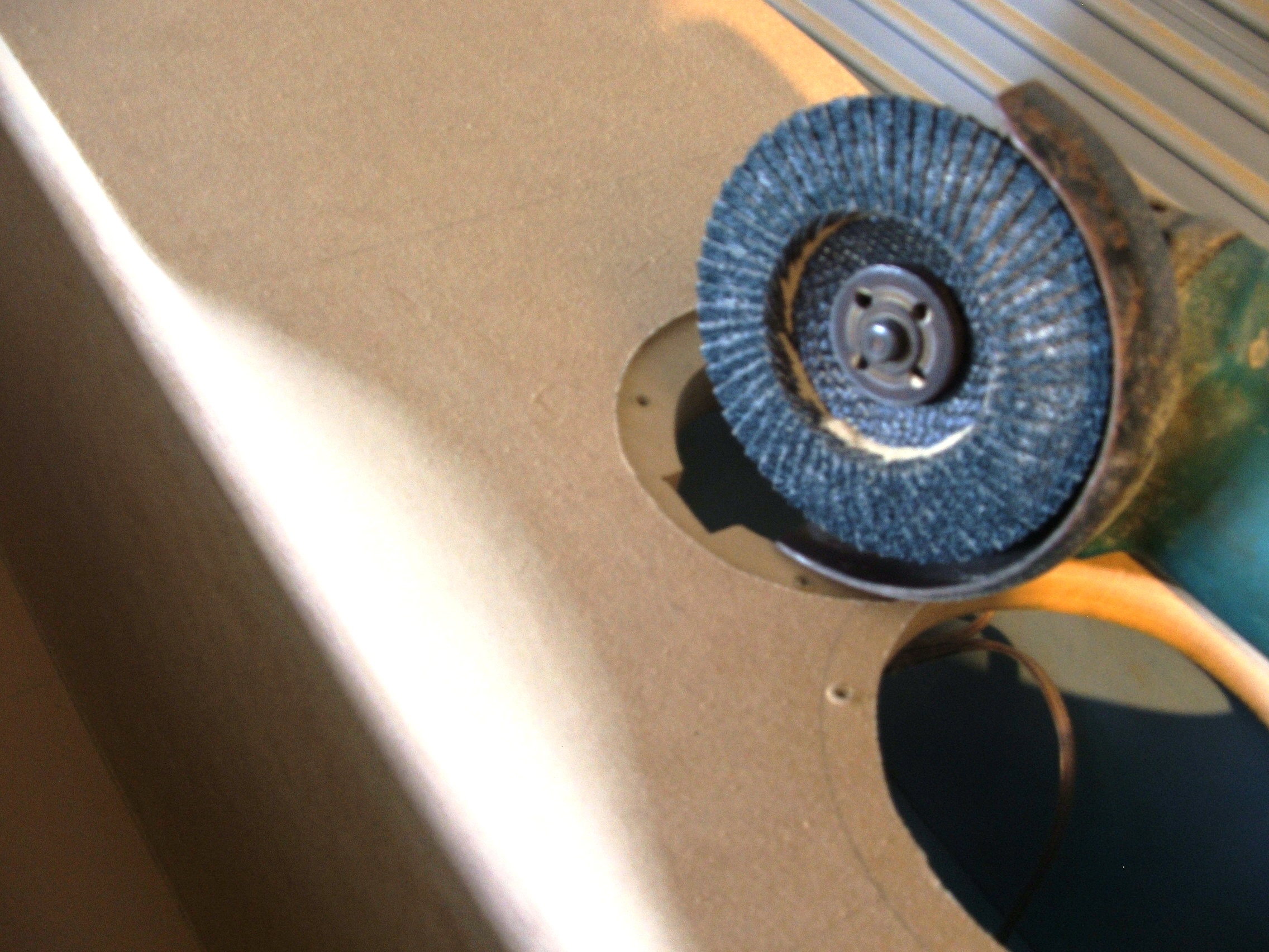

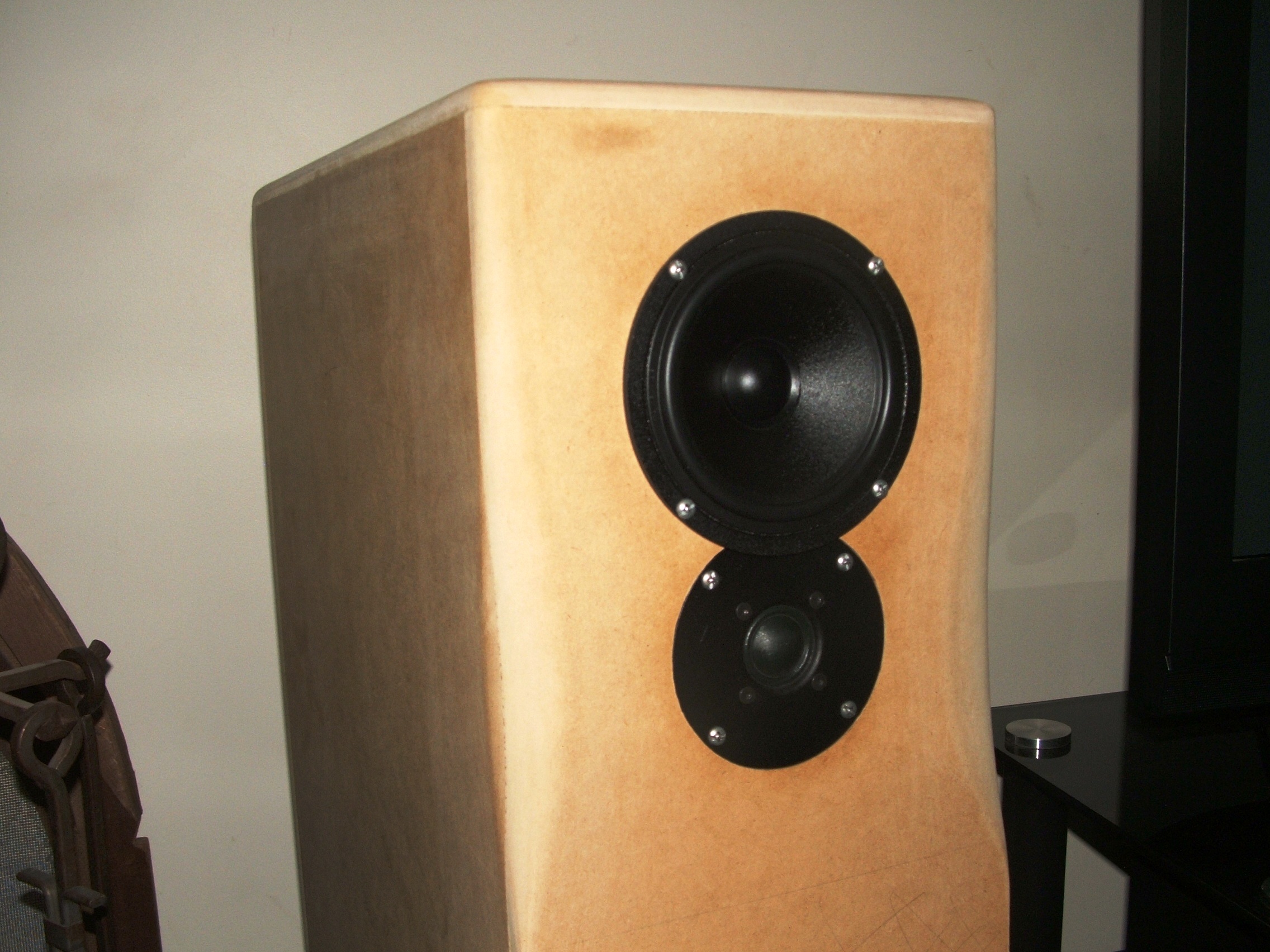

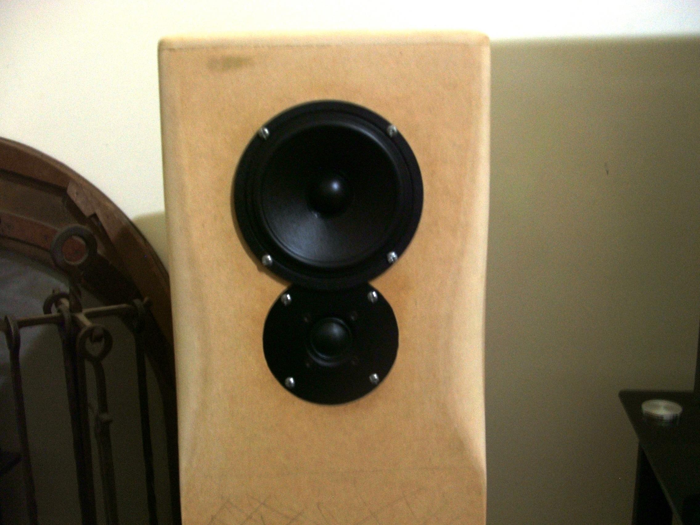

OK, I have recessed the p13 into this piece of 12 mm mdf as per link, (Thanks Rabbitz). Physical alignment is much, much closer. Basicly, I've tried to limit the amount of diffraction sources focusing on any particular freq. whilst keeping a close centre to centre, and as close as possible pysical alignment.
Alot less sound smearing, some sounds that were only there before are now pin sharp, sounds like you could fit a heap more sounds into each tiny piece and there's tonnes of room left over.
The diffraction I was hearing is less annoying now, it's not gone, in fact, if anything off axis at some angles its a little worse I think, but better overall.
I think what I was hearing, was the rim of the p13, coloring it's own sound rather than the sounds from the tweeter.
The biggest difference? Those hissing esses are much, much smoother, If anything can trip up a pair of otherwise nice sounding speakers, to my ears, those damned esses will do it.
This modification has improved that side of it out of sight, so for me they sound FAR more natural.
What can I say, I reckon they look better to boot!
