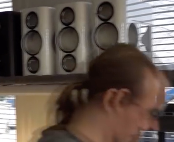

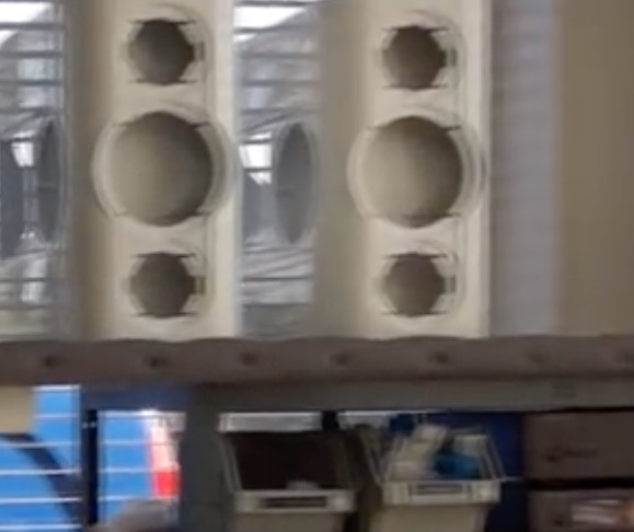

Let me share a "secret" I found from a video interview with Bruno, I could spot something quite interesting from production of the speaker. It looks like it has two Seas DXT??? The lower one is hidden behind the grill cloth and badge. Here are two "frames" from that youtube video. You clever guys, please explain this to me

But I have some serious doubt that there is an actual active tweeter mounted in that second hole. Why would they?

I agree, why two tweeters? But then try figure out why they would make an extra hole in the cabinet, put on a gasket, and from the 6moon picture, I can even se a loudspeaker wire in that hole?
Perhaps they had an idea about a certain industrial design at some point during development and then they changed their mind, but they didn't want to change the tooling for the cabinet so they just found a way to cover the hole? Things like that happens all the time in product development.
Now what if they didn't put a speaker in that hole but instead put a microphone there, now that would be interesting
Looks like they made the halves symmetrical so they only need one mould instead of two. Besides that they can user the hole for the wiring. The hole is covered by an aluminium plate, not by fabric.
This!
Very clever design.
Exactly It's clear to see the wires in the top hole is for tweeter, being two seperate wires for + and - with the red crimp shoe easily seen. Wheras the lower hole has a single plug, that fits the lit logo and maybe the IR remote eyeIt's just the wire for the lit logo I think.

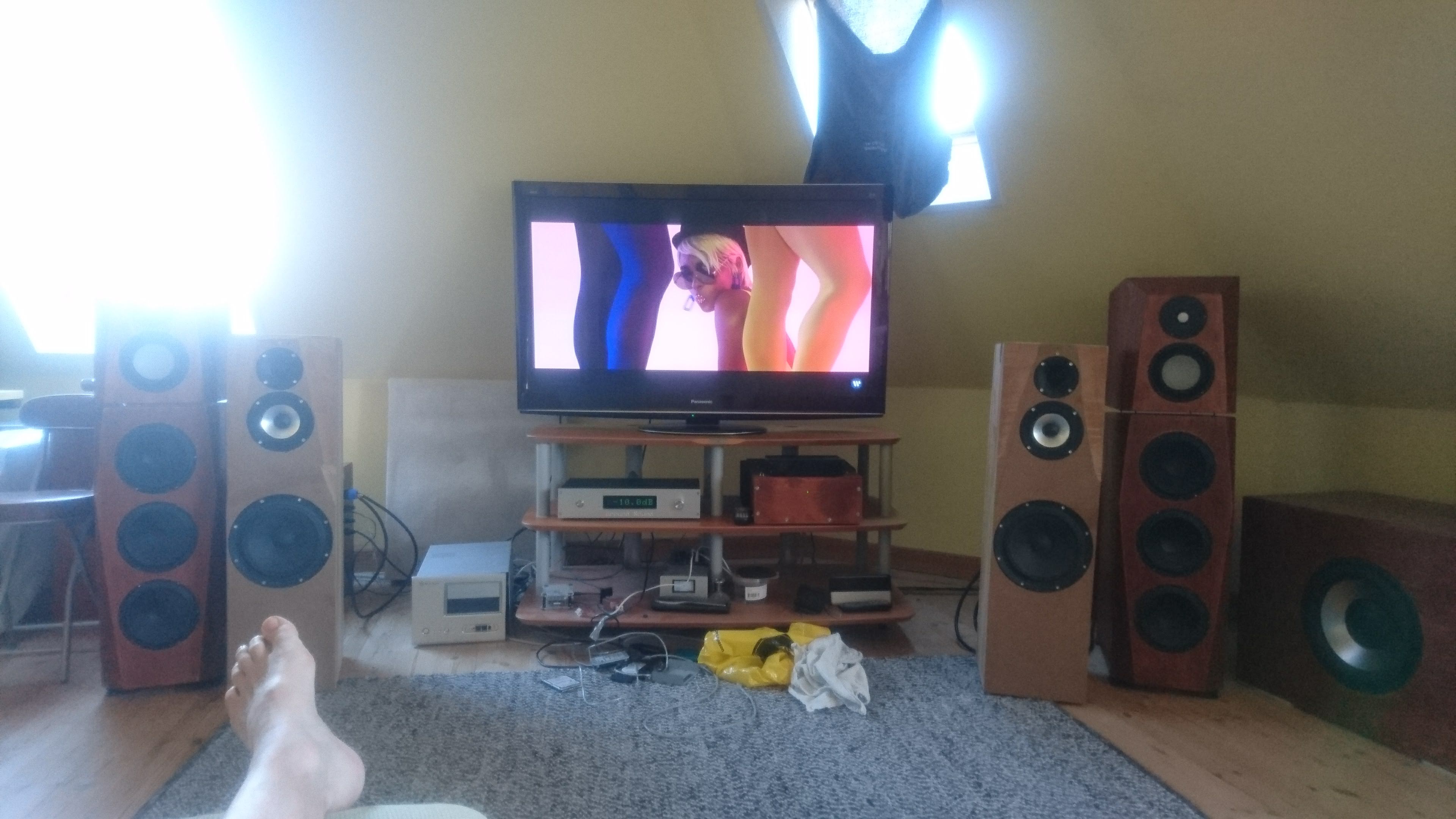

Build some speakers with the DXT yesterday:
The midrange is a 5" from acoustic energy and the woofer is SB23NRX in 30 liter closed with a HP around 50hz - cant take the beating down there.
Then 4 x 12" XXLS for subs.
Plays nicely here
I tried to mimic the baffle cut with a handsaw like the designs on Heissmann acoustics. Measures pretty well and sounds great.
Still need some tweeking - but they are 1 days old... needs care and nuturing for a week or so, to blossom
