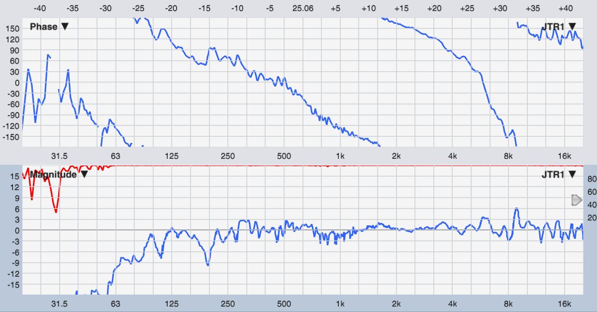

Ok, same speaker with passive xover,
with a regular dsp albeit one that has a small linear phase xover capability ,
and with dsp using FIR.
Speaker was a JTR 3TX.
Noesis 3TX
Uses a BMS 4593 coax on a 18Sound 1464 horn, with two 10" mids/bass below. So a 3-way TMM.
All made outdoors off an open deck at about 4m.
Here's with the factory passive xover.
No smoothing mag or phase.

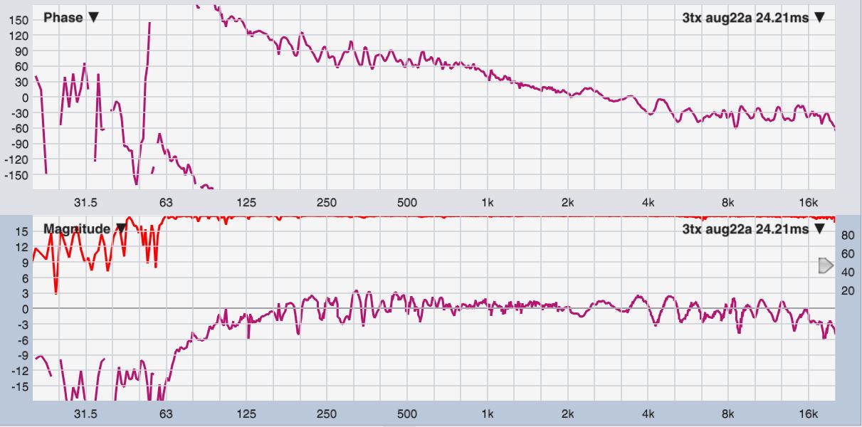

Here's with a Linea Research dsp using IIR EQ's and what Linea calls LIR xovers, which are essentially linear phase LR's 24dB/oct.
No smoothing.

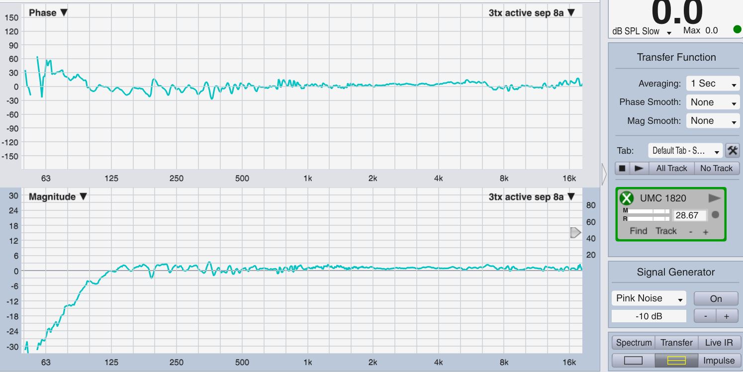

Here's with FIR dsp.
Again, no smoothing.

Well, you are cheating a bit . The last one starts at 63 Hz the others are from below 30 Hz. The last one is +/- 30 dB, the others +/- 15 Nevertheless, the difference is quite clear. One would wonder what could have been done better in the passive crossover. I'm pretty sure there is room for improvement there as well.

Yeah, sorry about the scale difference...they were taken at different times for different purposes, and i had saved screen grabs i can find, but measurements i cannot (to re-scale)
Below 60Hz is immaterial on all.
In use, any of the three xover types would be passing to subs at about 100Hz, with at least 4th order.

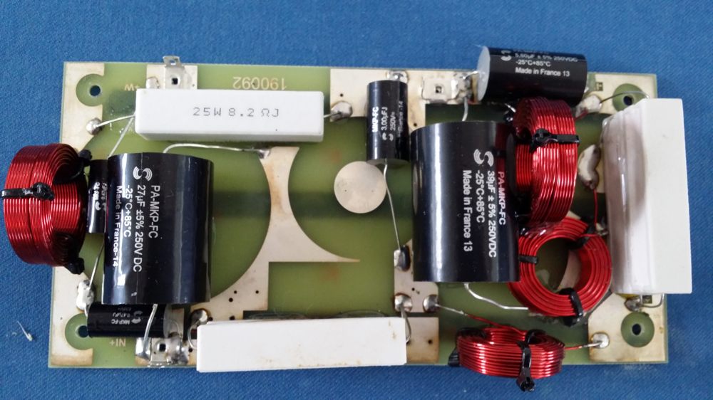

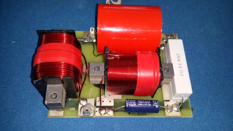

I'm not qualified to assess the passives (and never hope to be )
But they seemed appearance wise to have had a lot of effort put into them.
Big suckers...

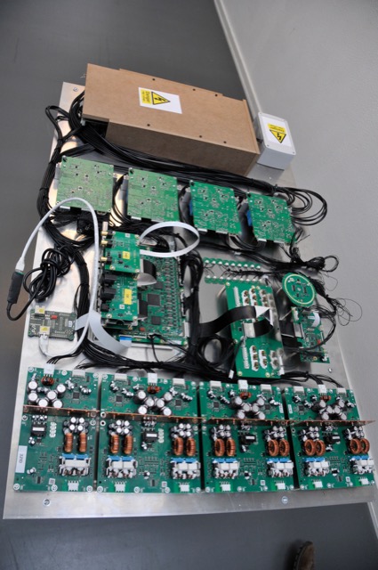

It's easy to put up a counter offer...
B&O Tech: BeoLab 90 – Behind the scenes – earfluff and eyecandy
The entire electronics assembly for the BeoLab 90. The top portion in the brown MDF box is the power supply. Moving down the photo, the 4 PCB’s are the woofer amplifiers. Next are the input and DSP boards. On the bottom are the 14 ICEpower amplifiers. The circle on the right is the light ring comprised of 72 LED’s.
