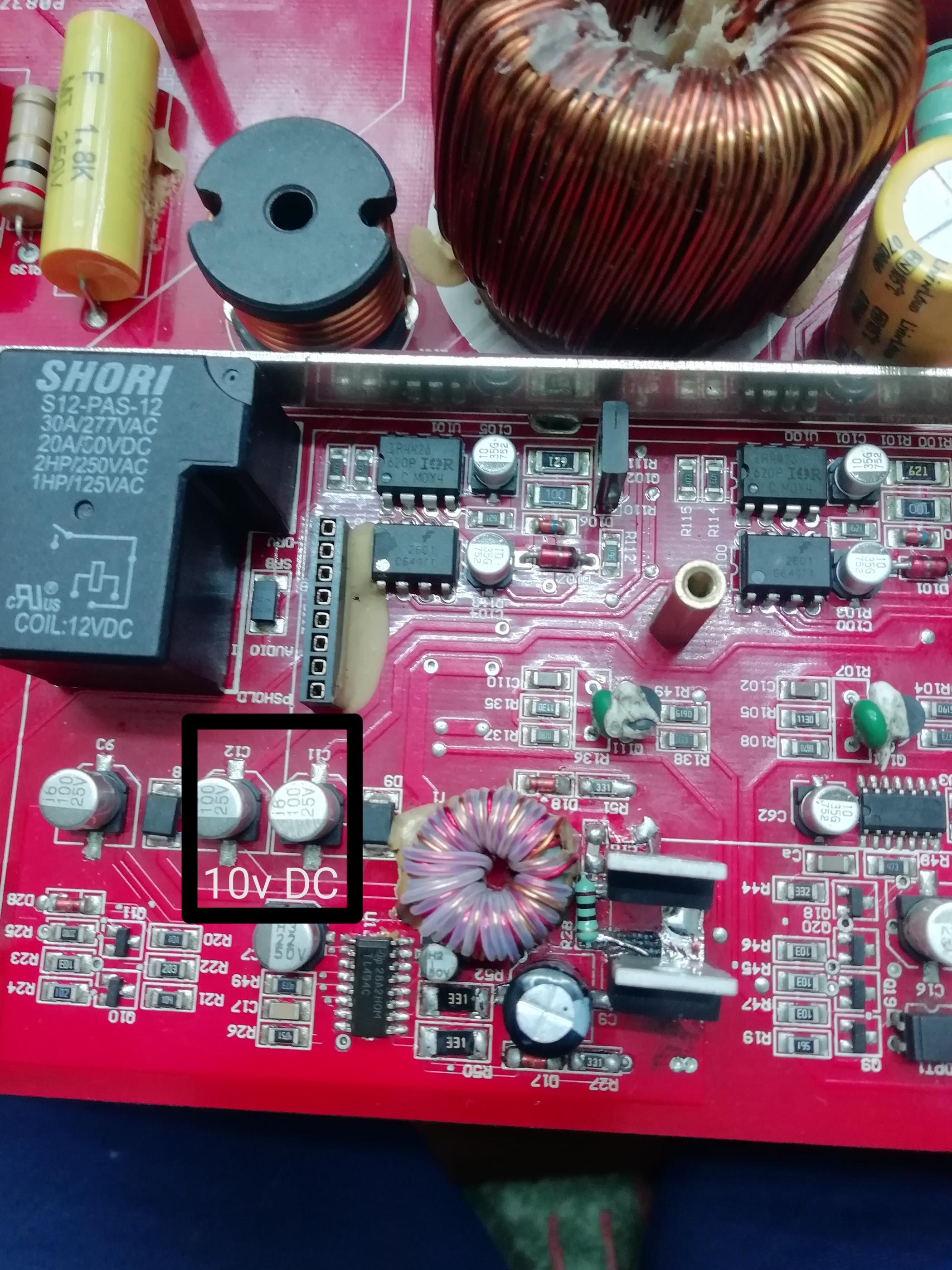

i put irfz46n and it seems to work but i have 10v on c12 and c11. if I measure the optocouplers 2601 I have 4v between pin 5 and 8 of both
What is your input voltage?
Also, did you do as Perry suggested.
The IRFZ46N's may be okay their are under load in real world conditions. I would try to get the P18N06G's.

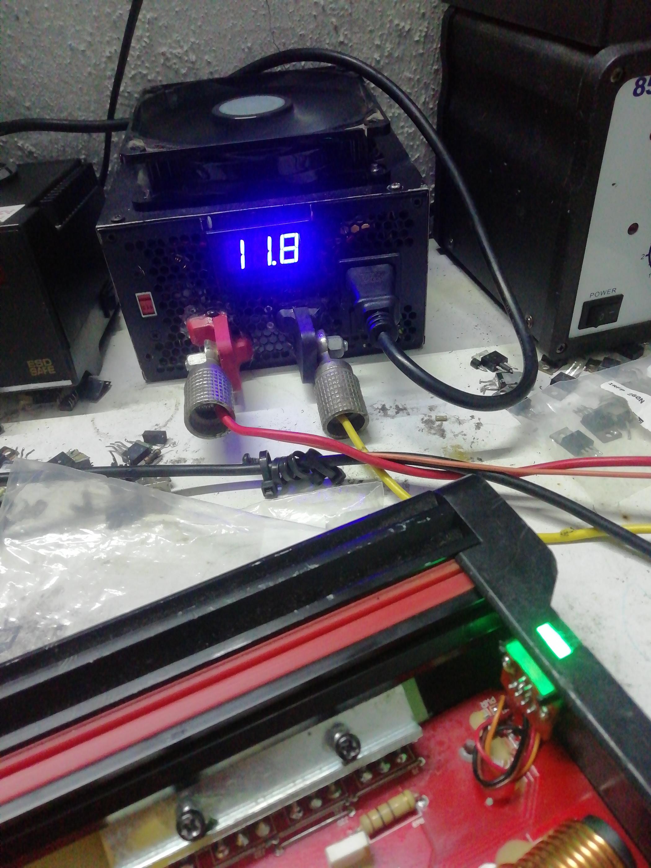

The input voltage is the Battery voltage. Are you using a battery or a power supply, and what is the DC voltage at the Power/Battery Terminal?
When I test an amp I normally have the power supply voltage set to 14.4 Volts. At 14.4 Volts C11 and C12 are at 18 Volts. If I lowered the voltage, C11 and C12 would also drop. When I set the Power supply to 11.8v, the voltage at C11 and C12 was ~14 volts.
I'm not sure why your only seeing 10 volts. It appears that the voltage between Pins 4 & 8 on the optocouplers is good, but low.
Did you say you have Drive and Audio?
If I have the drive on and check the points you have told me and I have the waveform taking horn output signal and putting the positive probe on the points of the drive, what replacement can I use to replace the optocouplers? I can't find the one that has been thinking of 6n137 here?

if I have audio at the speaker output, everything measures well except C11 C12 I have 10v even with 14.5v or 11v at the power input. , I have all the voltages ok apparently +90 -90 5v +12 -12
You mean to say "I have audio at the speaker outputs" correct?if I have audio at the speaker output, everything measures well except C11 C12 I have 10v even with 14.5v or 11v at the power input. , I have all the voltages ok apparently +90 -90 5v +12 -12
You don't need a replacement for U100 & U101. Get the HCLP2061 if you can.
I don't know for sure if the 6N137 is compatable, I will look at it.
If you measure the DC voltage between Pins 5(black probe) and Pins 8(red probe on OPT100 and OPT101 what do you see? D101 and D107-1N4733 are 5volt zener diodes which set this voltage.
I'm not sure why you only see 10Vdc on C11 and C12. Varying the input voltage should vary this voltage.
Please use locators when refering to a part, such as Q100 and Q102. This will help me and others when asking for advice.
ok opt100 and opt101 have 4v, with input power voltage 14.5v, and c12 has 12.4v and c11 has has 104v directly to the capacitor red and black tip with class d drive card installed without the card the voltage of c12 and c11 is 13.5 v with 14.5v at the input of the amplifier and one observation is that at 14.5v the mosfet transistors Q12 and Q13 of the small source get very hot
The attachment shows that the HCPL2601 and 6N37 are interchangeable, so the 6N37 should be a good replacements for OPT100 and OPT101
It's normal for the Q12 and Q13 to get warm, but I don't recall them getting hot to the touch. Changing Q100 and Q102-2SD669 or U100 and U101.
