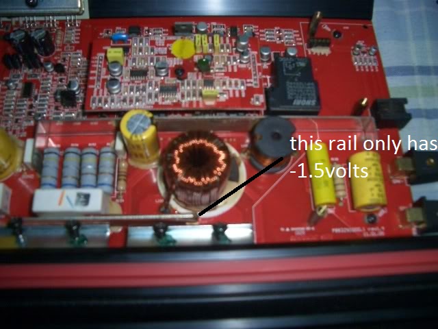

testing the output i have -1.5volts
see the image
see the image
I think that bussbar (labeled as a rail in the photo) is connected to the output filter inductor. If that's true, it shouldn't have any DC on it. When the amp is powered up, does the relay engage?
What is the DC voltage on that bussbar when the amp is powered up?
the relays engage, and the voltage in the busbar is -1.5v, and in the output has the same voltage.
