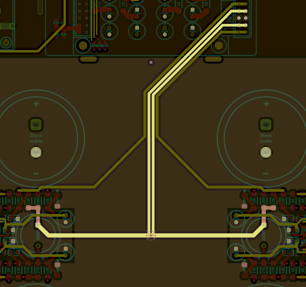

Breaks in the ground plane are placed to minimize shared currents in the signal sections and power sections. If you like, you can lay out a star ground pattern on the ground layer (usually the top layer when through-hole parts are used, or the bottom layer when SMT parts are used) without pours at first, and then add pours to join traces for those regions that can share ground safely so that more copper can be used to carry power than the traces that you have defined. Especially if thin copper such as 1 oz copper is used to save costs, the wider area of copper used by utilizing all of the copper between the components can reduce resistance of the ground connections while still maintaining the benefits of isolating the ground returns of the signal and power sections.
One question, though---will all my efforts to star ground be wiped out by the ground pours?
So do I define a "zone" for each portion of my star ground? My board consists of 8 opamps, and I have routed the ground connections of each opamp circuit together, and then one connection to my power supply ground. So how do I tell KiCad to tie the ground pours (front side and back side) to only connect to the power supply ground at ONE point?

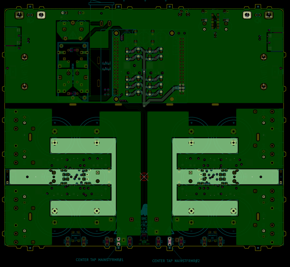

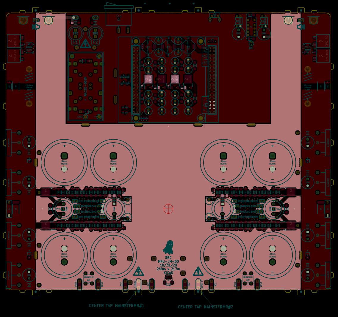

Have a look at the ground planes on one of my 4 layer boards. The main plane is on the top (red), however, on the bottom (green), I tie the bypass capacitors specifically together. The transformer center taps share the same plane on the top. It's primarily a task of eliminating loops. You cannot see the signal and signal grounding traces on either of the images, but they are run protected in an inner layer and grounds are tied together where you see the red + in the middle.

EDIT - added signal trace image
A zone for the ground plane doesn't have to encompass the entire ground plane. You can define regions of the plane that you want to be the same potential ground and then use a single ground trace to route it back to the power supply. You draw the zone only around the area you want to fill and connect the traces.
Without seeing your example, it is hard to know exactly what to do. But if I understand correctly, you can for example draw the ground connections in between the eight op-amps. Then you can draw a zone around the eight op-amps, and the area between the ground traces will be copper filled where possible to minimize inductance/resistance between the ground points you have connected. Then you can draw just the one trace back to the power supply. Similarly, you could draw the ground traces in the power supply, for example connecting bus capacitors to the rectifiers, regulator, etc., and the put a copper fill around that to minimize the resistance there.
If you widen the zones enough you can find that all that may really be required is a single zone with small cutouts to force the potential to be nearly constant at the points where the separated regions connect.
I guess my philosophy is that you are paying for all that copper on the board, you might as well use it.

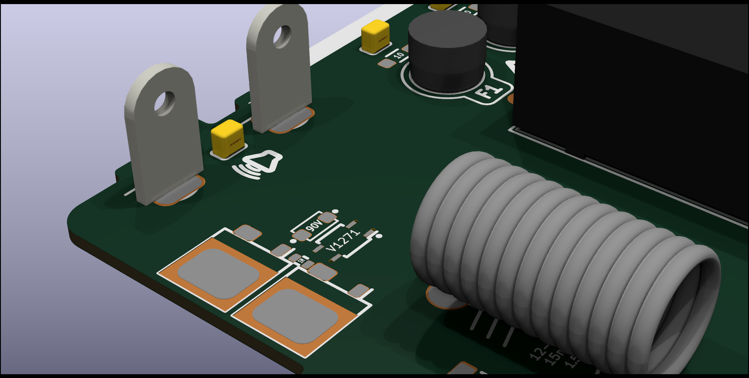

Another very very nice feature in KiCAD is the ability to preview the solder paste layer using the 3D viewer. It's not much of a big deal when designing for larger parts usually, but when designing using parts with 0.5mm pitch, the paste layer can become a tricky thing. Usually, you can find it better to shrink the aperture of the paste layer to keep from applying too much solder paste onto small pads, running the risk of bridging the pins together. This way, the fab house will read the paste layer to your liking, versus just using the pad dimension as default.
In the image, you can see the gray is for the solder paste and the copper color remains free of the paste. I shrink that paste size for larger parts too in that I don't want them to float too high off the board when finished.

I place power planes on the two inner layers, and route signals and ground on the outer layers. I use net ties to isolate noisy high current paths on transformer center taps, rectifiers and filter caps. I use polygon pours for planes, and use keep outs to control where the plane goes. I use a combination of star grounding and planes.
I rarely route ground traces except for high current paths in order to keep them out of the ground plane. I stitch the upper and lower planes together with lots of vias.
