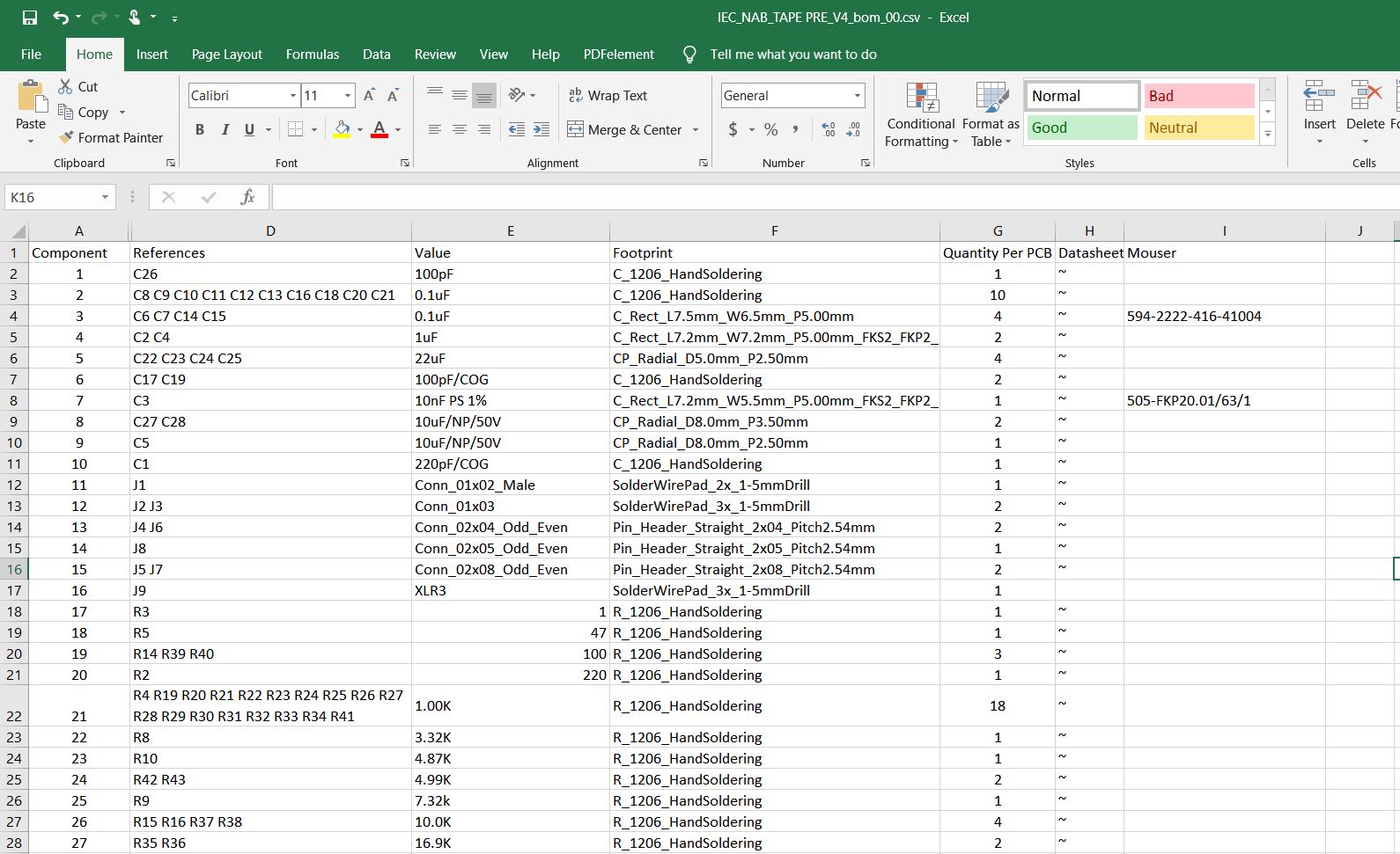

OK...I did as recommended and "bit the bullet"---downloaded KiCad v 5.1.6 and went through the DigiKey tutorial. WHEW!! Not exactly easy! But I have managed to draw a successful schematic, make parts and footprints, make a PCB layout, and generate zipped gerbers. VOILA!! The next part---the BOM---is stumping me. I can generate a csv file, but can't read it in Excel. How do you do this?
the easiest is to view the bom (click on the "edit symbol fields" icon, the spreadsheet looking one) on the schematic side, shift-click and select all the rows and columns, ctrl-c copy to clipboard and ctrl-v paste onto the spreadsheet.

I have had better luck importing a CSV file using LibreOffice Calc. It just works in LibreOffice, but can be a pain in Excel.
LibreOffice is free, and can be installed along side Office/Excel without any problems. You can create Excel files with LibreOffice Calc.

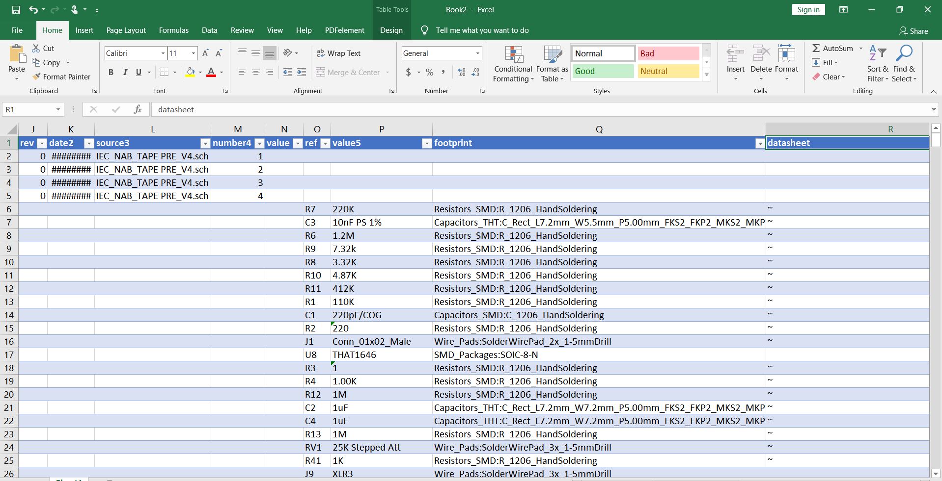

I just save them in xml format and import into excel with no problems and save as xls or xlsx as desired.
Never had any luck with XML into Excel (or importing many data formats like CSV without some fiddling needed). Libreoffice Calc always works perfectly on CSV files. Even works better on some Office files than modern Office versions do.

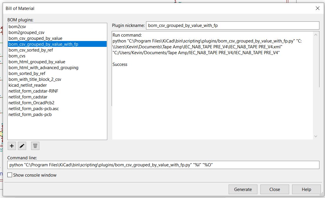

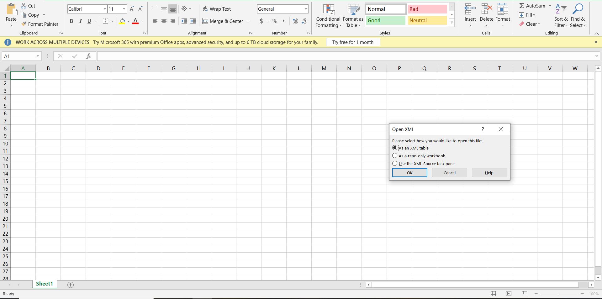

Hi Kevin! How do you do that? My KiCad version (5.1.6) only provides cvs format in the generate BOM tool.I just save them in xml format and import into excel with no problems and save as xls or xlsx as desired.
It's CSV (comma separated values) but saved in an xml format and it can be imported directly into excel without problems, and saved as an xls or xlsx format file.
