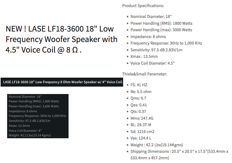

@weltersys The specs i have are directly from the Lase oem, Also lase displays the same spec on the web page. I originally went the reflex route for the smaller size I can stack myself, I currently have 4 so maybe in the horns they would reach down to 30hz. I`ve never used horn resp but ill figure it out, I was hoping maybe someone had experience with this combo already.
@GM "Based on your published specs, near enough dead on for a T/S max flat alignment : Vb = Vas, Fb = Fs, so tuned too low and assume the box is too big."
Are you saying the tuning is to low for this driver? That output below fs diminishes?
Correct! I made my assumption based on your complaint WRT its poor LF performance relative to the posted specs and now knowing the specs you posted as supposedly close enough, then you did tune it too low (30 Hz vs the driver's 41 Hz Fs tuning) and since the sim looks quite flat the box is apparently too big, so either a Vb = Vas, Fb = Fs as 'close enough' or do the math..............Are you saying the tuning is to low for this driver? That output below fs diminishes?
T/S max flat alignment:
Vented net volume (Vb) (L) = 20*Vas*Qts'^3.3
(Ft^3 = (Vb)/~28.31685)
Vented box tuning (Fb) (Hz) = 0.42*Fs*Qts'^-0.96
F3 (Hz) = Fs*0.28*Qts'^-1.4
(Qts'): (Qts) + any added series resistance (Rs)
As I said, the Fb of the Keystone is around 36Hz. It's output is around -10dB at 30 Hz, not useful if you want it loud that low, boosting more than a few Hz below Fb just wastes power and makes the cone flap.@weltersys The specs i have are directly from the Lase oem, Also lase displays the same spec on the web page. I originally went the reflex route for the smaller size I can stack myself, I currently have 4 so maybe in the horns they would reach down to 30hz. I`ve never used horn resp but ill figure it out, I was hoping maybe someone had experience with this combo already.
The LASE site I looked at yesterday listed the voice coil size as 4", having found the TS parameters for the "New! LASE LF-3600 18", I see they agree with the "SD-LF18X451" you posted in #1634.
However, those TS parameters are not at all the same as the RCF LF18X451, which has 30Hz Fs and VAS almost twice as large, 220L vs 124.4L.
At any rate, your "clone" may look like the RCF, but looks can be decieving 😉

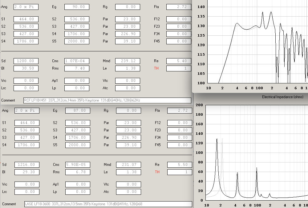

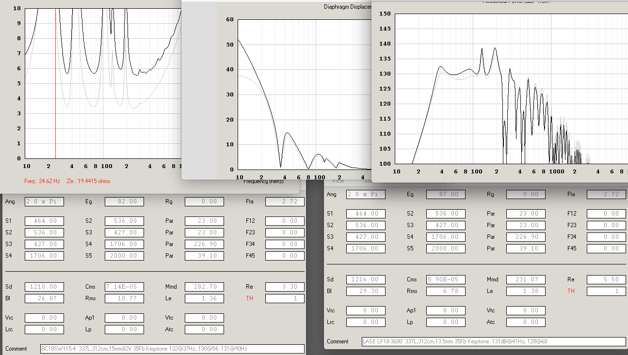

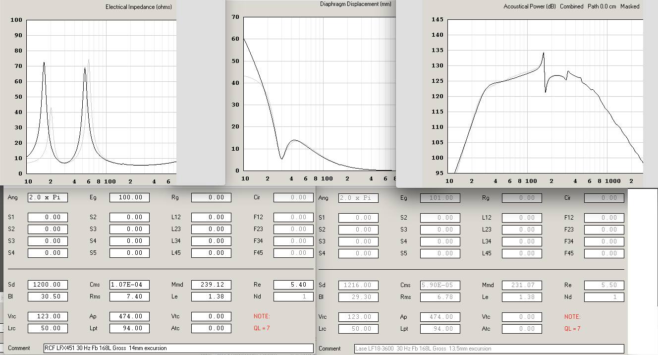

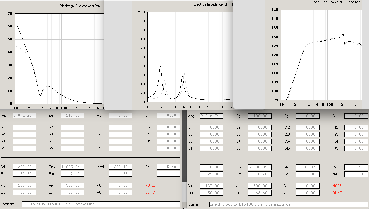

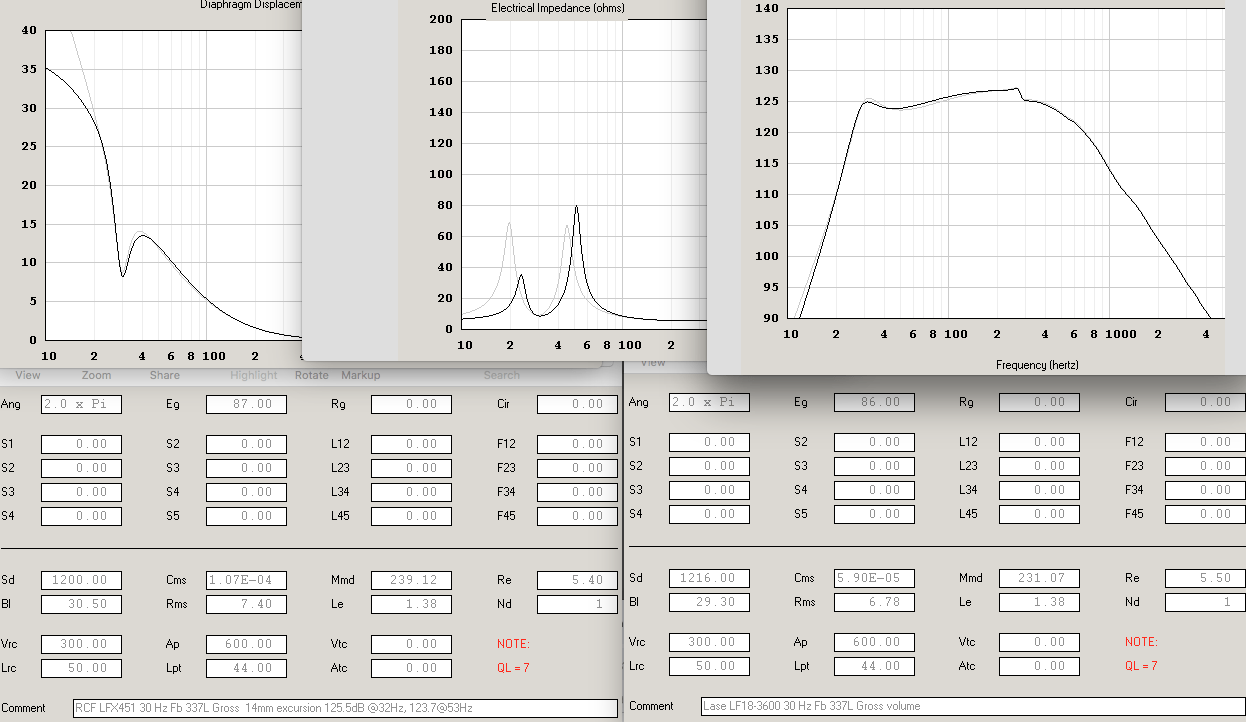

Normally we expect drivers with larger VAS and lower Fs to perform better in a larger cabinet at low tunings than a smaller VAS higher FS would. In turn, the smaller VAS higher FS should perform better in a smaller cabinet.
In contrast, the RCF 18” LXF451 and the Lase LF18-3600 “clone” simulate almost identically in tunings below and above Fs, larger or smaller cabinet volumes than the VAS.
337L is about the gross volume of the Keystone, 186L half the size.
I did BR simulations of 35Hz Fb (same as the Keystone sim Fb) 186L and 30Hz in 337L & 186L.
The 337L 30Hz Fb BR has +3dB at 30Hz compared to the Keystone, but -5dB (or more) less output at 100 Hz.
The 186L 30Hz Fb BR is -3dB LF reduction, output at 30 Hz no more than the 35Hz tuning, and about -3dB at 40Hz.
The 186L 35Hz Fb BR uses more voltage (power) to achieve -2 to -3 dB less output than the Keystone, though two cabinets with two drivers could achieve +2 to +3 dB more level using three times the power.
Both the RCF 18” LXF451 and the Lase LF18-3600 perform equally well in the Keystone simulation, and favorably to the B&C 18SW115-4, output difference mainly due to the 18SW115 greater Xmax/Xvar.
The Keystone exit can’t be modeled exactly using Hornresp. The actual measured response tilts up from around 40Hz to 100Hz, the upper 120-160Hz peaks at lower level than the 100Hz response.
The RCF 18” LXF451 and the Lase LF18-3600 both appear to be more sensitive than the heavier 18SW115-4, approximately 1180watts compared to 1921watts required to reach Xmax/Xvar.
I know the 18SW115-4 has low distortion below Xmax/Xvar, having never heard or tested the RCF and Lase, can’t vouch for them, but they look good in the simulations.

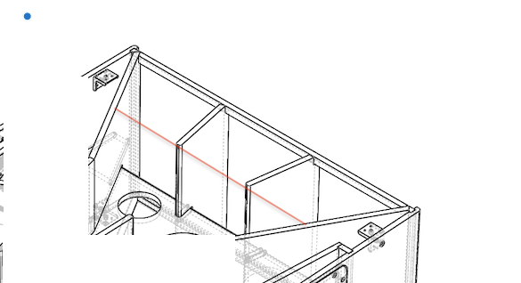

Has anyone attempted to build this with 1/2 ply? Or would that require too much extra bracing?

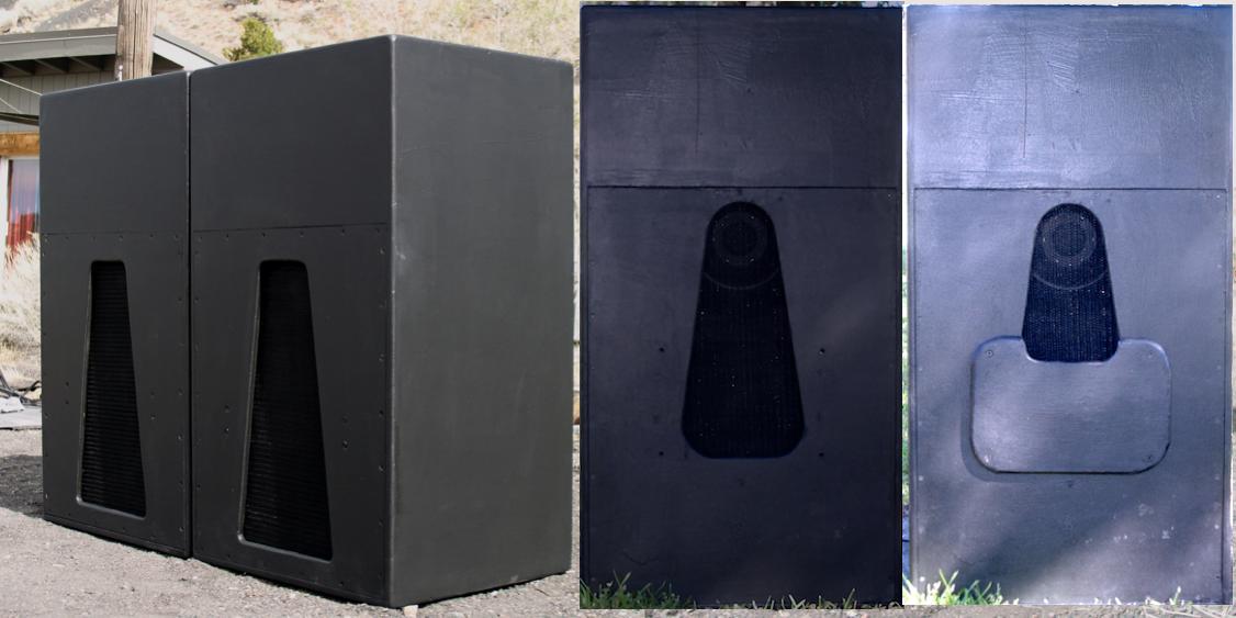

Just had a cool idea and maybe someone has the time/material/place to test. Keep the exit area size but change from the Keystone exit shape to a 1/4 circle kinda sorta like the Danley BC stuff.
Not that they have reported.Has anyone attempted to build this with 1/2 ply?
It would require a lot more bracing to make 1/2" ply as stiff as 3/4".Or would that require too much extra bracing?
The reports of wood deflection and level loss at high volume in smaller TH subs using 1/2" and added build complexity to save a few pounds is not worth it.

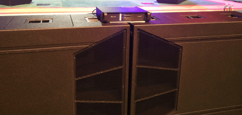

Zwiller,Just had a cool idea and maybe someone has the time/material/place to test. Keep the exit area size but change from the Keystone exit shape to a 1/4 circle kinda sorta like the Danley BC stuff.
Each of the BC front loaded horn (FLH) enclosures has a mouth exit best suited to the application.
I tested over 20 different shapes and areas before deciding on the Keystone tapped horn exit.
Several years later found it interesting to see Danley Sound Labs using a keystone shaped exit on their DBH-218LF:
The DBH-218LF exit shape was simply a result of using a side exit on a FLH:
At any rate, after extensive testing and evaluation, I don't think any of the DSL FLH exit shapes would result in overall better response for the TH Keystone Sub, but don't let that deter you from trying them yourself!

The Keystone sub's mouth shape, area and location was dictated by the position of the two sides of the driver relative to the exit.
When the rear path length was extended, in the "Tall" version, the location and area had to be changed to retain decent response past 100Hz and keep the Fb low.
