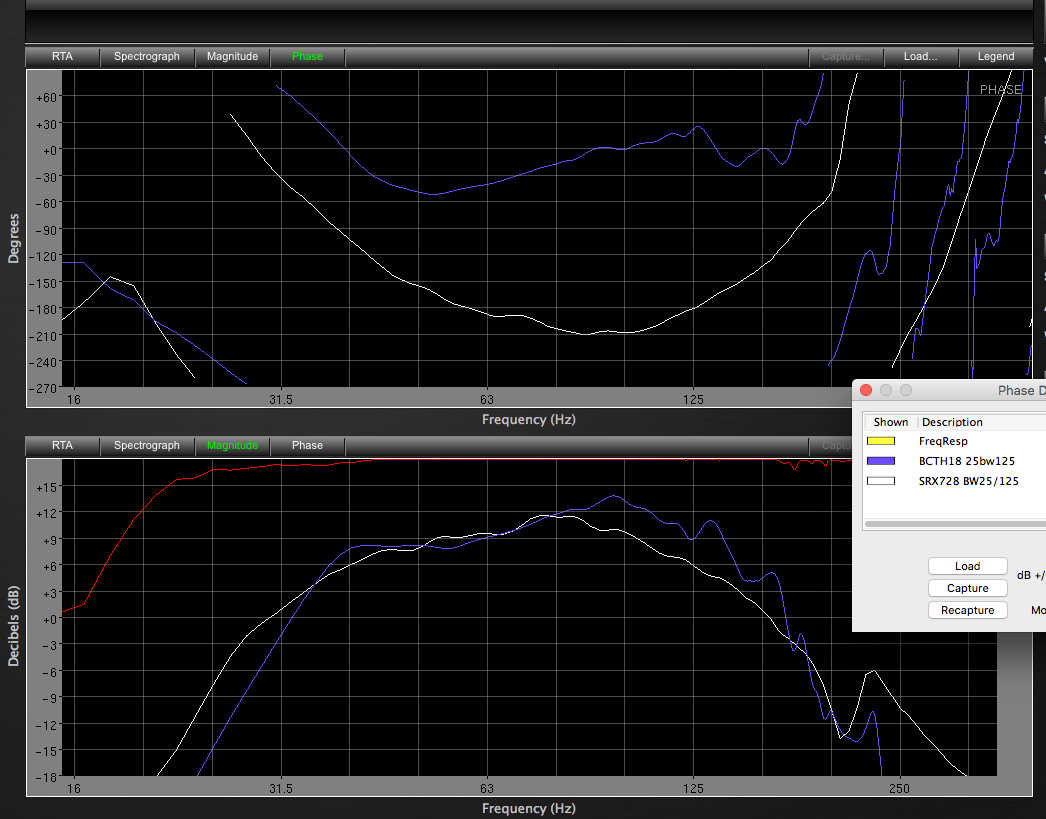

Yeah, different subs will have different phase responses. the SRX728s are vented subs and the Keystones are THs, which should have a phase response similar to a series-tuned 6th order BP within the passband (and very horrible phase response outside the passband - don't go there!).
According to my Hornresp sim, the phase response of the Keystone design hits 180 degrees out of phase around 70 Hz - maybe there's a connection between this and what you heard when the subs are all played together?

I've measured the 2x18" 4 ohm JBL SRX728 as very close in sensitivity to a single Keystone loaded with a BC18SW115-4.
SRX 728:Keystone.png
The phase difference between the TH and BR will only allow alignment at either the top or bottom of the sub range unless you use FIR filters, which would require more latency than would be acceptable for most live gigs.
The above phase charts are a bit off, due to the SMAART auto delay finder choosing 4.48ms different times (in retrospect should have used the same time, live and learn..) but gives an idea of the relative phase difference.

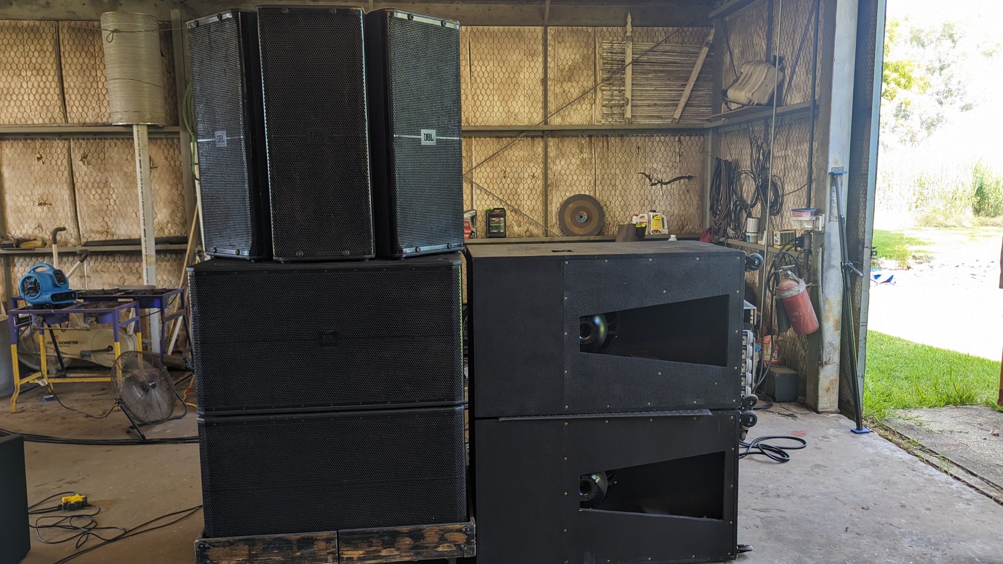

Concert over so I thought I would post my findings. I ended up putting the keystones center clustered laying down on the floor in front of the stage with a couple of fills on top. The JBL's were stacked like the picture with three tops on top of two subs. Of course I had to invert the phase on the keystones. We played with various crossover settings but what I found out was that I no longer heard any weird noise anomalies once I got the keystone's away from the JBL's. I ended up turning the keystone's down 9 dB to get the volumes relatively the same as the JBL's. The general consensus from the sound men that were there was that the keystone's blew away the JBL's. The amount of air that they move is incredible.
