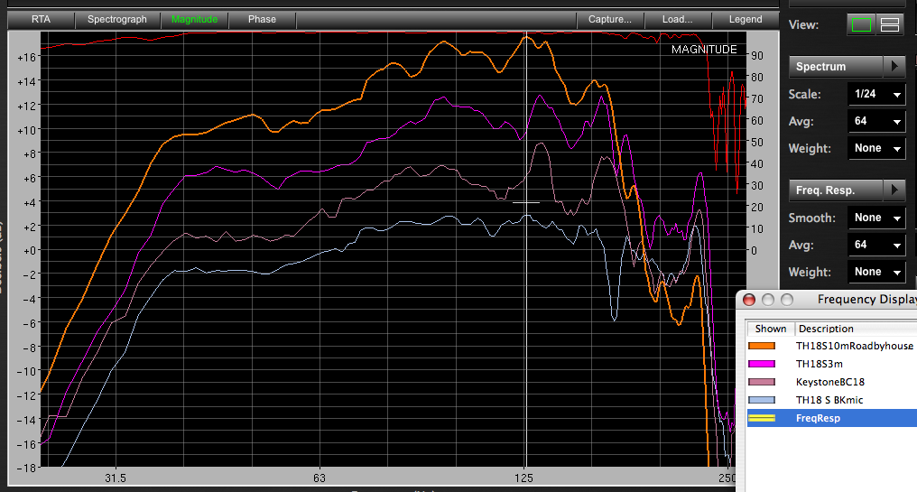

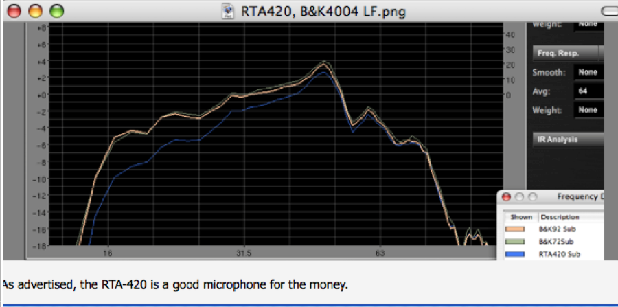

Posted below are measurements of the Keystone at various distances, most of the tests previously posted in this thread were done at 2 meters using an RTA 420 mic laying on a piece of plywood on the dirt.
The RTA 420 mic response rolls off slightly below 60 Hz, about 1 dB down at 40 Hz, 2dB down at 30Hz, 4 dB down at 16 Hz. That falling response curve makes the Keystone measurements look a little more upward tilted than the actual response is.
The response using the B&K 4004 microphone (at an unknown distance) shows the response to be +/- 3 dB from 35 to 230 Hz, and inverts one of the upper peaks at around 180 Hz compared to the 2 meter tests.
Art
