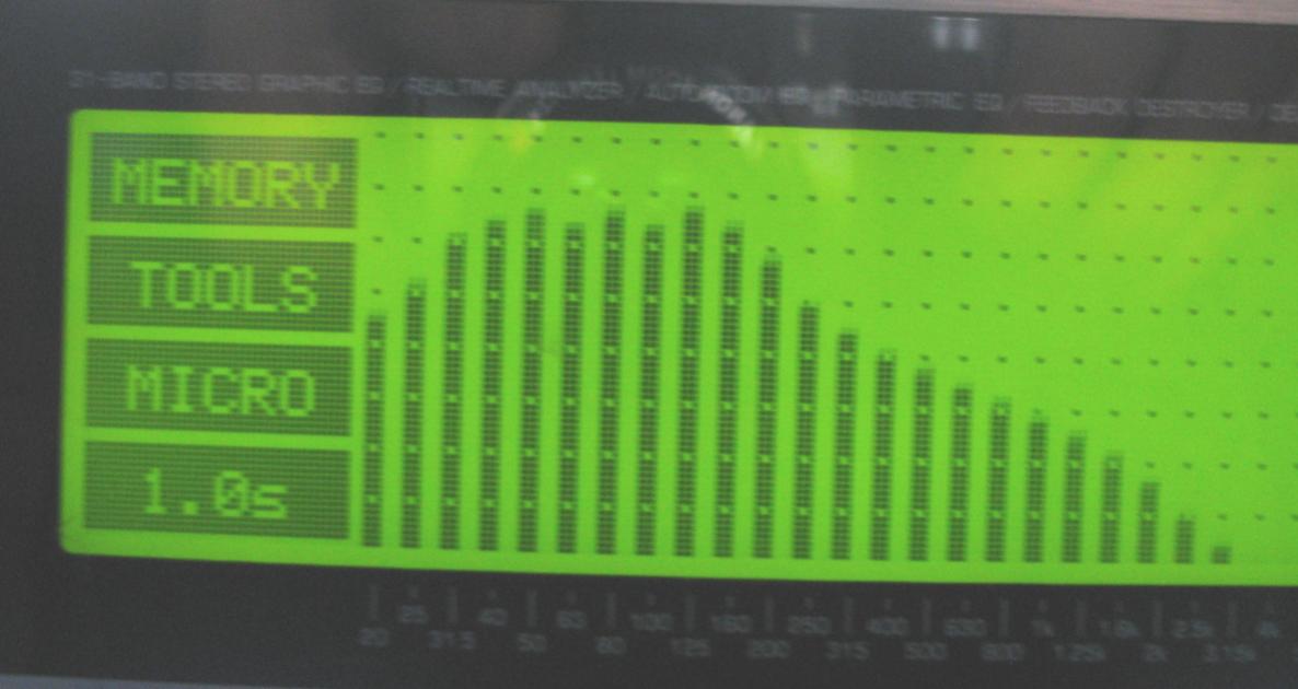

One box with 18NLW9600, into a big warehouse, floor concrete, around 8 M from nearest wall, just in front of the gate where trucks can pass into place.
Pasc,
What is the dB scale on the RTA?
