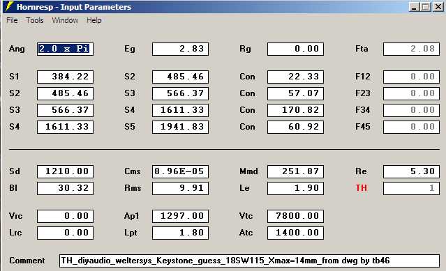

Hi NEO Dan,
It'll take me a little bit of time to do that, and I don't quite know if I'll have the time today. Anyway, I'll attach my Hornresp Input screen for the original drawing I made. As far as the tapped horn aspect is concerned, there should not be enough difference between the two drawings to matter. Be warned though, Hornresp does not have any way (I know of) to model the Keystone exit, so all you're going to get is a general idea for a tapped horn with a similarly sized mouth located at the front at the end of the horn path.

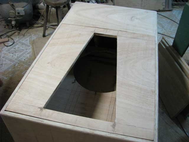

Hi!
I'm making one.
Need to round opening both sides and attach braces to the front
Will try the 18Sound 18NLW9600 in it (have an offer of local dealer).
