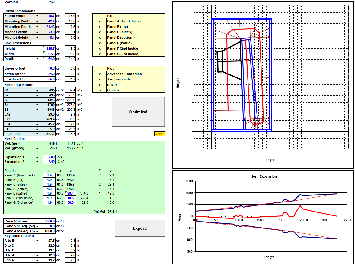

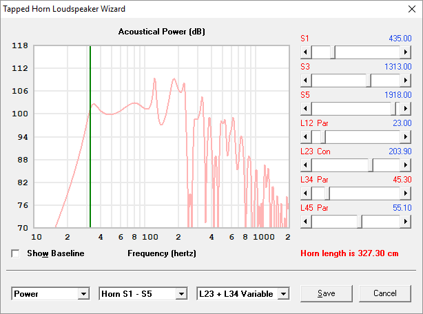

LOL, remember my original purpose was to find out why measured Fb was higher than the sim. And from the sim, it looks like mouth size vs. cabinet volume might be the key. The volume at the back of the horn is smaller than it should be, which could partly explain the smaller mouth you ended up having to use to achieve a lower Fb.
After messing around with the layout a bit, if the cabinet depth is extended to 24" and the internal panels re-arranged slightly as per diagram below, mouth size can be extended to 300 sq.in. and Fb will be about 32 Hz. Of course what the passband response looks like will be entirely dependent on the placement and shape of said mouth... 🙂

Yeah, I've been running a few sims on some other TH folds that I've transcribed to workbooks to see what could optimally fit in a box that's 45" x 22.5" x 26.5", and apart from one that had an Fb down at 24 Hz and could hit just under 130dB but would require 180V to do so, I haven't come across much. Art has done some horn alchemy with the KS 🙂.
I just though of a new TH fold though that might work though, and it can be KS'd too, and it places the driver at the bottom of the box which should make it slightly more stable (or a bit less prone to damage if the box is tipped). Roughly drawn out it looks like it might work, but I'll to do a bit more workbook-warrioring to see if it will work....

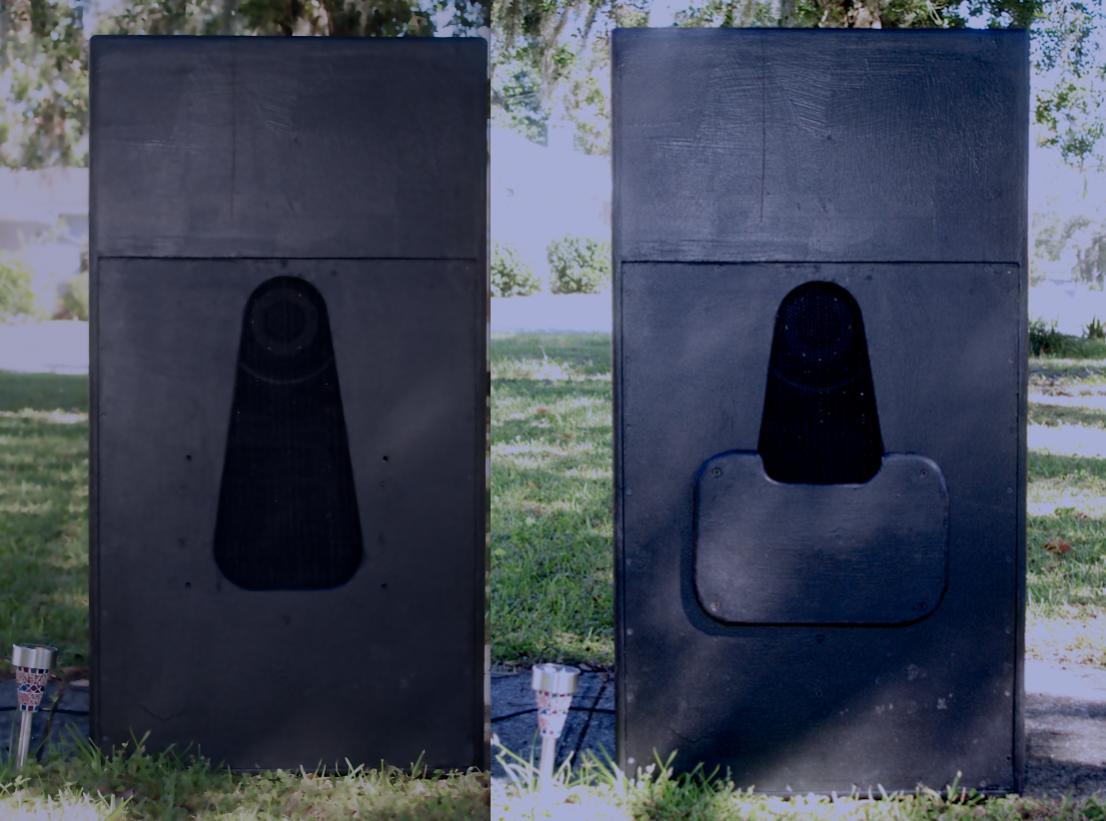

The screenshot below shows the raw response of the 48” tall Keystone B-Low cabinets, the B18 loaded with an 18” B&C18TBW100-4, the Key B15 loaded with a 15” Dayton PA385S-8. The “S” designation is using the “step down” exit cover plate which lowers the Fb from 32Hz to 31Hz.
The drive level was the same for both drivers, the 15” being an 8 ohm driver gets half the power as the 4 ohm 18”, therefore has been raised by 3 dB on the screenshot. The overall sensitivity of each driver is quite similar down to 35 Hz, the B&C 18 +2dB at 30Hz. The B&C driver has more excursion and power handling, so can play louder and cleaner than the Dayton, but the 15” works better than expected.

Nice work, Art! Interesting to see the behavioral change between normal and step-down mode above 90Hz.

It appears the band pass effect from the step-down cover also reduces harmonic distortion by around 36%.
