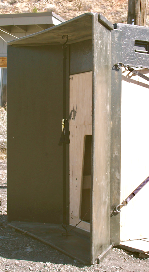

I had the same problem with TH18 prototype standing up. First I did some more bracing and then I put some 'stone carriers' (rubber plates from recycled rubber) that helped a lot. i think you can find them at your local BAUHAUS Bäckebol. We use this a lot on our gigs. looks like this:
Hi there: Here in the US we can purchase similar recycled rubber pads at HomeD in 18"x18" and 18"x 9" in the garden department, at a rather reasonable cost. Ollie's also carries the 18"x18" size. Also, I've used them for no/low resonance OB driver boards...regards, Michael
Have you tried raising the back of the sub with a strip of wood say about 1/2" high? Let the front edge of the sub rest on the ground. This should decouple the bottom panel from the ground and remove its vibrations as a cause of the "movement".
The subs are already decoupled from the ground using common rubber feet like for cases and such. But as usual the feet have a rather small area which might be the issue.
My old MTL1s never walked. They had large feet AND they were very soft. These look very similar. https://www.parts-express.com/penn-elcom-9106-rubber-cabinet-foot-25-dia-x-1-h--260-772

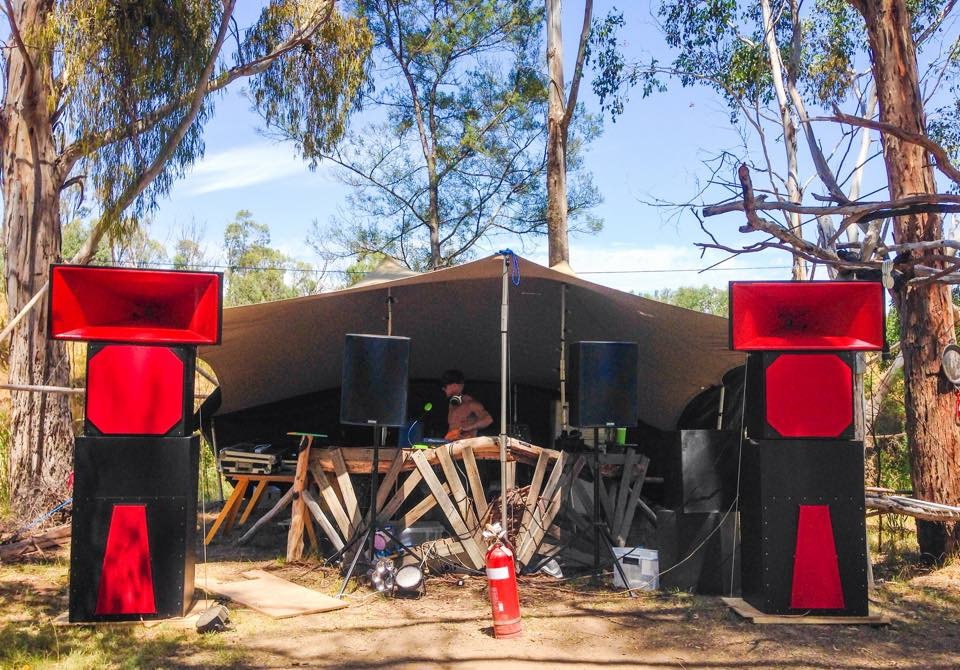

This weekend we ran this warehouse party with dark techno using two keystones with extenders.
Hey I'm about to build some extenders for mine, do you cross brace yours or is it not needed, also do you notice much difference with the extender? I know Art measured a 3db increase.
Hi there! Not sure what you mean with cross bracing, I use no bracing at all, three straps each extender and it works like a charm.

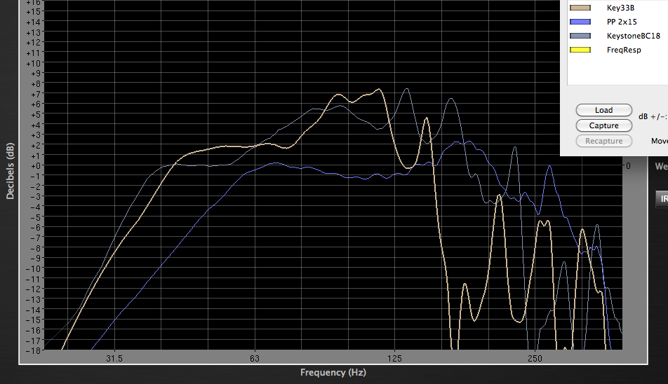

Keystone B-Low
After two hurricanes since purchasing the plywood, am well on the way to completion of the six Keystone “B-Low” cabinets that I hoped to start on about a year ago, before life got messy, then slowly cleaned back up.
With changes in latitudes, attitudes and computer operating systems that have fell by the wayside like rotten bamboo scaffold in the tropics, the Smaart measuring system used for all the 2011 and subsequent tests now is problematic.
To compare prior test results to the new sub designs has been like pulling teeth, it feels better after, but then there are those gaps..
The 4.5” taller Keystone B-Low is a “qualified success”.
According to simulations, the longer path length should have dropped the Fb (the minimum excursion point for the driver) to 29.65 Hz, with an F3 of 31 Hz.
It did not. The first test using an exit of 416 square inches had a 35 Hz Fb.
Reducing the exit to 267 square inches dropped Fb to 34 Hz, and reduced excursion around Fb. With a 207 square inch exit, the Fb drops to 33 Hz, increasing available output at 31 Hz (the “Low B” note) by 2 dB over the 34 Hz version.
In addition to the Fb not being as low as expected, the LF corner is higher than the original design, perhaps due to the BC18TBW-4 having less BL than the more expensive, higher BL, higher power, (but less sensitive) BC SW18115-4 used in the original.
The original BC18SW115-4 Keystone excursion minima (Fb) is about 34 Hz, with -8 dB response at 30 Hz. It’s excursion is the same at 32 Hz as 45 Hz.
The Keystone B-Low with a 207 sq. in exit has a 33 Hz Fb, -10 dB at 30Hz response, but with equivalent excursion at 23 & 42 Hz. This wider range of excursion control allows a 12 dB LF EQ boost to the BCTBW100-4 at 92 volts, with only 16% distortion, compared with 32% in the original at 77 volts. From 35 Hz to 100 Hz distortion averages only 3% at the same 124 dB output level.
Since the original expectation of a F3 of 31 Hz with a resultant overall sensitivity drop did not occur, Hoffmann’s Iron Law prevailed. The “B-Low”, being larger, but with nearly the same Fb as the original Keystone is a bit more sensitive over most of the pass band. The larger box with a longer horn path can accept more voltage around Fb with less than half the distortion, so can produce more “gut feel”. The upper output range is huge, real world peaks in the 133 dB SPL range above 40 Hz are no problem, at 100 Hz around 145 dB SPL seems to be available based on initial testing.

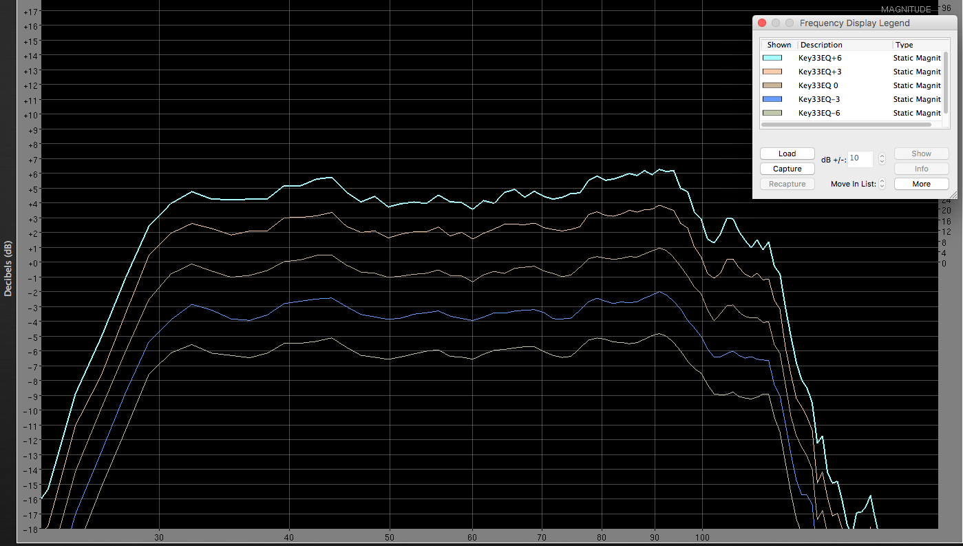

Two channels of a NU4-6000 bridged mono used for testing produces as much as 3000 watts at clip/limit. The limiter is hard, no audible clipping is heard, but if the light flashes even momentarily, the input/output is reduced by 1 dB. This can be seen in the Keystone B-Low screen shot Key33EQ -6 to +6 tests. Regardless of input level increases, once the limiter engages, output will not raise at all.
The Keystone B-Low was swinging 116-118 dB SPL peaks at 2 meters with "bottom feeder" type music like Bass Mekanik's “Bass I Love You” tickling the limiters when equalized flat to 30 Hz, requiring a 12 dB boost at 30 Hz. 92 volts of juice swinging down there!..
Raising the HP from 25 to 30.5, effectively eliminating the LF boost in the pass band brought SPL to 124 dB or more with more typical rock fare. That level is equivalent to 130 dB musical peaks at one meter with a typical SPL meter “C” scale, fast response. “Fast” is still slow compared to short peaks not visible on the old analog SPL meters used.
The initial listening test ended abruptly when a neighbor came over with complaints of her windows rattling and chest hurting. The nearest part of her house is 171 feet (52.6 meters) from the speaker location. I was already feeling a little queasy from the 30 Hz response from the first couple songs played, and at over 25’ from the sub could feel the louder rock bass line modulating my voice on each note while I apologized to her and shut down.
Although I am happy with the response of the Keystone B-Low for the type of music I prefer to work with, if heavy output below 40 Hz is what you are looking for, Josh Ricci’s Othorn, Gjallerhorn, or Skhorn are still the way to go if you can afford it.

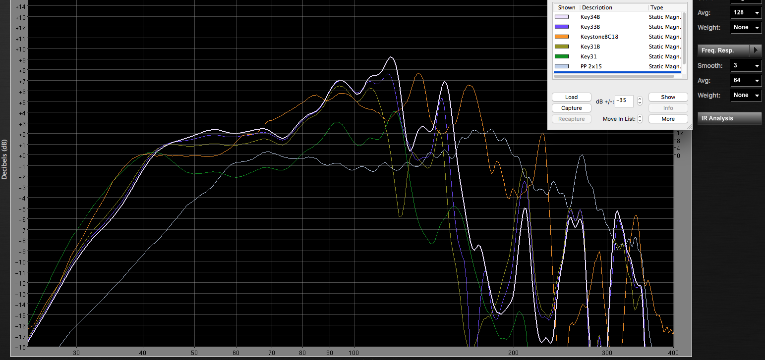

In the screen shots below, “KeystoneBC18” is the original using a BC18SW115, the various “Key” show response of various exit openings. “PP 2x15” is a cabinet half the size of the original Keystone, details here:

According to simulations, the longer path length should have dropped the Fb (the minimum excursion point for the driver) to 29.65 Hz, with an F3 of 31 Hz. It did not. The first test using an exit of 416 square inches had a 35 Hz Fb. Reducing the exit to 267 square inches dropped Fb to 34 Hz, and reduced excursion around Fb. With a 207 square inch exit, the Fb drops to 33 Hz, increasing available output at 31 Hz (the “Low B” note) by 2 dB over the 34 Hz version.
That's a pretty significant difference in predicted vs. actual Fb there. Hornresp predictions for Fb are usually pretty close, though of course the Hornresp prediction is also impacted by the size of the mouth. My guess is that the actual effective path length is not the same as the sim due to the location, size and shape of the mouth.

I already have the four Dayton drivers and four B-Lows that they will go in- sims came out pretty close for the PPSL 2x15" they are loaded in now, so I expect they will work reasonably well, should know how well in a few more days.
The Fb not dropping with the longer B-Low path length is a real mystery, I can't think of any reason why it wouldn't.
