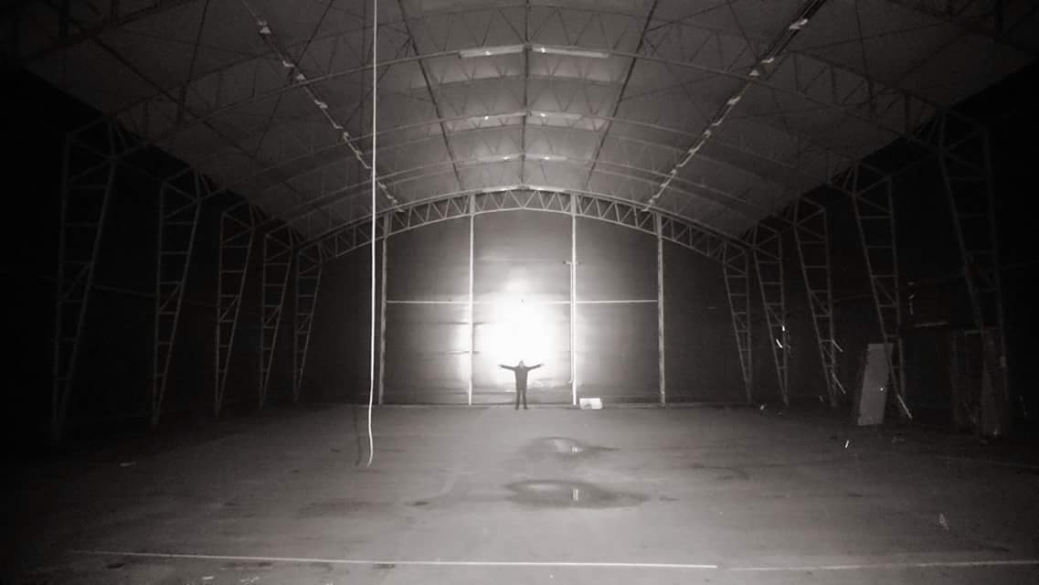

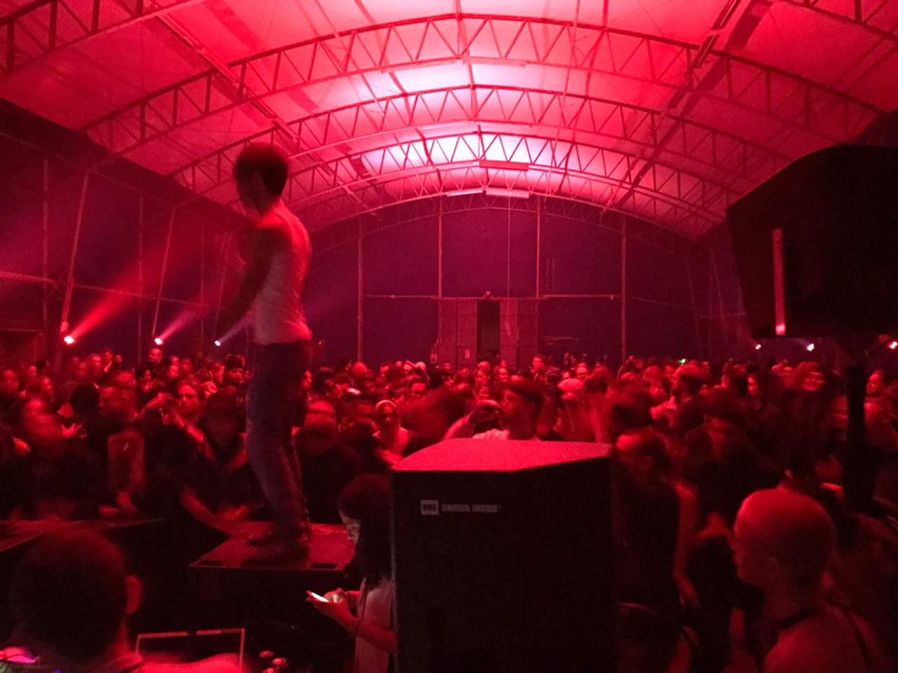

This weekend we ran this warehouse party with dark techno using two keystones with extenders. Normally the size of venue you could see 6-8 f221 and six res.5 tops.
Not my most intense experience but it sounded great and was intense in the front! It sometimes ran 15 dB's into the sub limiter for extended periods at 85 volts and the magnets were barely warm.. I heard the limiter working but don't think anybody else noticed. 8 ohm drivers
Great party. Great cabs. Thanks Art!

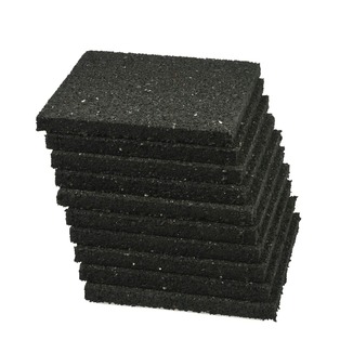

I had the same problem with TH18 prototype standing up. First I did some more bracing and then I put some 'stone carriers' (rubber plates from recycled rubber) that helped a lot. i think you can find them at your local BAUHAUS Bäckebol. We use this a lot on our gigs.
looks like this:
121

How big are those matrasses, do they cover the whole bottom or one in each corner? Thanks for the tips!
I was just out and bought a package of the stone rubber feet, but they are small, 60x90 mm. Still much bigger surface than my current feet offcourse!
Hope it will solve the walking subs!
