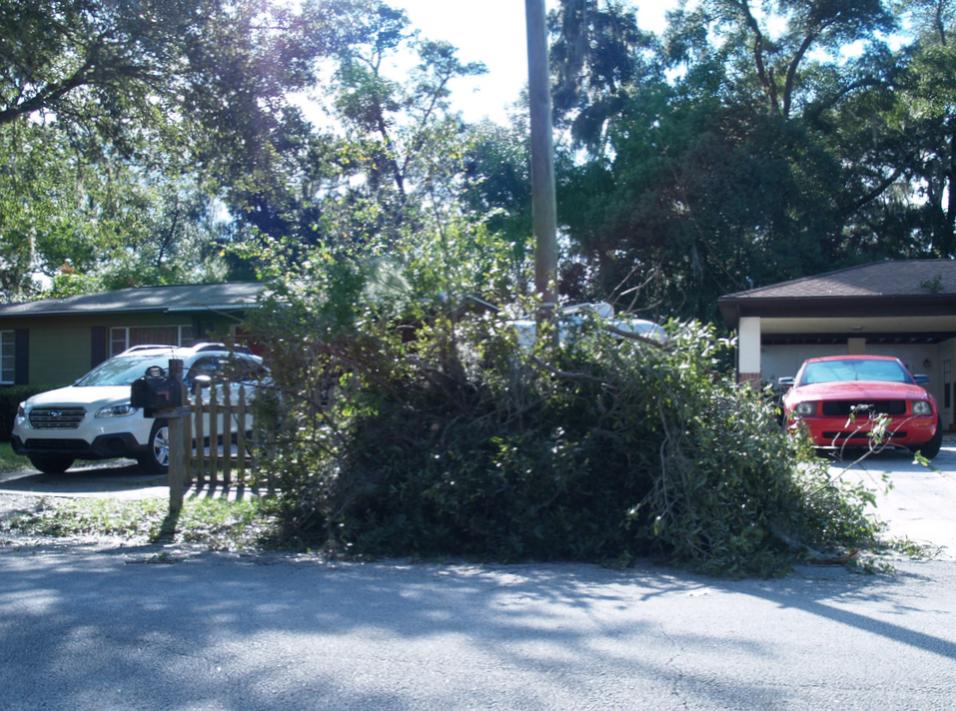

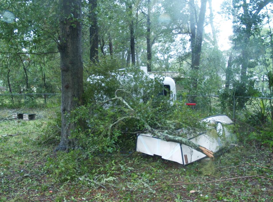

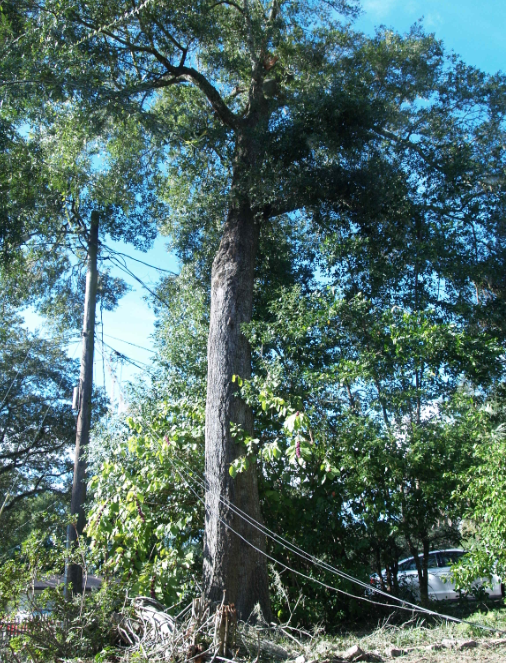

Yikes, what a mess. Hope no-one was harmed.
I was going to delete my post, but woke up on the couch 6 hrs later to a no-can-do situation. 😱 It was just laziness, so now I've subscribed.
Taller with (slightly lower) output down to the high 20's sounds like something I'd be very interested in, completely understand these things take quite some time, I'll just keep an eye on the thread. Thanks.
As far as I've heard, only one lady was killed when a branch fell on her while she was feeding her animals, died on the way to the hospital. Considering the amount of huge water oak trees dropping like flies all around here, I am just amazed there were so few casualties.
I was lucky that my rental house has an attic, a branch dropped about 50' and pierced the roof just a few feet from my desk, it was LOUD, and then the power went out. I shut down the computer and my two battery back up power supplies, and ike a dumb-***, went outside to see what happened. There was almost no wind, but my neighbor had another huge branch drop on the power lines at the same time, which resulting in the power outage.
