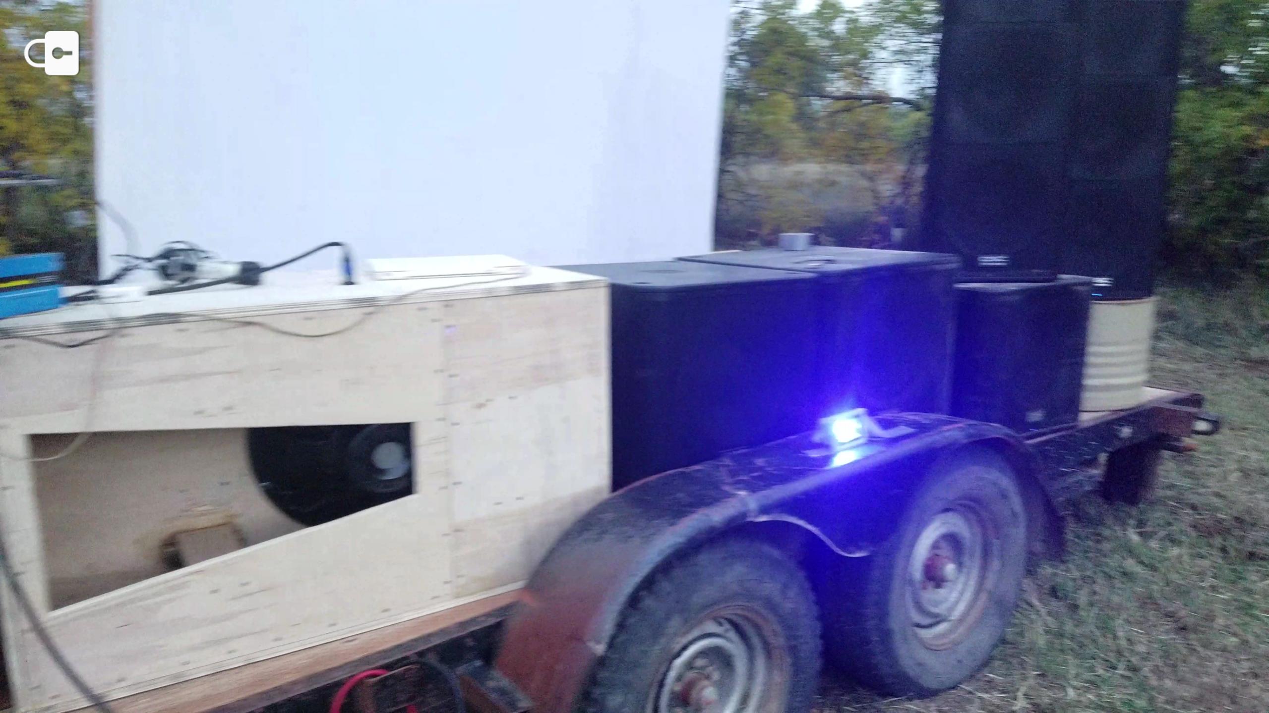

Well here was the weekends trial of the keystone. It was a rush to throw it together in time, but it was just for 20 close friends in our alfalfa bottom haha.
Review:
18sw115 driven by nu3000 dsp bridged.
Having a flatish response does wonders for edm music (havent had time to eq the amp yet). The lower extenstion over our qsc kw181's really made a difference. The bass was incredibly tight and accurate compared to the vented qsc's. I ran the sub for 6 hrs on low volume to break in, then ran the gain and front attenuator around 3/4. Which drove the sub hard. Never got beyond slightly warm with over 8hrs of playing. This design really creates some good forced convection on the sub. People were blown away by the quality of bass and weve been to some pretty impressive venues. Turn downs made everyone smile. I did have to run the sub on its side as it blocked my projection screen. Real world output equalled about two of our qsc's while vastly exceeding their freq range. I a/b'd them and dont seem to notice two much issue with running the tapped horn with vented subs. Im very intrigued to see what a sub that could run down to 20 hz could do.
