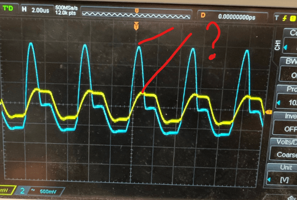

Interesting. There are a couple of things here...
The amplitude difference is all important. Looking at this image it is how much higher in voltage the peek of that blue trace is compared to the yellow one that determines whether the following transistor will turn on. So if you are on 0.1 volts per div (accounting for any divider probe you might use 🙂) then there is indeed around 0.25 volts difference. Same applies to the other image.
That in itself is not enough to turn on a silicon transistor... so is something else going on here?
One question is why are the traces not the same. The only thing I can thing of is that this is oscillation and that the high current you see when the outputs are fitted is due to two possible causes (perhaps both happening together).
1/ There is conduction overlap of the relatively slow outputs and so they both linger in an on condition.
2/ The frequency of oscillation is high enough to cause considerable AC current to flow in the Zobel network at the output.
Even with no outputs fitted you could try measuring from ground to these two resistors (there seem to be two Zobels, one before and one after the relay). The first one has an effective value of 5 ohm. If we know the AC voltage across each resistor we can work out the peak current. With only drivers fitted its going to be low but of course it should be absolutely zero. Fit the outputs and I suspect it will be much higher.
That is all kind of another proof that the issue is instability and not a normal component fault as such.

Thanks @Mooly
as each division is 500mv, does this mean that the delta between blue and yellow is 1.2v approx?

try to vertical align blue (ch 2) with yellow and you will be sure how much difference you have (as I calculated, you have blue line about 2.2 Vpp, yellow is about 0.8 Vpp), so there is enough difference to cause one transistor to conduct on high frequencies. If I remembered correctly, I think that PNP transistor will conduct and you will see on zobel negative pulses (if you follow Mooly's suggestion).
Now you have starting point to go backwards to the input stage and try to find where oscillation rises with signal similar to negative pulses.

It does as long as the coupling was set to DC for both channels and both channels with no signal were aligned to the same point on the screen,
If that is so then that would force a very high current in the output stage.
What was the time/div set at in that shot. One cycle is approximately 2.5 squares in the horizontal plane. 1/T will give us the frequency. For example if the setting is 2us per division then one cycle is approx 2.5 * 2E-6 which is 5uS (for one cycle) and the frequency is 1/5E-6 is 200kHz

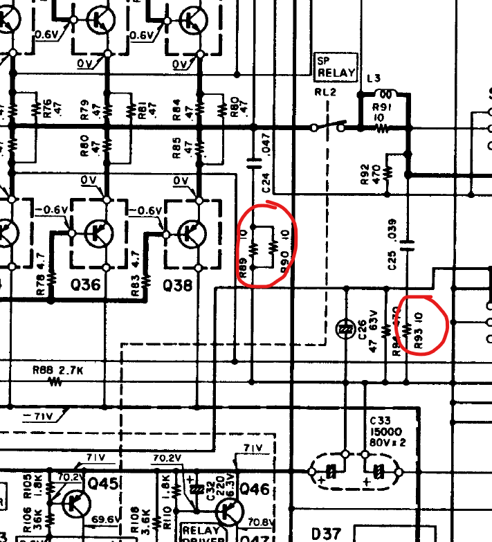

I reinstalled C25, which is post the relay bringing R93 back into the circuit. There is no voltage across R62/R65 and no 210Khz on TP 15,16 or 17.

Are you saying that adding that second Zobel flips the amp into oscillation? That was good thinking by @BSST to go down that route.
If so then my first thoughts would be to make sure that C25 really does connect via the series resistor and is not somehow shorted to ground. i.e. not adding a cap directly across the output.
Second thing is to check the ground end of the Zobel is OK and that it is not somehow floating in some way and adding positive feeding to another point in the amp circuit (if that makes sense 🙂) You could try a lashup network across the other one. Also make sure that first Zobel is grounded OK. If both share the same ground and its not correct then it might just be the second network pushes it all over the edge.

Another small difference on the circuit, on the board it is C25 that goes to earth rather than R93- so output line goes to R93 then C25 then earth.
