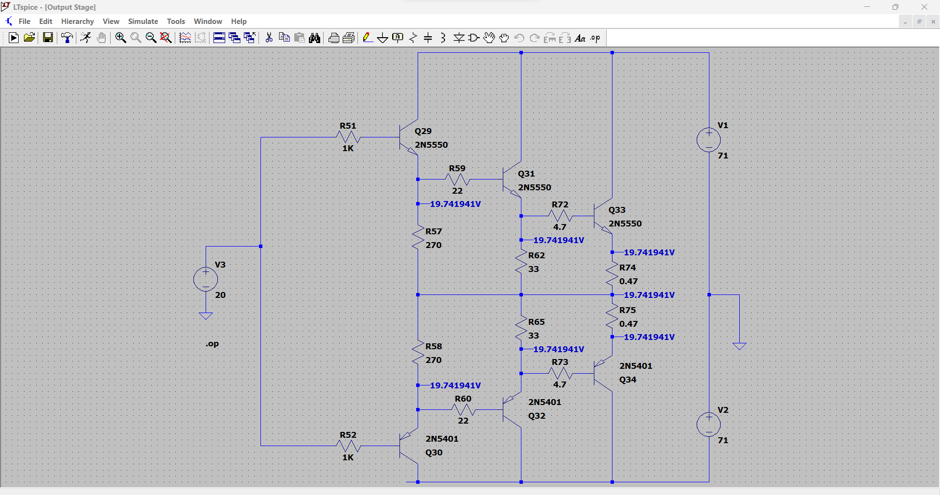

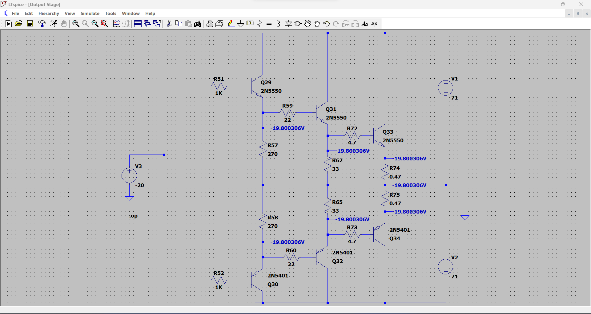

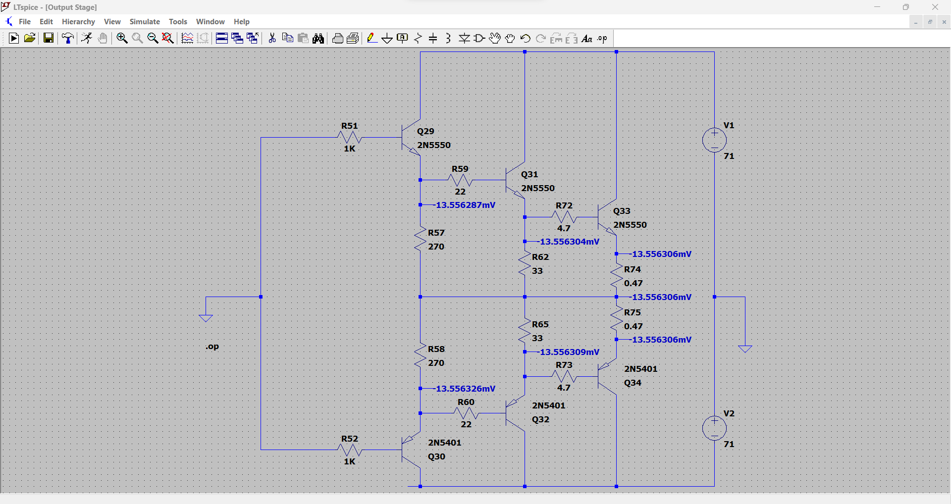

You have to get it to this state. First image is with R51 and R52 grounded. Second and third image show what happens if there is an offset. No current flows in any of transistors (provided there is no load attached). The voltages just follow the offset driving R51 and R52 but we still have zero current in the 270 ohm, the 33 ohm and the 0.47 ohm.
At DC and with no DC load it can't be any other way 🙂

So- with the 22ohm installed and R51/R52 grounded as in the first image, there is 0v across the 33 Ohm (R65/62).
I then installed one each of the output (2SA/2SC) and still zero volts across 33 Ohm, the relays click, there is 0 volts on TP 16 and the dim bulb is off.
This implies that some how the "front end" is causing the problem- though I am not sure how
