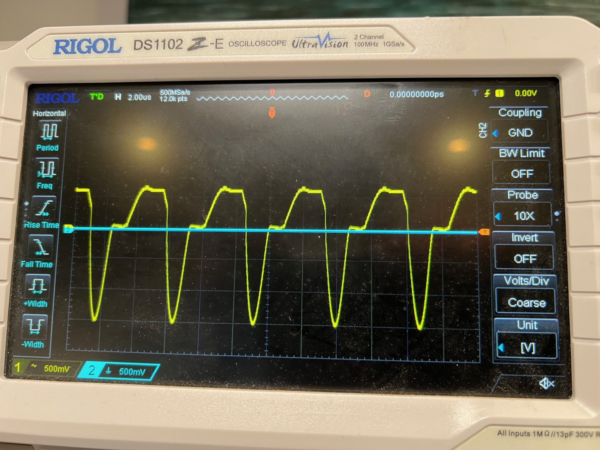

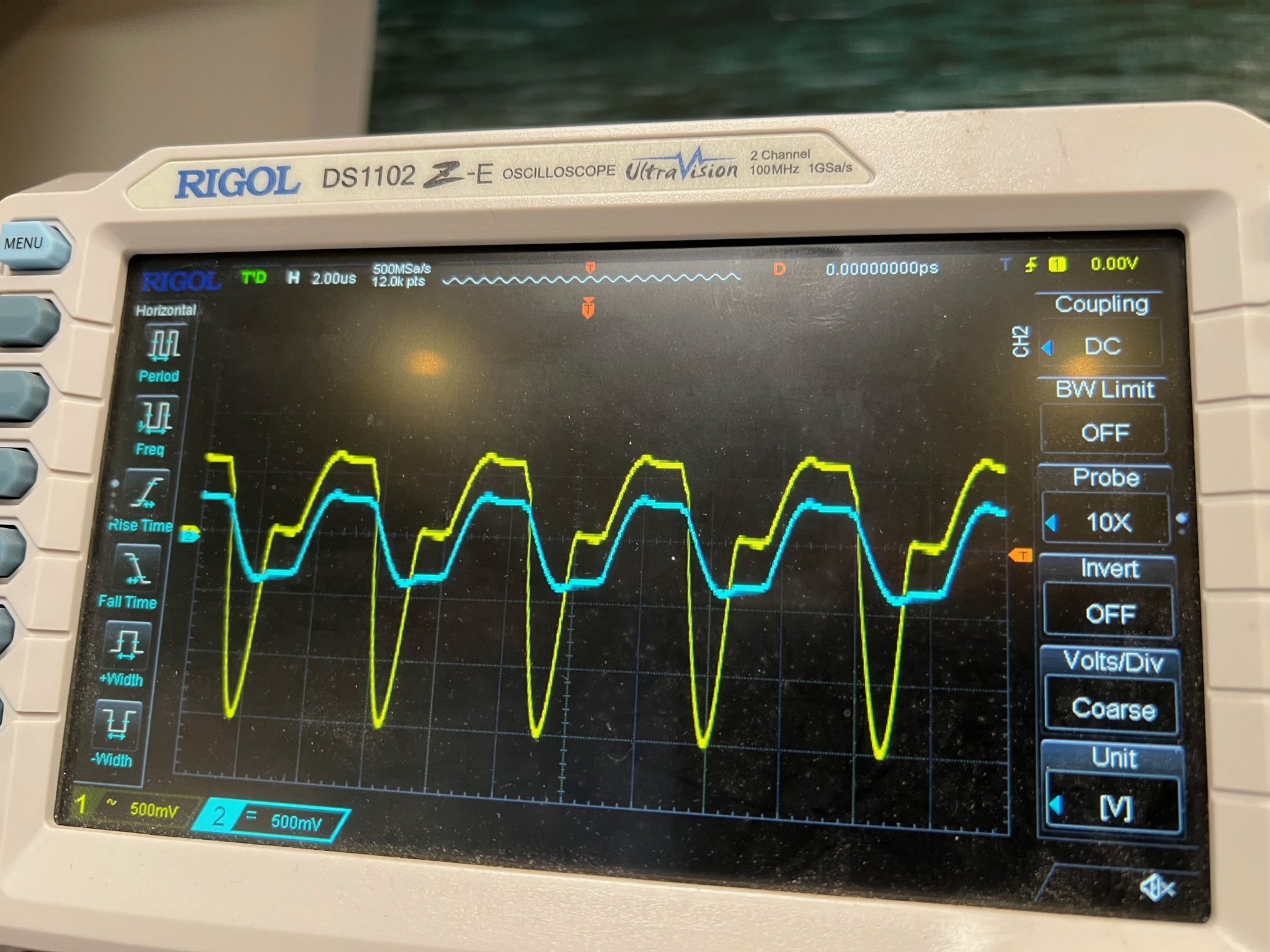

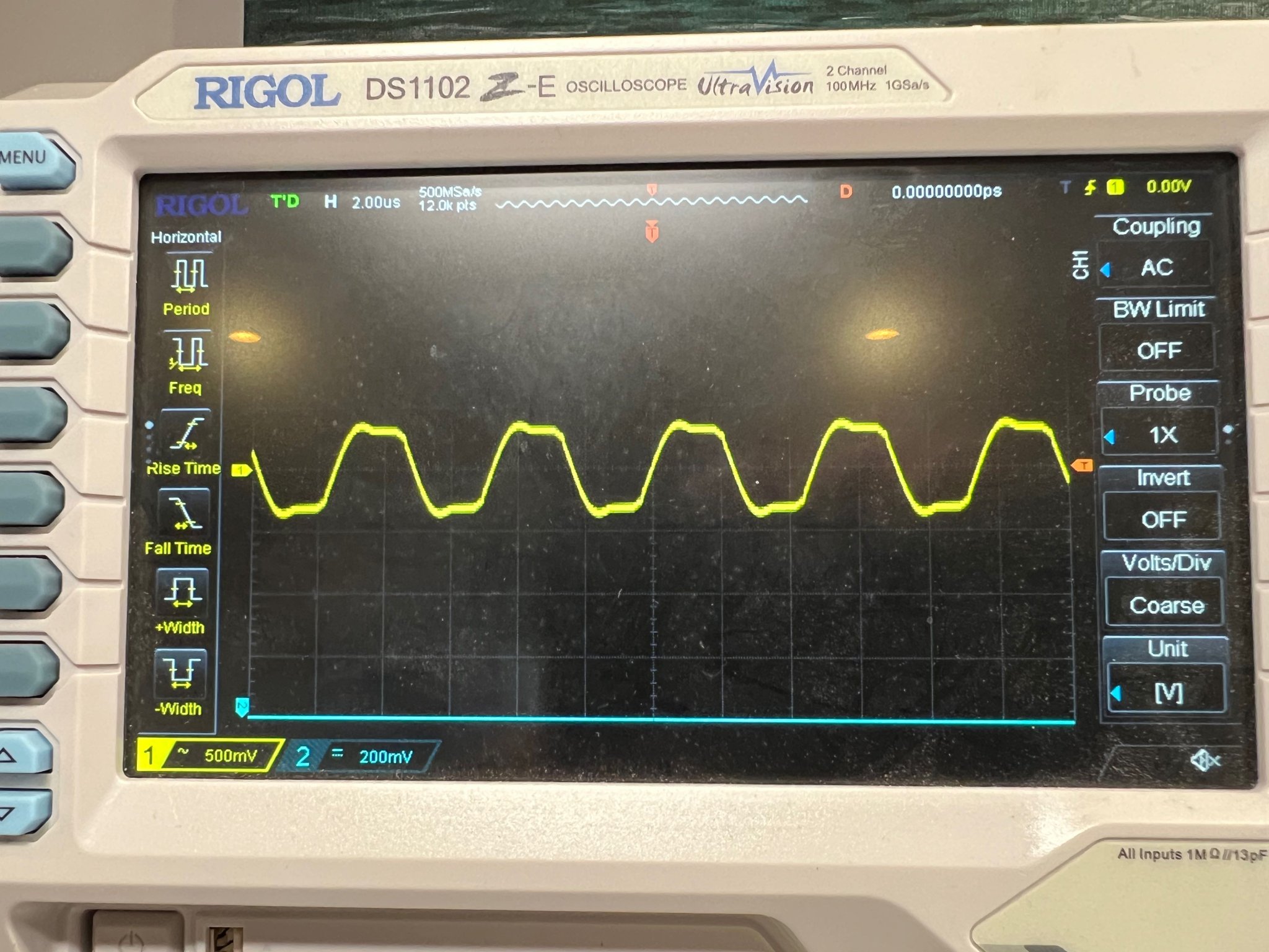

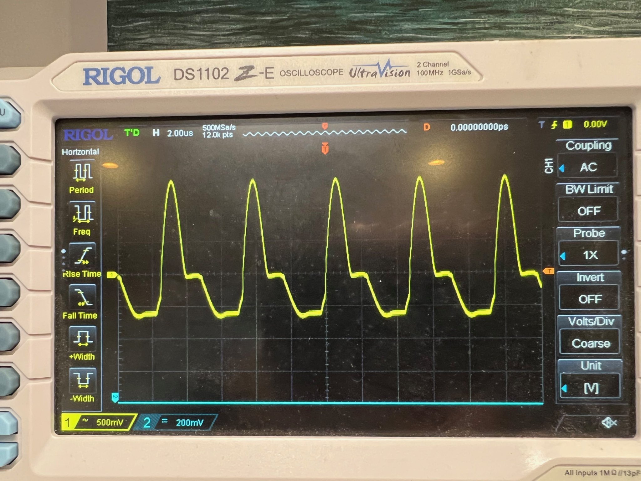

Hi

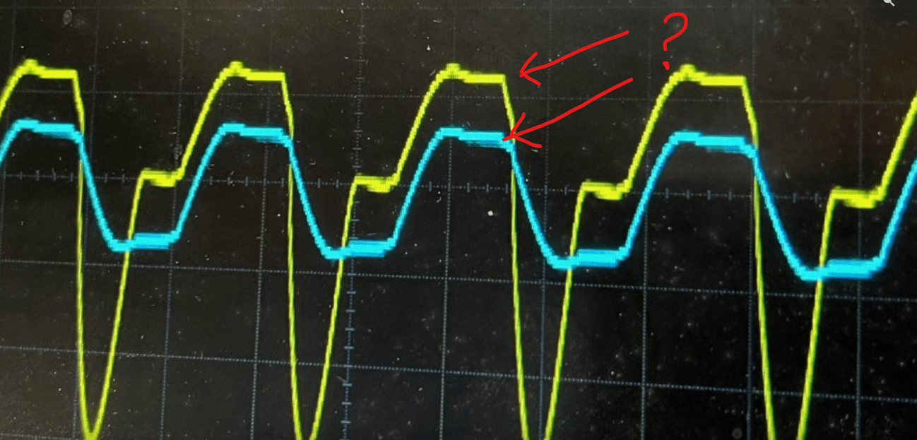

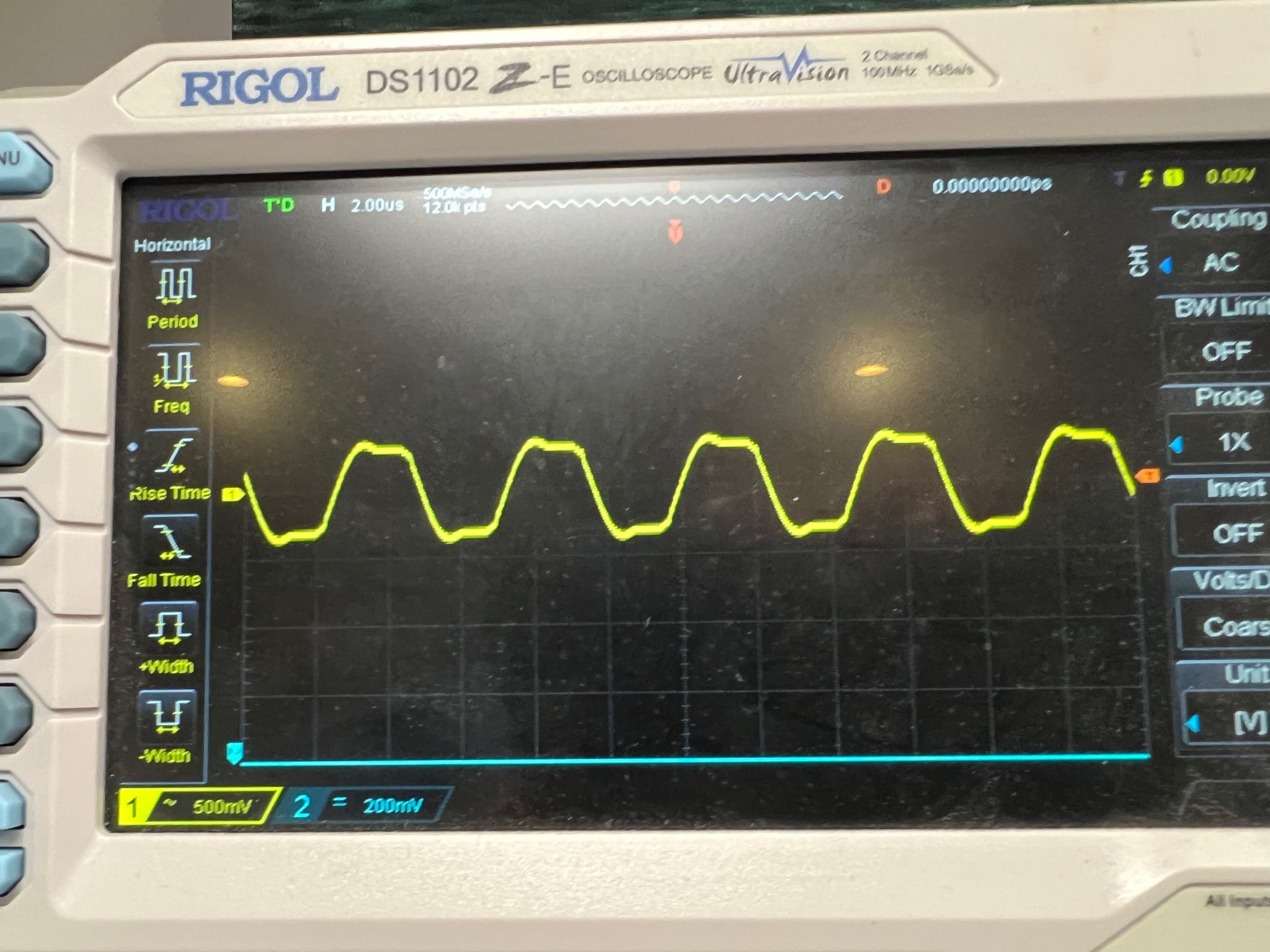

I have attached pictures from the scope with the ground connected to Pin 23 from each end of R62/R65 (they are the same) and TP15,16 and 17 which are also the same as one end of the resistors.
I strongly recommend switching your scope probes to x10 setting. The higher capacitance of x1 probes can provoke oscillation, especially at internal nodes of an amplifier. Switch to x10 and see if there's any change.
Can you just clarify exactly what we are looking at there 🙂 Its not easy without seeing it for real.
Scope grounded
TP15, 16 and 17 are effectively the same point with no output transistors fitted and should all show the same. Is that what we see in the last two images?
The voltage on R62 and 65 needs more info 🙂
You need to carefully look and see if whatever is on those resistors is generating more than around 0.6 volts across the resistors. If it is then it will turn the outputs on and draw current.
Using both scope channels and with both calibrated and set to overlay each other look at the voltage on each end of the resistor simultaneously. If both channels perfectly overlay each other then the outputs can not turn on. If they are separated by at least 0.6 volts then the outputs will conduct.
Even if the DC offset is not zero they should still overlay. If both were sat at +10 or -10 the outputs are still off. It is the difference between the two that matters.

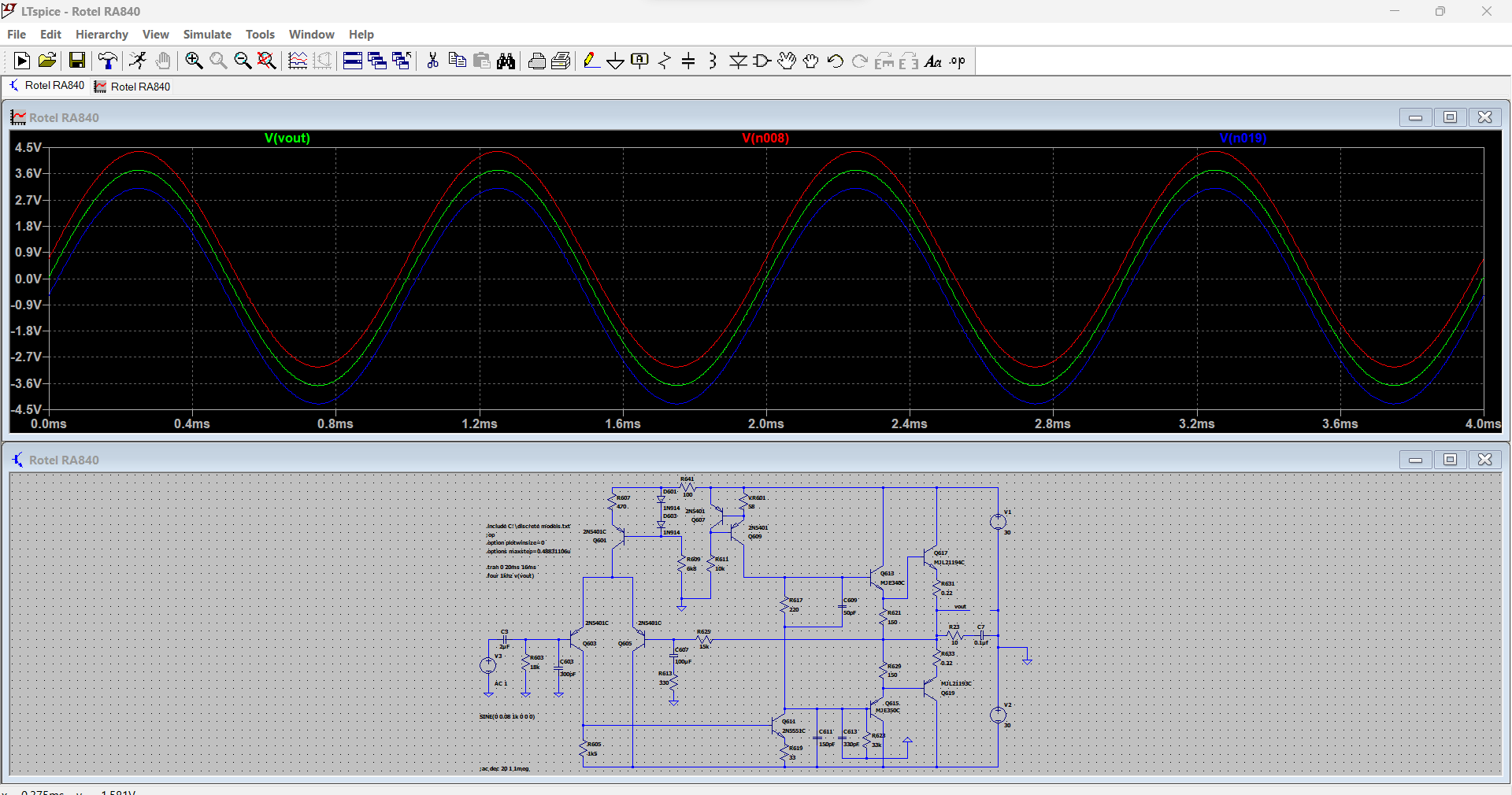

This is just a simulation but it shows what happens. The amp is biased correctly and there is no load. The green trace is the output node, the red trace the other end of R621 and the blue trace is the other end of R629

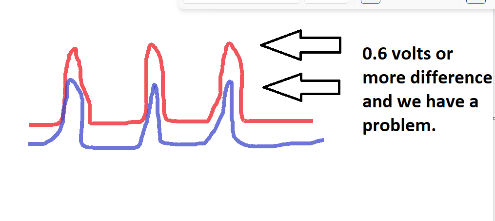

This is biased correctly remember. The input is 1kHz. The two other traces are separated from the output node by that magic 0.6 volts. It is 0.6 volts because the bias is set correctly at this point.
Now with the bias generator shorted. All points are now very similar in voltage and no current flows in the output stage. The three traces are still all present but almost perfectly overlaid.
So in your image it is the voltage difference between the two that is important. If this exceeds that 0.6v then transistors start to turn on. If the frequency is very high then the transistor conduction begins to overlap because they can not turn off quickly enough and that can cause a current to flow in both. Few a few tens of kHz that shouldn't happen but beyond that it will become an issue.

There is not enough description to me, is the scope picture taken with some input signal, or something else is going on.So one probe at each end of resistor, both traces aligned on top of each other, with DC/Gnd/AC coupling all grounded at TP 23 and probes at 10x
Next pictures should be taken with visible scope settings like Mooly said, voltage per division (volts/div)-vertical units, time division-horizontal units or time with ms, us or ns (seconds). I think that your scope have this details on the screen, but they should be selected to be shown.
After that I will have something to say...
Sorry
Maybe, but I don't know the meaning of 2us, maybe it is horizontal scale, maybe is hold of the signal taken...
It would be nice to write down some details, input signal is not determined (is it still grounded). Every manufacturer have some custom details of the settings, I don't know Rigol, it is similar to my GW Instek, but...
In your situation I would test whole input without output stage and determine that there is no oscillation, take every step to remove this kind of operation, check every trace of the circuit board, maybe something is broken and you don't have good connection (you said that you changed some ELCOs), during this operation breaking some part of the trace is possible.

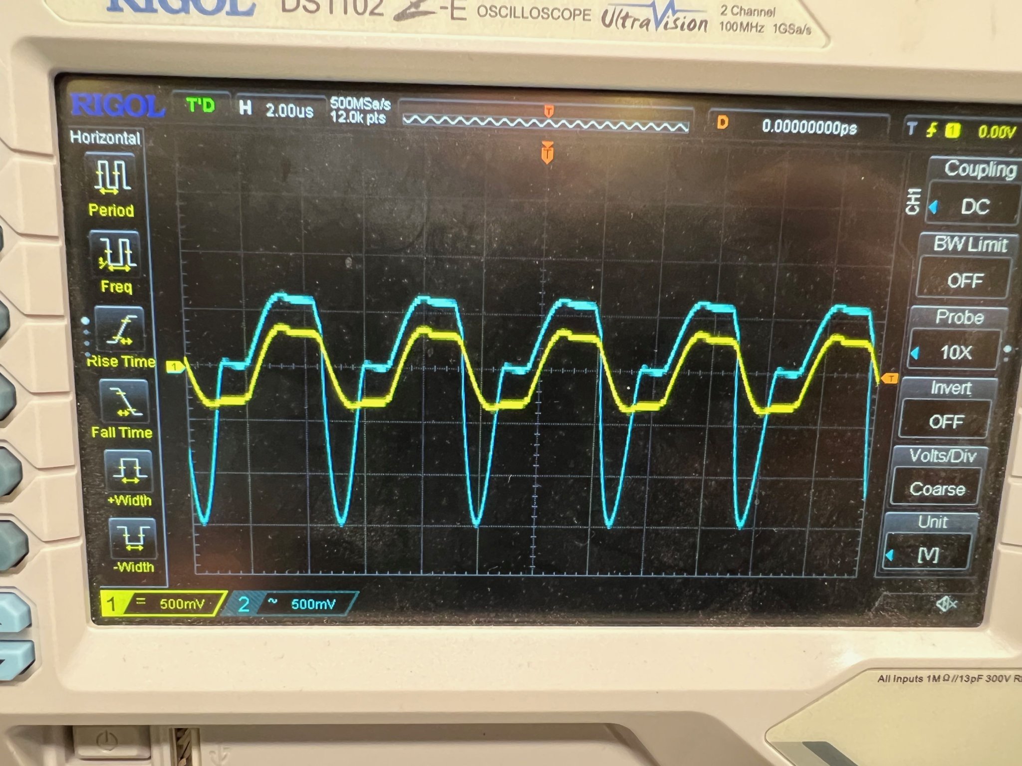

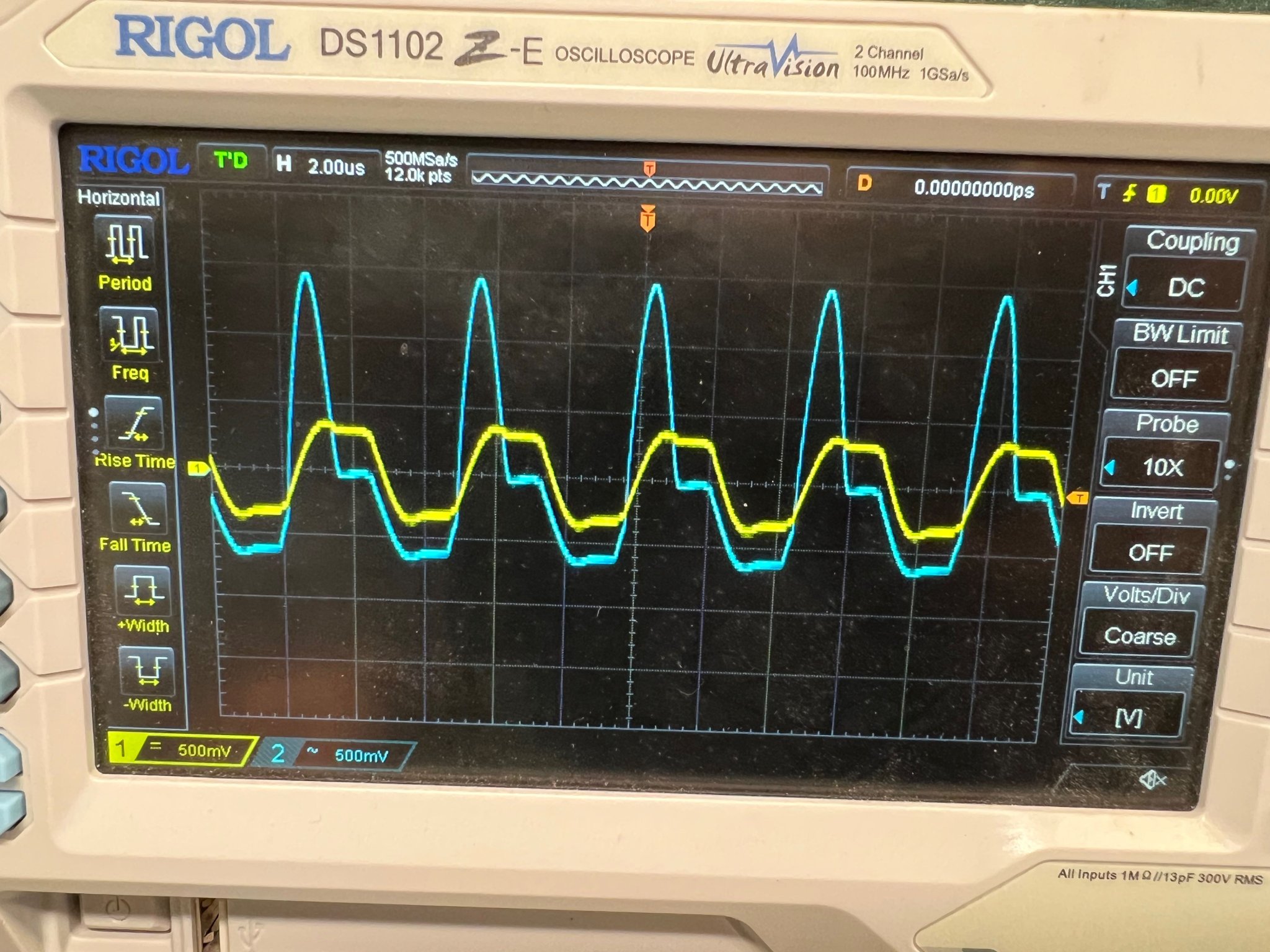

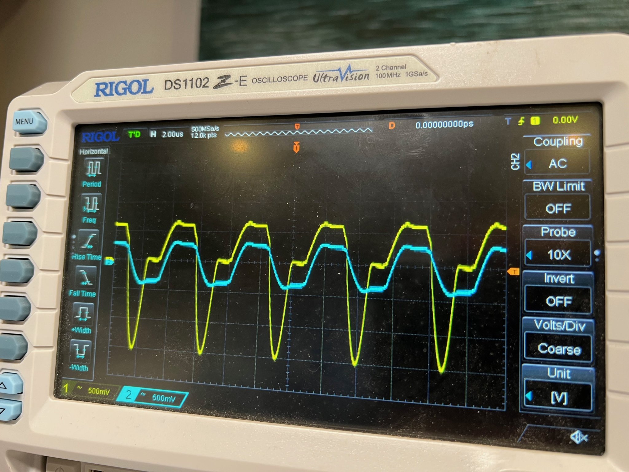

@Mooly
So following your instructions ( I think)
I calibrated the scope.
Tested both channels at the join of R62/R65 and they overlaid perfectly
Then checked across R65/R62- the first image is R65 and the second R62
If I am interpreting them correctly there is about 0.25v across each of the resistors
