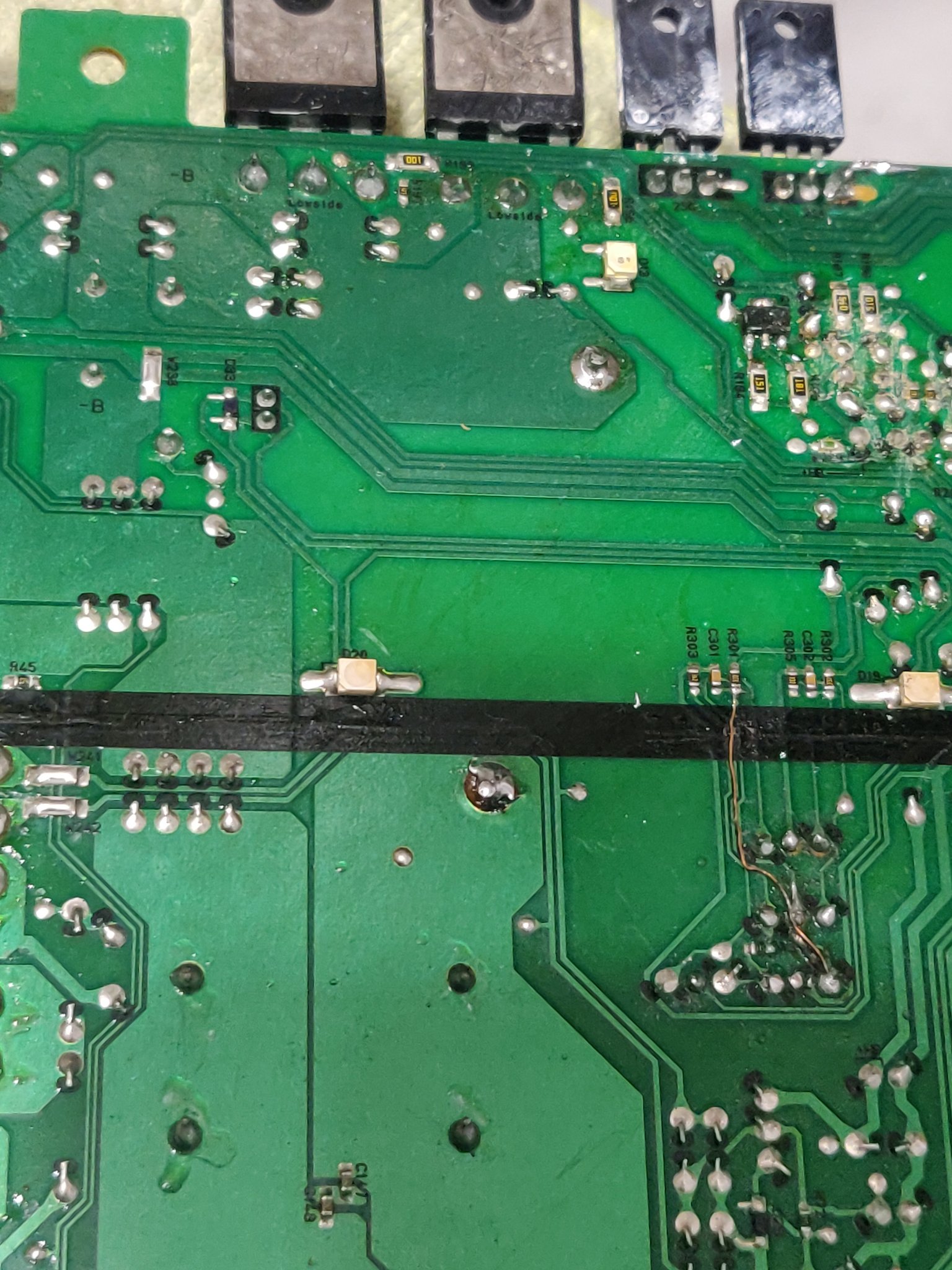

The behavior of IC6 pin7 when probed/touched had me wondering whether the solder connection was good so I resoldered the leg and all components in the area of that trace. IC6 leg 7 now reads -5.0 to -5.2v consistently. I think the connection at the junction of C132 was not good. All of the squealing behavior has stopped and the amp no longer shuts off when the ICs are probed.

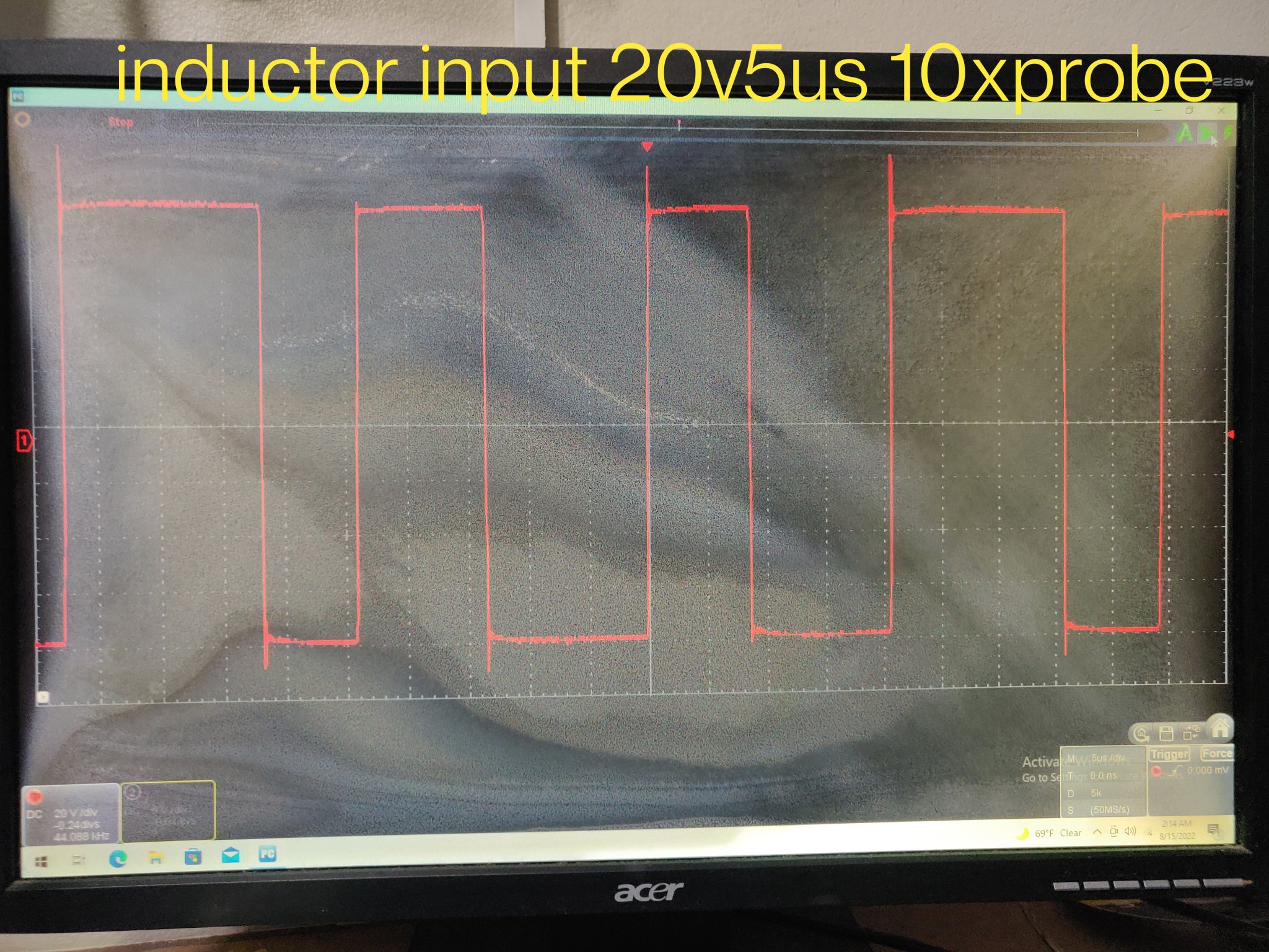

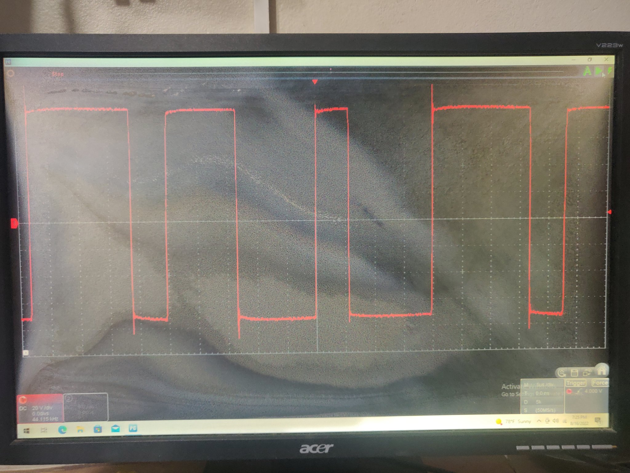

I would have to reassemble it and test it tomorrow but it still seems that the inductor is getting hot very quickly. Isn't that abnormal?
I don't think that's normal. Do you still have an irregular pulse width on the input of the inductor? Every pulse should have the same width.

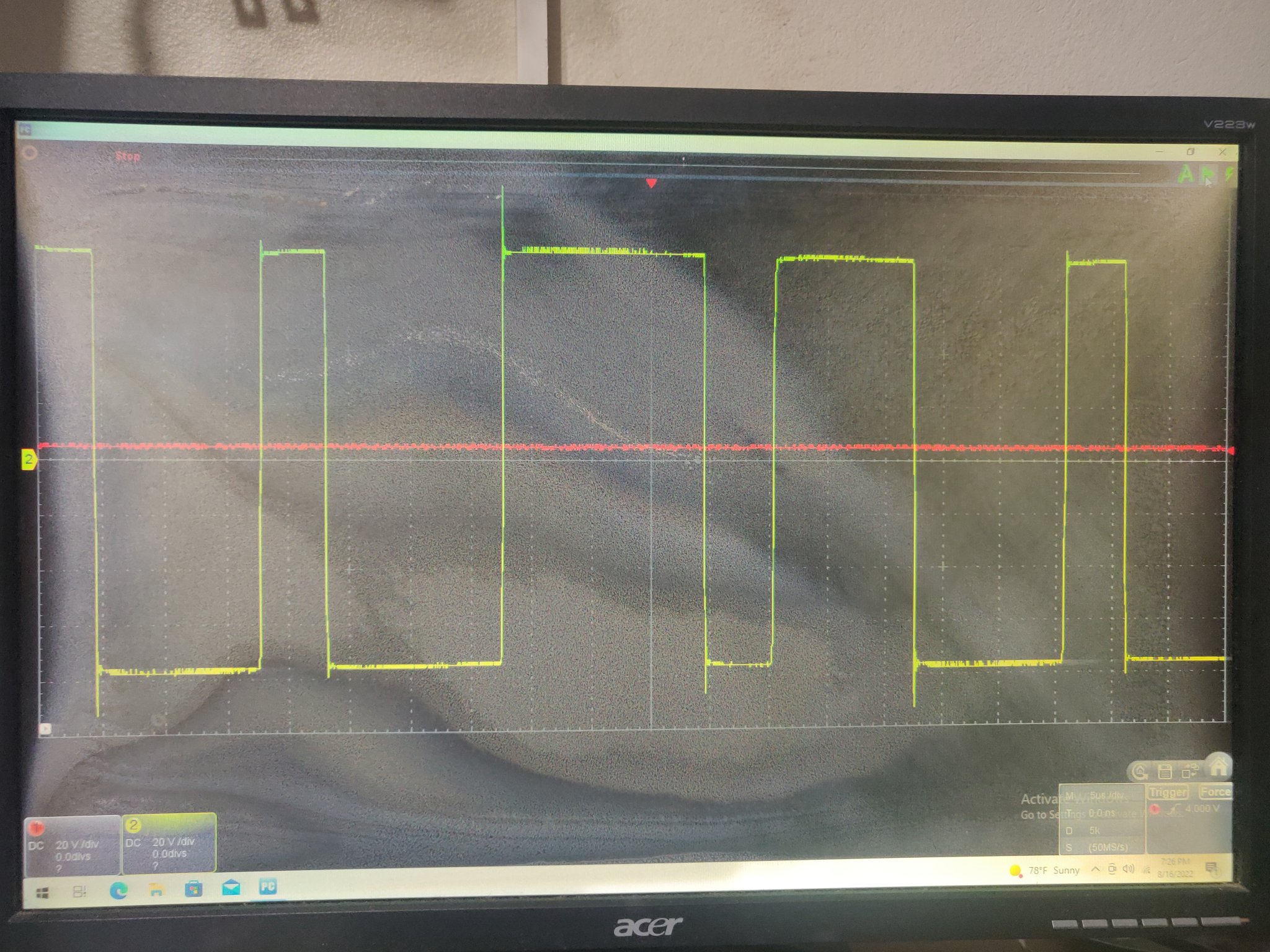

Screenshots are of the inductor input with both probes grounded to input GND. The square wave pattern is still irregular.
