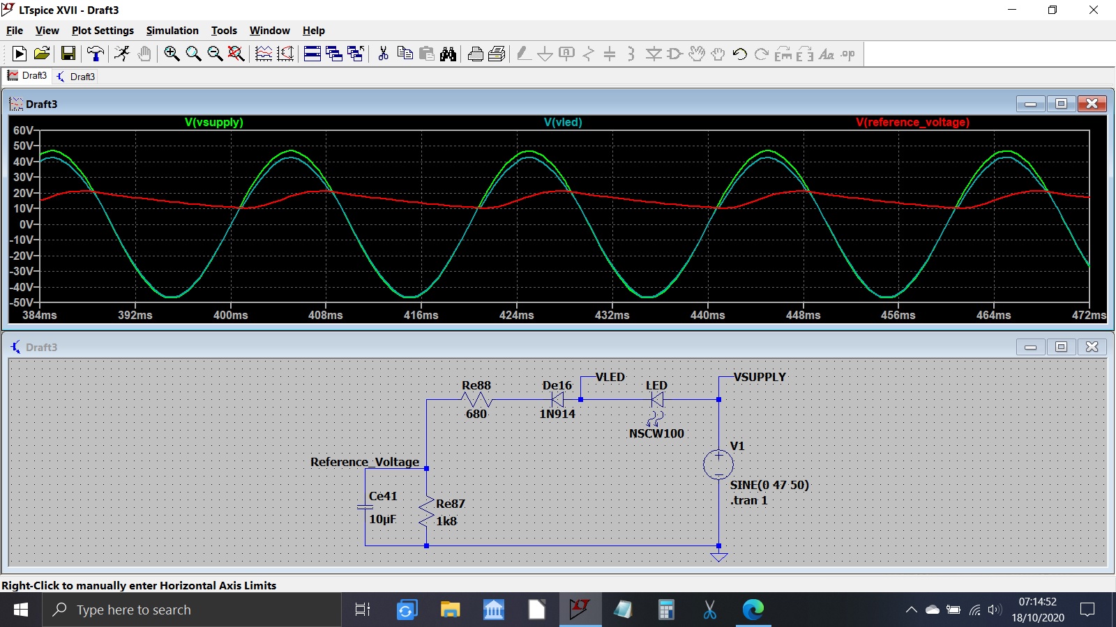

I drew those components out in a simulation so that you can visualise what is happening.
The first diagram shows a simple DC version where the transformer is replaced by a 33 volt DC supply.
There are three key points marked, the supply, the LED voltage and the 'Reference Voltage' which is the 19 volts we needed.
The second diagram shows it all dynamically with an AC voltage source driving it. You can see the 19 volt produced (the red trace) has lots of ripple present... and that is by design and because of the small value of the cap across that supply.
The 19 volt reference serves a secondary purpose here. It allows the relay to drop out near instantly when you switch off rather than relying on the power supply caps to discharge enough to let the relay drop out.
When the mains voltage disappears that 19 volt rail collapses quickly because of the 1k8 resistor across the 10uF cap.
Once the 19 volts has dropped the relay is turned off smartly even though the main reservoir caps are still almost fully charged and the amp still operating normally.

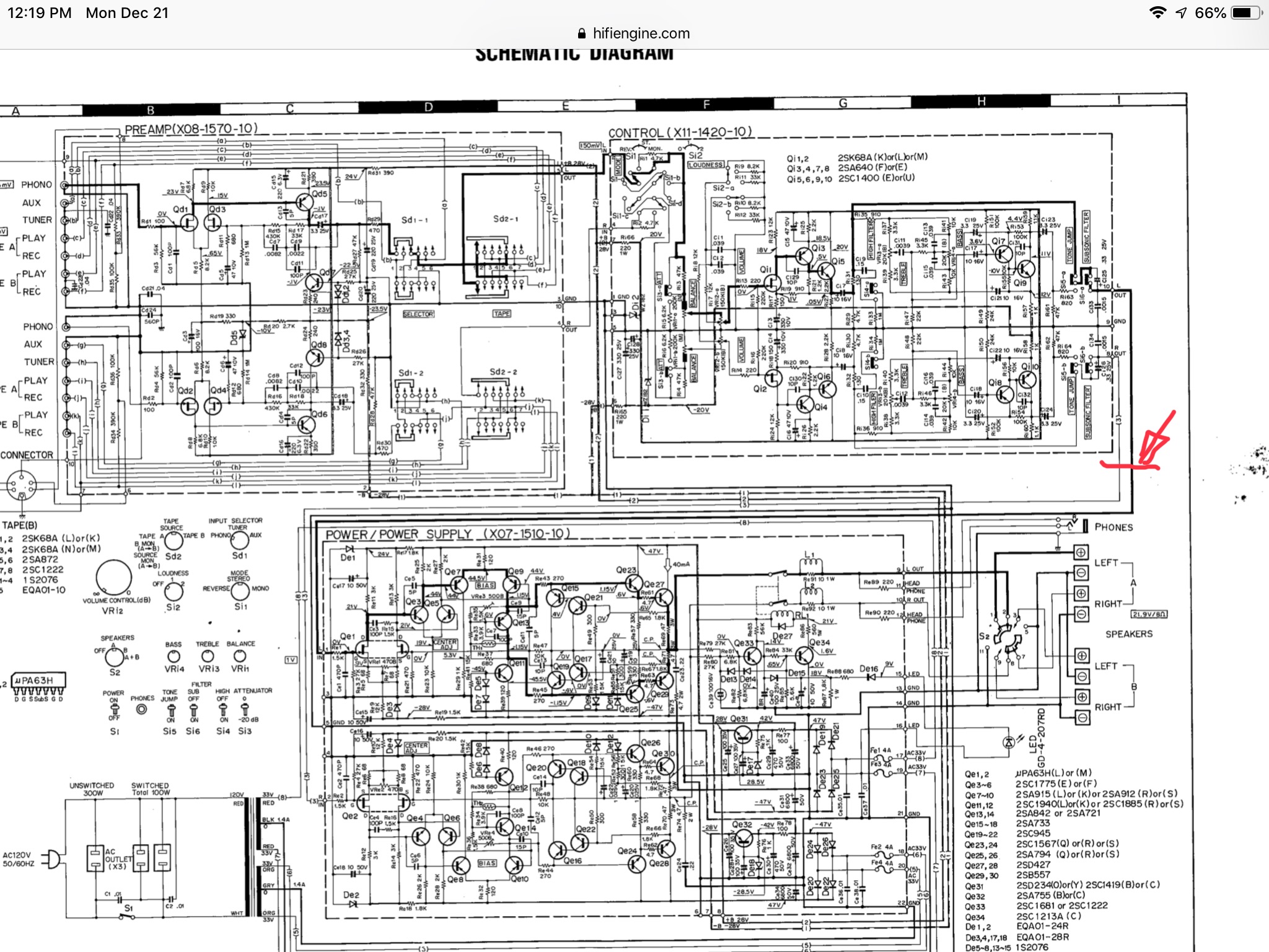

I am really pleased with the performance of the KA7100, and I am considering adding pre out and mains in rca connectors to the rear panel.
I assume that, from the attached schematic, all that is required, after the connectors are installed, is to connect the output(pins 10 and 8 on the control board) to the respective R and L pre out connector, and the input(pins 1 and 2 on the amplifier board to the R and L mains in connector. All four connectors grounded to chassis(?) or ground points on the control board and amplifier board.
Is it that simple, or am I missing something?
The reason for the mod is to be able to use a minidsp and additional amp.
