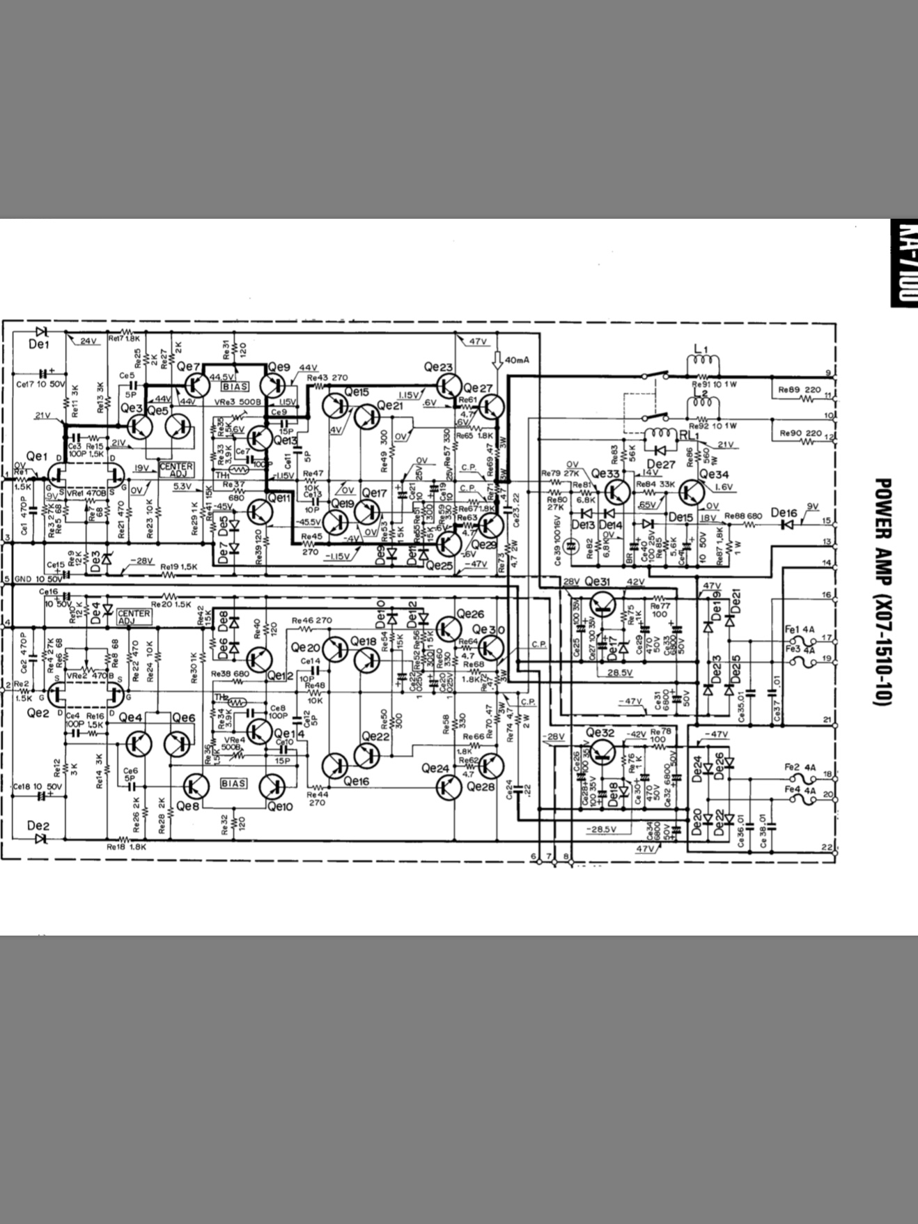

I triple checked all the new caps for polarity and checked all the voltages indicated in the service manual power amp board circuit diagram.
All voltage readings on the entire board are good except for the following:
Qe33 should be 14v, measures 1.9v
Qe34 should be .65v and 1.6v, measures .28v and 47v
RL1 should be 21v, measures 47v.
Re87/88 should read 18v, measures 1.3v
Pin15 should read 9v, measures 0v

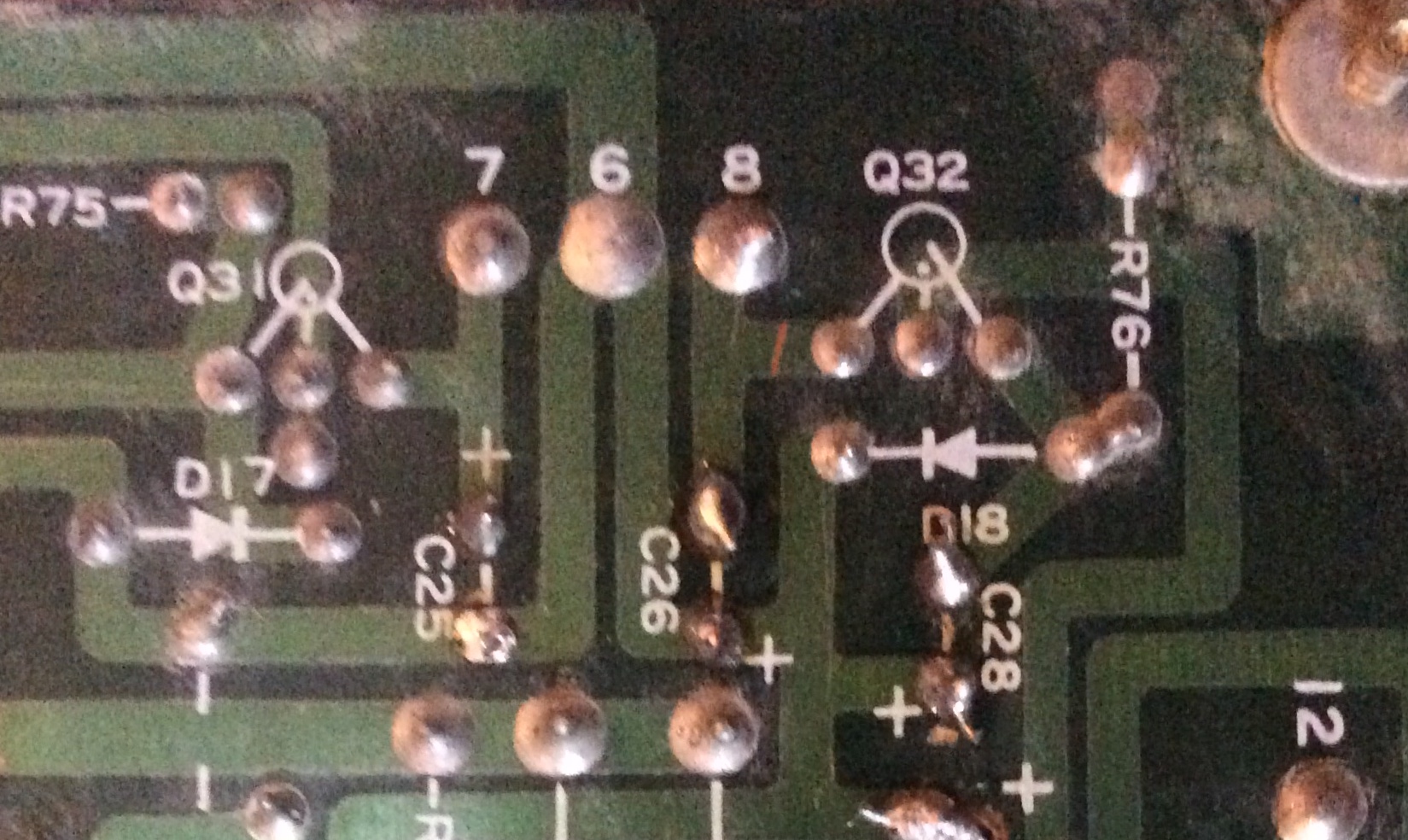

Here’s a picture of the board showing pins 7 and 8 and their respective transistors. Opposite of the circuit diagram. However I assume that is not a significant problem, just a mistake.

I agree. I just mentioned it to acknowledge that the circuit diagram is not infallible.

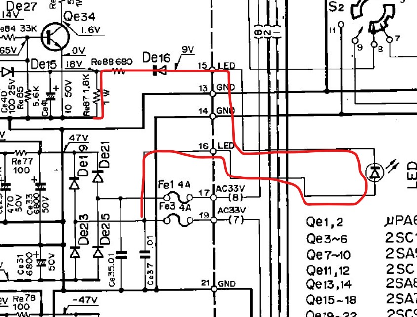

You need to check the DC voltage across Ce41 (bit blurry) where it says 18 volts. Where it says 9V on De 16 I think will be 9 volts AC and not DC.
If that 18 volts DC is missing then the collector of Qe33 will be pulled to a low voltage all the time.
That sounds to low based on the diagram. That 1.8k resistor is shown as 1 watt and that confirms that there is normally a high-ish voltage there.
You need to to work from that point back to where that 9v goes (or rather comes from).
I suspect that voltage will be missing.
See what voltage is on that diode on the anode (the 9v end). Try measuring both AC and DC voltage to cover all possibilities.

OK, this has to be something basic...
Look at the circuit and trace it through.
You have 33 volts AC applied to one end of the LED. Check and measure to confirm that is so.
Also if the LED is not lit then there should be zero volts across the LED. If there is lots of voltage across it then it is probably open circuit.
De16 rectifies the AC.
The 680 ohm and 1k8 are in series and go to ground.
So you have an LED across 33 volts AC with a series limiter resistor and diode rectifier. The LED has to light. The low voltage across Ce41 shows that the LED should have its full current available and be really bright.
Something around there is open circuit or missing. Trace it through.
This is the current flow path. Nothing in the amp can stop the LED lighting. You have confirmed the voltage across Ce41 is very low. That leaves the 680 ohm as the main limiter resistor and it will/should be fairly warm or even hot.
