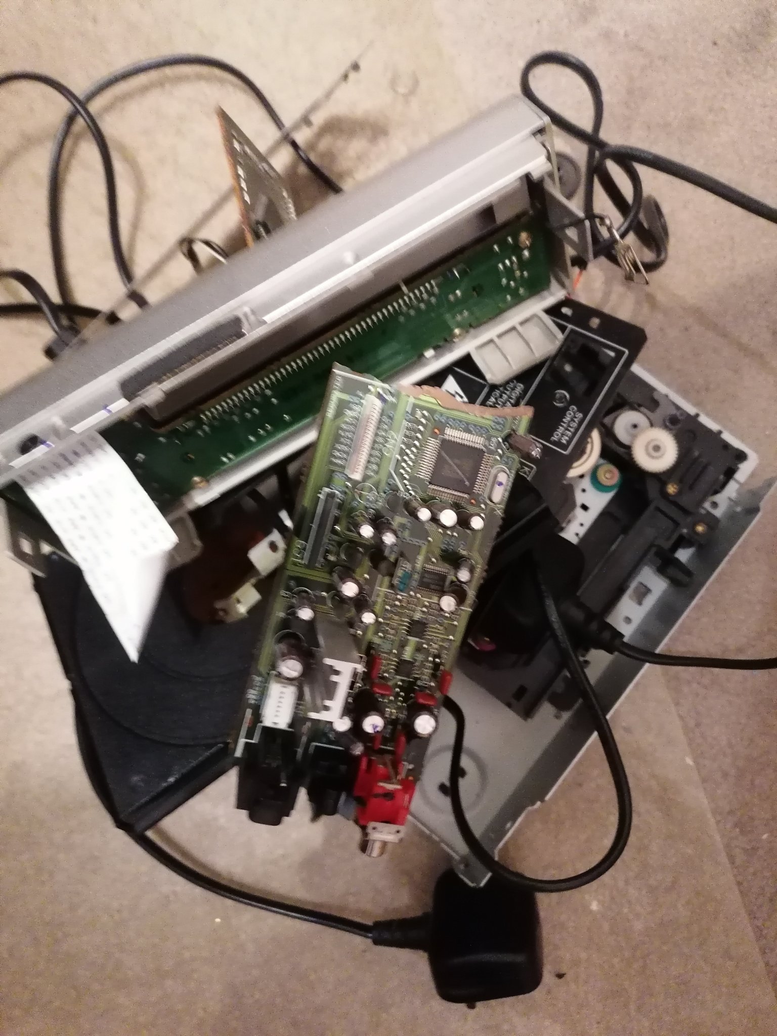

From the pictures the player looks to have the transformer board, the main board down the side of the player, the front panel board and the mechanism. You know both players are faulty in some way and that they have different faults.
Decide on one player to try and fix and note exactly what the symptoms are. Now swap in turn the main board, the mech and then the front panel and at each point see if the symptom changes. If you swap a good board for another good board or a good mech for another good one then the symptom on that player should not change. You have to use a process of elimination to try and find where the fault is.

Current situation to recap:
Player 1: absolutely dead and hasn't ever in my possession powered up - board has broken rails
Player 2: powers up for a moment and then powers off
Action taken - I swapped out the psu and main board from unit 2 and put it into unit 1. First time I powered this combination up the lcd remained lit until I pressed eject and since that point the player behaves exactly like player 2.
This video shows the behaviour:
Unless both players have the same problem with the disc carriage and additionally player 1 had a problem with the board - the issue must be that main board from player 2 that is now in unit 1 - if I am not mistaken. But remember this combination of parts did power up the first time I tried them. Something happened when I pressed the eject button - increased load that has blown something?

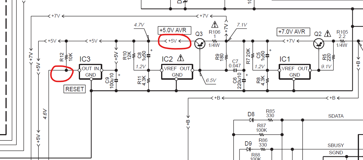

Can you measure the voltage on Q3 collector as you press that power button. We know the 5 volts is OK when its not doing anything but does it drop even momentarily when you press that button? So you have to connect your meter carefully and then watch what happens to the voltage.
Also can you measure the voltage on R12 at the end that goes to the reset generator chip. Again measure the steady state voltage and then see if the reading changes momentarily when you press the button.
This is more scope territory tbh but your meter might just show something. The meter reading should stay constant for points. If the 5 volt supply dips it may be generating a reset pulse but whether your meter can capture that is another matter.
At face value those readings are all OK but as I say, its really scope territory because that would capture much shorter glitches.
I was wondering if the 5v rail was dipping under load momentarily which in turn generates a reset pulse from the reset generator chip and that reset pulse then sets everything back to standby.
