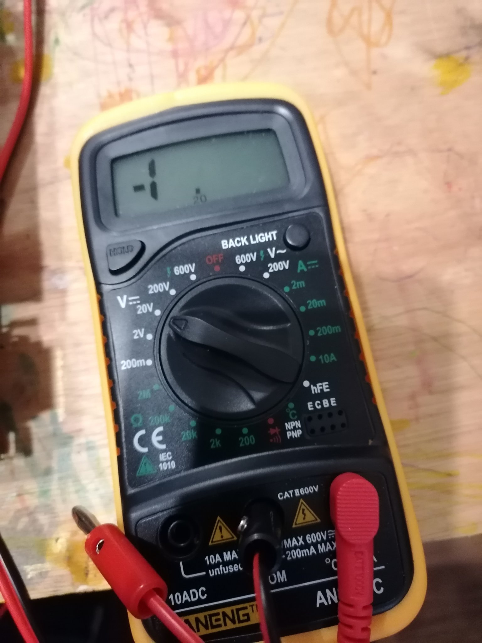

Should I try the readings again with probes attached as I try to power up looking for voltage drip, these readings were taken with case open in standby mode.
For your own curiosity yes, then you know what to expect. It is as adason says, your meter is on wrong range.
Yes I see makes sense, would it unreasonable to expect it might just max out and say -20v instead of -1? Presumably it would show just '1' if I tried to measure more than +20 on 20v scale. I guess these are nuances of the DMM I will learn...What do you expect when you have selected 20V scale? Thats how dmm displays out of range. Swith to 200V and measure again.

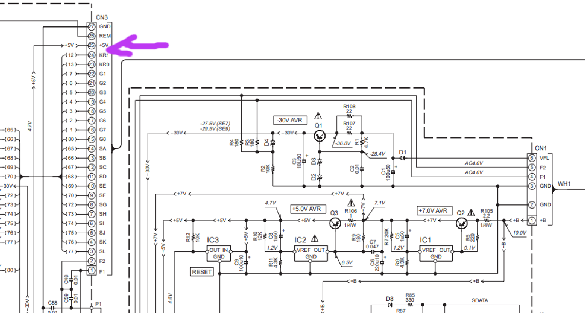

The 4 volt AC is measured between those two points rather than to ground. It is the filament (heater) supply for the display tube and can also be measured across the end pins of the display. The filament supply is not ground referenced but is instead referenced to the -30 rail via R3 and R4 and the Zener D4. That allows the filament supply to float at a voltage set by the Zener which is typically around 5.6 volt. So the filaments will be around -24 to to -25 volts as measured from ground but still reading 4 volts AC between the two points.
If the display is working all these supplies will be OK and these supplies will not stop the player working.

Se we do that by checking all voltages from the power are present and correct even when the player is in a faulty state. That means all the voltages I highlighted in post #2.I'm trying to rule out the psu board before diving deeper into the main board.
I would doubt there is any problem with the display power supply voltages but you should for completeness just check that the 4 volt AC is still present. Easy to measure between R3 and R4 (look at the diagram)the display remain illuminated until I tried to eject

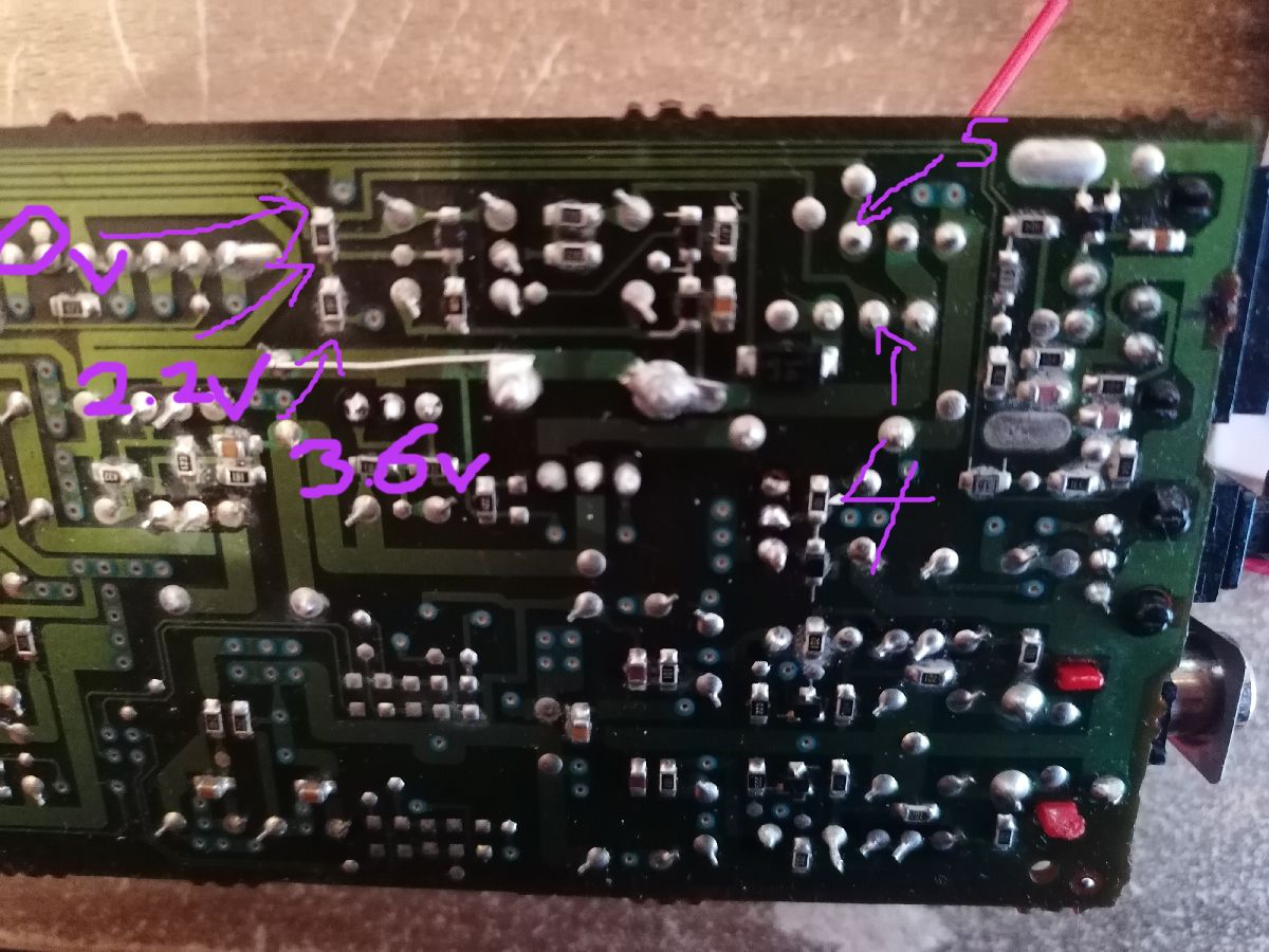

On the unit I am testing which is hooked up only 3.7v on pins 4 and 5. I traced to what I think is R3 and R4 - 3.6v, 2.2v between the two and 0 v on the other side (see photo).
Is the drop to 3.6v expected when hooked up?

It sounds reasonable as the voltage will fall under load. Any problem with the -30 volt rail and/or the 4 volt AC will only affect the glass filament display tube, it will not alter any other functionality on the player.

Q2 is the 7 volt regulator and we confirmed by measurement that the correct voltage (+7 volts) was present on the collector. No further testing is really needed as long as that 7 volts is stable and constant but for your own curiosity...

When your meter is on the diode test range it is actually supplying a small test current from the meter leads and the reading you see is actually volt drop between the probes. So 715, 605 and 226 are actually 715mv, 605mv and 229mv. 600 to 700mv is the normal volt drop across a silicon diode or transistor junction.
With your player, once you have measured all those voltage rails on the power supply and found them OK you have to say that the power supply is OK and the fault is elsewhere.

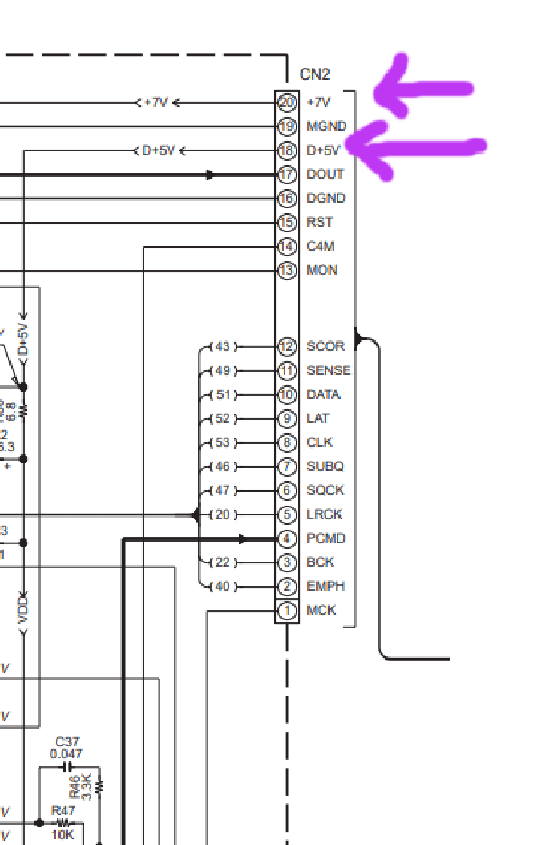

I've traced the 7v and and 5v to the ribbon connectors which look like where they terminate (to me) - I get 5v and 7v and only a slight drop when I power-up.
