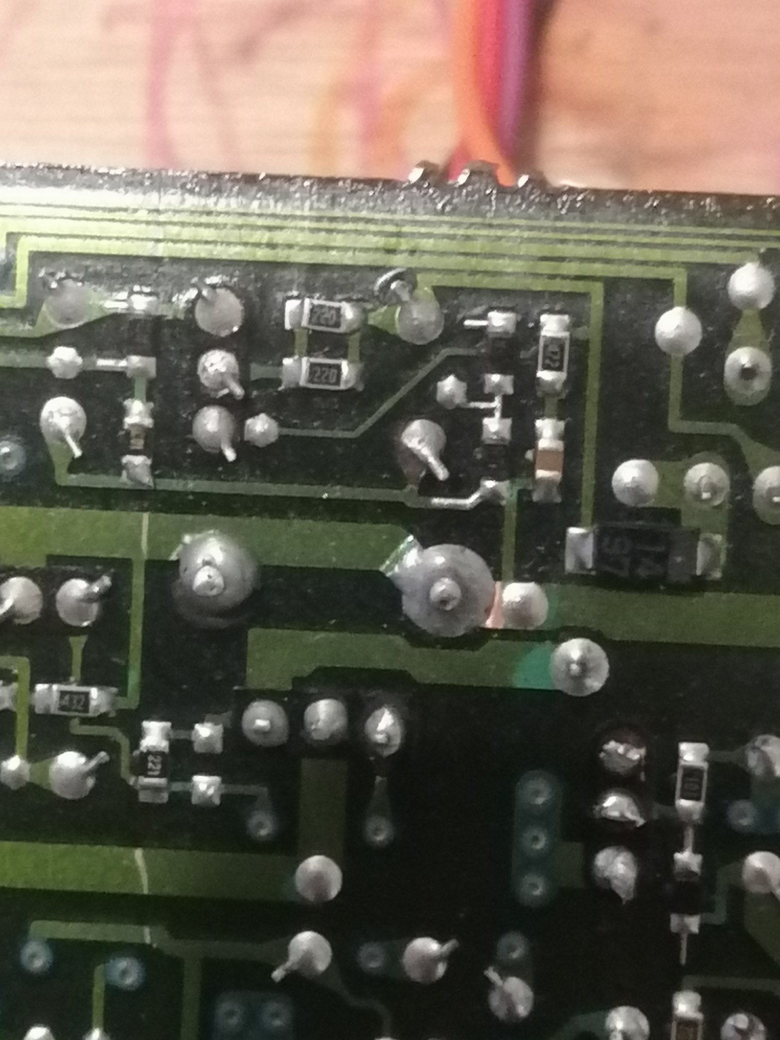

I even have 12v on the heatsink that holds Q2 - here is how it looks after I put it back:
(the heat sink is the 2 large solder points centre of the photo - the 3 pins directly below are Q2)

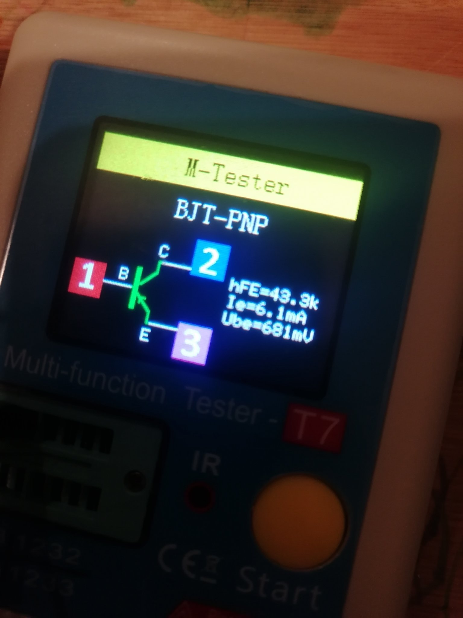

I also removed IC1 and meter tester gives the following:

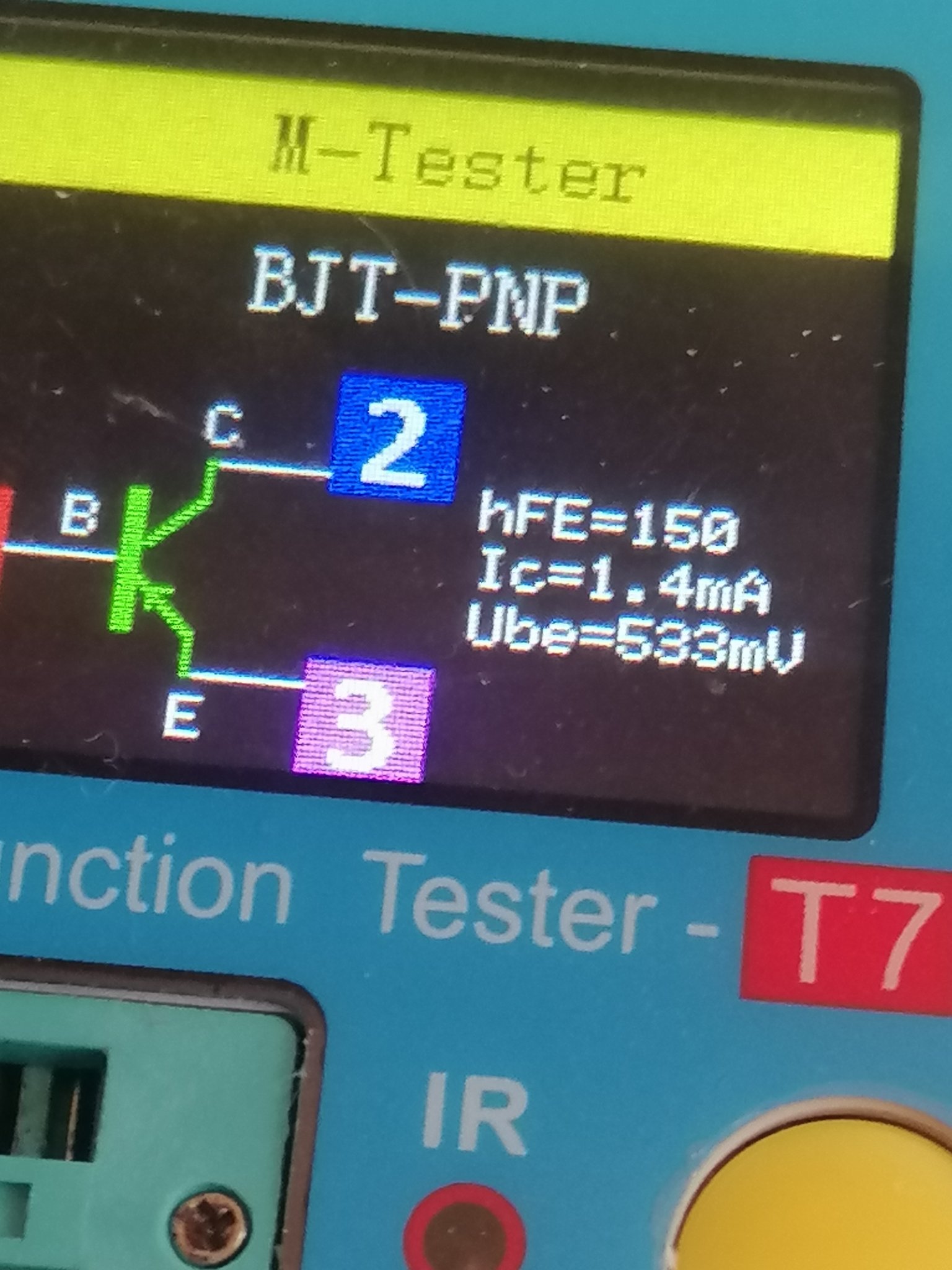

Q3 tested on the board with my tester and I get:

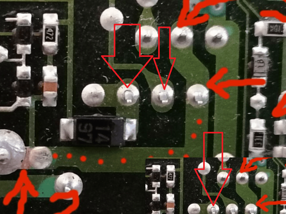

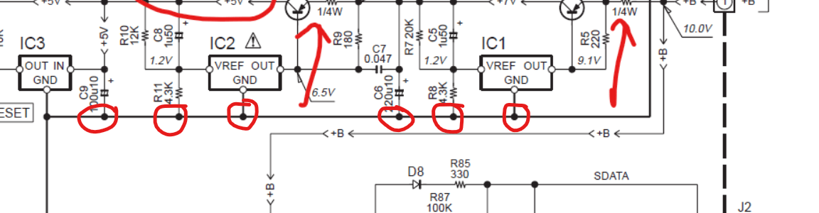

Can you do one important test. Using the identical ground point used for the above measurements can you measure on a couple of these circled points. Measure to the component itself. You should zee 0.00 volts on all.

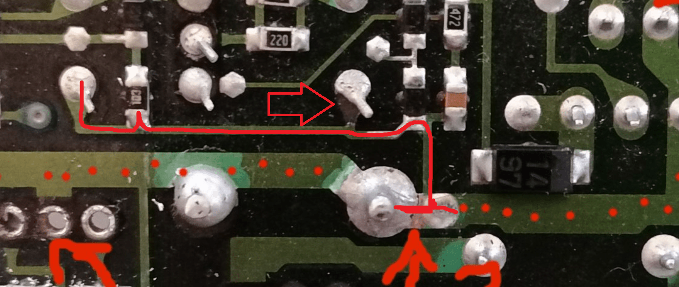

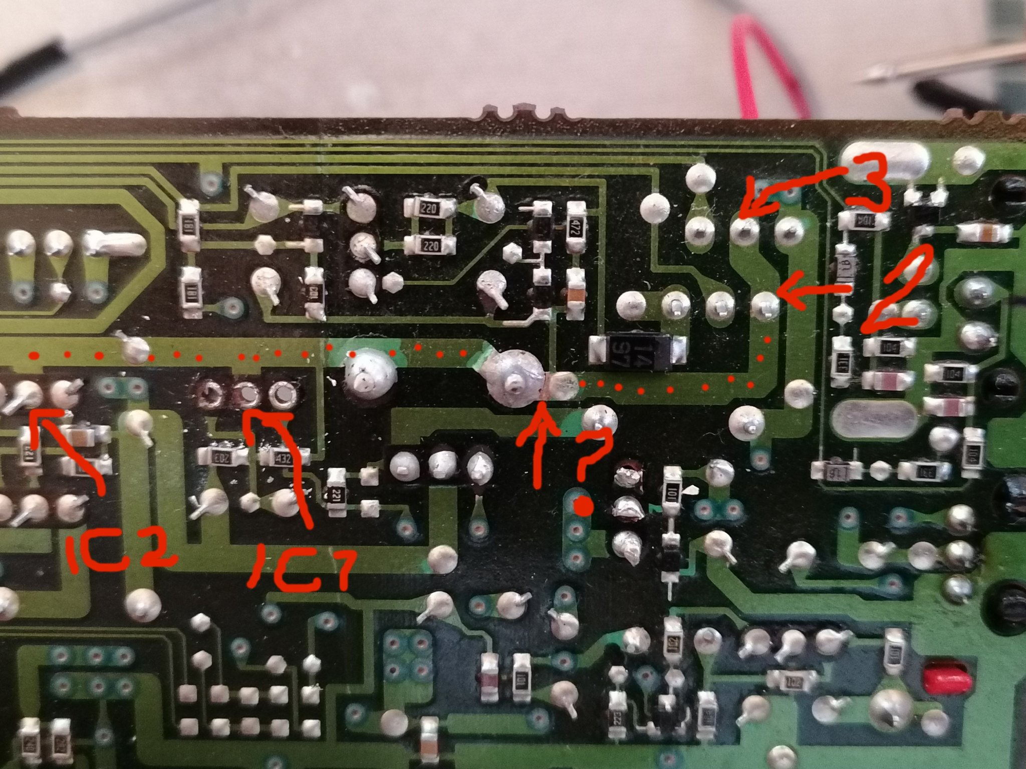

Before I take those measurements I thought I'd take a step back and trace the tracks on the pcb, and I noticed something:

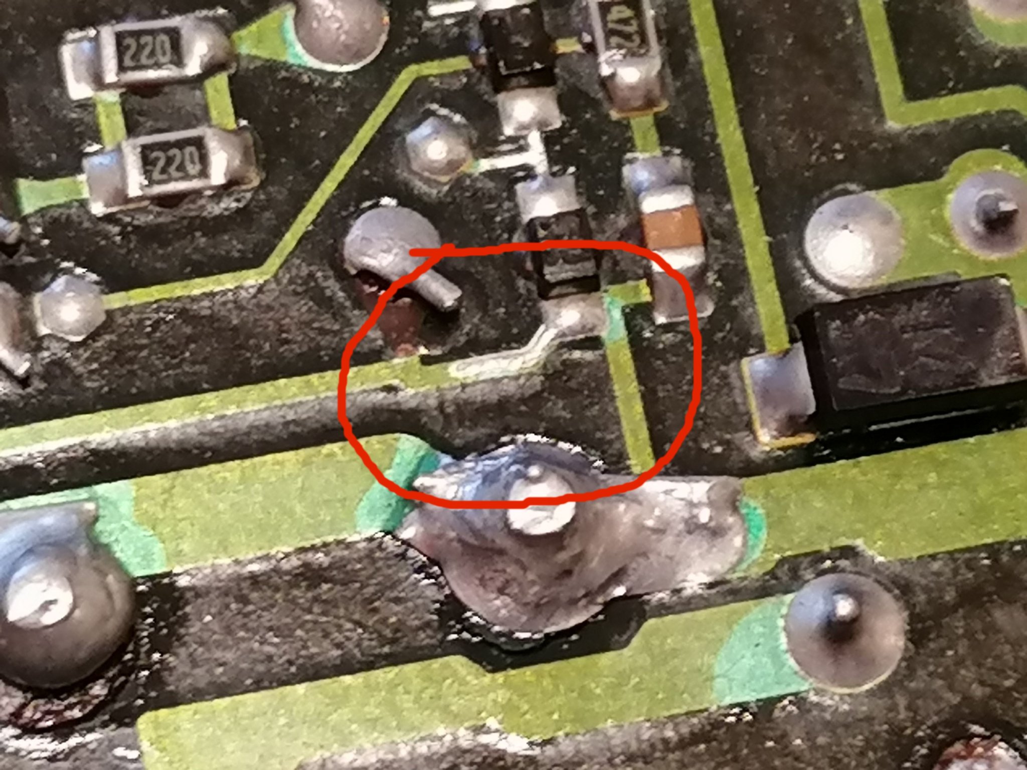

Presumably pins 2 and 3 combine to carry the ground to the centre pin of IC1 and IC2. However using my DMM in diode mode I get an open circuit where my arrow with question mark is. The large solder point is the heatsink which I had to resolder when I removed the mosfet. I'm guessing I need to touch a bit of solder to make there?
Is my logic correct?

The print could well be cracked there. Don't use solder alone as it is fragile and will crack, lay a bit or wire (bit of resistor leg is perfect ) over the break and put solder on to that. Breaks like that are common around pads when any rework has been done.
Hard to tell in pictures bit the other side of the pad looks as if the print may be creased or lifted and so you could add wire neatly to cover those two and continue it to the next pad on the left.

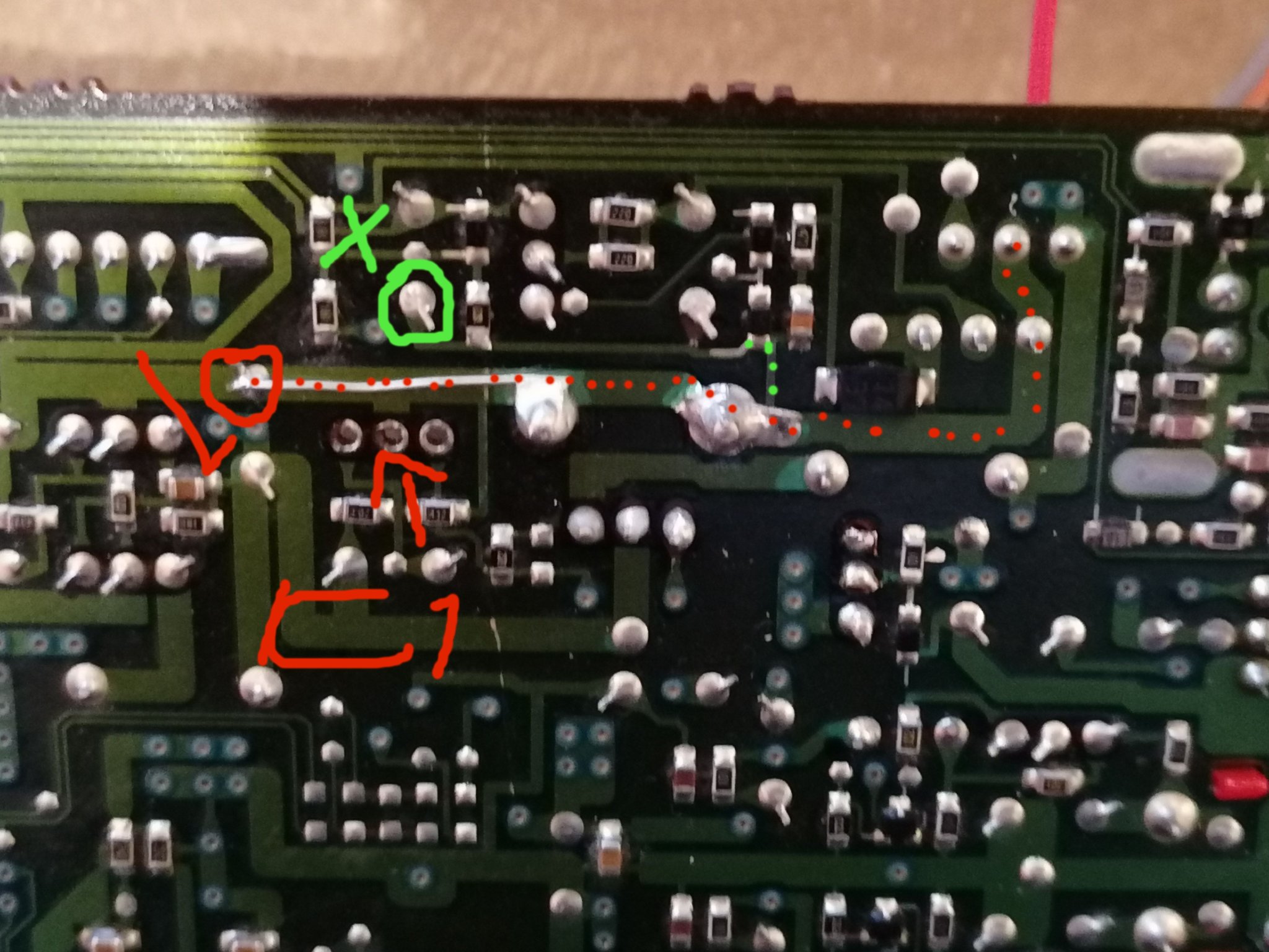

Ok fixed the tracks and I now get continuity to IC1.
I noticed to that I have the ground continuity along the green dotted line to a b solder point. But there is no continuity to the green circle. That is the positive leg of C3 so I gues htat is by design and I didn't break something on that track. Here is a close up of that point where the green dotted line end.
Lets go back to your original picture. There should be continuity all along this track to the main ground. The arrow I have marked is pointing to what looks like missing print. That pad should connect to ground.
Also these joints arrowed are definitely suspect. See how the solder is cracked. This is common, look for other such areas like these.

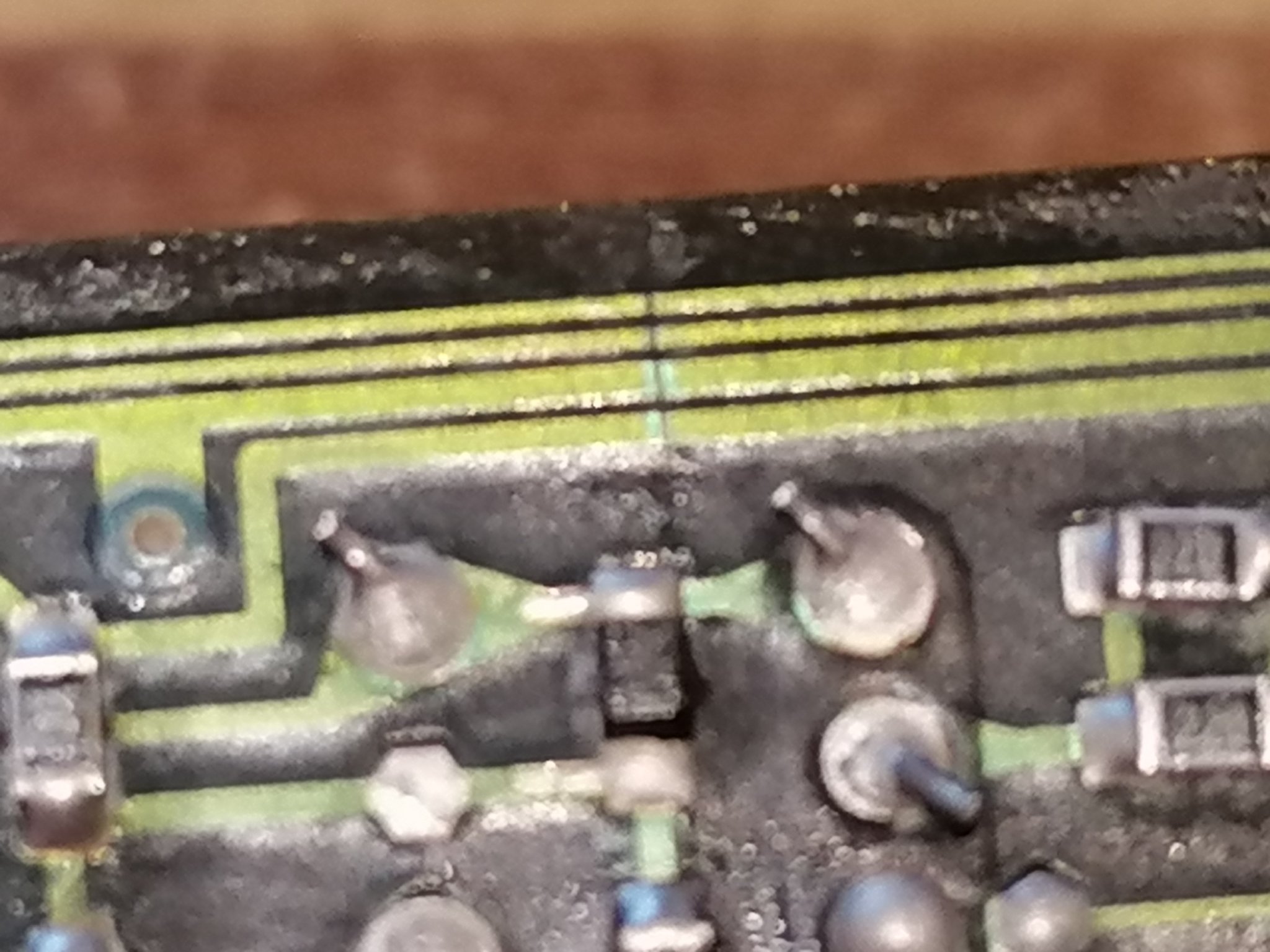

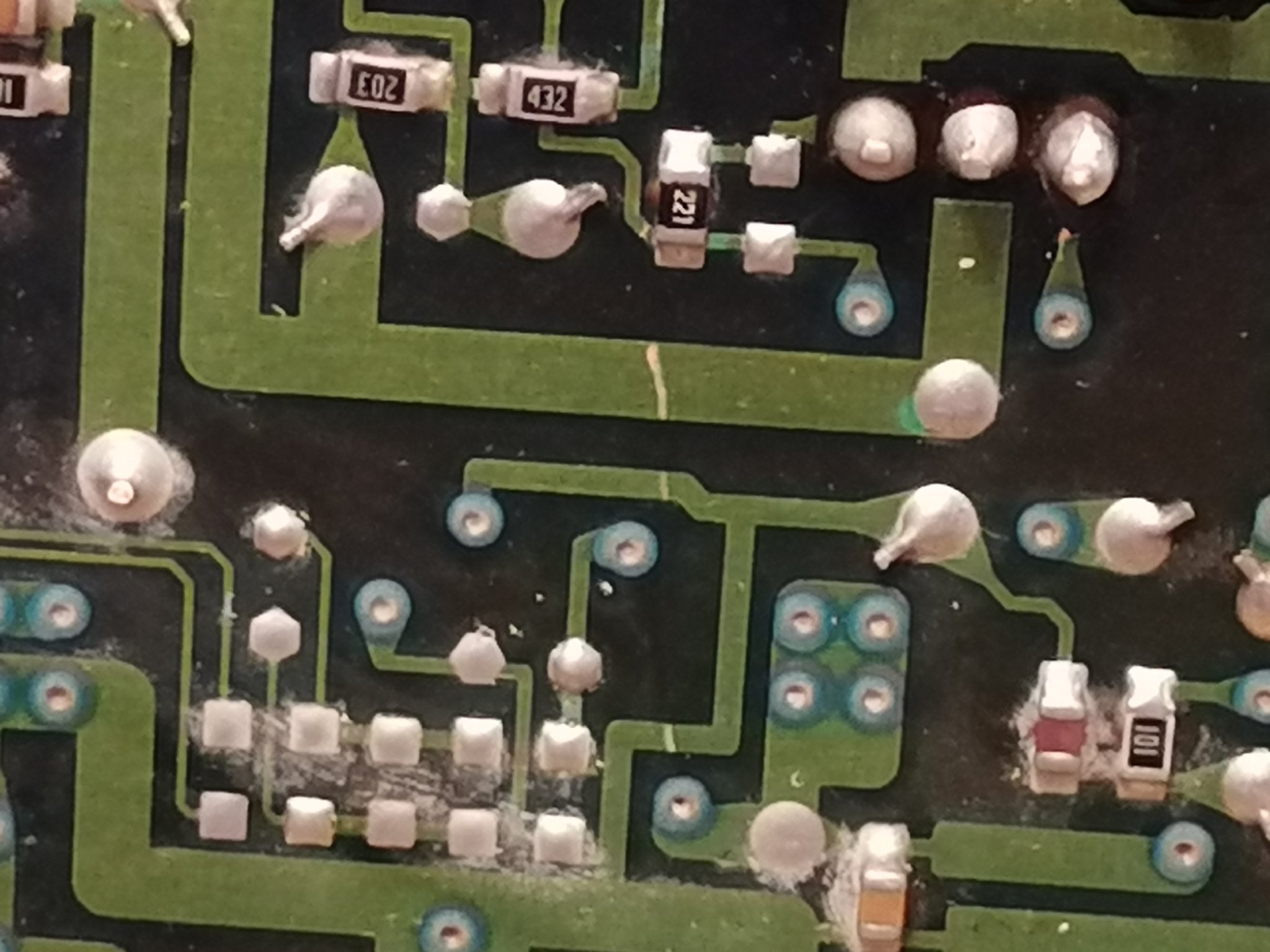

However I think i am fighting a losing battle as I found the following which looks like damaged tracks. One is repairable but the smaller one is around some really fine tracks which I have no chance of repairing.
I may see if I can find a donor machine to swap this board out with as it seems to be a bit of a mess.

Those four cracked tracks (and any others) are a super easy quick fix repair, honest. A few minutes work at most
Use a sharp knife or small screwdriver blade to scrape the lacquer off the tracks on each side of the crack. Tin the bare copper with solder and then just lay wire (resistor leg again) across the break and solder. If you use a resistor leg bend it at 90 degrees and then you can easily hold it while soldering.
Super glue (not that this really need its) bond circuit board material really well. A drop applied to the crack after the repair is done will fuse the board together and make it super strong.
Check visually and if necessary with a meter afterwards to make sure none of the tracks are shorted to each other

I hear you but those 2 tracks at the top of the first image are so fine I didn't fancy tackling this.

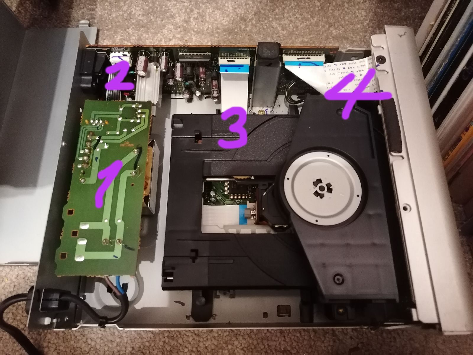

Seems the unit is comprised of the psu (1), the main logic board(2), the drive bay (3) and the front display and buttons (4). Looks like there is another board below the drive bay too.
