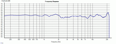

KEF R300 playground - measurements of raw drivers
Measurements are done in room so 4,5ms gate is best i can do which translates to about 220Hz gate frequency. 1m distance. Measurements done 0-90 degrees in 10deg increments. I don't believe i'll be dragging these to the parking lot any time soon, but who knows. Until then:
attachment.php
Averaging them:
attachment.php

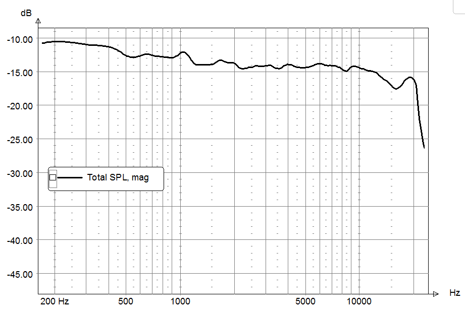

I've been listening these speakers past two weeks and tweaking a bit. Nothing dramatically changed but few details for better phase matching and a bit more linearity. I'm at the stage of putting the crossovers into the cabinets so here's few screenshots:
On axis:

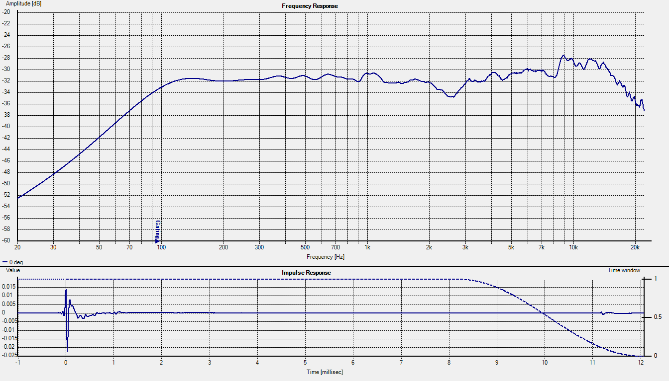

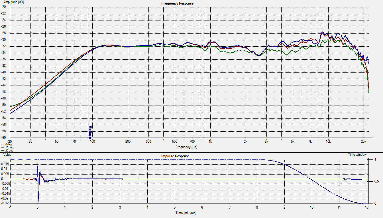

I've made some more measurements last night to see the agreement of simulator to measured response. There is a slight upward tilt toward high frequencies but that could be due to cold (6 degrees Celsius last night). By the looks of it, if it is real, the tweeter is a 1.5-2dB hotter but final level is to be determined indoors by listening. So, without further ado...
On axis:
Off axis 10 and 20 degrees
Up to 45 degrees

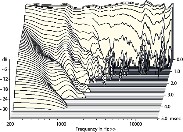

The tweeter level adjusted and some more measurements made. Measurements made are 0-80 degrees. Blip at 900-1200Hz that shows on virtually all of mine previous measurements vanished. Trim ring around the midrange has very tight tolerance so when i centered it better, that aberration disappeared. I'm not saying that i could notice it while playing music (or that anyone could for that matter) but i prefer it gone if i'm to decide.
The only difference from crossover in post 42 is that series resistor on the tweeter is not 0.5 but 2 ohms.

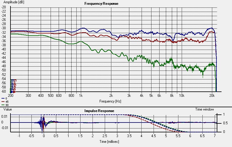

Here are my last three quasi anechoic measurements - done indoors so not without flaws. There isn't dip that large between 1-2KHz in R300 concentric.
This is 0, 45 and 90 degrees frequency response with 2dB grid resolution.
Not too shabby with passive crossover.
