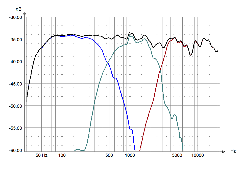

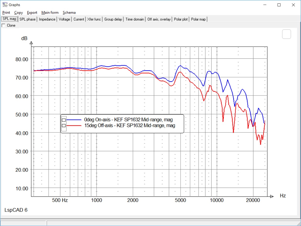

I beg to differ. I think that Kef did much better job regarding diffraction than Goran with his test baffle, which is kinda expected given that he positioned R300 mid-hi on the center of the baffle. Problem is that low resolution on X axis and low resolution on Y axis (the way Goran showed his measurement) leads to wrong conclusions.
When i see 5dB or (worse) 10dB resolution on Y axis and i see, what i believe is, a problem - it always magnifies when i bring measurement resolution to what Geddes proposed: 2dB resolution with 40dB high Y axis grid.
Look how Goran's measurements look now...

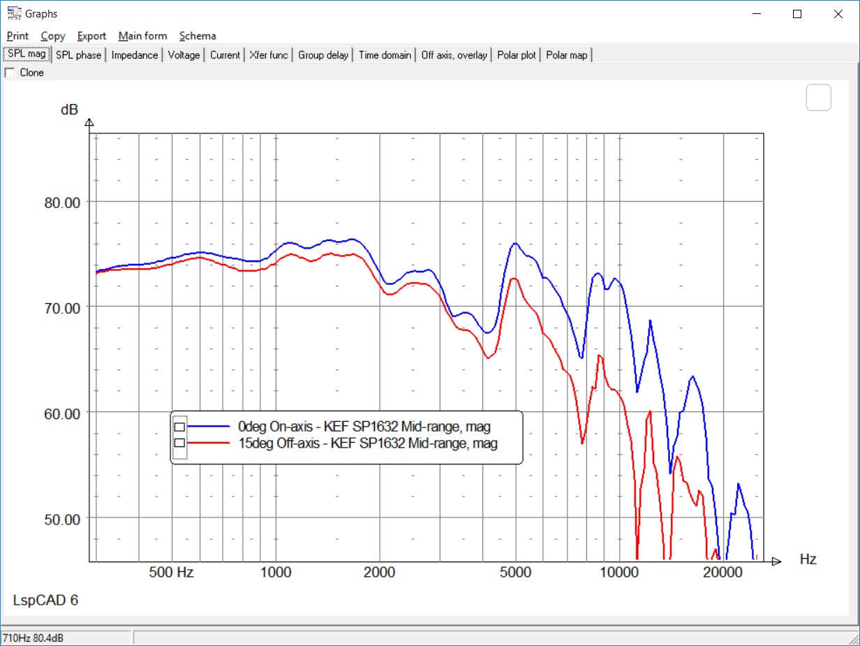

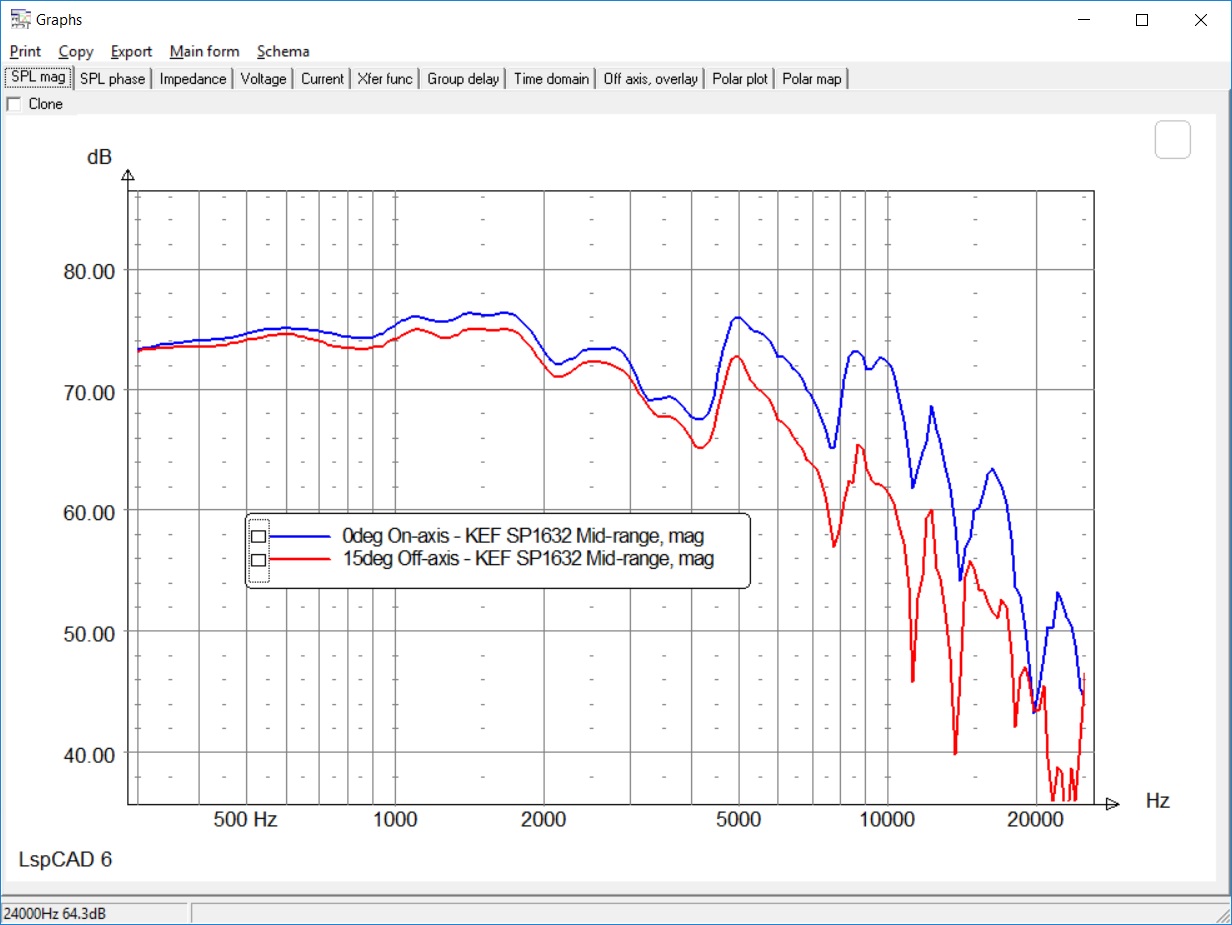

Here's three different graph resolutions (40/50/80dB, no smoothing) of the same measurement of the KEF SP1632 mid-range:
Measurement conditions:
Baffle: 90x20cm (se pictures).
Mic position: 1m on mid center-axis.
Regards
/Göran

Here's my measurement that's a little more comparable to yours but lower frequency limit is set to 200Hz, unlike yours that is 300Hz. Gate is good to 250Hz (yours is 275 if i'm not mistaken), 1m distance, mic at tweeter axis - on axis and 45 degrees off axis. Anyhow, midranges measure superb on both baffles my opinion. Tweeters differ somewhat and Kef's looks flatter on axis. Not that that is of great importance because off axis is by far more dominant at farfield listening but it was worth noting when Juha said that yours look much better regarding diffraction than measurements done in original Kef cabinet - which was product of displayed measurement resolution, in my opinion. When i posted it my way and side by side, it looked different enough and could be compared in a rightful manner.

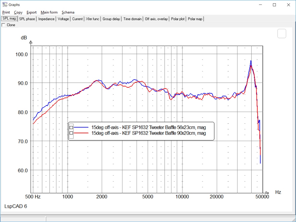

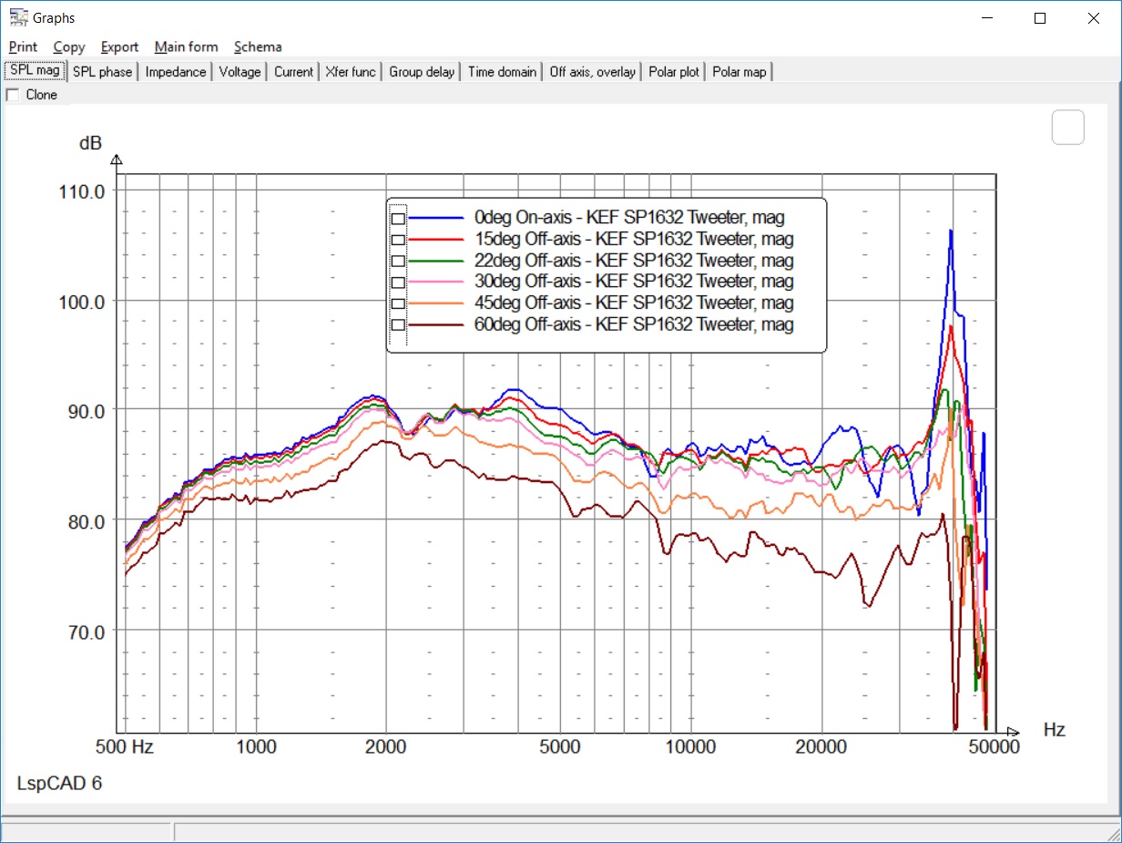

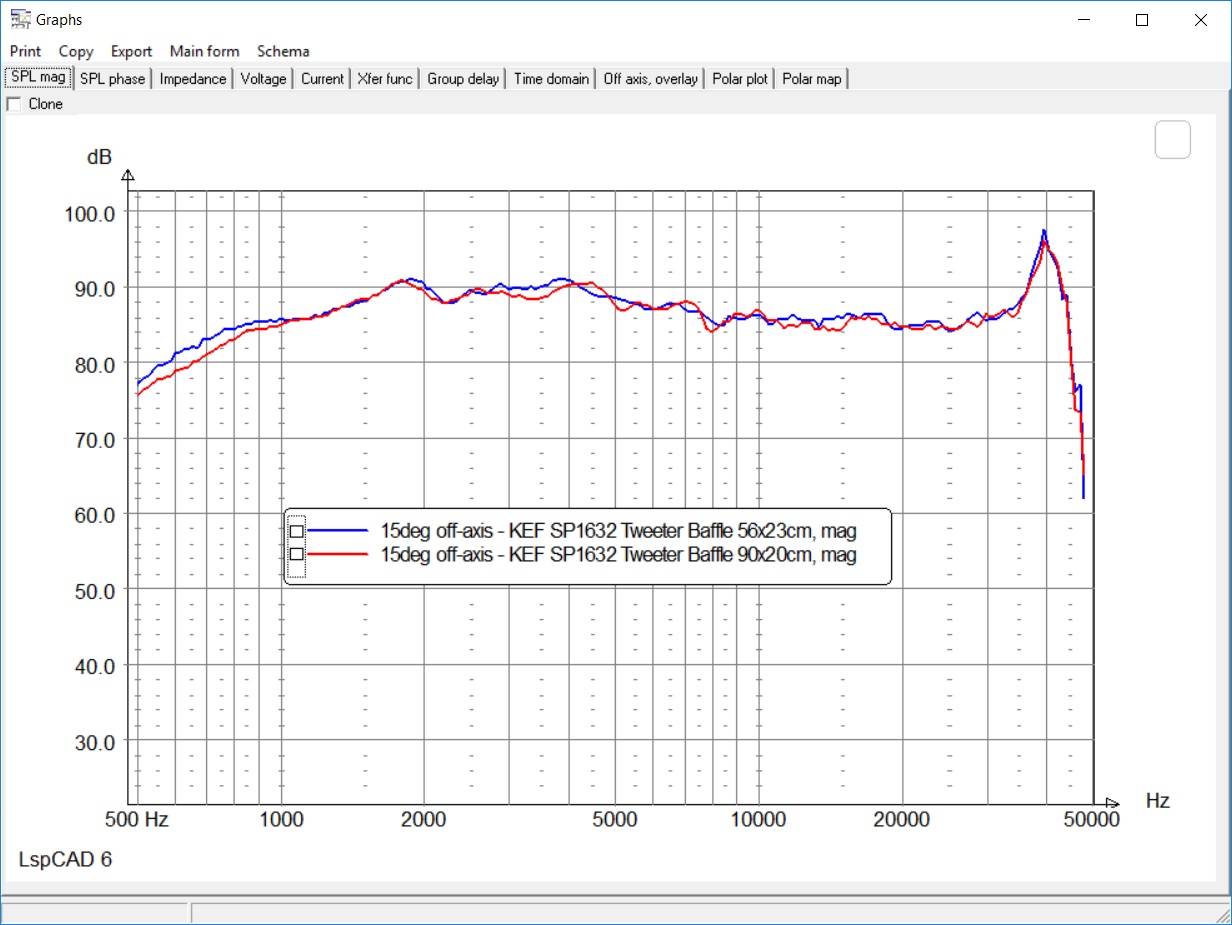

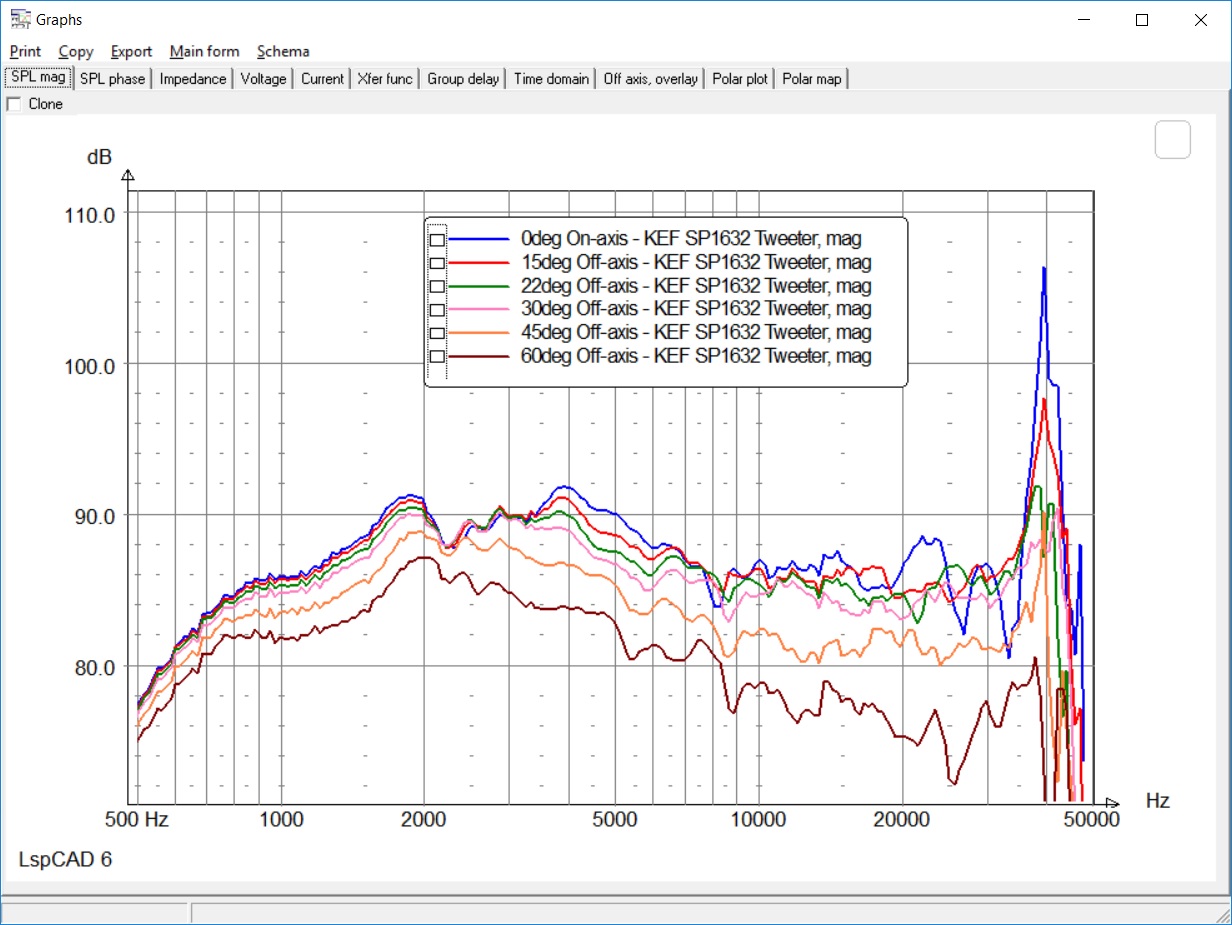

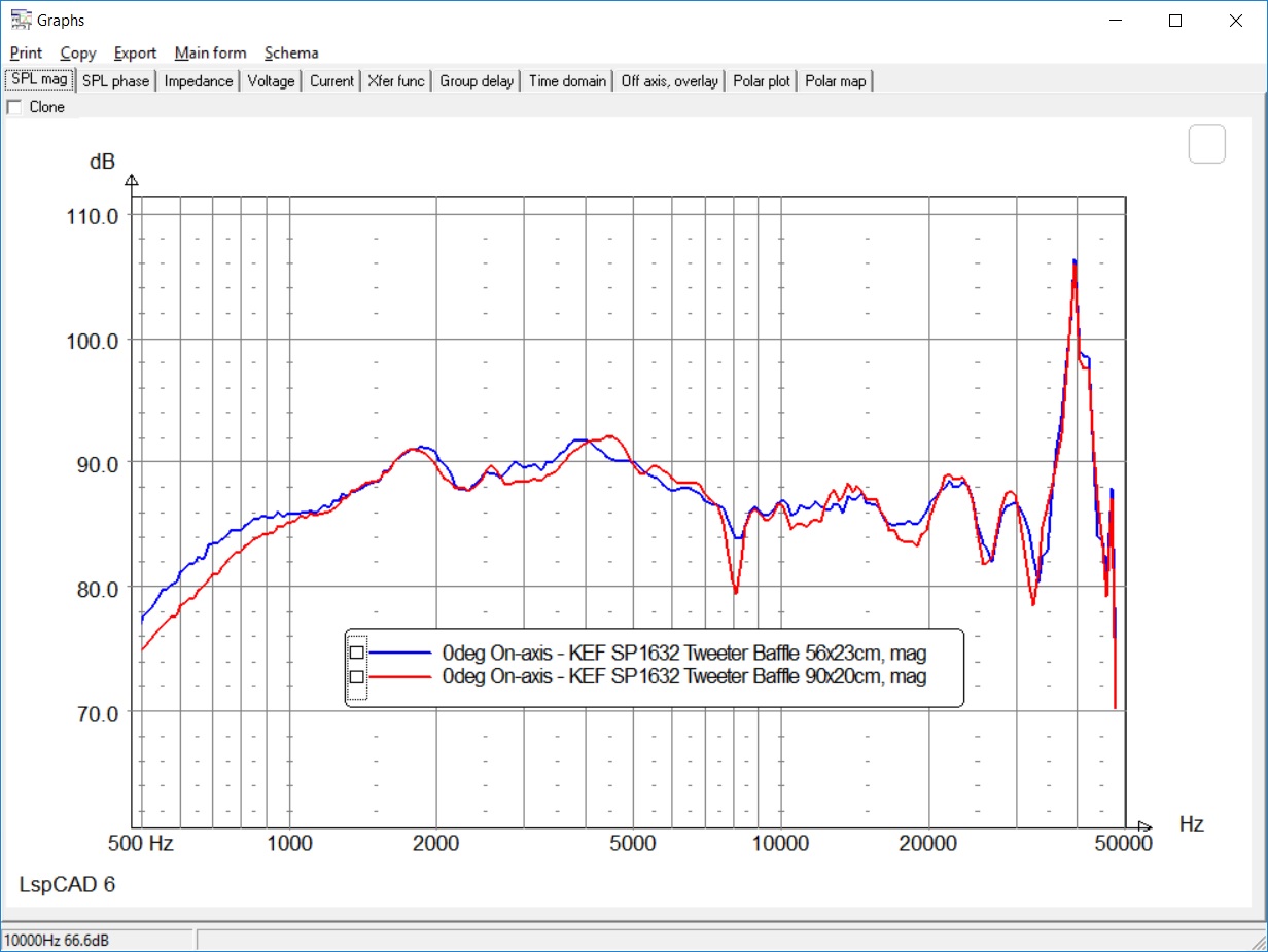

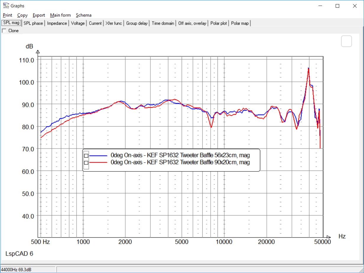

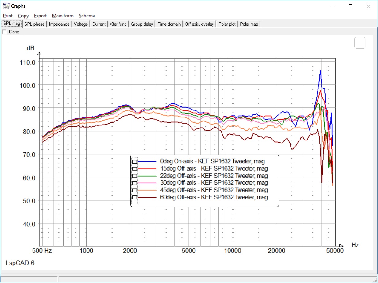

Here's some frequency responses for the KEF SP1632 tweeter.
The response is slightly better on the 56x23cm baffle with baffle edge round-overs compared to the 90x20cm baffle with sharp edges and other driver cones in the proximity of the co-axial.
Regards
/Göran

OWhen ever i made sim for R300 crossover that was flat on axis, i got a bump at 2-3KHz off axis. So, little irregularities on axis is quite acceptable if the dips fills up off axis. Since it is a diffraction issue there's no need to try to solve it on axis.

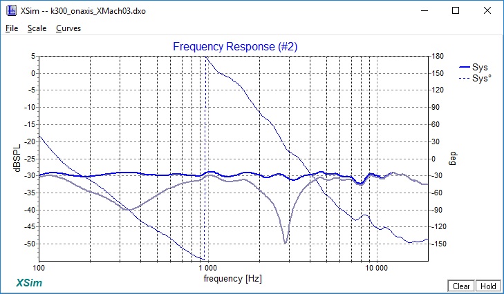

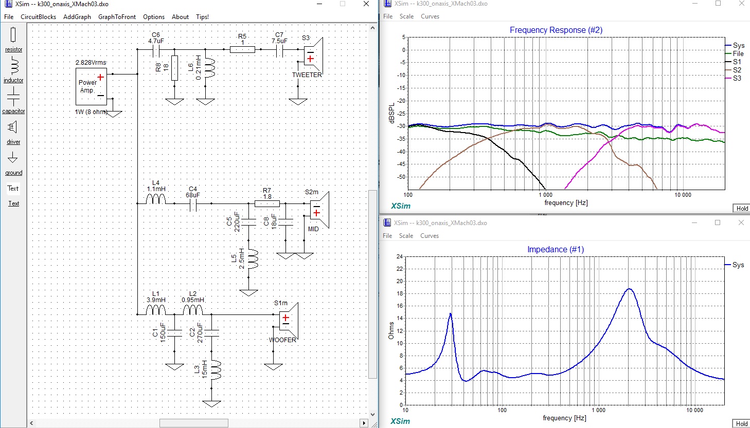

Thanks for uploading the measurements.

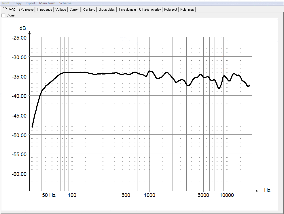

I have been experimenting with them for a while with the following result.
The 2-3 kHz bump (45 deg characteristic, green) is still present but it's less than 1dB over the slope line.
On-axis (blue) response variations are witin +-1 dB around average level up to 17 kHz (except for the dip at 8kHz)
Great stuff X. How's your phase response and for what distance did you optimize your crossover for ?
I'm still waiting for capacitors to arrive. Then i'll be able to play outside of simulator a little bit 🙂
I did not actually assume anything about the distance in this excercise. I just took the data "as measured". The only preprocessing was determnination of mod delay (with relation to the tweeter: 0.42in mid, 1.13in woofer)

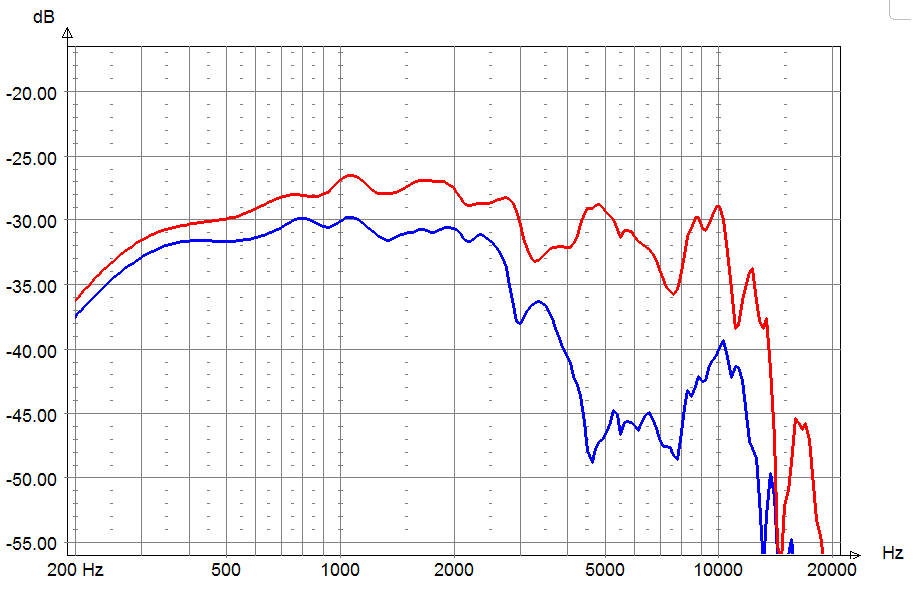

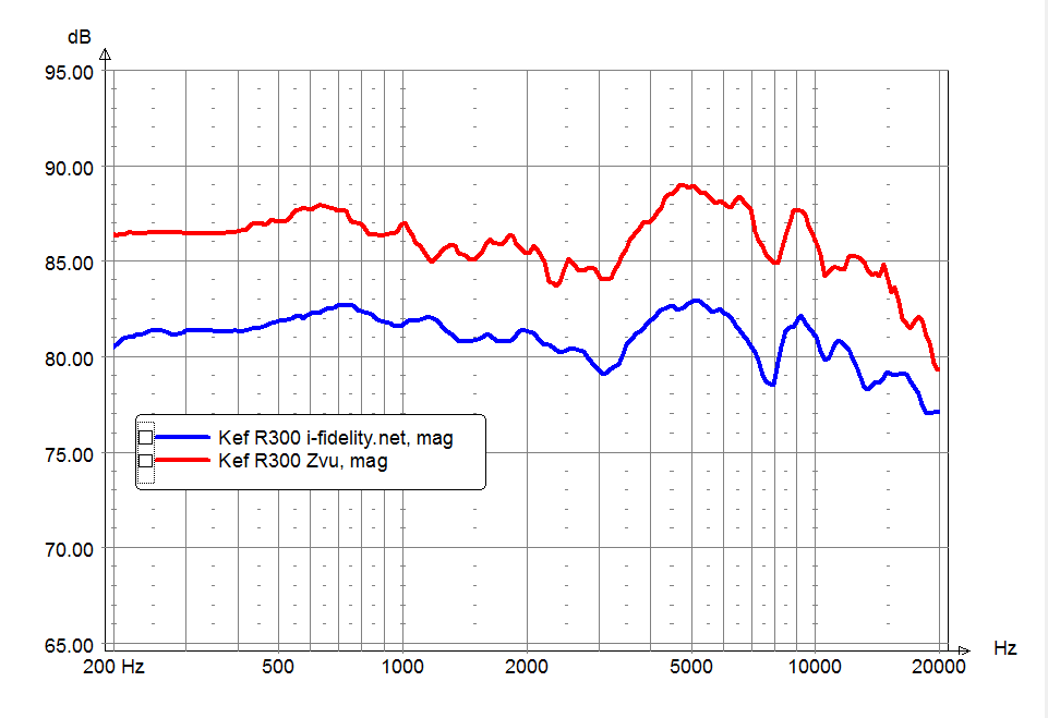

Here's one measurement that i've found on the German website i-fidelity.net
When i adapt it to grid used in my measurement from post no.1 it looks like this:
In the monolab measurement we can see typical coaxial tweeter response - it is much smoother at 15 and 30¤ than 0¤. Still, the on-axis should be smoother, I believe.

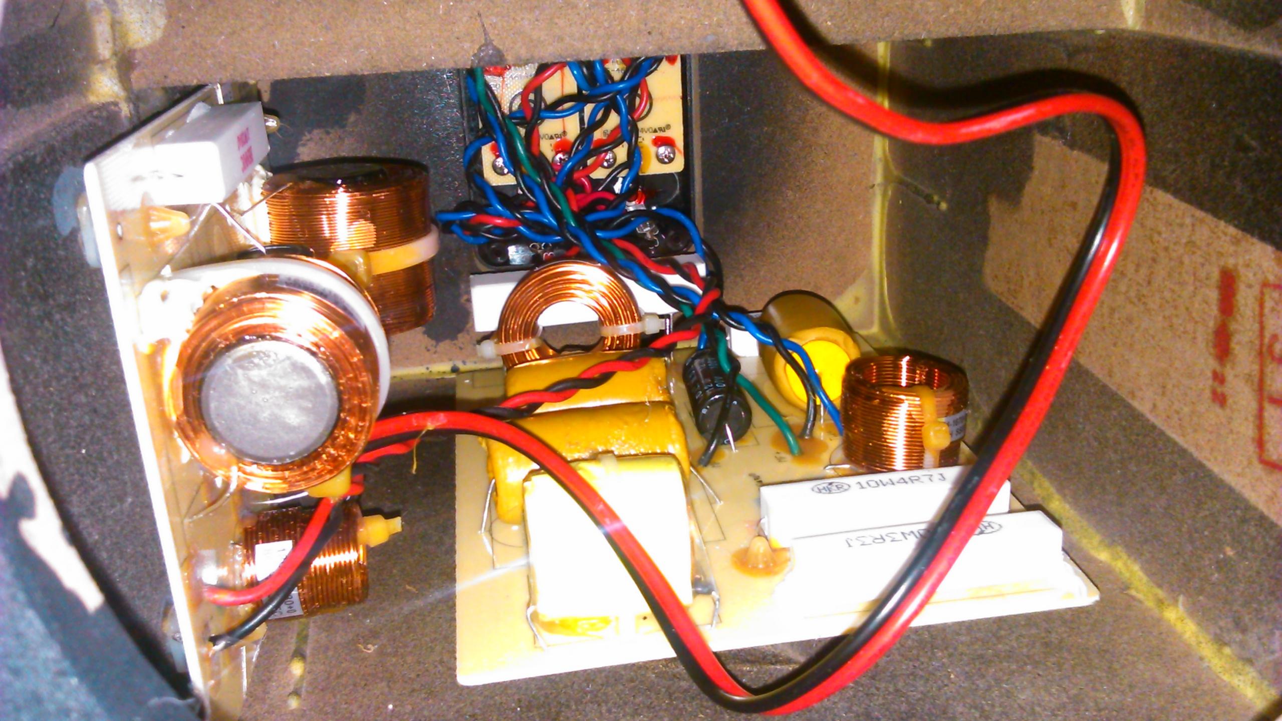

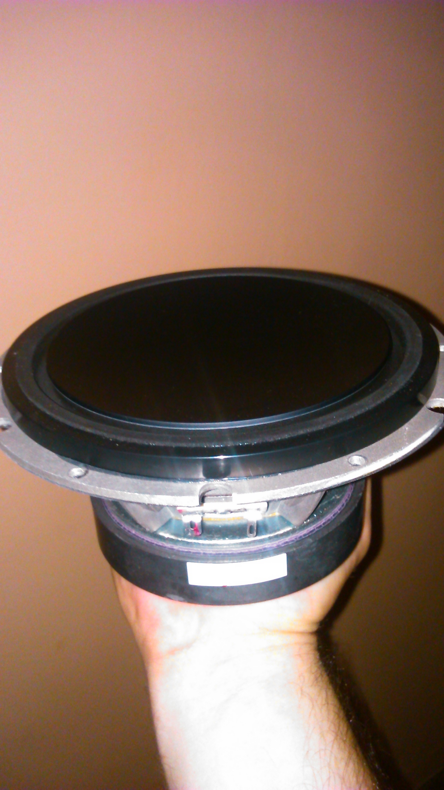

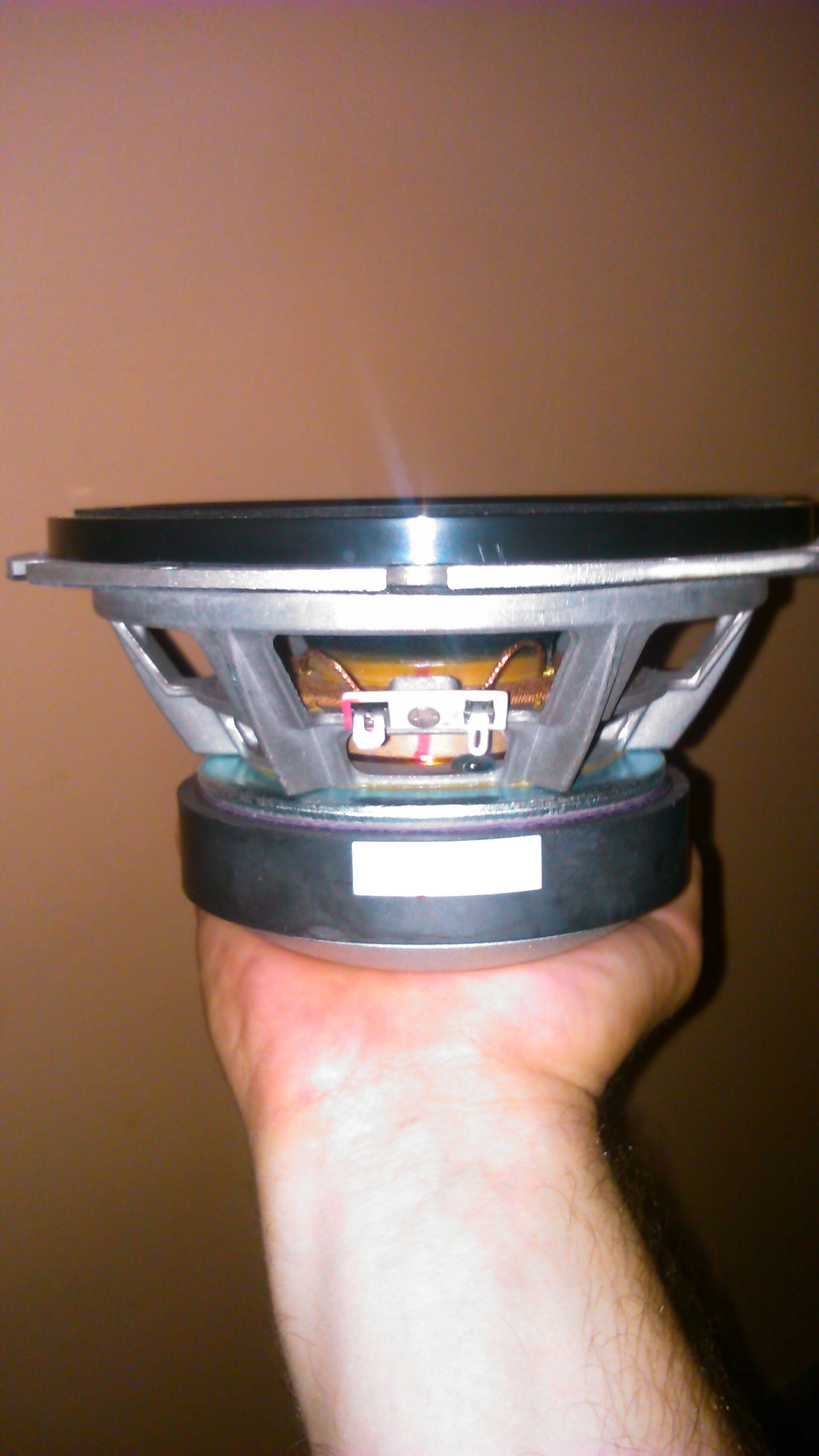

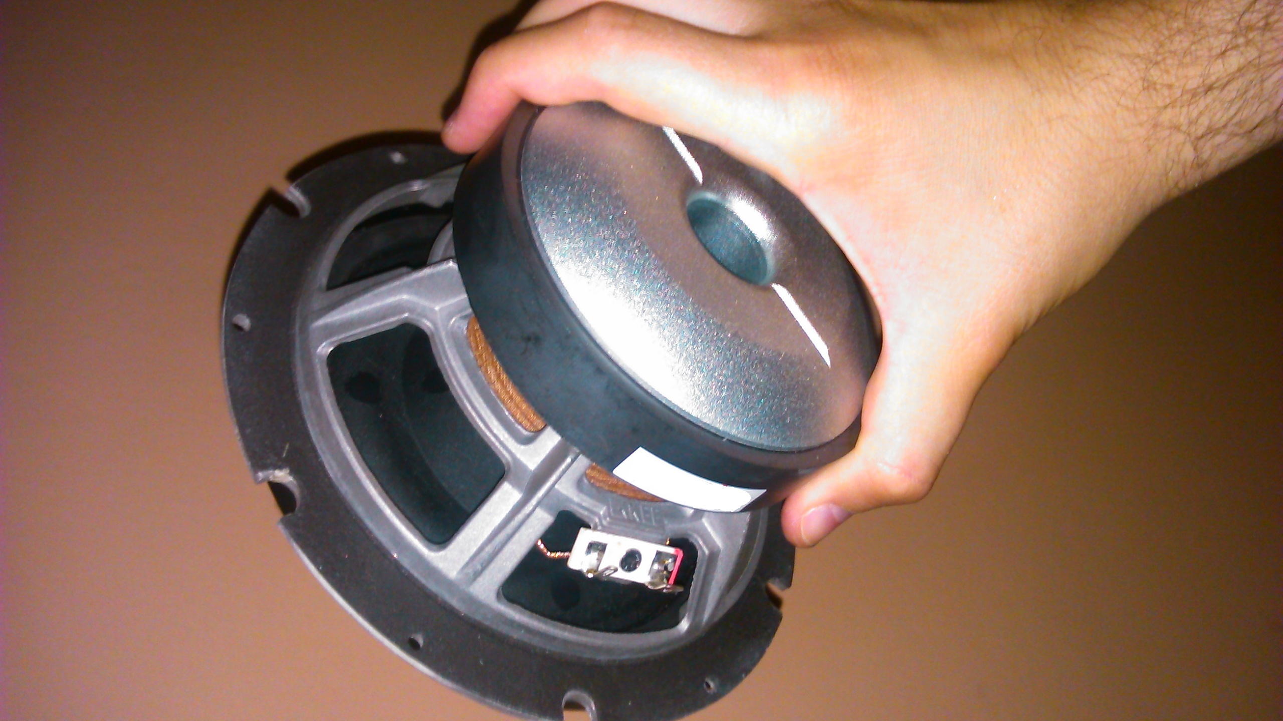

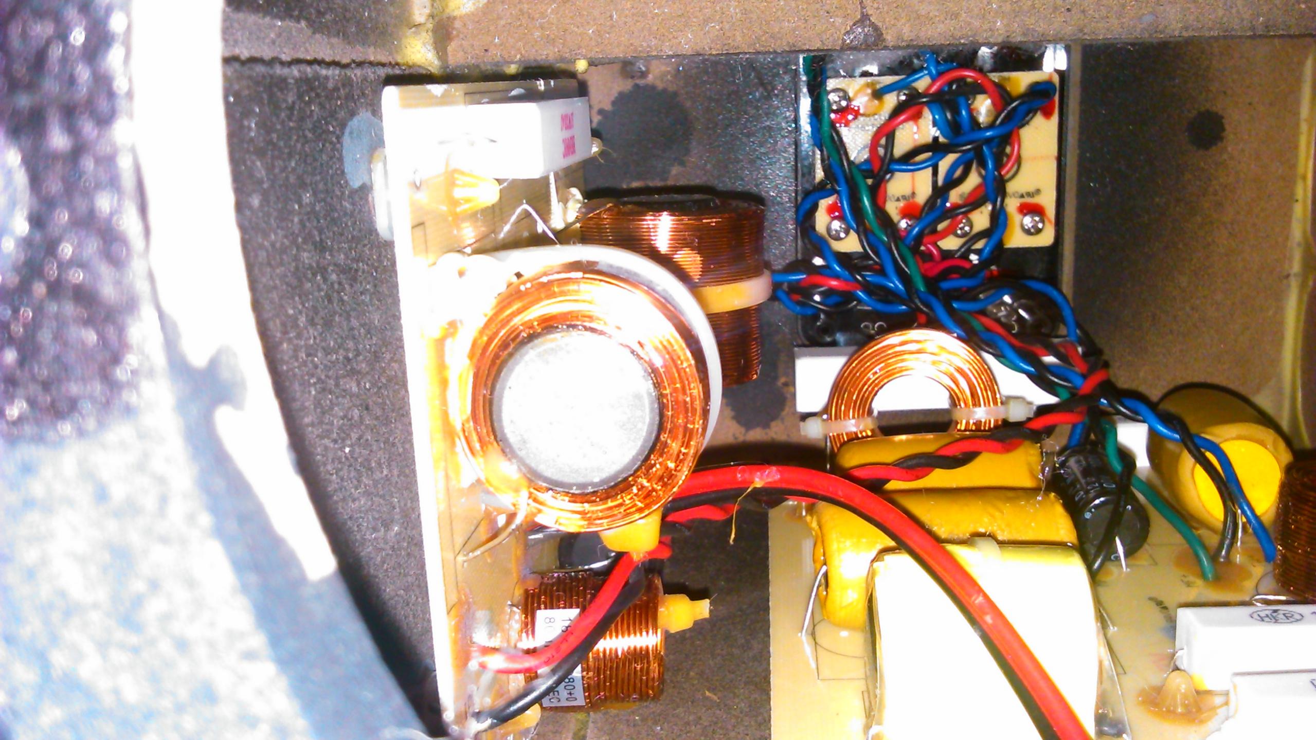

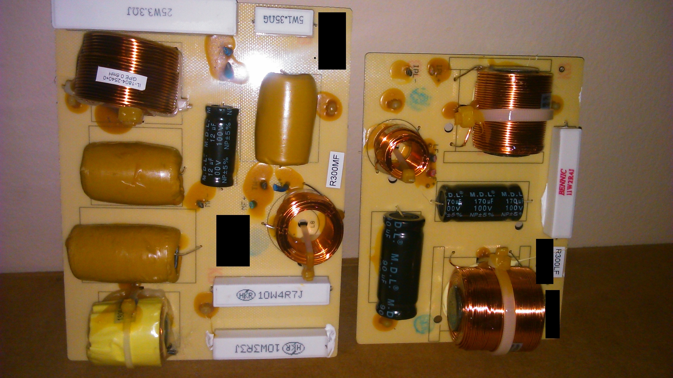

Few pics of factory crossover and woofer. Few capacitors are wrapped in some sticky material. It looks like the stuff that Kef uses for CLD in LS50.
From your pic it appears that the driver hole is not chamfered/beveled. When I pulled the mid tweet section from my R300 the hole was not beveled either and I was amazed it was not. I was too lazy to set up my router so I left it alone as the speaker was listenable if not a bit dynamically constrained. Do you plan to bevel the inside of the driver hole?
I'm thinking of gutting my pair and making an outboard crossover and slowly tweak it and the box (as needed) over a period of time. Or not, just something to do when I'm bored albeit it is last in the que of speaker projects. Overall, I think Kef did a pretty good job.

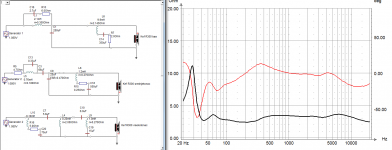

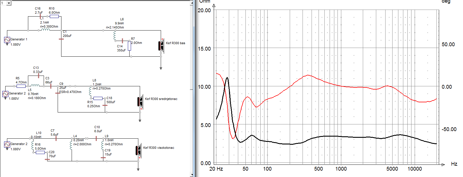

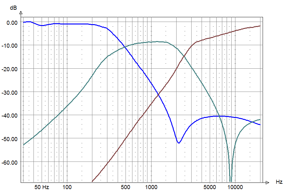

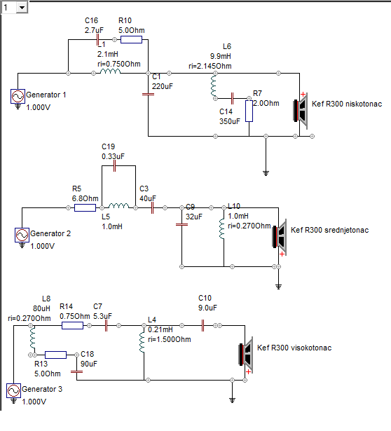

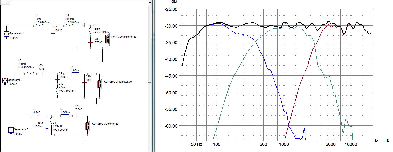

I'm there - these are my test crossovers.
Wires go through the port tube now and i'm listening for changes with slight changes of values. Actually crossover sounded really good without any tweaking but i want to see if i can achieve something better by tweaking it a little. For now i can make it different but not better. I'm here at the moment:
attachment.php
Transfer function of crossover:
attachment.php
Number of components can be used from factory crossover. C1 is made of 170uF and 50uF in parallel, C7 and C18 are from factory crossover, L6 is factory coil of 22mH unwinded to get 10mH, L4-L8-L10 are also salvaged unchanged from factory crossover.
Simulated impedance response:
https://s15.postimg.cc/u0yjku5y3/Untitled1.png
Measured impedance:
https://s15.postimg.cc/j1dc987t7/Untitled.png
In the next days i expect to find some time to measure frequency response.
As for the cabinet, there are no chamfers but the real question is if it needs it. If you do the chamfering i'd appreciate if you posted some frequency response measurements here - before/after.
