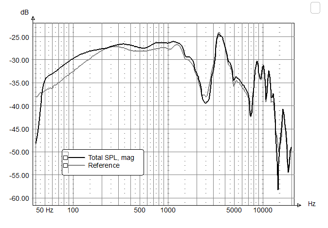

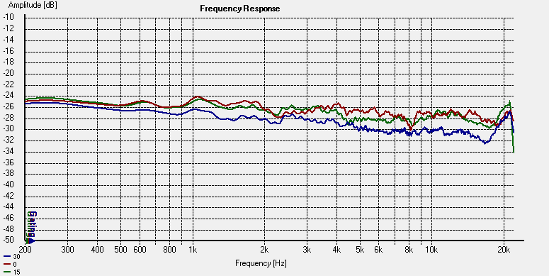

On topic - every UniQ Kef has (more or less pronounced) dip at 8kHz. That is product of their tangerine phase plug and is present only on axis. Off axis it disappears. Here's measurement of my modified Kef R300 on axis, 15 deg and 30 deg off axis:

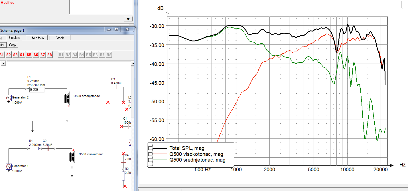

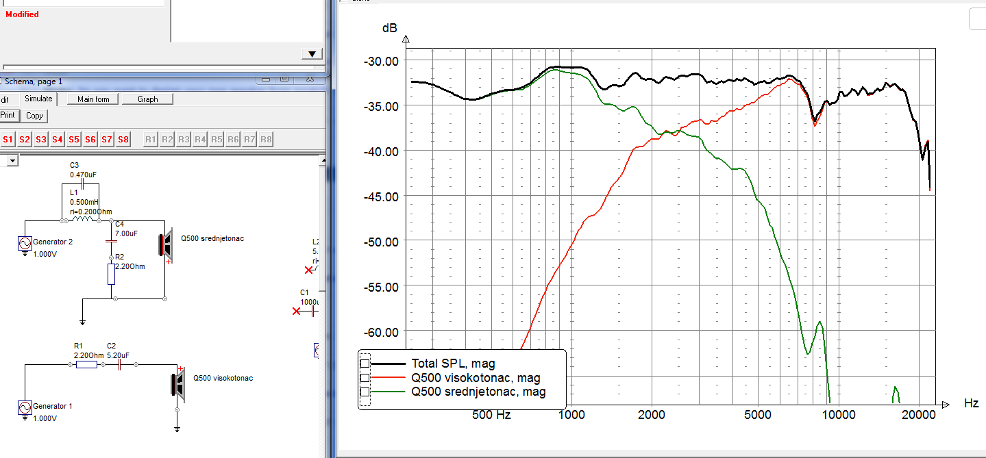

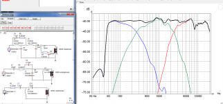

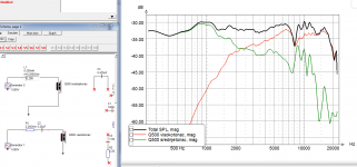

Slightly modified your Q500 midrange frequency response looks like this - it should already sound much better because you don't listen your highs through midrange cone breakup:
Factory crossover
Slightly modified
Factory crossover
Slightly modified

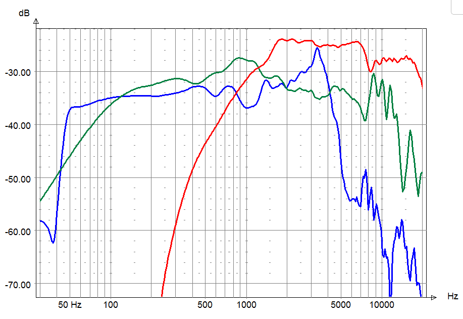

All you need to do is to connect all three drivers (normal polarity, + on + and - on -), put the mic on a stand on tweeter axis 1m distance and make those 5 measurements. Mic position and amplifier volume shouldn't be messed with during all 5 measurements. 3 pieces of wire, one for each driver, that sticks out of the cabinet so you can connect it the way explained in that PDF i posted before. I made .txt files from 5.zip you've uploaded and i don't get anything resembling a real situation.

That's because that amount of gating allows good resolution down to 300Hz. Everything under that frequency isn't right. Anyway, i think i'll manage to do something with these last measurements. I'll get back to you by this evening with results.

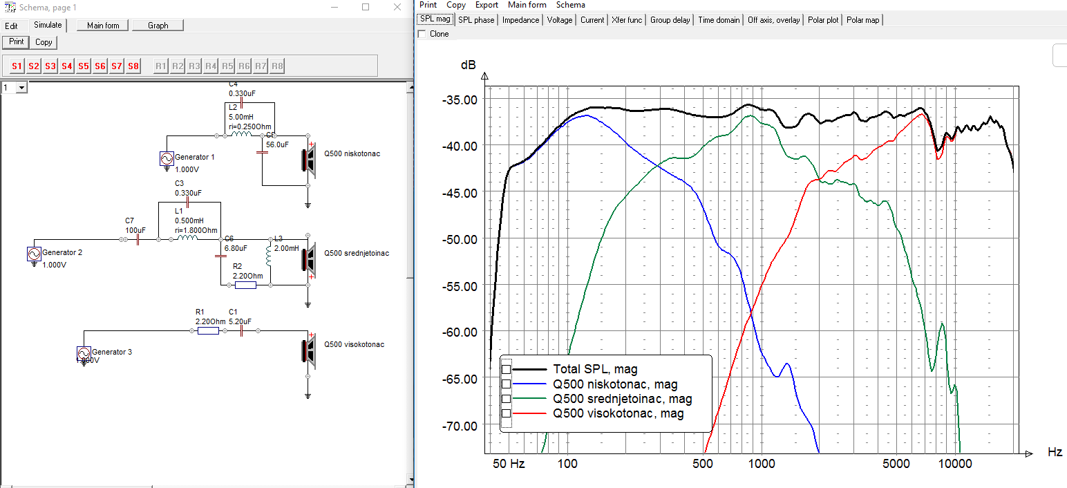

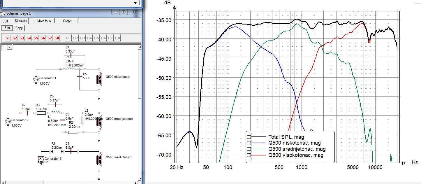

This is a little dressed up version of the five minute crossover i simulated earlier today. Regardless of time spent to simulate it, it does look like an obvious improvement on factory crossover.
Offsets worked very good with midrange and tweeter, little less precise with woofer and midrange, but that is a product of short gate and rather high merging. It looks like this.
For tweeter all offseta are 0
For midrange Z offset is 2,5mm in front of the tweeter
For woofer Y offset is -300mm and Z offset is 10mm behind the tweeter
You can set the level of midrange in regard to bass with resistor R3. Use at least 10W resistors. Capacitor C7 will be expensive if you look at some high end manufacturers but since Kef in their R series uses bipolar electrolytic capacitor bypassed with some small value foil capacitor, i think you'll be fine with foil capacitors you can find on ebay. I've bought some nos Vishay foil capacitors 63V/22uF quite cheap from ebay.
Bare in mind that this is simulation based on data i was given. Longer gate, higher resolution, measurements off axis up to at least 90 degrees and i would be much more confident in what i simulate to be very close to end version of crossover. This one will likely need some tweaking by ear. I tried to save as much of the components that are already there to minimize the cost of reworked crossover.
I'll simulate one more version aiming to get the bass under 100Hz a little higher which usually means that everything else must go down so at least 3dB lower sensitivity in regard to this one.

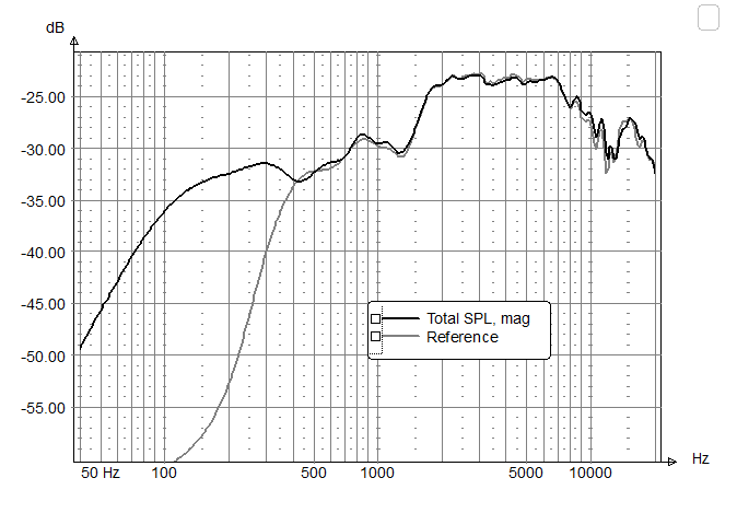

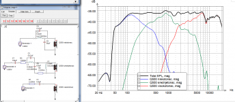

Here's low sensitivity full baffle step.
Although it does look good, i'd be reluctant to make this crossover without sim files derived from measurements with gate under 9ms. Too much large component values - it would be pricey. Not saying that Kef Q500 doesn't deserve it but it needs to be done with as little error possible.

350uF capacitor is large but it is cheap. Since it is in notch filter that is centered at around 90Hz, i'd advise you to buy 2 polarized electrolytic capacitors 680uF/100V and connect them in series back to back (- on -). Then measure it with dats and add foil capacitor in parallel to get to 350uF. C7 however needs to be as good as you can afford so no bipolars or any electrolytics for that matter. I like to make that large capacitors out of 22uF because of later tweaking. If you buy 100uF and it doesn't work as supposed to, you're stuck with it (unless you need higher value). Making it out of few smaller ones gives you a degree of freedom. I've made mine out of 4x22uF and 1x10uF connected in parallel.

First, i'd make that slight modification to speakers from this schematic.
https://www.diyaudio.com/forums/att...872-kef-q500-crossover-blaga-modifikacija-png
Don't touch the woofer but use 6.8uF and 2.2ohms shunt with midwoofer, buy 0.47uF small foil cap and 0.5mH coil (per speaker). It is mild change but quite effective. I order my air coils from hificollective.
Make the mod and listen how it sounds and if it makes a difference in clarity to you. If you're satisfied, then wait some more untill you do the anechoic chamber measurements. You should ask them down to what frequency the chamber is effective. If it is over 300Hz then you can use it but the results shouldn't differ that much from what you've achieved in your flat.
