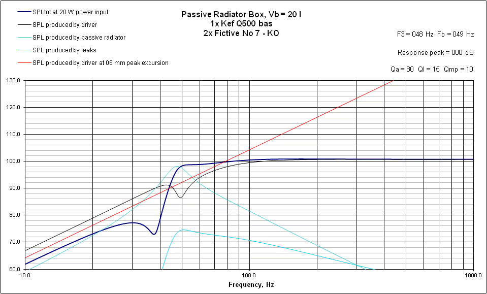

I have recreated response you've measured close enough.
When you measure frequency response of raw woofer driver in cabinet, we will merge it with this sim at around 100Hz and get quasi anechoic file for simulators.
