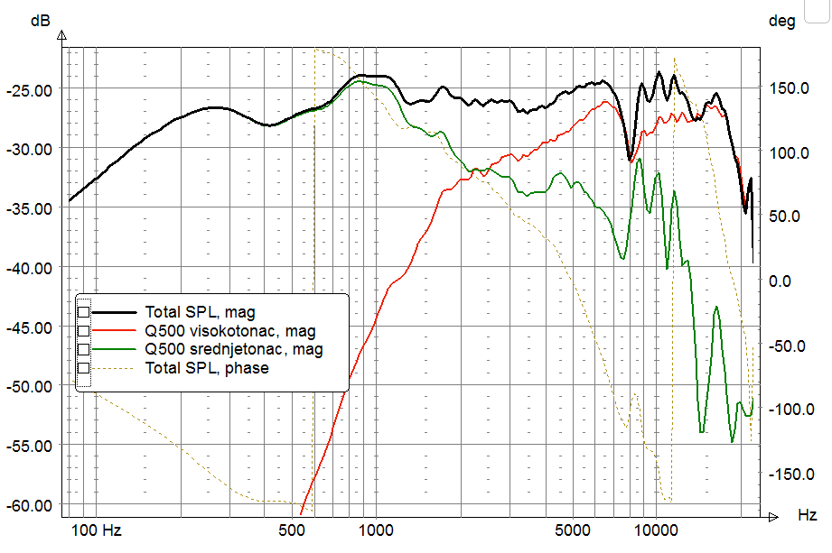

At least finally I could measure with 4.2ms gate:
freq3 - Google Drive
The issue was the speaker was too close to the ground. With this measurement the speaker is from 120cm from the ground.

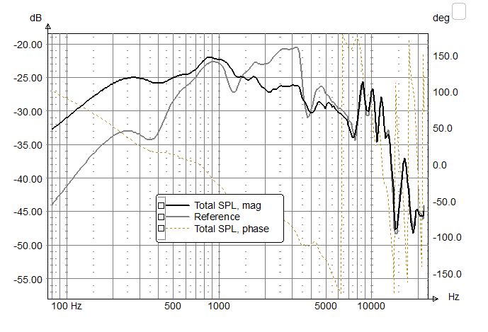

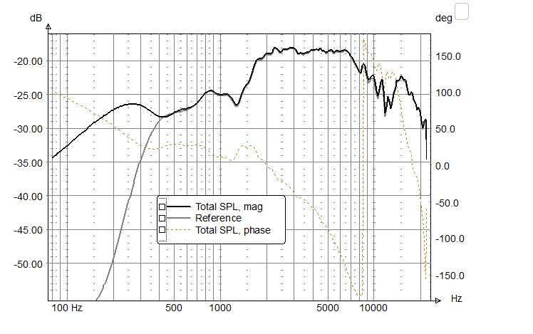

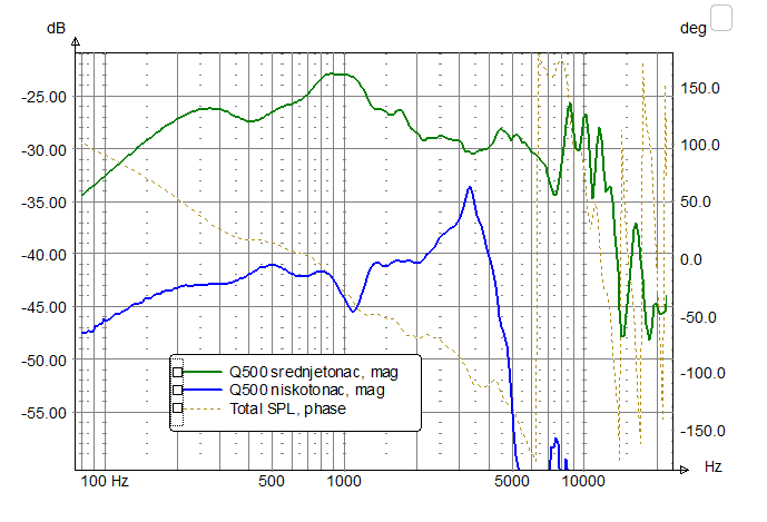

To derive acoustic Z offsets for drivers you have to place the mic on axis to the tweeter at 1m distance. Don't touch the volume of the amplifier (or any other volume control in chain for that matter) and set start frequency of the sweep at 300Hz. Measure the tweeter and name it say Q500TW. Then you connect the midrange in parallel with the tweeter and make another sweep. Name it Q500MID.TW. Then you set start frequency of the sweep at 20Hz. Disconnect tweeter and measure just midrange. Name it Q500MID. Then connect the woofer in parallel to the mid and make another sweep, you get it, name it Q500MID.WF. Then disconnect the midrange and measure the woofer, name it Q500WF.
Now you have everything that is necessary to derive Z acoustic offsets yourself.
Set listening distance in VituixCAD at 1m. Make the tweeter in sim and upload the tweeter Q500TW and impedance. Then make a midrange in sim, and import Q500MID file. Import Q500MID.TW file as Reference (that's what it's called in LspCAD that i use) and compare it to the combined curve. Add Z offset in mm until they overlap. Then disconnect the tweeter and make a woofer in sim and upload Q500WF and impedance. Now upload as a Reference Q500MID.WF and compare it to combined curve. Set X offset at 300mm and add Z offset (usually negative value) until the curves overlap. Now connect the tweeter again and you can begin to simulate your crossover.

The weird thing, in Xsim, I'm already really close to the measured response (brown measured, black simulated), if I DON'T invert the mid speaker...:
I'd, again, advise you to use Holmimpulse or Arta. I'm not sure that rew is good for modeling frequency response. It has few different types of smoothing that all give slightly different results. I'm not saying that's bad but it takes knowledge to know when and what to use. With Holm and Arta it is much simpler.
As for differences in Xsim, maybe it is optimized to work with rew measurements like Vituix is for ARTA.

Your reference measurement must be made under same conditions and with same gate lenght as your frd files of you want to achieve complete overlap.
