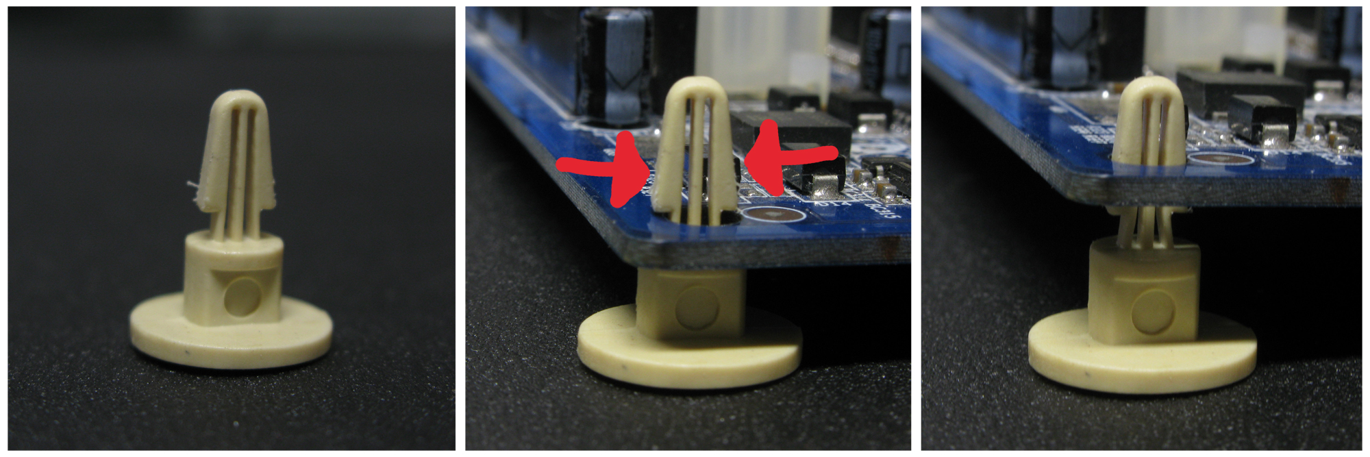

How did you get your boards out Wes, and without damage ?

Taking off the boards was quite a pain, there isnt really anything to it, except for patience and perseverance...
and a hand/wrist combo thin enough to get inside the speakers...
I didnt take pics of the inside of the speakers cause i dont want to open them for now, unless necessary... { I too like to keep them closed, assembled and playing }
the pin in the pic is practicaly identical to the kef ones.
All you have to do is press the four pins as the red arrows indicate. That in itself is quite hard tho, since the pins are placed quite close to inductors/capacitors, so u have little space to press the pins. (I am quite sure you are aware of that tho.. my "secret" are my skinny hands... )
But after a good amount of pressing, twisting, pulling, pushing and cursing, the boards should come off...

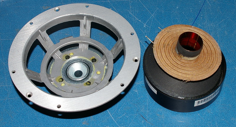

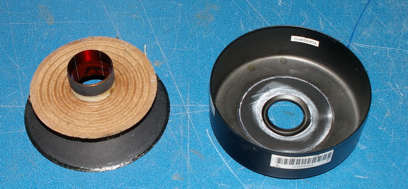

Hi

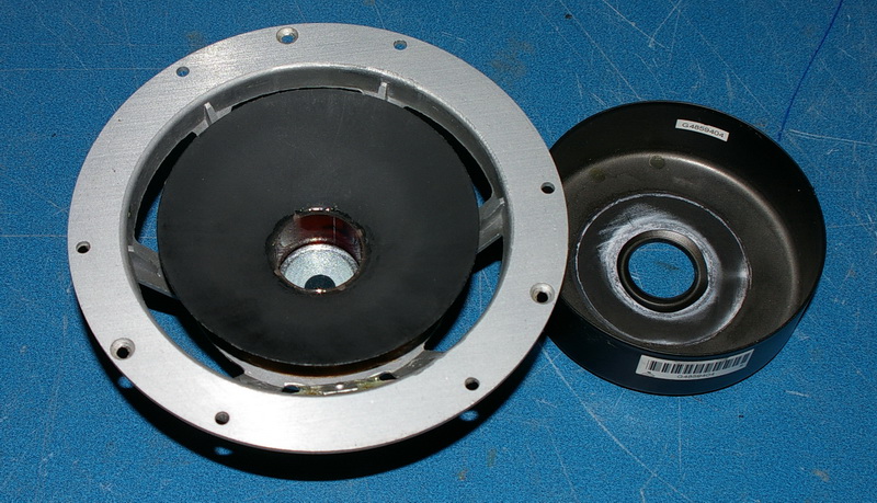

I decide to make some modification to the drivers in fact I change the tweeter with a Monacor CRB, 40 and for the woofer we change the cone material, we use paper cone from some Jamo speakers. The drivers will be black with the silver plastic wave guide.
The tweeter have silk dome with aluminum voice coil.
For the woofer we use the original voice coil and in did is from aluminum wire on kapton
Tomorrow I will test him, I keep a driver untouch.
I tested the new driver and the driver with the new diaphragm has more bass start from 30Hz the original cone has 4.8g and start from 45Hz like in the specs and the Jamo cone has 3.2g so it is less heavy. I use the same voice coil, aluminum on kapton material. I have a friend who does this job, it is his job fixes all the day drivers.

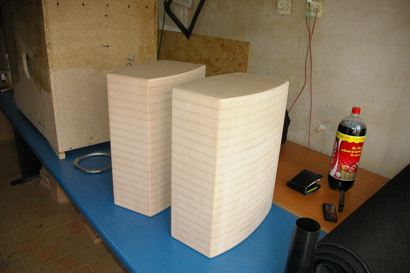

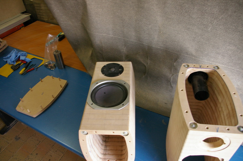

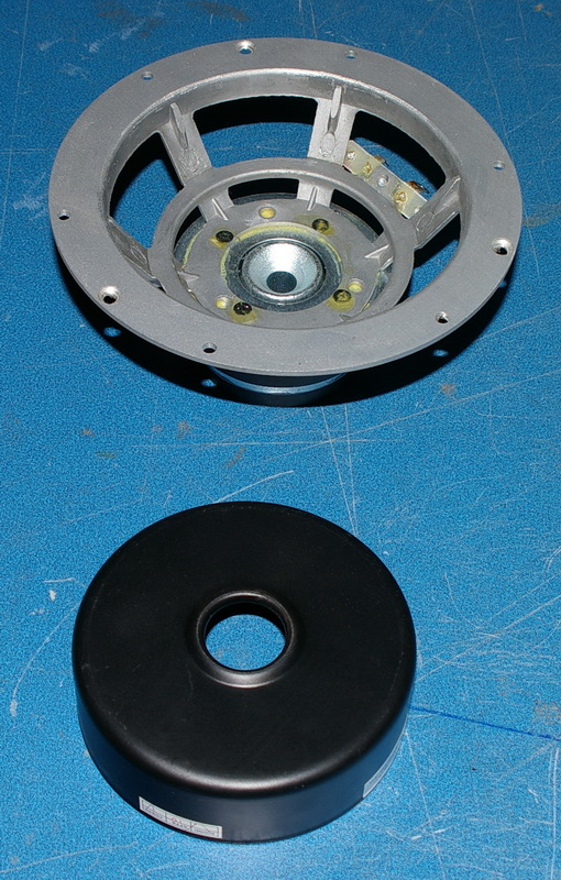

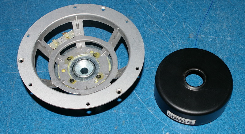

Hi

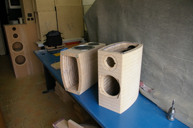

My IQ3 are in the process of rebuilding. I changed the Plastic mid woofer cone with Paper cone, and the original tweeter with another one that use silk dome. For the mid bass driver I use the same voice coif because is light, they use aluminum coil for both drivers.

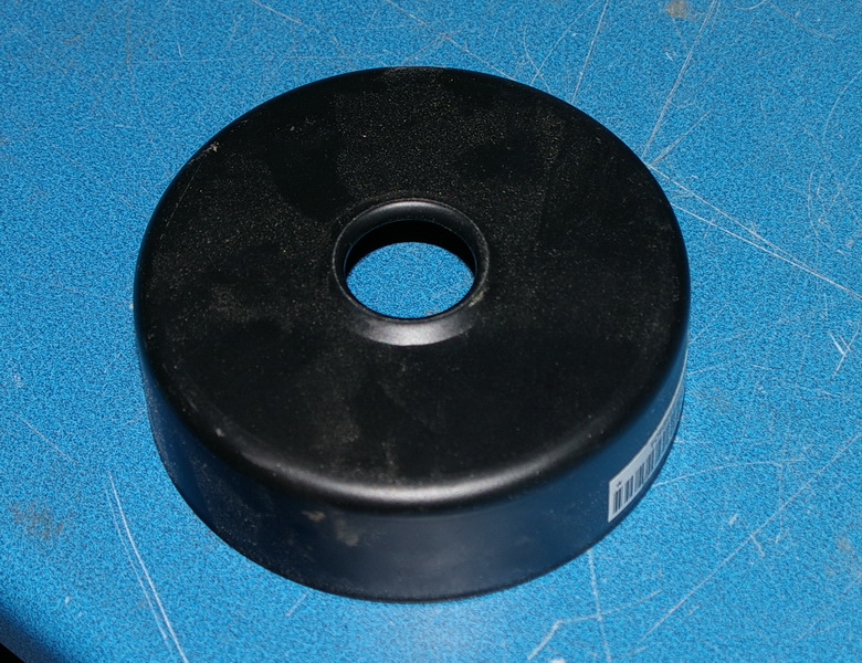

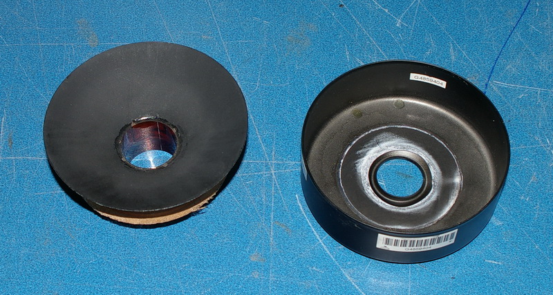

I remove the metal shield from the magnets. After I will finish this project I will put some pictures. All this jobs was done by a fried of mine, it is day to day job to repair audio drivers, and he is an expert.
For crossover we will use an active crossover to determine the point where to cut, after we will make a classic crossover.
Best regards
Hi
I will post some pictures with the KEF IQ3 mid bass driver
2 magnets ?
Hi Gabriel,
great photos !
Are there 2 magnets on the back of the KEF driver's chassis in one of your photos - or is the other dark coloured disc that looks like a magnet actually something else ?
The tweeter section of the dual-concentric driver would use the same magnet in this KEF design, unless one of the voice-coils is set back behind the other ...
what do the voice coils look like ? ...
and what does your technician friend say about this ?
I will return to our other discussion about crossovers as soon as I have sufficient time available to write that completely.
This post is a quick one so that you know I am still following !

Hi
What you see is the original KEF driver except the paper cone. For the high frequency I will use a Monacor driver.
When I will finis the drivers I will describe what I change to make them better. For the moment I will use the original voice coil, original suspension, original magnets and original chassis. I will change only the paper cone and the tweeter.
What I see until now after lots of testing is that you will discover different sounds only by changing the paper con. The quality construction of the paper cone gives the sound of the speakers. Also the voice coils is very important but in our case we want to use the aluminum Kef voice coils. I will put more info soon.
