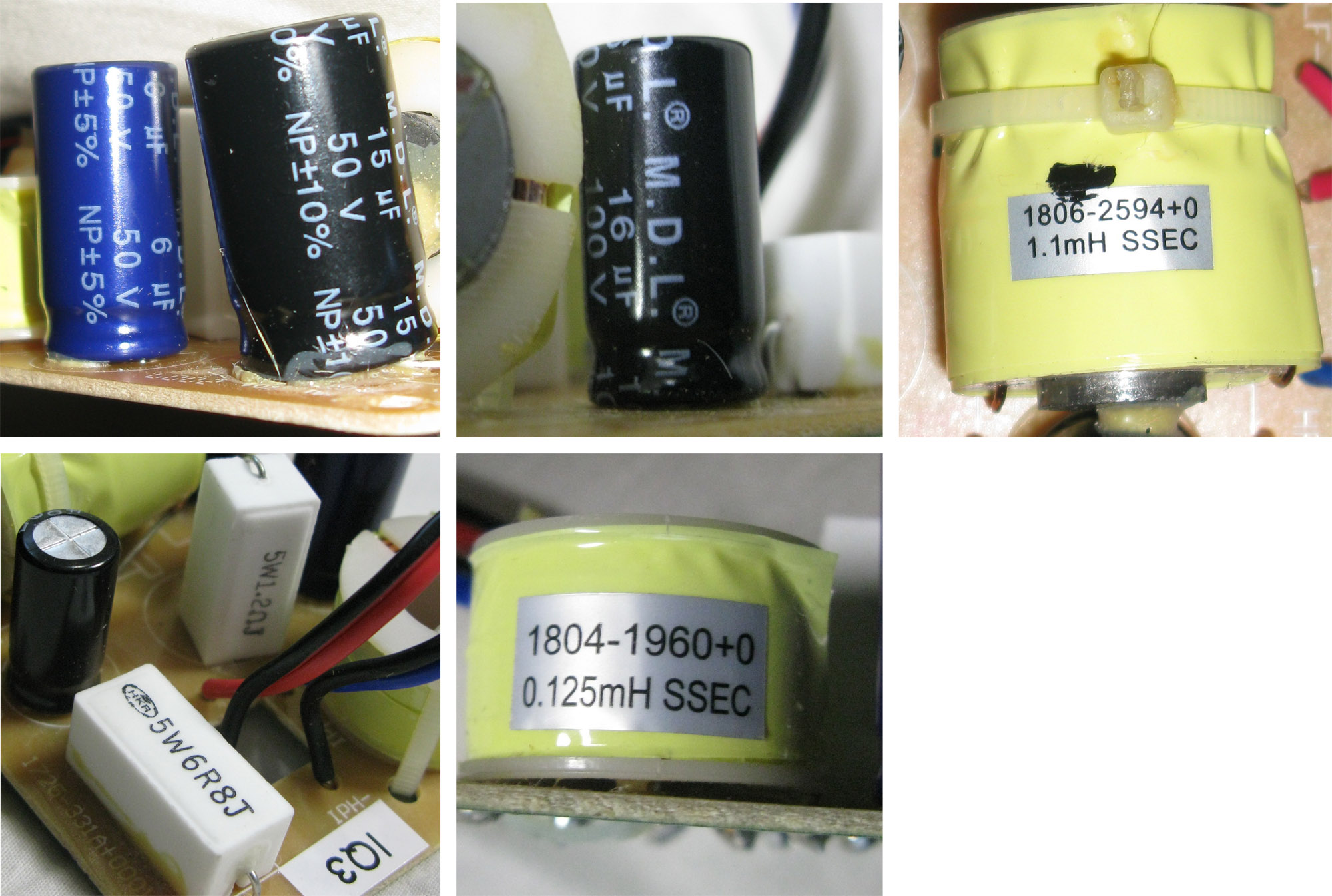

Today I modify my pair of IQ3 witch I bought last week.
I change all the capacitors with Bennic and Visaton the resistor with Mundorf, and DIY coil.
Also the cable was changed with Real Cable.
Bass C 16uF/250v Bennic, R 6.8ohm, L 1.1mH
Tweeter C1 15uF/250v Visaton. C2 5.6uF/250v Bennic, R 1.2ohm L 0.125mH
The sound for this speaker after the modification in unbelievable, sound is more accurate more clean.

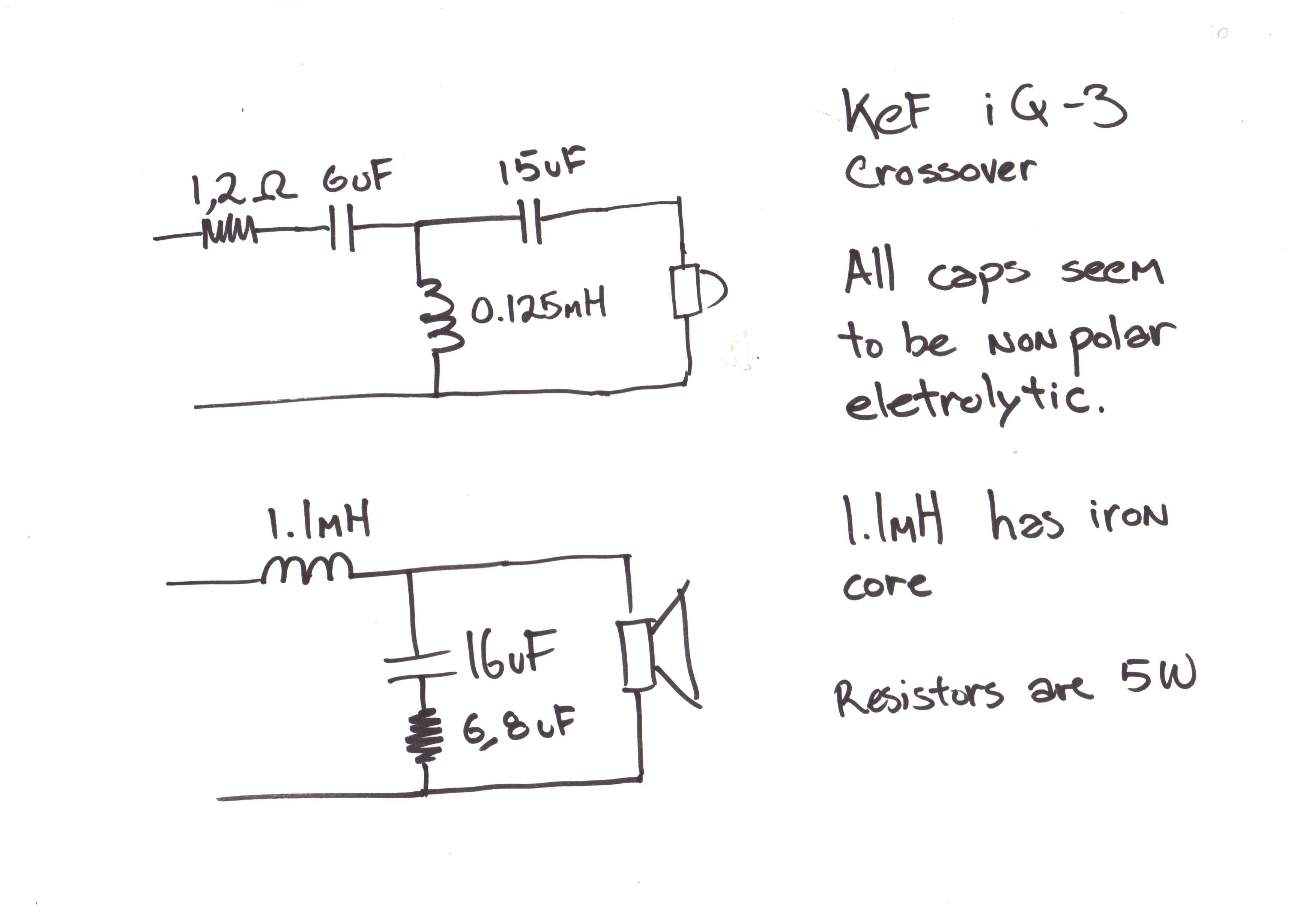

opened up my KEF iQ-3 and drew an schematic of what i found inside...
Cap voltages are 50/100V
Inductors have a quite thin wire, didnt get to measure dc resistance, but they sure look small.. one of them has an iron(ferrite?) core..
I'll try to get some pics of the crossovers and/or inside of the speakers online if someone wants them... Dont have my camera with me now...
I've been thinking about upgrading it...
I am no expert on crossover design nor parts selection, so i will apreciatte if anyone could give me some input...
I'm not really looking to change the values, maybe just change the nonpolar eletrolytics for some film caps, inductors with thicker wire maybe? air core also?
I can wind inductors myself, not sure if thats a good alternative...
Looking both for a sound upgrade and for the fun of doing it x)
Cheers all!

well, i wrote 6,8uF on the resistor on the drawing, but as you might figure, it was suposed to be ohms ;)
dont know how that happened... lol
p.s.: i do know the crossover "upgrade" has been talked about in the thread, i just find it a little confusing, so if i could have any more advice i'll be grateful
6uF or 5.6uF ?

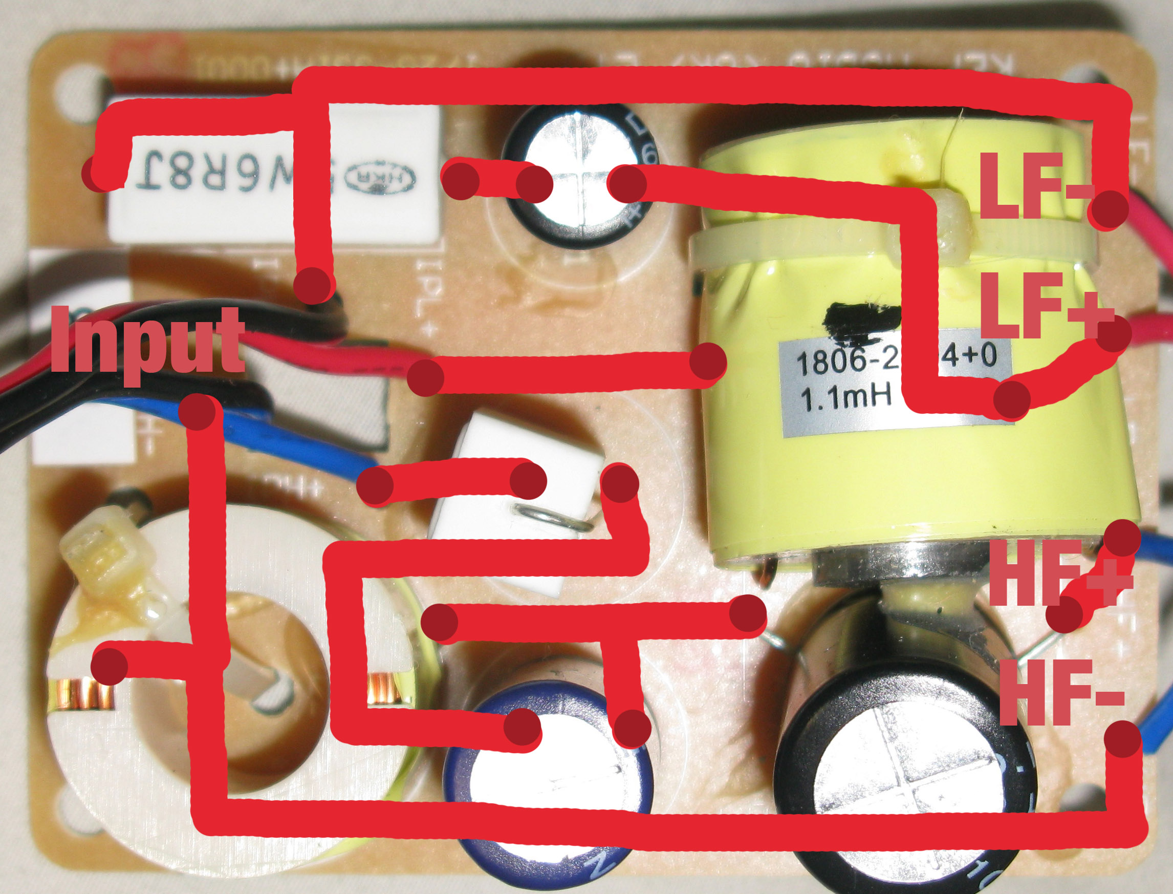

Hello honorable co-forumnists! :D
I'm sorry for all the confusion. I am now posting pics of the crossover with some drawings in an attempt to represent it more clearly.
If still that is not very easy to understand I can make another attempt.

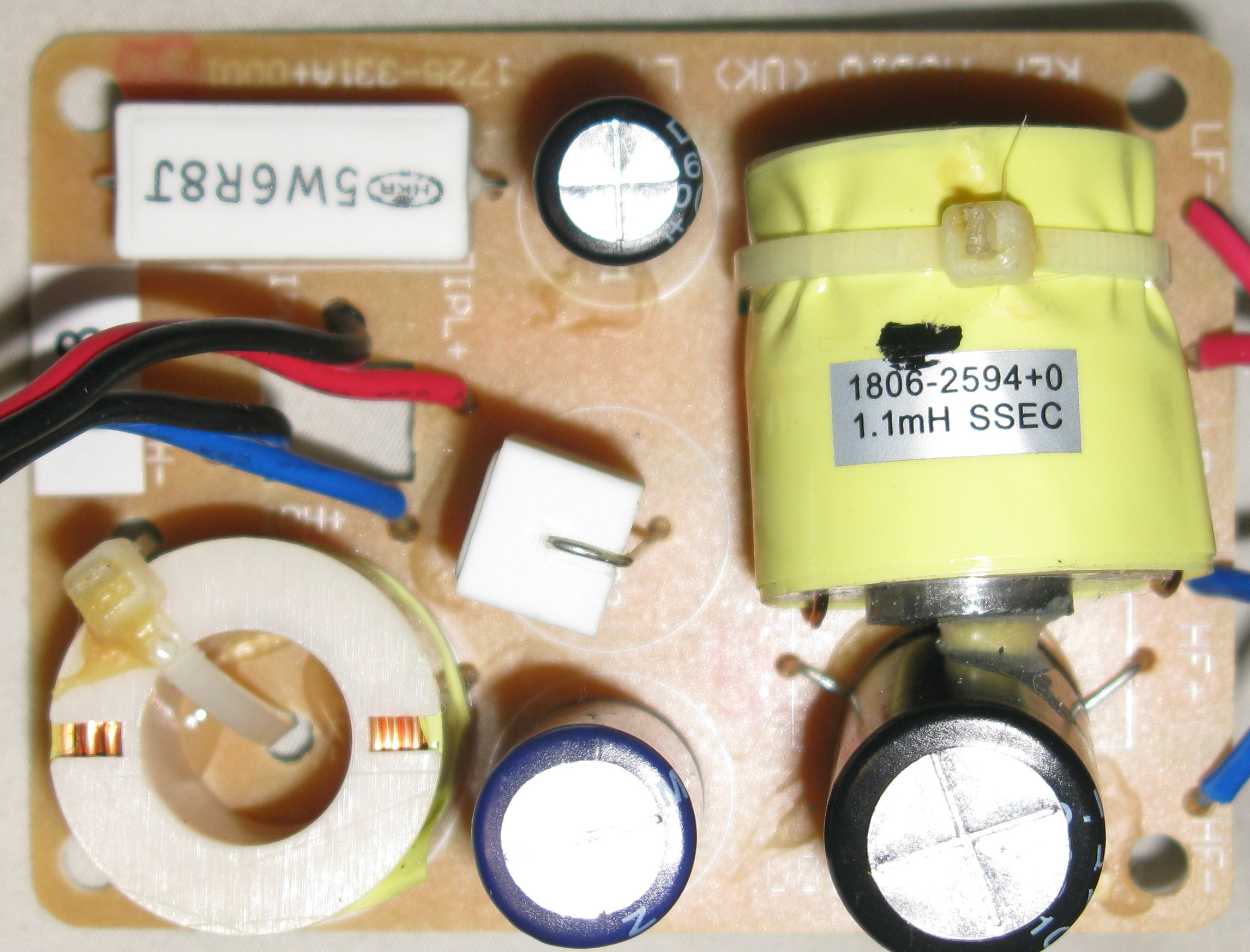

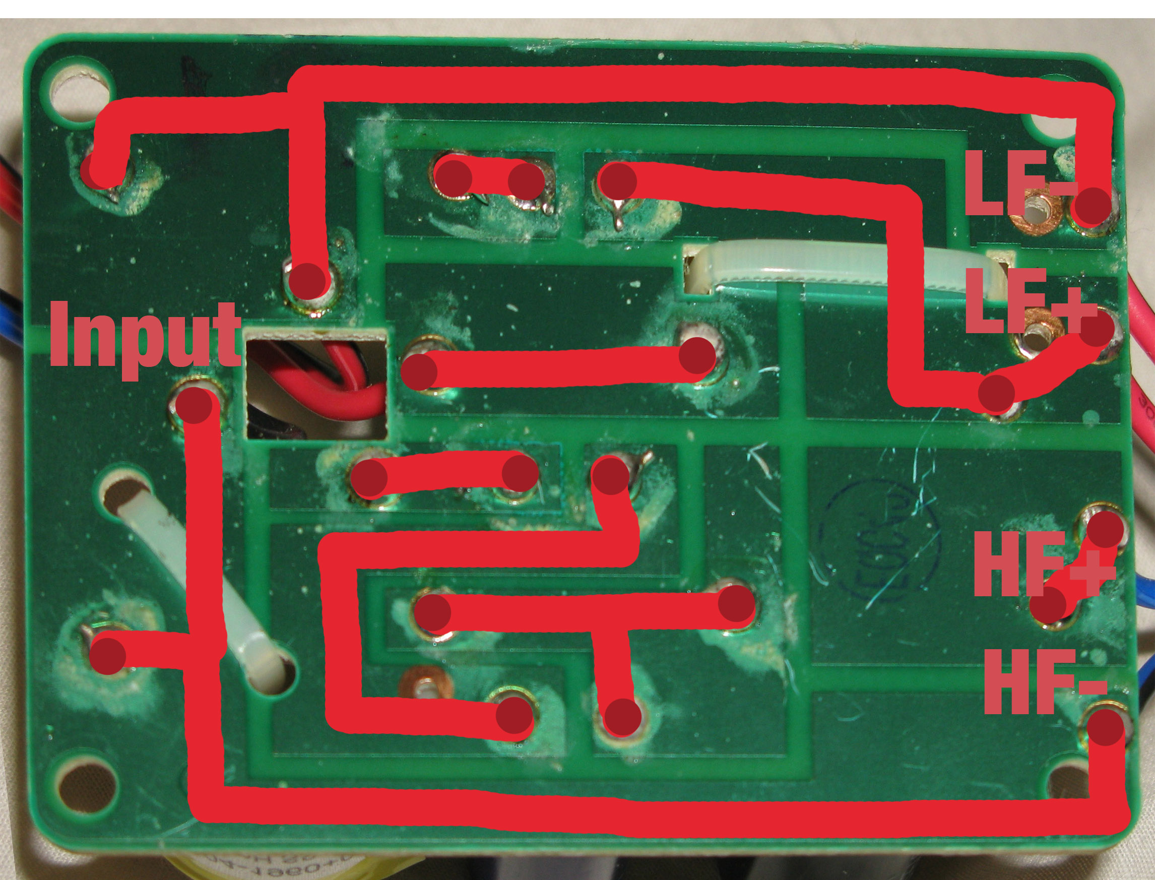

Posting pics so u can confirm by yourself, just in case my readings and schematics are wrong. The day i did it i barely took the crossover off the speaker so... who knows eh :)
Measured the resistors without taking them off the board and they measure 1,5 Ohm and 7 Ohm.
Capacitors give a rather strange reading, but i think its because i didnt take them off the board too. 16uf and 15uF gave 3uF and 20 uF, dont know if respectively or not. If really needed I can unsolder them and measure.
For the following pics I mirrored the image of the bottom of the pcb so that it would correspond to the component placement in the top of the pcb.
Other than that I had it skewed to correct the perspective of when i took the pictures. No other editing than those. Oh and the ugly drawings, of course! :eek:

it looks like KEF have sourced some odd values of capacitors for this crossover. Presumably because KEF thought it was worth the effort.
Feeding the same voltage source to the crossover sends the correct voltage and frequencies to the respective drivers.
Bi-wire the speaker and again the same voltage source feeds both drivers.
Bi-amplify and you must use the same voltage to feed the crossover to ensure the correct voltage to the drivers.
Remove the crossover and all bets are off. You must measure and experiment to discover what voltages and what EQ each of the drivers needs, then you can design your active crossover for the active speakers.
