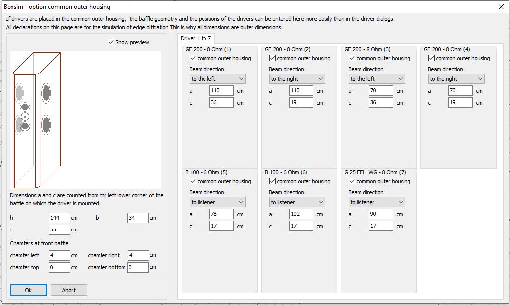

Hi all,
i am no good with VituixCAD but very quick with Visaton's BoxSim
simulating real quick something similar like the Blade construction like this
BladeCloneEnclosureBoxSimCapture.JPG BladeCloneDirectivityBoxSimCapture.JPG BladeCloneFRDirectionsBoxSimCapture.JPG

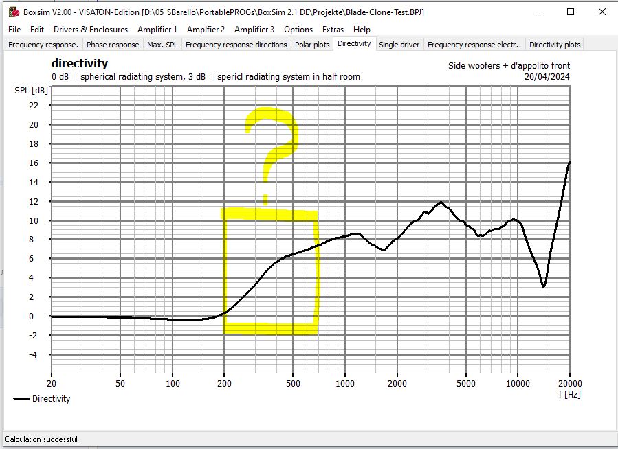

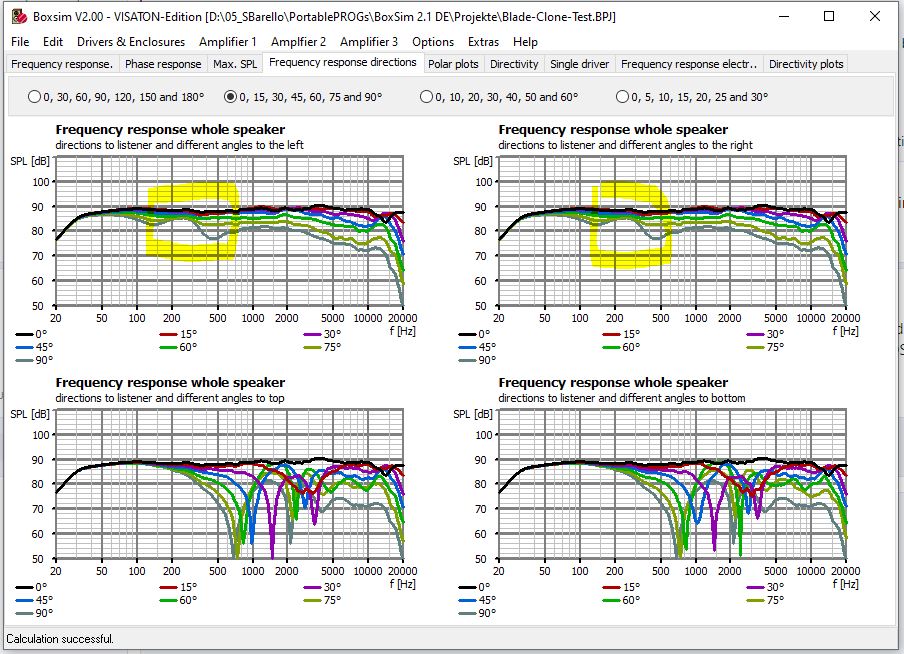

i can see that there might be issue with the directivity changes between 200 and 500 Hz and with the frequency response directions that you will not get with front mounted woofers

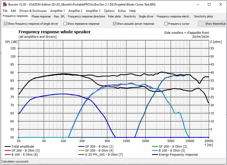

P.S.: for correctness also the on axis estimated frequency response
active crossover
LR4 330 / 270 Hz woofer to midrange and PEQ 30 Hz / Q=1 / A=6db for CB enclosure bass EQ for free field simulation
LR4 3300 / 4300 Hz midrange to dome with waveguide
