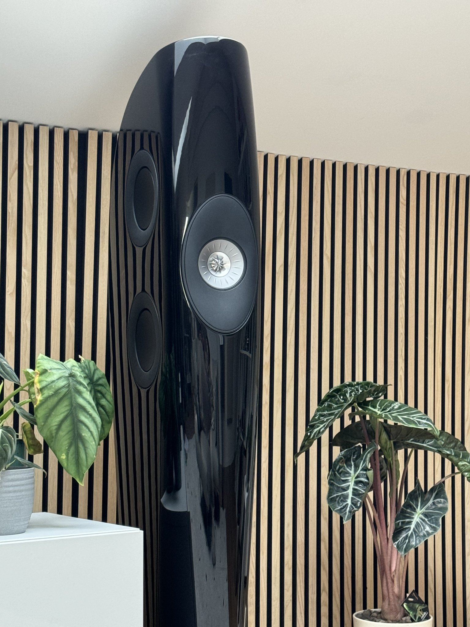

The thing that i like the most are the very good directivity even the vertical one. The sweet spot is large. The speaker are very neutral and eq'able. The bass goes Till 28hz in my room, about output they can go loud. For what they are i mean. They are still 4 6.5 inch drivers. Soo you know the limktations

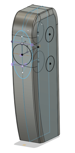

The basic design principles of the Blade don’t scare me………getting the function from the alignment without all the artistic form shouldn’t be an issue. I’ve sketched a design using sliced facets…..I’ve always liked that look. I don’t think there’s any acoustic value to the way they taper the enclosure to the base either…..if I build these active, I’ll need room down there for the amplifiers.
The true flagship of KEF is the Muon…..and they again went all front to back on that one……no force cancelling coupled woofers there. I’m not yet convinced the side firing drivers really bring much to the table.
They bring push-push. That is a lot. Very significant.

The thing that impressed me most about the Blade 2 in Erin's review was the dynamic range / lack of compression. I didn't expect that from the mid / tweeter. I guess the big voice coil of the midrange helps (even though the cone SD is small). That thing takes a beating.

I’d have to do some 90 degree off axis measurements of the 6.5” woofers i intend to use to be confident in all of this…..440 hz is A4………a critical element universal to nearly every vocal performance not to mention guitar, violin, etc……see what correlates with the crossover frequency and slope.
As the Uni Q used in the 150 is a little hot up top, I’d be listening to these around 15-20 degrees off axis….so no toe in.
Please show us your results w meas , thanks!I get whole point source coherence thing with the side firing woofers but with an Xo point of 440hz for the Blade 2, my brain can’t process the off axis imaging discontinuance where as the Ref 5 with all drivers fwd firing makes much more sense.
I ask the question as I have a pair of white Q150’s with scratched up cabinets I bought open box a few years ago on impulse for $250 that I had intended to just paint…….but now I’m thinking to harvest the Uni Q drivers instead and build my own active WWCWW. Thoughts?
Side woofers are still questionable ... how about KEF LS60 - better integration?
Front woofers rulez , of course! Hard to fool the brain!
Just close your eyes 😉.Hard to fool the brain!
Wot a bad Uni-Q MoFu 🙂Both are different compromises IMHO.
The Reference 5 could do with large roundovers.
The Blade 2 Meta could do with a lower crossover point, but the cone area of that UniQ MF means that it can’t reach down low enough to do a 120-150Hz crossover.

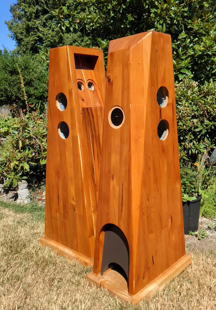

I could add 2 more woofers to Tysen V2 (and vent the woofers instead of ML-TL into shrink the size). Wouldn’t go as low but parts (excluding XO) would be about $300 USD.

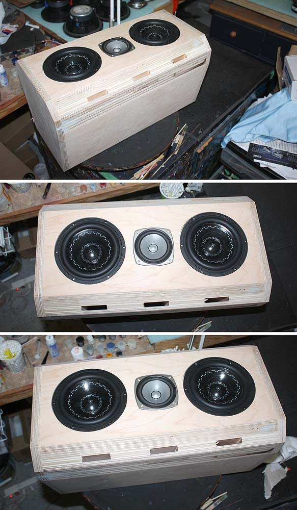

Went for a walk. Sketched this out in my head. Could be anywhere between 20-40 litres net for the 4 woofers. Add in a midTweeter midTL and box material. 12mm ply should be sufficient but 15mm is easier to work with.
This is an MTM with 2 of the woofers, 10 litre net, got lots of positive comments with a rudumentary passive XO. Parts got pinched for Tysen V2, box disappeared.
Members @DaveR, @Cal Weldon.
8 x Silver Flute W14 @ $28.50 each (the price has exploded) + a pair of 3” midTweeters of your choice.
