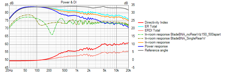

Actually, the simulation can show the effect of the frontwall.
This chart is the Vituix power-DI-PIR chart for the blade clone with rear woofer. The orange curve is the predicted in room. The dashed olive curve is the PIR with reflection from front wall enabled. Vituix drops the level of that trace to separate it from the orange. You can see that the primary effect of the front wall in the bass is to support the bass below 100 hz. The speaker is placed .5m from the front wall.

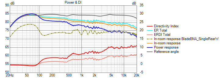

Not convinced its an improvement? Let's look at what happens without the rear woofer:
The dashed green trace is the in-room response with front wall reflection enabled. The dashed olive trace from the first chart remains in place for comparison. Choose your poison.

Sorry , nice simulation but the story was do have front woofers better integration than side-firing ultra-reference-wannabees?
Many listeners claim side firing woofers have drawbacks! (depending of course on more or less advanced filtering/delay)
VituixCad cannot simulate human perception , nor derivate it somehow!
Integration of sounds depends on masking , tresholds over time , HRTF influence , very complex scenario!
At the end - better trust your ears than relying on stupid simulations!

Simulatons are not stupid.stupid simulations!
Stupid might be someone drawing wrong conclusions.
But I know, you're not entirely serious ...
The all forward firing solution will have a wider forward beam, unless made cardioid-like by any of several methods. DSP controller rear woofer is the least painful but also the least directive. Side vents are the opposite, as you have confirmed, and can control directivity to a higher frequency.

I don't have personal feelings about side woofers vs front woofers; my feelings form around the resulting directivity characteristics which I predict via simulation. I don't trust simulation over my ears. I use simulation to determine what is worth building so that my ears can make a judgement and so that most times they like what they hear.
what the out of phase rear woofer does is cancel most of the output from the side woofers that goes to the rear and some of what goes to the sides so that you don't hear a too-shortly delayed reflection from the front wall. Without it or some form of cardioid, you may need to pull the speakers further out in the room than the room size permits in order to get the reflection past the Haas limit. This is true for most (non-cardioid) speakers, not just the Blade.
Its the cancellation of "some of what goes to the sides" that I thought might overcome objections I've heard to side woofers. These objections show in erin's measurements as the horizontal side lobes. These are reduced but not completely eliminated (see attached) in my simulation by the effect of the rear woofer and likely steeper crossover slopes. Because those sidelobes aren't completely eliminated, you would not want to place these drivers near a room corner, at least not without absorbing that near sidewall reflection of the side woofers. For really tight quarters, I think you would want to use cardioid technique past 1 khz.

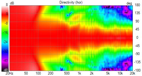

One of the problems with the blade configuration is the that the side woofers widen the response.
Why? At the frequencies the woofers ar eused they are omnidirectional. It would make no difference what direction the woofers face or how they are arranged..
dave
hmm the woofers do indeed go omni, at/around 450 hz but they also form an array and array configuration does indeed affect directivity. If you put them all in a line as in the reference series, fr example, you could hope to get improved vertical directivity in their range. but that is just a quibble.
I should have introduced my post differently. In retrospect, I should have faulted the blade, not the side woofers, for its widening response below 800 Hz or so, setting the stage for showing how that could be substantially improved with an out of phase rear woofer. Its interesting that a rear woofer allows you to have a cardioid-like response working against side woofers as well as front woofers
No they don’t, the DI flat lines at about 150Hz which is consistent with BEM sims of where all directionality is lost. Between 150Hz and 500Hz the DI is rising showing increasing directionality. In this frequency range you will get a different response depending on how the woofers are positioned.hmm the woofers do indeed go omni, at/around 450

Below a quarter wavelength there is no difference between a single driver and array in terms of directivity so it applies to both over most of the frequency range they are being used.The woofer array goes as you said but I was talking about individual drivers in that sentence.
