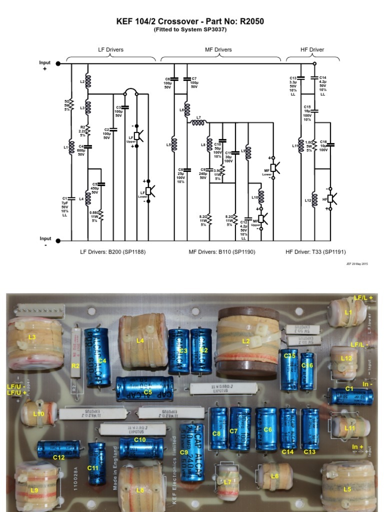

Absolutely none of the YouTube vids shows two boards, but a cutaway of the model does show it! My next step is to take the seven caps off the board and test and replace them. Here’s the cutaway.
Some versions had separate boards, i believe they were the later models with bi-amp capability. If you think about, you have to have separate crossovers to do that. The schematic is probobly very similar if you just copy it up into sections. Only additional complication is they added more protection circuitry into the later models.

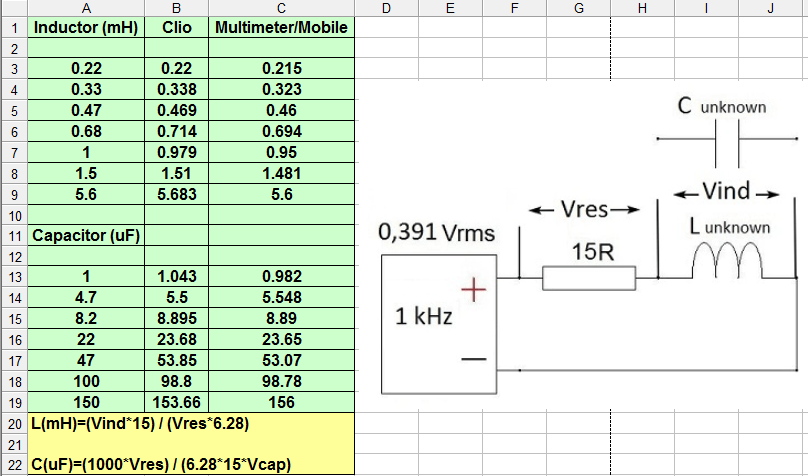

No specialized precision equipment, a multimeter able to measure from 0Vrms and up, one resistor, a laptop headphone out, a sine wave frequency generator software (REW) and some hook-up wire (mini mono or stereo plug). After that some calculations and you are done.
Can you supply a little more detail? I don’t see how I can use this to test a 50 volt cap with that low of an output. And I certainly wouldn’t want anything to kill my computer.

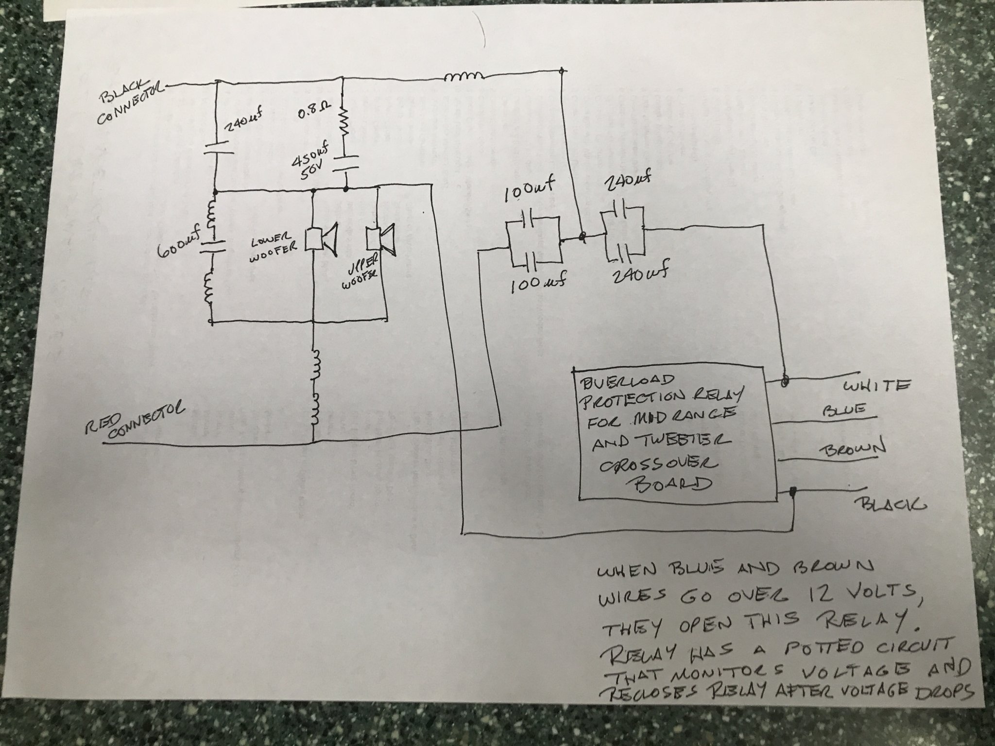

That component is a 8 ohm resister and it reads good. Unfortunately, the protection circuit can’t be diagramed. It has two wafers coated in a red plastic that you can tell are multiple components on each wafer. The good news is that portion of the board is past the woofers. It’s function is to cut power at this board to protect the midrange and tweeter. It has nothing to do with the woofers. I have already sketched out the circuit. See below. Also note it doesn’t in any way fit the LF portion of the single board crossover.
Have you checked the colors of wires at the bottom of the loudspeaker insise the cavity, it should be below a green grey foam ? Are they really red and white at the binding posts or white and black ?
I do not recognize the shematic, maybe a drawing error or a serie filter ???
The 104/2 I know is the shematic given in a post above. I would check all the caps in the woofer circuitry that are shunted to the gnd aka return path black connector.
On your photo where are going the white and black wires ?
The posts on the back of the speaker are bolted to the two holes in the bottom of the board in question. The black and white wires carry in audio input to the crossover for the midrange and the tweeter. The blue and grey wires are also on that crossover board and they signal an overload which then opens the relay to save the tweeter and midrange.
Ok, check the 600 uF and the two caps below, i.e the 3 upper caps on the pcb. Resolder the vias on those three caps...maybe a cold joint. Check idem with the buzzer for the coils. Anyway one of the cap should have a problem, they are too old... you will not recognize the sound with brandnew ones 🙂.
The four first above the bolds (240 uf//240uf + serie100 uf)//100 uF are the high pass towards the mid tweet pcb and are ok.
Be aware than the recap kit from Falcon is for the standalone pcb. Alcaps seems to have problem perhaps as the caps are more and more difficult to source at Falcon...their Alcaps catalog melted down halas.
Check also where are going the purple and the orange wires. They are the signals cables of the woofers after the 2 low pass coils. One is going to the neg post of the upper woof, the other is going to the positive of the bottom woof. Important to check for their push pull working or you will have bass cancelation,
