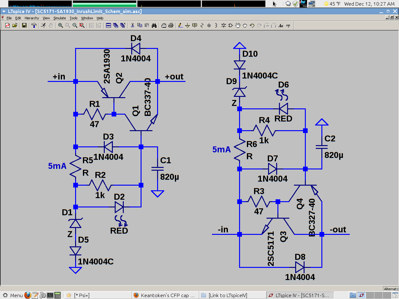

I have another quick question - if I want to set the voltage drop / output using a potential divider, would this work ? My input voltage would be 21V, and output between 12V and 9V, @40mA, R2 and R3 are created using a 10K potentiometer. The 2SA would be a BUP41 with a heatsink. C1 might need to be smaller so the RC delay isn't too long, say 47uF.
Thanks !

I just realised it might be far easier and more effective to replace the string of diodes with a 12V zener, so this would drop about 12.7V ? So 21V in and 8.3V out. This would be fine for my application. Would the higher voltage drop cause any issues, except of course the need for a heatsink on Q2 ?
BTW, if you don't like me using your images in this way, please let me know. I just thought it's the easiest way to describe the changes.

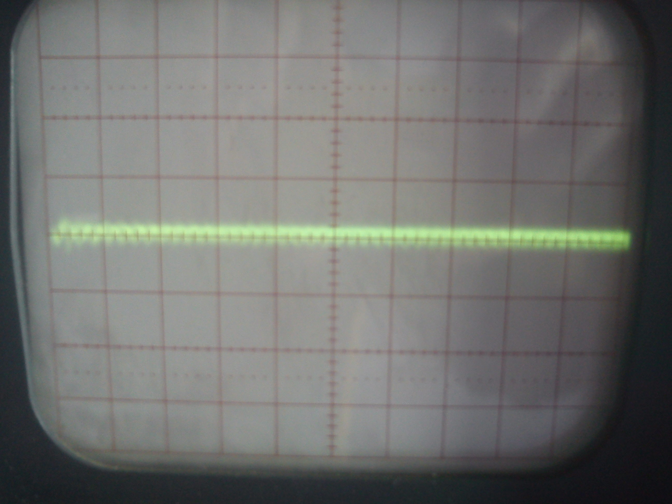

Thanks Keantoken, before to make it I will measure with the scope real ripple between the PSU & SSHV2.
@keantoken
Scope ripple measurement done at the last CRC, scope set 0.5mV/cm so it's Ok to use🙂. Where have I to connect the cap multiplier: in the PSU box or in the lineamp box togheter the SSHV2? I guess in the lineamp box, right?
To use that schematic you need to turn the zener upside down and add a 5mA resistor from it's bottom to ground. However this way the Kmultiplier will still track the input voltage. Is this the desired effect? I don't think so, and I would rather replace the upper two diodes with a 5mA resistor, and put the zener below in series with a diode to put the output less than a diode away from 12V.
One of the reasons the Kmultiplier works is because it normally has such low Vce. With 2V Vce the output transistor can handle its max Ic within SOA. However you won't get this benefit if you step a 21V supply down to 12V, so mind the inrush and output dissipation. If the output dissipates more than 2W you'll need a heatsink.
Here is a version of the Kmultiplier for a fixed output voltage. Choose the Zener for whichever output voltage you need and size R5/6 for 5mA of current.

You are so helpful - thank you. I've got it sorted in my head now so thank you very much. I greatly appreciate your help.
In my case, there'll be just under 8V across R5 (20.5V in, - 12.7V for the diode+zener) so 1.6K resistor.
