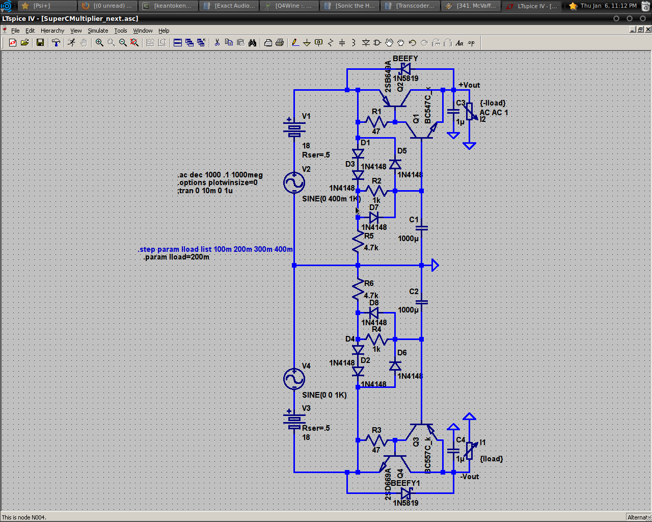

Keantoken:
Let me show you the datasheet. VceSat is the parameter we're looking for, in figure 4.
http://www.fairchildsemi.com/ds/BC/BC550.pdf
I like to keep Vcb positive. Transistors are most linear with at least 2V Vce. You can see this in figure 1. Keeping base current the same, Vce is varied in order to observe Early effect (change in transistor parameters with Vce). Between 20 and 10mA, you can see that 1V Vce or more is desirable (the line begins to straighten out at that point). VceSat is the point where Early effect begins to destroy transistor operation, when Vce is too low. If it matters enough, you can get away with just 70mV Vce at 20mA. But at this point, as you can see again in figure 4, Early effect will reduce that transistor's natural resistance to input voltage variation (decreasing PSRR).
The problem so far with the diodes is that the bias current through them is on the order of uA. For this reason their voltage drop will be below what it is at currents in the mA. I think adding one more resistor may be beneficial to the circuit, but it could just as well be useless. See attached schematic. I give the diodes 5mA bias. This should increase Vce a little, and make it a little more predictable. You could also use a red LED here, for default 1V Vce (may improve PSRR) (2.6V voltage drop), and less noise than a 4 diode string.
For the 2SC5171, it is advisable to have a heatsink. Even though the device specified for an operating temperature up to 150C, if you look at the Hfe chart, operating at higher temperatures reduces the Hfe range. At 300mA you are just at the rolloff point, and this may differ between devices. Even if this is not a concern, the device may get hot enough to melt nearby components and damage the PCB (and transferring heat to other components through the leads).
39R should work, but I wouldn't go any higher.
- keantoken
I did the change last night by taking out 3 x 1N4148 replacing them with 1 x 3mm red LED, and added a 5k1 resistor.
Vce for the driver was 1.32V, but is now 14.96-13.06=1.90V. Vce for the pass transistor, or the total voltage drop of the K-Multiplier is 15.65-13.06=2.60V.
Output with various voltage drops of the diode string:
1 x 1N4148: about 12mV non sine wave at 14.65VDC. Subjectively It did not sound good.
2 x 1N4148: about 8mV non sine wave (but rounder) at 13.90VDC. Subjectively it sounded better.
3 x 1N4148: about 6mV sine wave (or close) at 13.83VDC. Subjectively it sounds the best.
1 x LED + 5k1: about 3mV sine wave (or close) at 13.06VDC. Subjectively it sounds good but not the best.
The LED version with 2.60V voltage drop does not really work for me because in that case the Marantz reg has been left with only 1.7V for voltage drop, which is insufficient. The Marantz reg sets 11.30V output voltage but with the LED prereg it has only 11.10V at the output, indicating too low input voltage. With 3 x 1N4148, I had 2.52V voltage drop for the Marantz reg and it appeared to be working with the desired 11.30V output voltage.
So for me, 3 x 1N4148 work the best. I will reverse the last change and am content with 3 x 1N4148.
Note that the LED version might be better if you could afford the higher voltage drop.

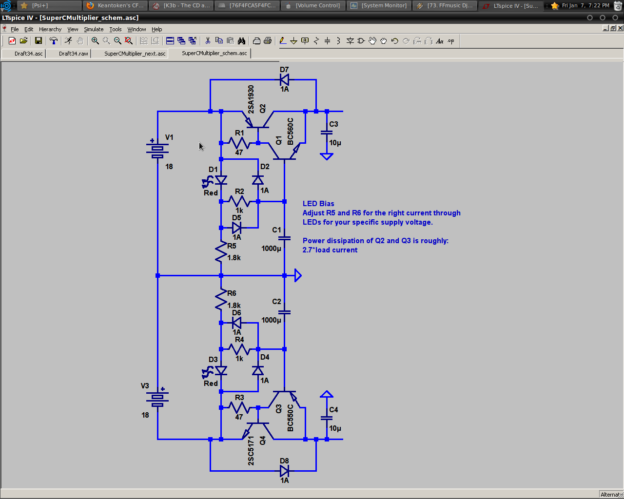

The schematic I sent you contains some possibly misleading features:
1: Output devices are 2SD669A/B649A. These will work to 100mA, but the 2SC5171/A1930 work to 300mA, are just as fast (if not faster) and are easier to get for some people.
2: Drivers are BC547C/557C. The BC550C/560C have slightly better noise specs, not sure if it matters but I prefer to buy the superior part anyways if it's of little consequence to the wallet.
Here is a cleaned up, nice schematic representing the ideas I described to HiFi.
- keantoken

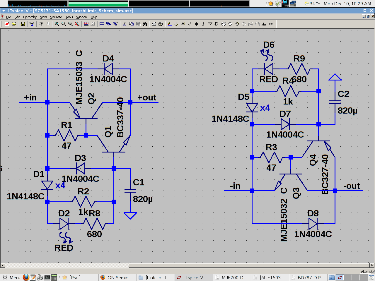

Hello Iko,
Nice page, KMultipliers.
Not Iko, keantoken!
1.6A steady is getting into wary territory. At this point outputs are generally too slow and Hfe is too low to be unconditionally stable and still have low output impedance. In simulation this is looking like it can work.
The MJE200/210 seem like reasonable transistors in this current range, and while the MJE15033/32 are more robust they are morbidly slow in comparison. Ultimately I would need to test the circuit myself to see if it is viable. You will certainly not get all the performance at 1A that you can get from the standard Kmultipliers at 100mA.
Luckily, both Cordell and Andy_C have provided custom simulation models for the MJE13032/33 pair, so I'm reasonably sure this is the best solution. Again to be sure, I will need to test it myself or have you take some simple measurements.
For best performance the diode string needs another diode. It's not necessary but it helps.
It will help to know what is the pk-pk input ripple voltage at the point you are intending to put the Kmultipier.
EDIT: Added schematic.
